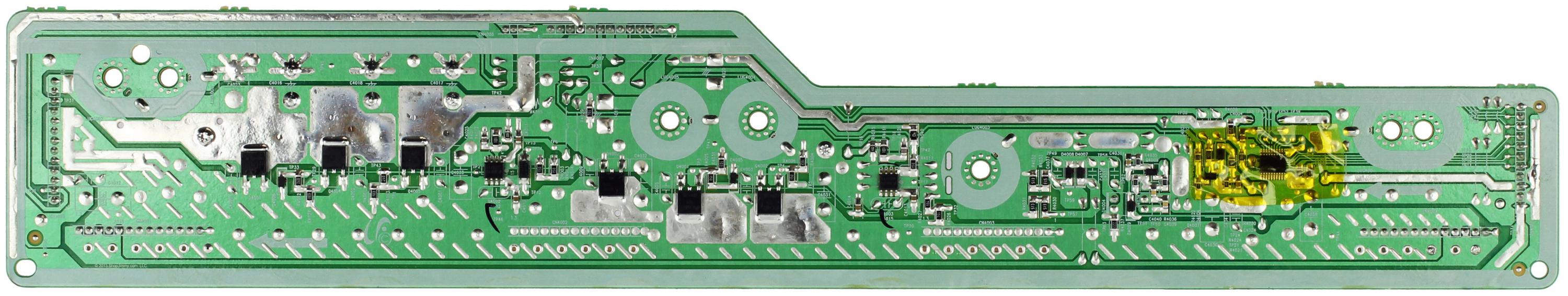

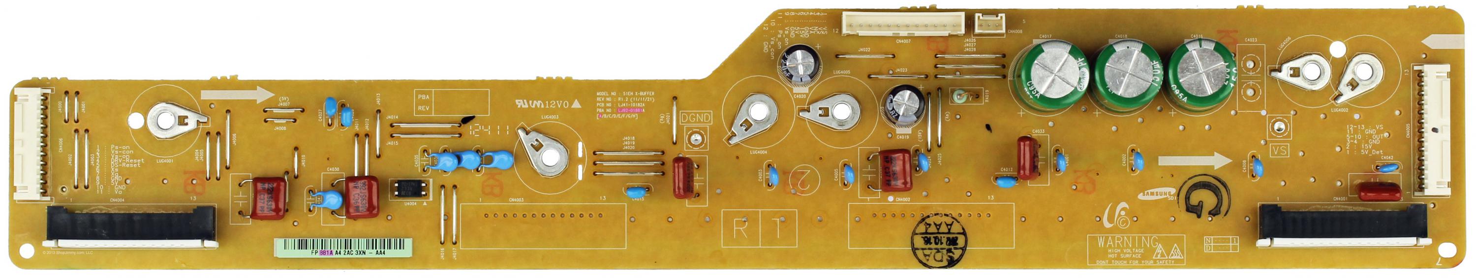

                      Not sure if this has been noticed but there is no Xmain, just x-buffer, both x & y main combined, X/Y-main
                        #51
                        Re: Samsung PS51E450 Plasma Problem.
                        I'm not certain about that, would need to see underneath X-main, the green caps on it suggest some power electronics (if only SUS - the ERC being on Y-main...)
                        I did see an old LG 42T1 panel with combined Y/Z-sus; the Z-extension board only had a few protection diodes and poly caps. I also have had 42PQ3000 & 42PG3000 LG plasmas (42G1A/42G2) which also had partially combined Y/Z-sus.

                            Maybe they're using the term loosely. there 's a bit more to it but that's the name they gave it.
                              #54
                              Yes, there are SUS_UP+SUS_DN IGBTs on there.
                              Everything else, including Ve(common bias voltage) and energy recovery/resonance is done on the XY-main.
                              Interestingly: there appears to now be an FPC DET built into a Samsung X-buffer, look at the connections coming off the FPCs. I bet if it detects a broken X-main FPC it'll shut down. That would be a dead panel (though it would probably not be too hard to fix.)
