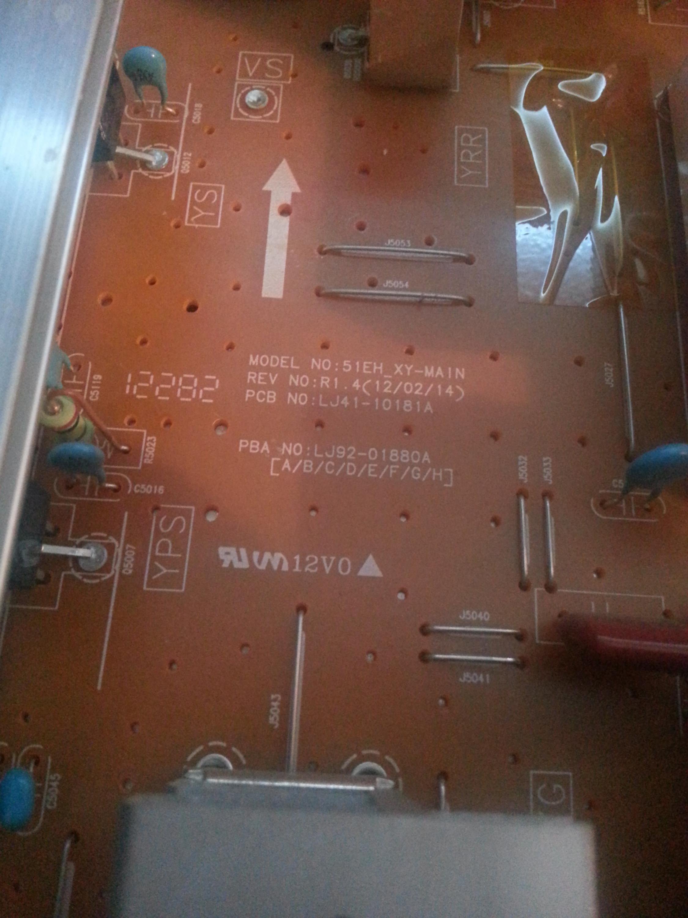

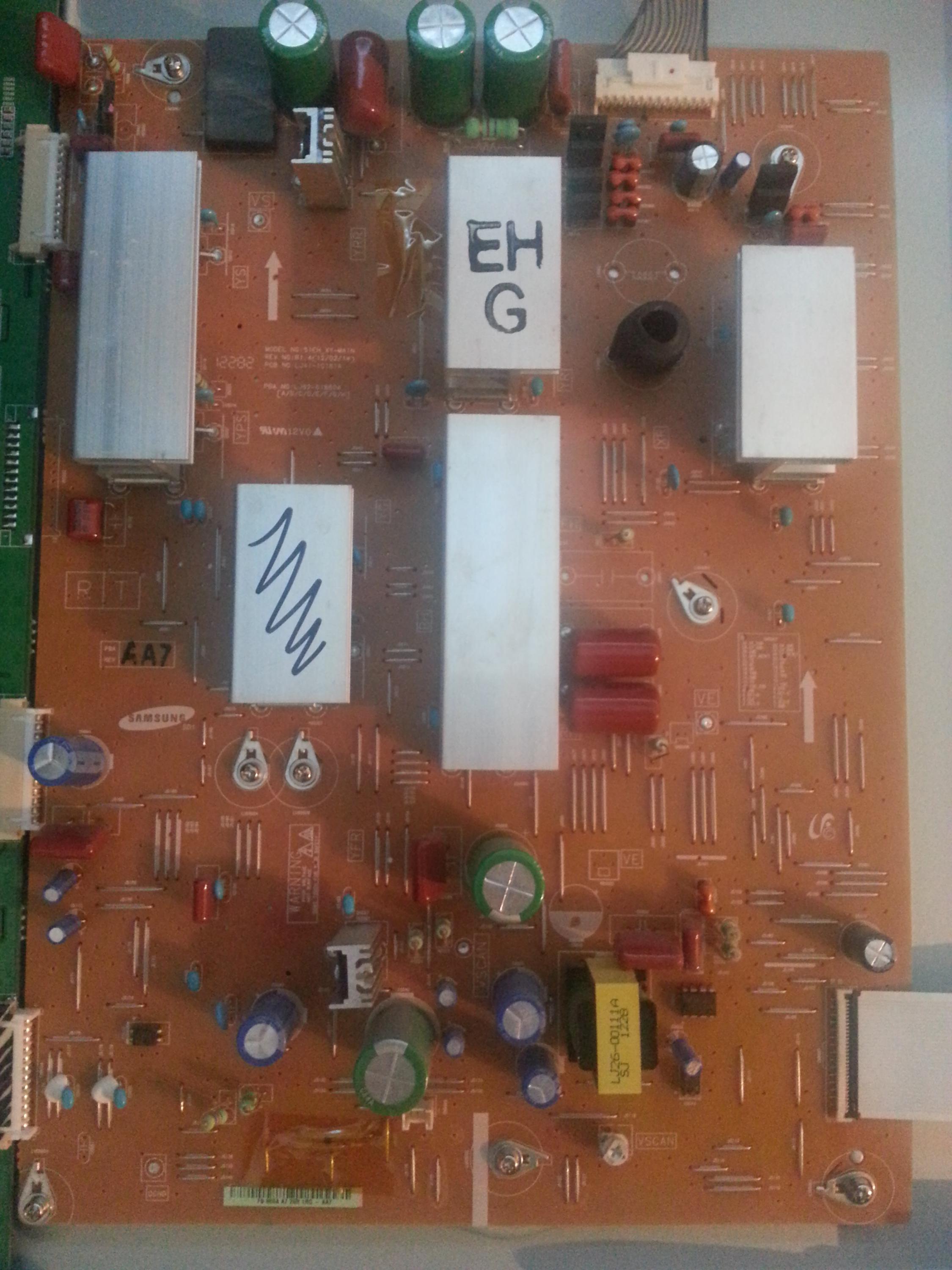

            #65
            Re: Samsung PS51E450 Plasma Problem.
            i think the x-y main board is combined in this TV Tom ?

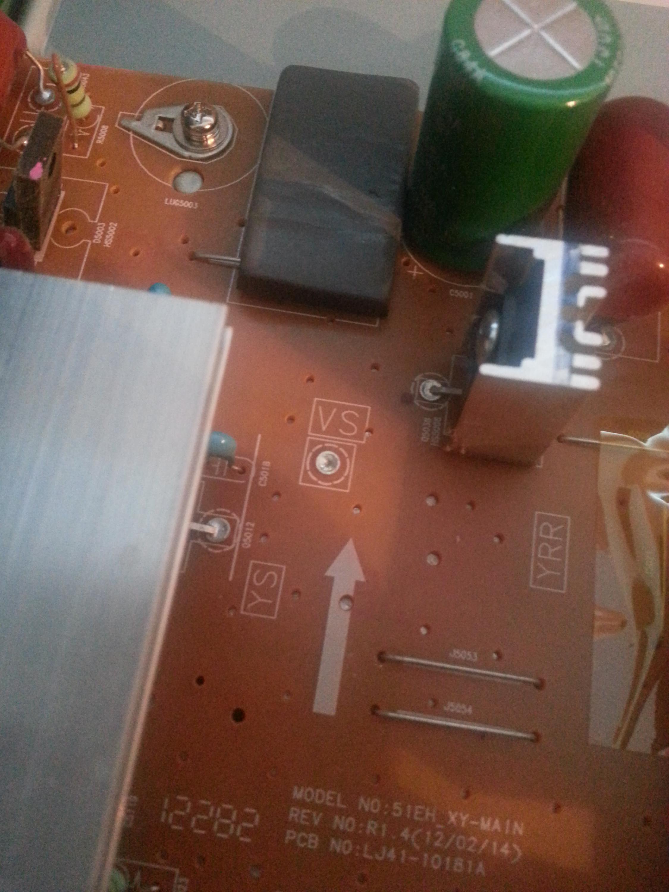

              #66
              As discussed with tw2005, kinda. But not quite. But sort of. I still call it a Y-main even if drives most of the X-main.
              A picture of the large lefthand board then if you like .
              • Mikeyboy2007
                • Mar 2013
                • 745
                • Scotland

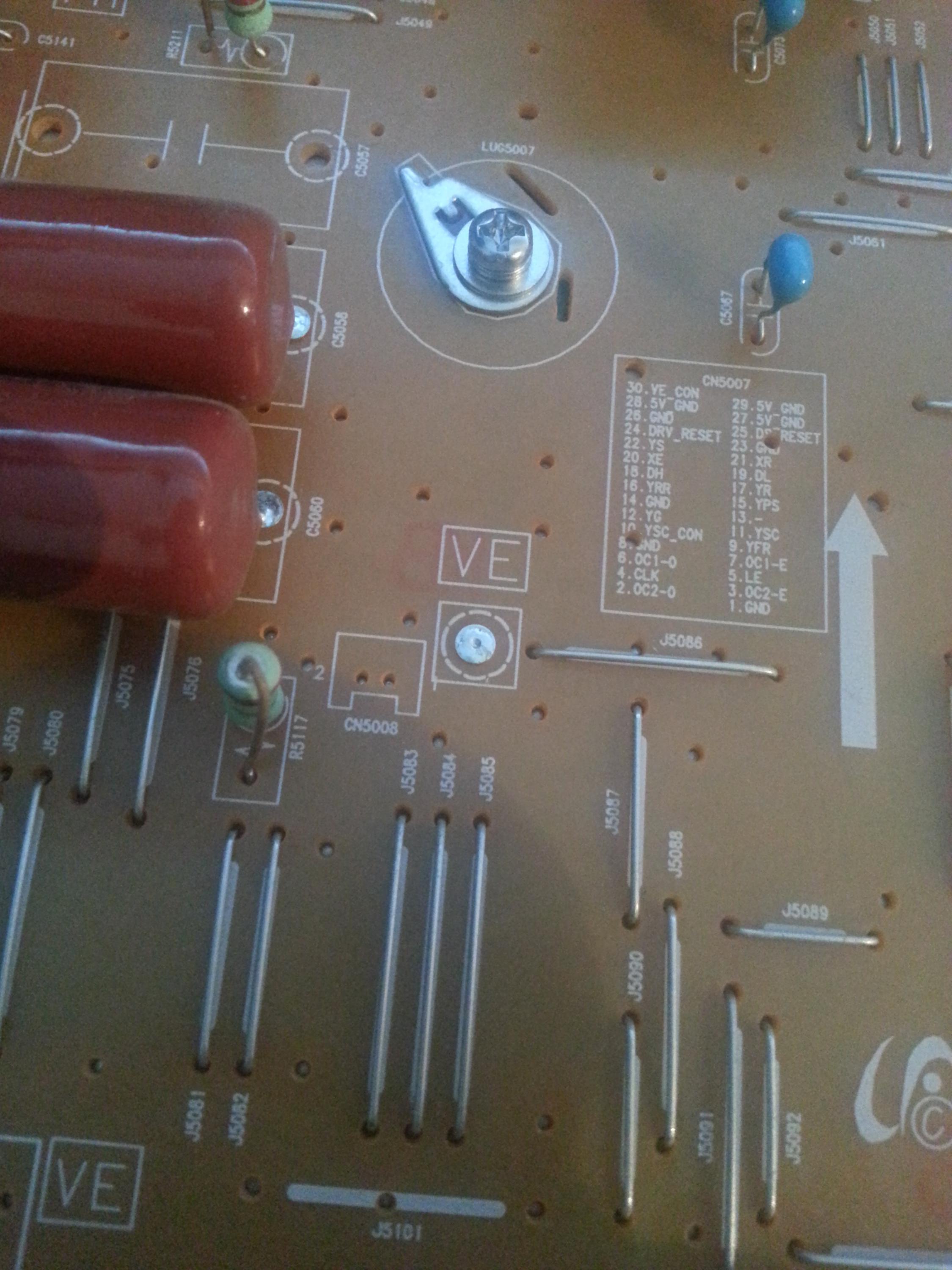

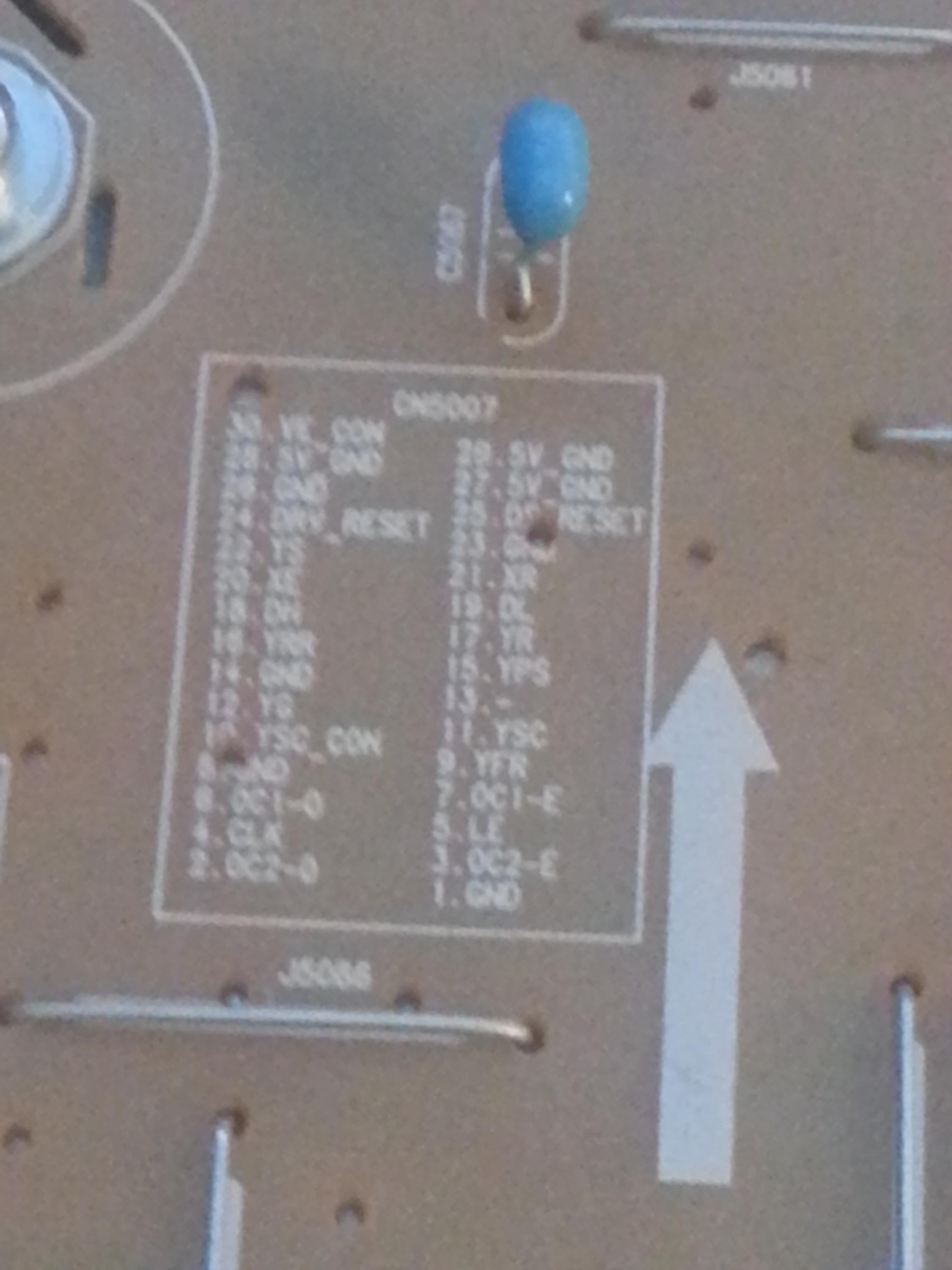

                #67
                hope this helps Tom. if you need clearer photos of anything let me know.
                  #68
                  OK test points marked VSCAN and VE. Check the voltage you get on those, red probe on point, black on chassis, and as it turns on, flashes, and then goes dark, note any changes. Compare to panel sticker ratings.

                        #71
                        ok tom as instructed, VS went striaght upto 201v then started slowly going back down to 010v, VE rose slowly to 81v then slowly rose back down to 10v also

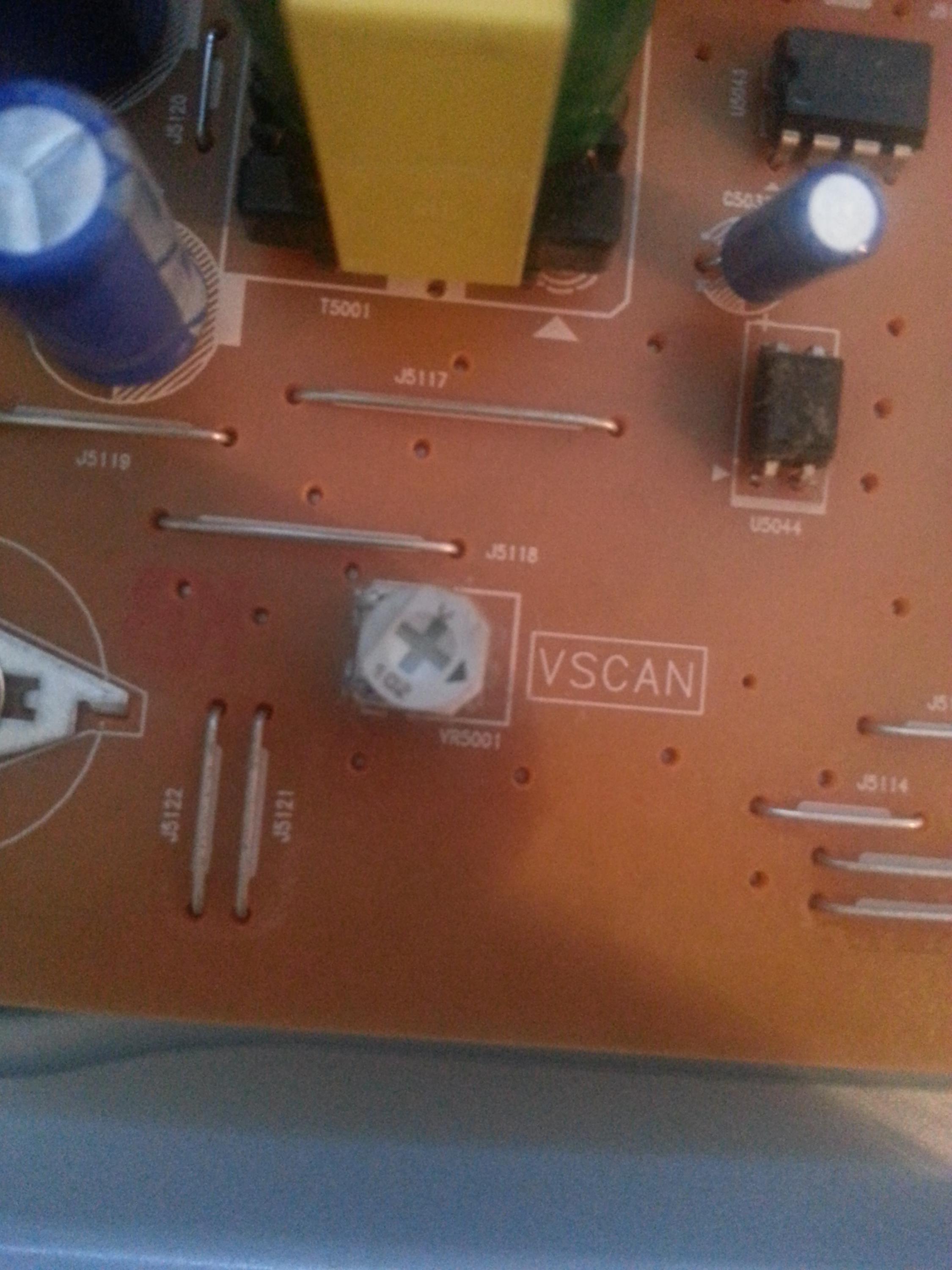

                            #73
                            no tom the two test points on this board are VS and VE . VSCAN on the board is what is pictured.
                              #74
                              VSCAN testpoint is near the bottom of the board.

                                #75
                                OK Tom finally managed to find VSSCAN lol plugged in went to -183 stayed like that for a 2 seconds then started rising slowly towards -000, that was with multimeter set to 250vdc.
                                hope this helps, and thanks for your help.

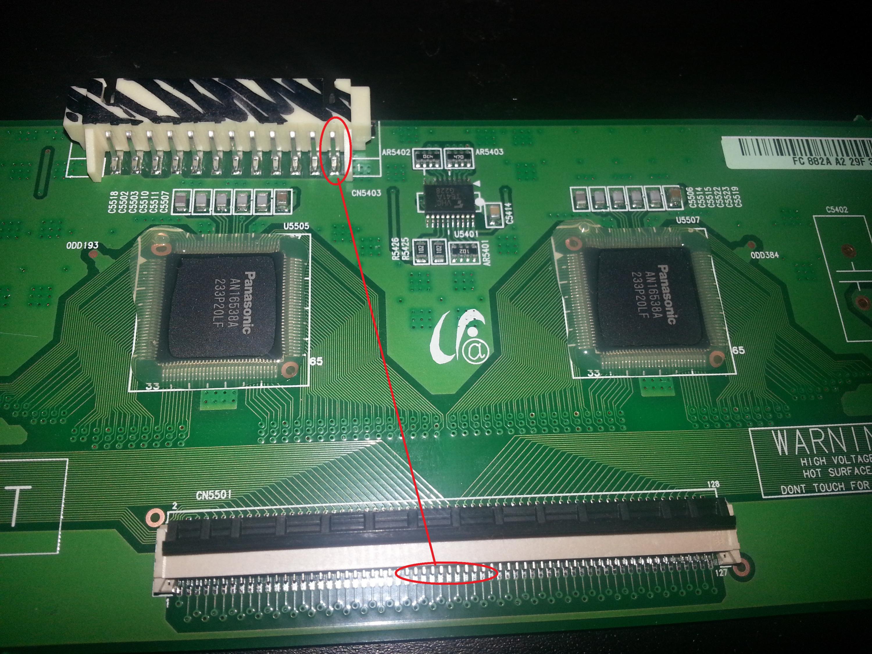

                                      #78
                                      ok tried best to do as the guy showed in video and got some beeps in there
                                        #79
                                        That's me in the video ... Could you highlight where you got beeps on a photo?
                                        • Mikeyboy2007
                                          • Mar 2013
                                          • 745
                                          • Scotland
                                          #80
                                          good video Tom, do you do those kinda videos a lot ? posted a picture, hope it helps was first lot i tested. am i testing right ?
