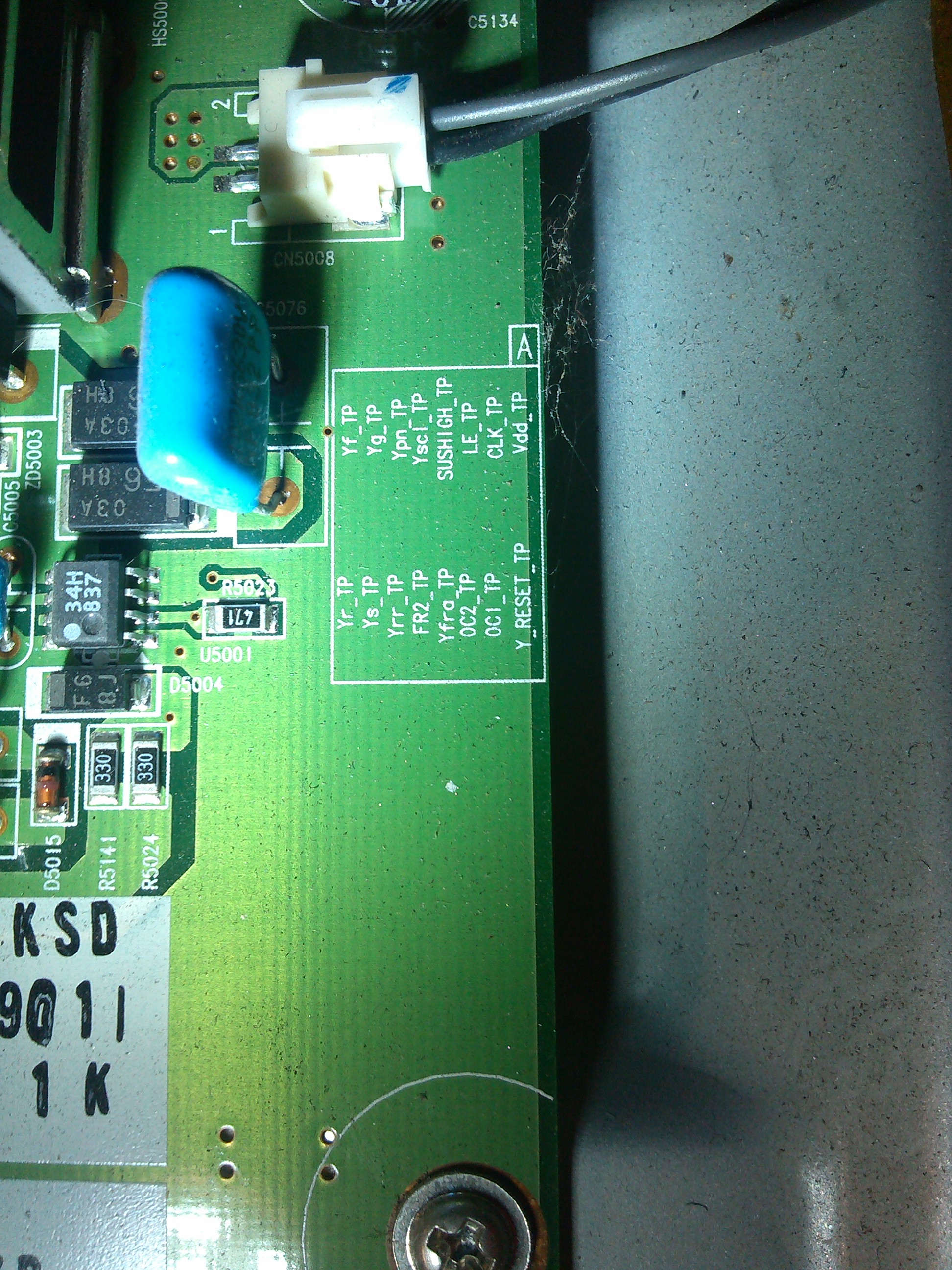

            Tom I'm sorry I'm dragging this out but I have no idea where these test points are??? All them pictures I added on page 1 is not it? I don't even know what it looks like if u could show me an example picture maybe? Thanks for all ur help

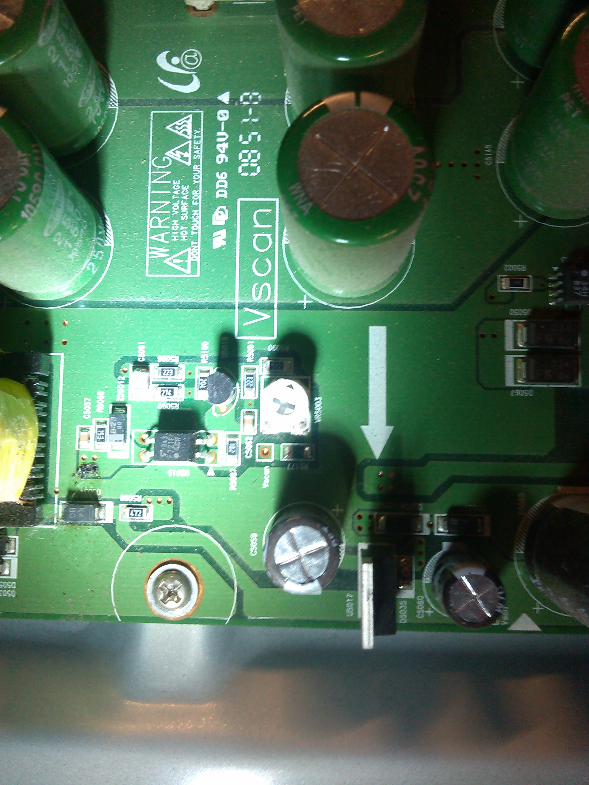

              Tom im at my shop now can u tell me what to look for on this plasma?
                Re: help with samsung pn58b550 plasma
                not sure, I just recalled this thread and we couldn't find it either, see this image for some quick checks

                  tom is this anything you wanted to see?
                    #29
                    I have a feeling Vscan might be indicated by that arrow... but that could also be the DIP flow direction, so.... not sure. Nice of Samsung to make it so very clear as mud.
                      so in that picture am I putting my probes on each side of that coil?
                          the red capacitor, not the coil.
                          red lead on red, black lead on black.

                            #33
                            what about in the picture of the connector?
                              #34
                              As you said. Do that.
                                on the cap im getting -110 on my meter??? on the connector im getting nothing.. and while I was testing it I smelled something really hot on that board burning
