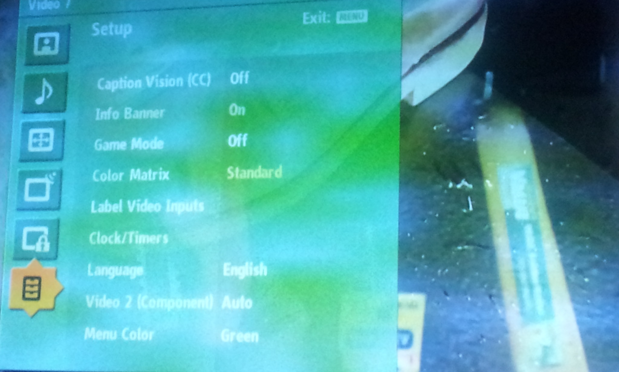

    Sony KDS-55A2000 Yellow Patches in Picture
    I turned on my TV tonight and noticed yellow patches or blotches in picture even on the menu. Is a SXRD Type. Is has the three liquid crystal generator setup. What one of the three would cause this or is the whole block one assembly? Thoughts or suggestions?
    Re: Sony KDS-55A2000 Yellow Patches in Picture
    That is blue module failure. Very common wih these sets from what I have seen. UV light from lamp assembly (especially if aftermarket bulb used) damages the module.
    https://www.youtube.com/watch?v=K6YW...s&noredirect=1
    https://www.youtube.com/watch?v=oP2nNPOjn_Y
      Right after I posted it, my wife asked. Have you tried turning it off and and back on. I said no. Strange thing just to appease her, it worked! What are the odds of that! I know it will probably back but now at least I have a heads up on the problem. We just came back from Church. Praise the Lord that it working because we are having to buy another central AC unit this week.
        I have replaced the bulb twice before, It uses a clear projection bulb like a DLP projector. It had three Liquid crystal devices I beleive. I just located and downloaded the Service Manual. I am sure it will be toast soon if the modules are unobtainable.
