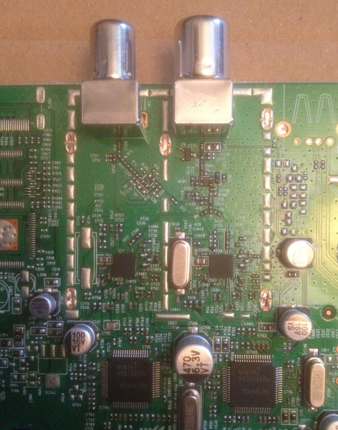

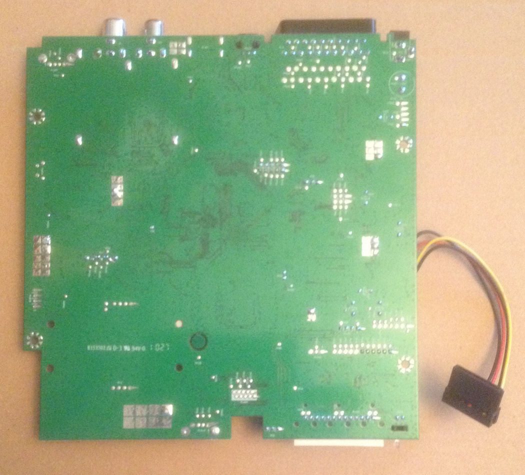

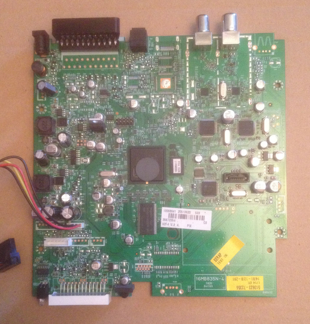

    I have an Hitachi HDR505 Freeview+ Recorder. It uses a Vestel 16MB835N-4 T385 041109 PCB.
    It powers up ok and can access the existing recordings on the HD, but it reports there is no antenna signal - so re-tuning results in no channels found, and there is no signal at the aerial output socket (JK2) with a known good aerial connected to the input (JK1).
    I have tried re-touching the solder on those discrete components obviously in the signal path from JK1 to the tuner IC's (? MXL5007T) and back out to JK2 with no success.
    Any suggestions on what to try or test next would be very welcome.

    Check the +35V from the PSU is OK. This is used to tune the tuner.

      @tom66 - Thanks for the quick reply. The external PSU is only 12V so I guess the 35V must be generated on the board but I can't even see any capacitors rated greater than 25V - would you happen to know where I could check?

        It might be of a different design. What is the part # of those ICs near the tuner input?
          Re: Hitachi HDR505 - no antenna signal
          The two smaller chips nearest the jacks are both marked MXL5007T the two larger chips beneath are both marked D61541GB.
