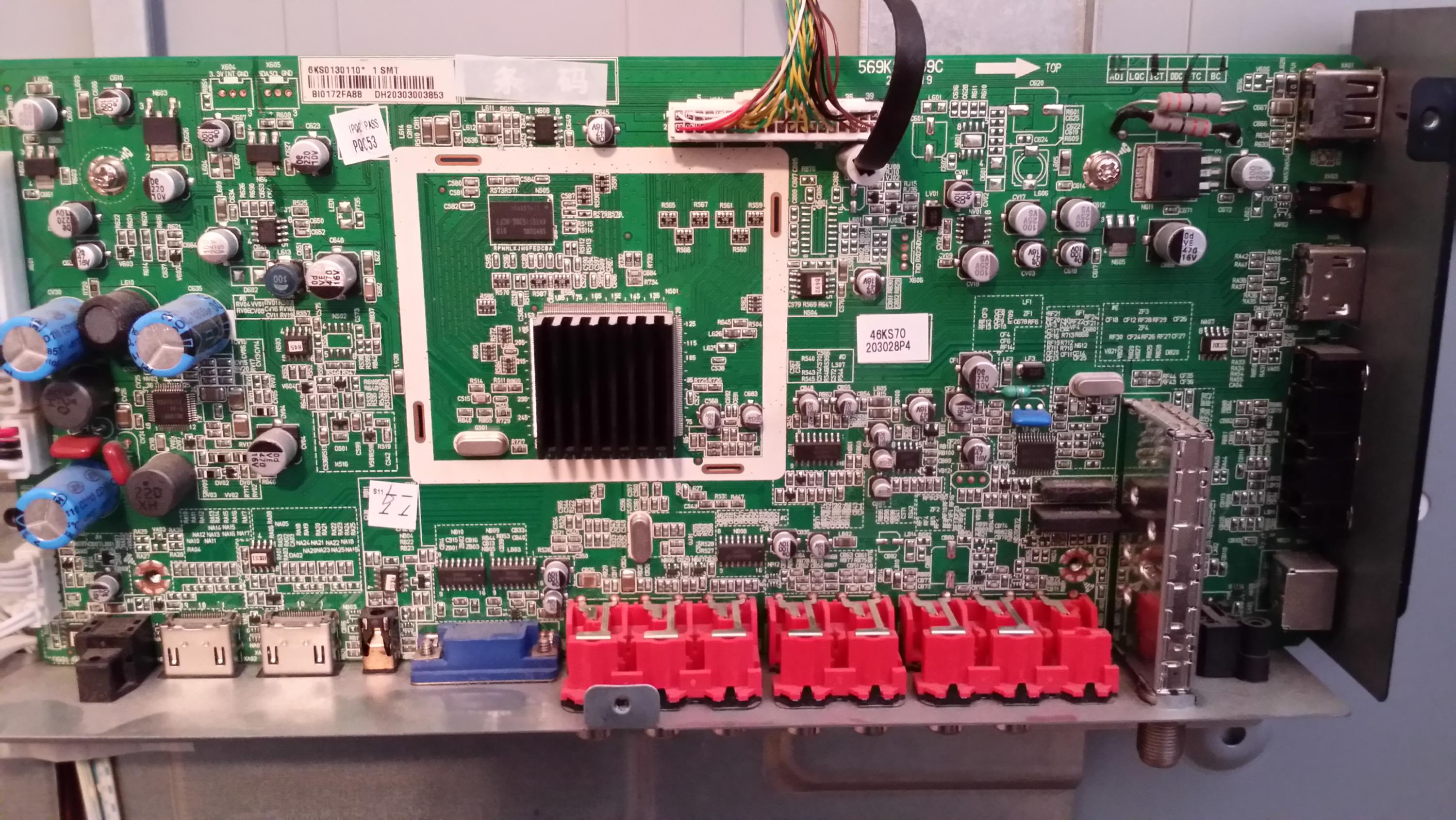

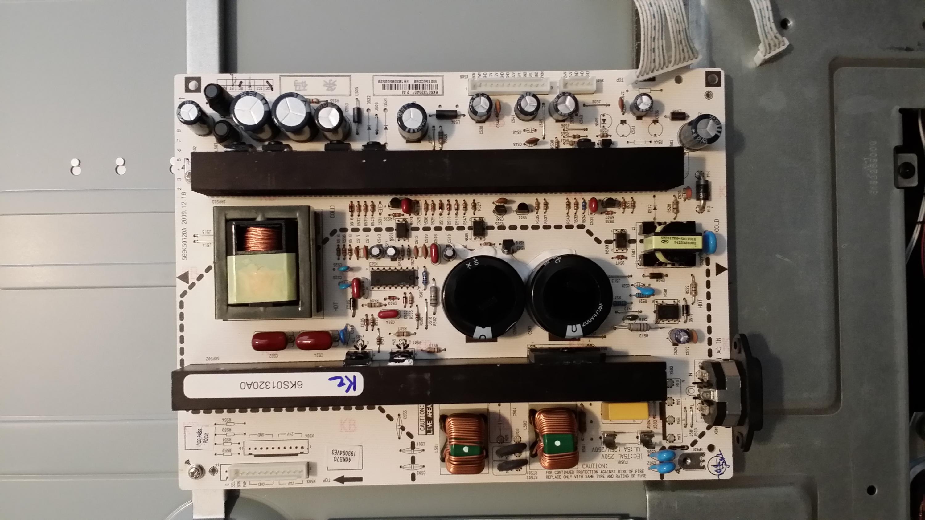

    Re: dynex dx46l150a11 stand by power only
    pics
    • un4givintoo
      • Apr 2014
      • 14
      • usa
      few more

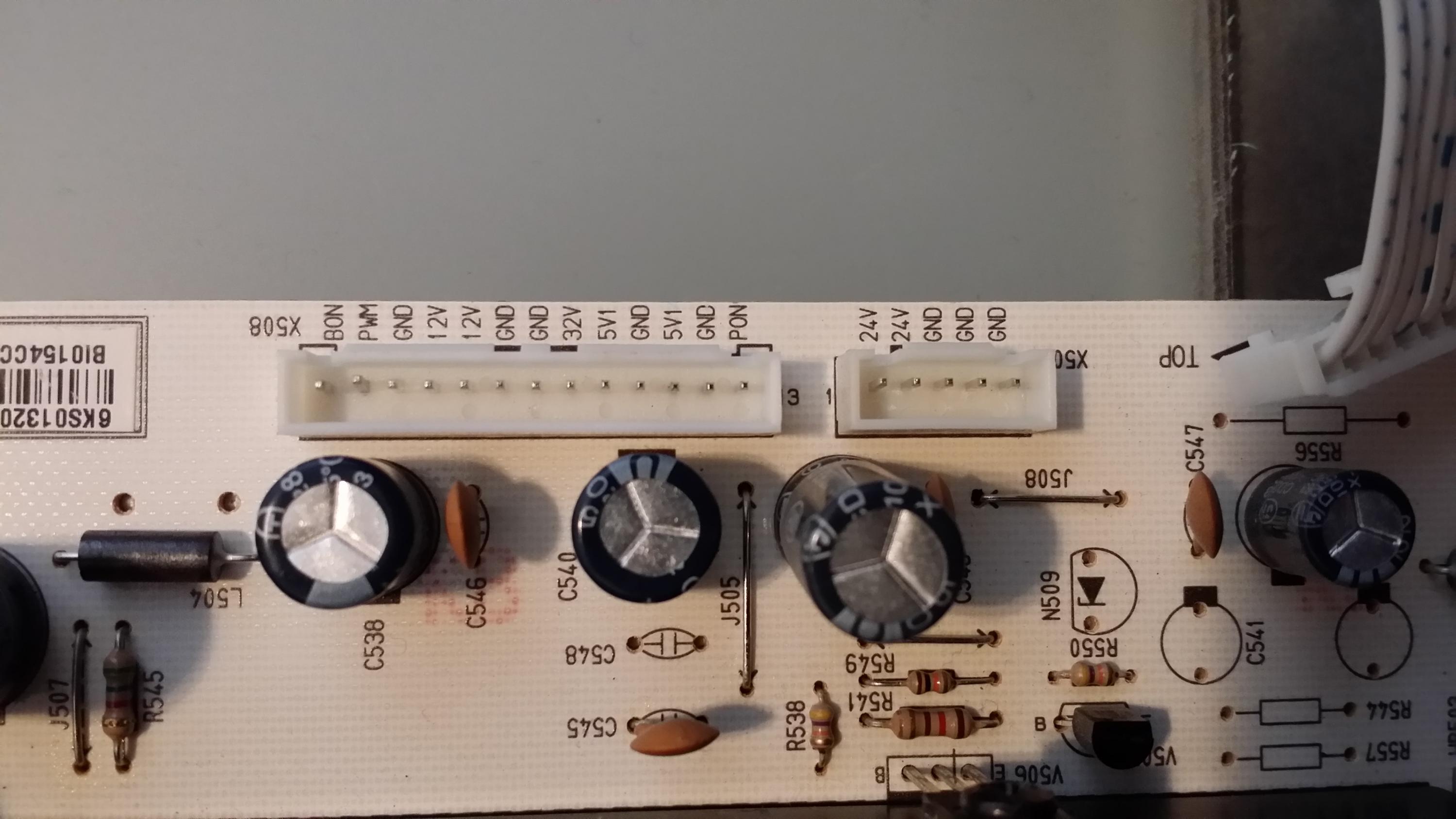

        OK, on the power supply board, there are 3 white connectors with labels for the pins.
        Take the DC voltage readings (using chassis as the ground ref. point), when TV is plugged in but the power switch not activated, then with the power switch activated.
        Post all the pins labels follow by the voltage readings.
          it looks like im getting nothing but on the bottom 5v1 pin im getting 5.1 thats on the top ribbon on the right
              I am still waiting for the reports of all the readings and the labels on each one of those pins on the connectors.
                bon .012
                pwm .003
                gnd 0
                gnd 0
                12v 0
                12v 0
                gnd 0
                gnd 0
                32v 0
                5v1 0
                gnd 0
                5v1 0
                gnd 0
                pon 0
                24v 0
                24v 0
                gnd 0
                gnd 0
                gnd 0
                not sure what happened im not even getting th 5.1 volt standby power anymore fuse is good
                  You have 3 connectors on the board, what are the reading on the rest. So far I see the inverter board is not getting the BON (Backlights ON), PWM signals from the main board per your readings on post 8.
