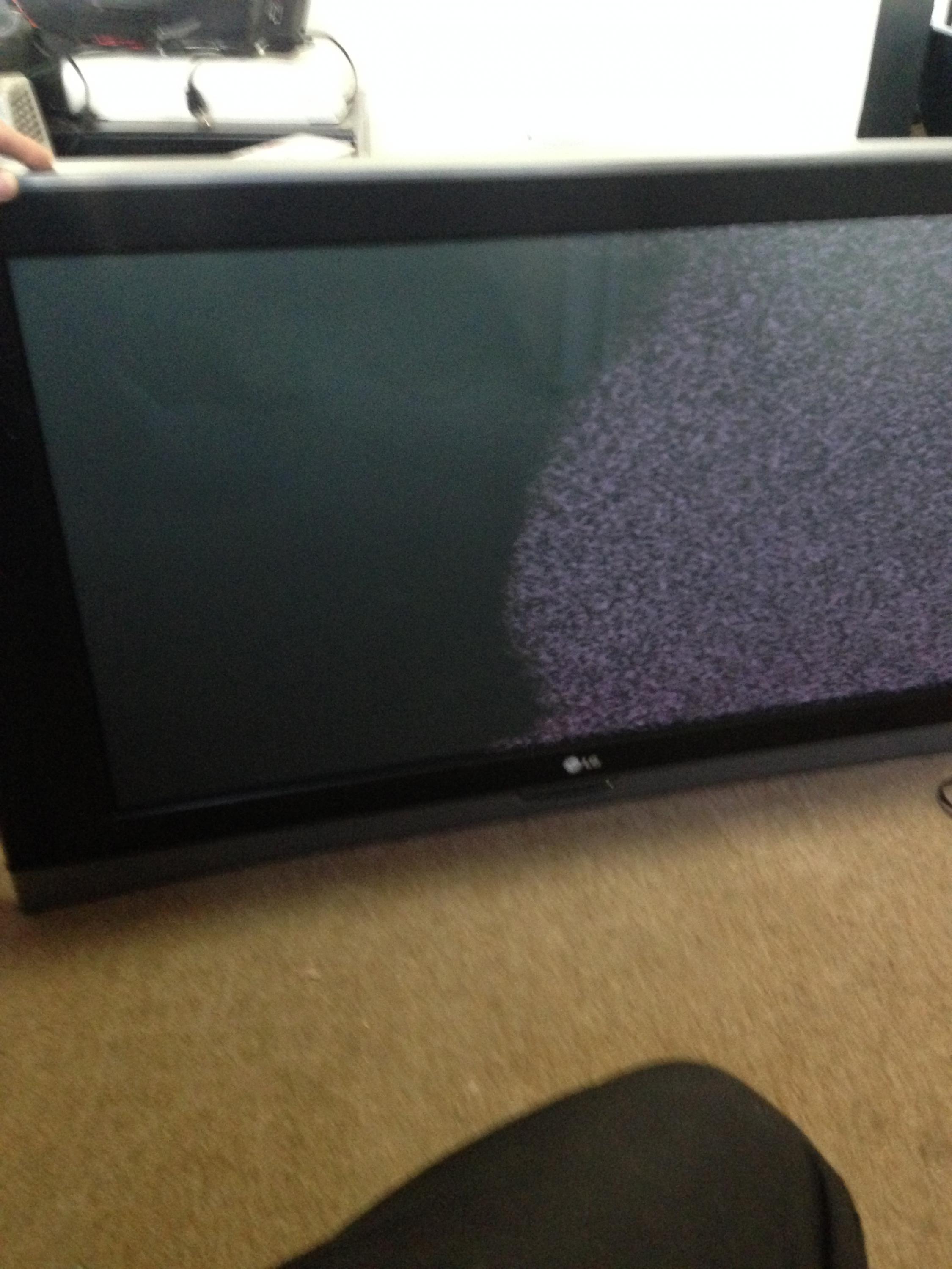

    LG 42PC3DVA Left Side of screen is black
    I have a LG 42PC3DVA that the left side of the screen is black, no blown caps anywhere
  • kmoonen
    • Dec 2011
    • 61
    Re: LG 42PC3DVA Left Side of screen is black
    Looks like it gets a bit better as the tv runs?
      99% it's a Z-sustain problem.
      Probably IPM failure on this model.
