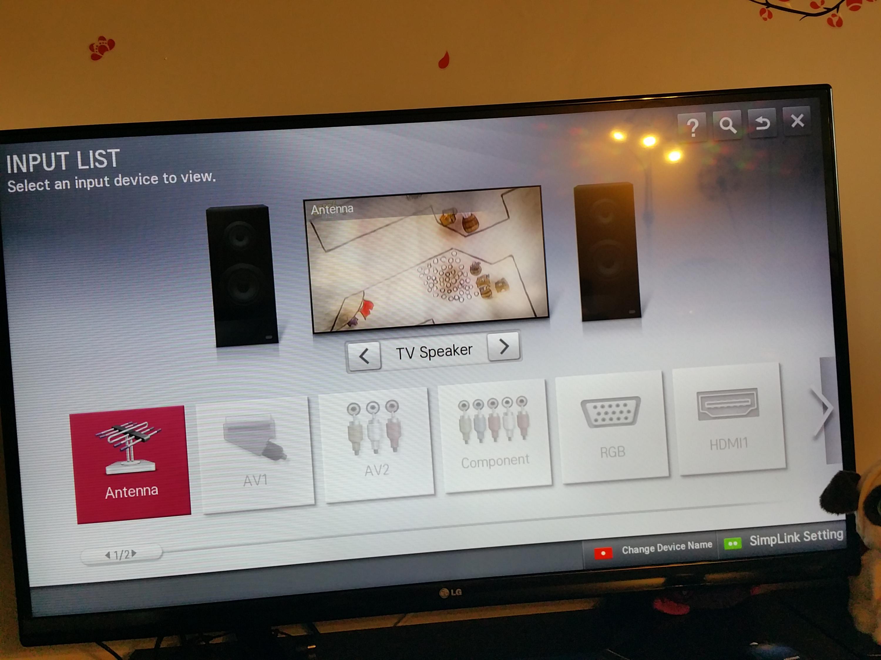

    Hi all
    Got a LG 47LM640T 3D Smart LED TV that's got thin equidistant horizontal black lines covering the full screen. The picture underneath the lines is fine. Its just over a year old and just out of warranty (typical). I'm thinking faulty T-Con board. Any thoughts ?

    Re: LG 47LM640T 3D Smart LED TV thin horizontal lines
    Might help you if you post some pictures of the fault

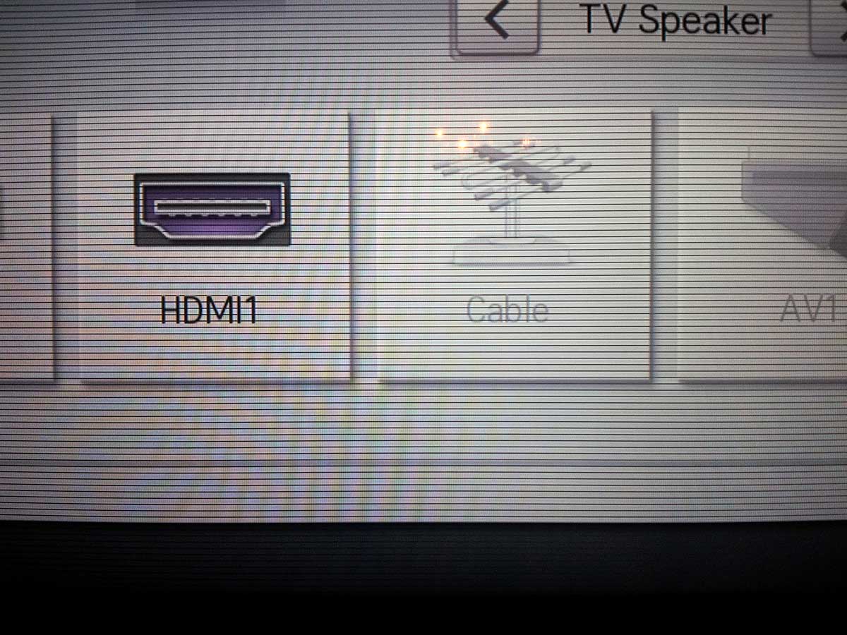

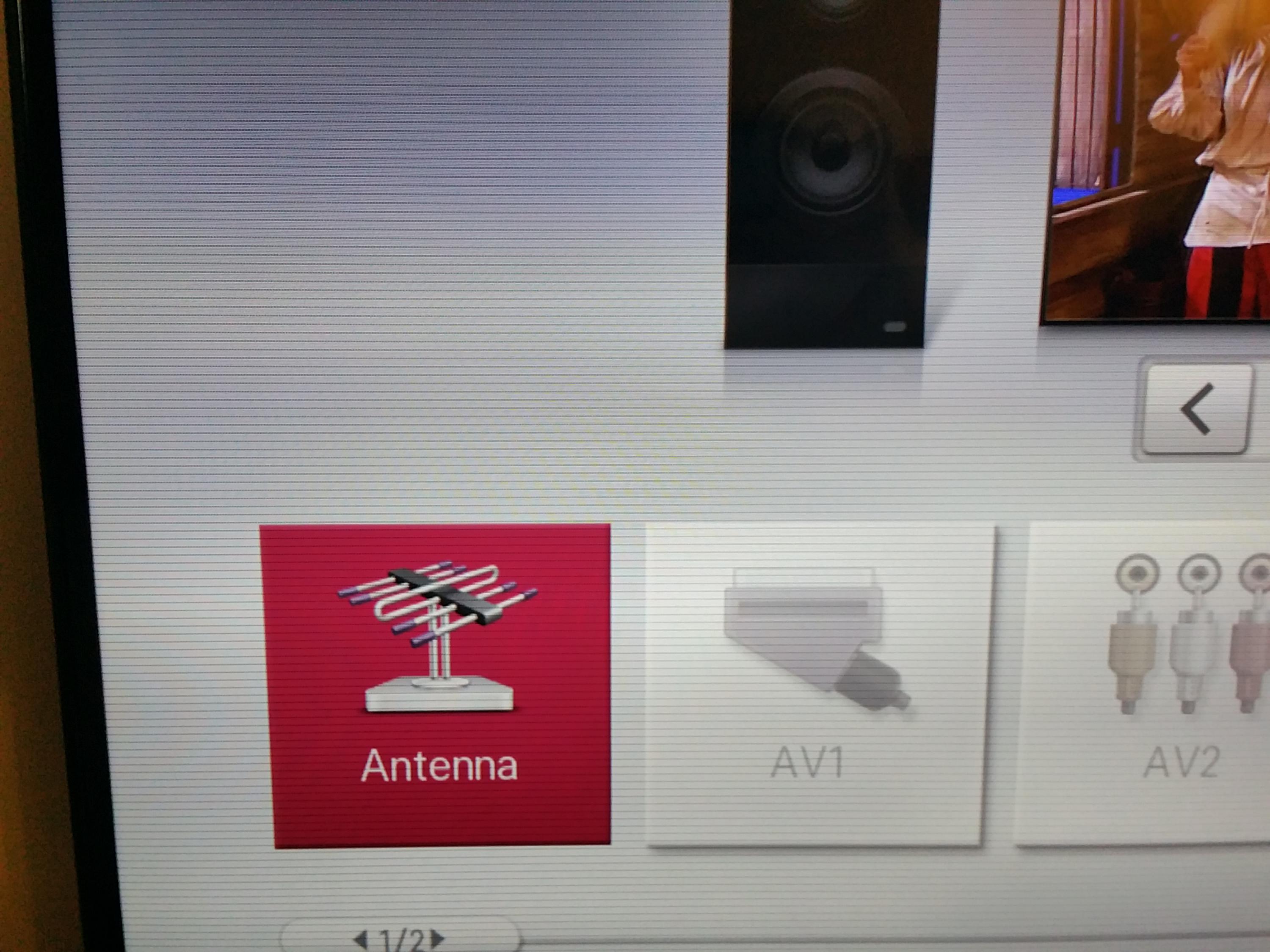

      hello
      I've attached a photo of the screen as requested. I'm presuming this particular TV has the T-Con integrated onto the main board as it doesn't have a separate T-Con board that I could see. Any ideas ?

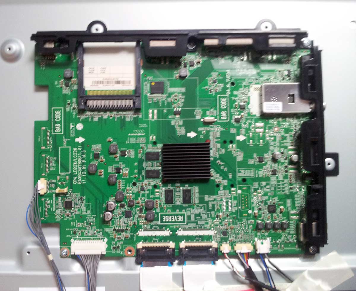

        Photo of Main board attached !
            Either a main board or panel failure. I would be more susceptible to say mainboard because the lines are too spaced apart to be panel in my opinion. But could be wrong. Take a pic of the full screen so we can.see what it looks like
              Have a look at my thread I just posted with 2 LG TV's. Dont be so quick to suspect the main board. Along the bottom of the unit is 2 PCB under the metal case directly along the bottom of the panel which seem to break down and cause this issue. If any fluid dripped down the screen from cleaning would cause this. Sadly the ribbons are glued onto the board meaning you are unable to replace.
                        Its frustrating because the person who made the thread never BOTHERED to update us. I would say your mainboard is faulty here as well.
                          Try heating your mainboard with a hair dryer see if the problem clears.
                                Hi. Back with the problem. I heated first the mainboard . No effect at all. I ordered another main board and just replaced it , didn't cured the problem. What is left are the 2 pcb s under the screen which are kind of irreplaceable because are together with the screen. They've got though some small resistors Capacitors and diods I think. Any chance someone can have a play on them? Or is just waste of time. Would any magnetic field from a external hdd affect them? I had my external drive under the tv for few hours.
                                  I Have a LG Model 55LM640S-ZA
                                  I have same problem it just started last night. same as the photos here but my lines are more on the right side and fade out across the screen towards the left side.
