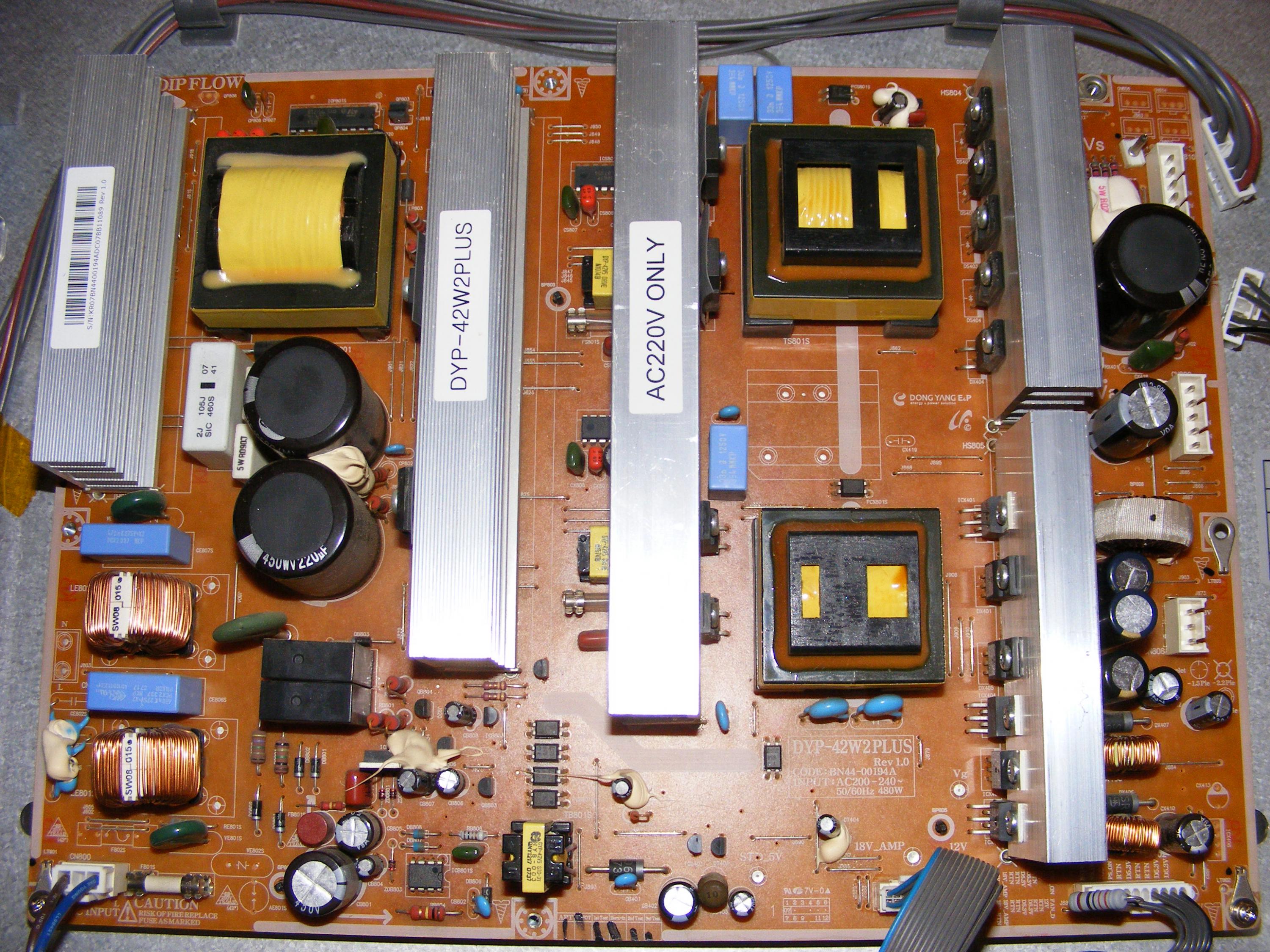

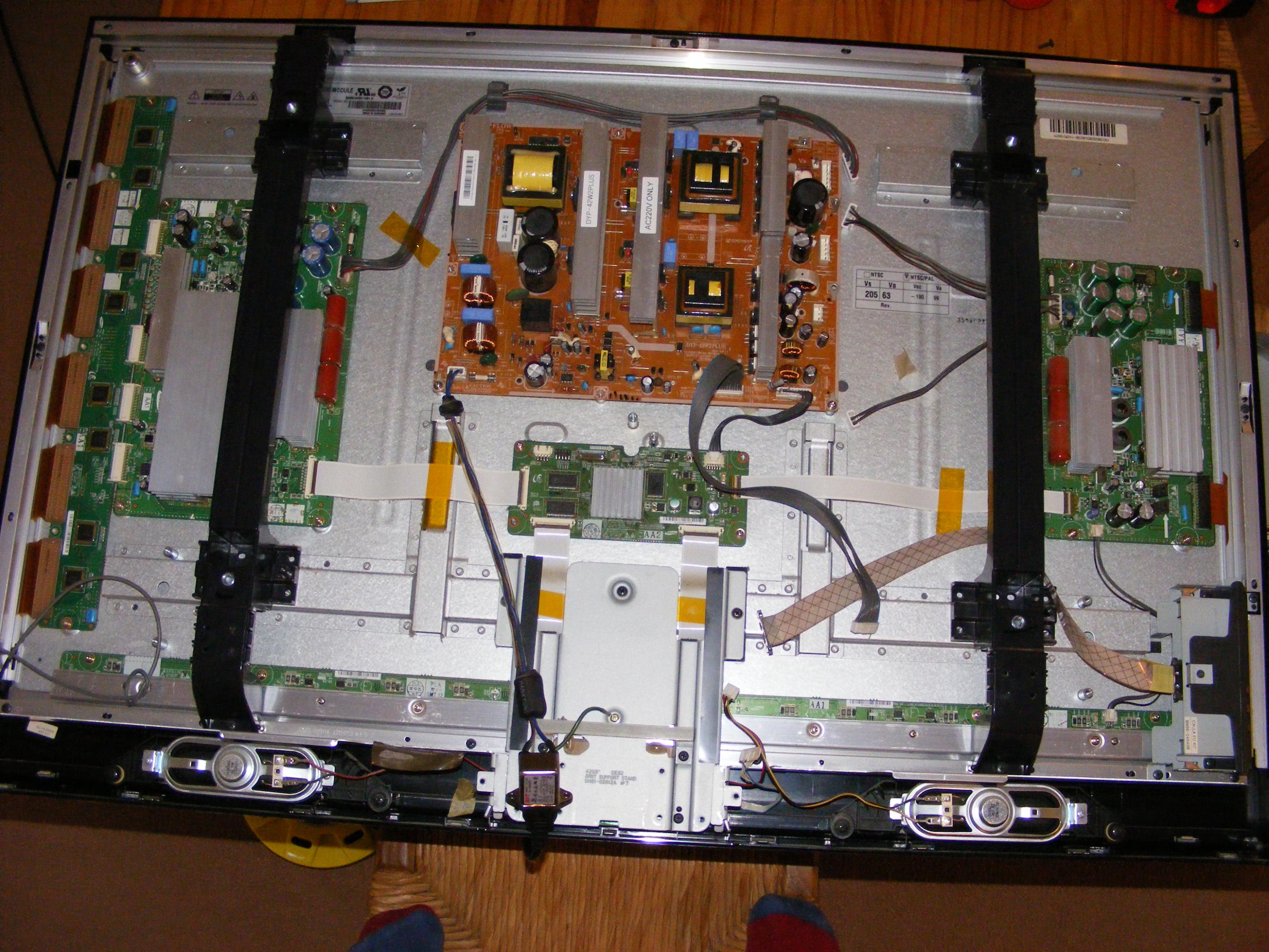

    Hi!
    This TV also had the dubious honour of being the subject of the worst soldering job ever thread, but I thought I'd start another thread for some troubleshooting I need to do unrelated to the shocking repair job discussed in that topic.

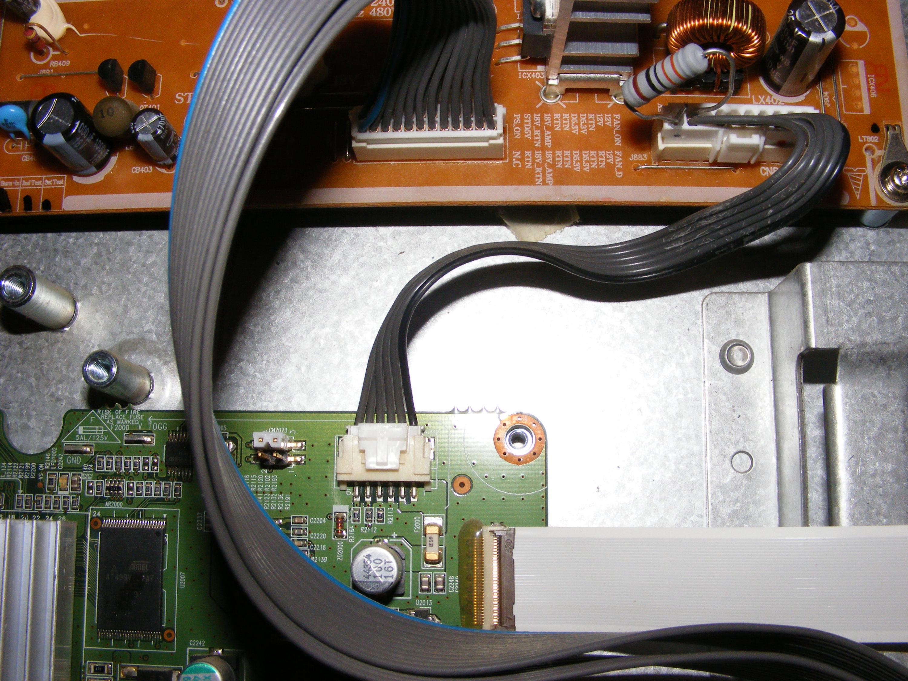

    I've got the PSU working when isolated. Jumpering ps_on and with a resistor between std5v and vs_on I get correct voltages including Vs at 205V.
    With everything connected, everything fires up except Vs which stays at 0V, and vs_on which also remains at 0V through the whole start-up sequence. This happens also with any combination of X-main and Y-main connected/disconnected.
    I've removed the main AV board and jumpered the logic board for test patterns. Is it supposed to give the vs_on signal itself in this state? Either way I have tried it with forcing vs_on with the resistor and without. With logic board connected without forcing it, vs_on remains at 0V. With forcing it, it briefly rises to about 1.7V and then drops to 0.7V and Vs spikes to 100V or so and then gradually drops down.
    The two LEDs on the logic board light up and stay constantly lit.
    My guess is I need a new logic board. What are your thoughts?

    Vs on will rise only if pson is grounded and the connector between logic and power board is connected.

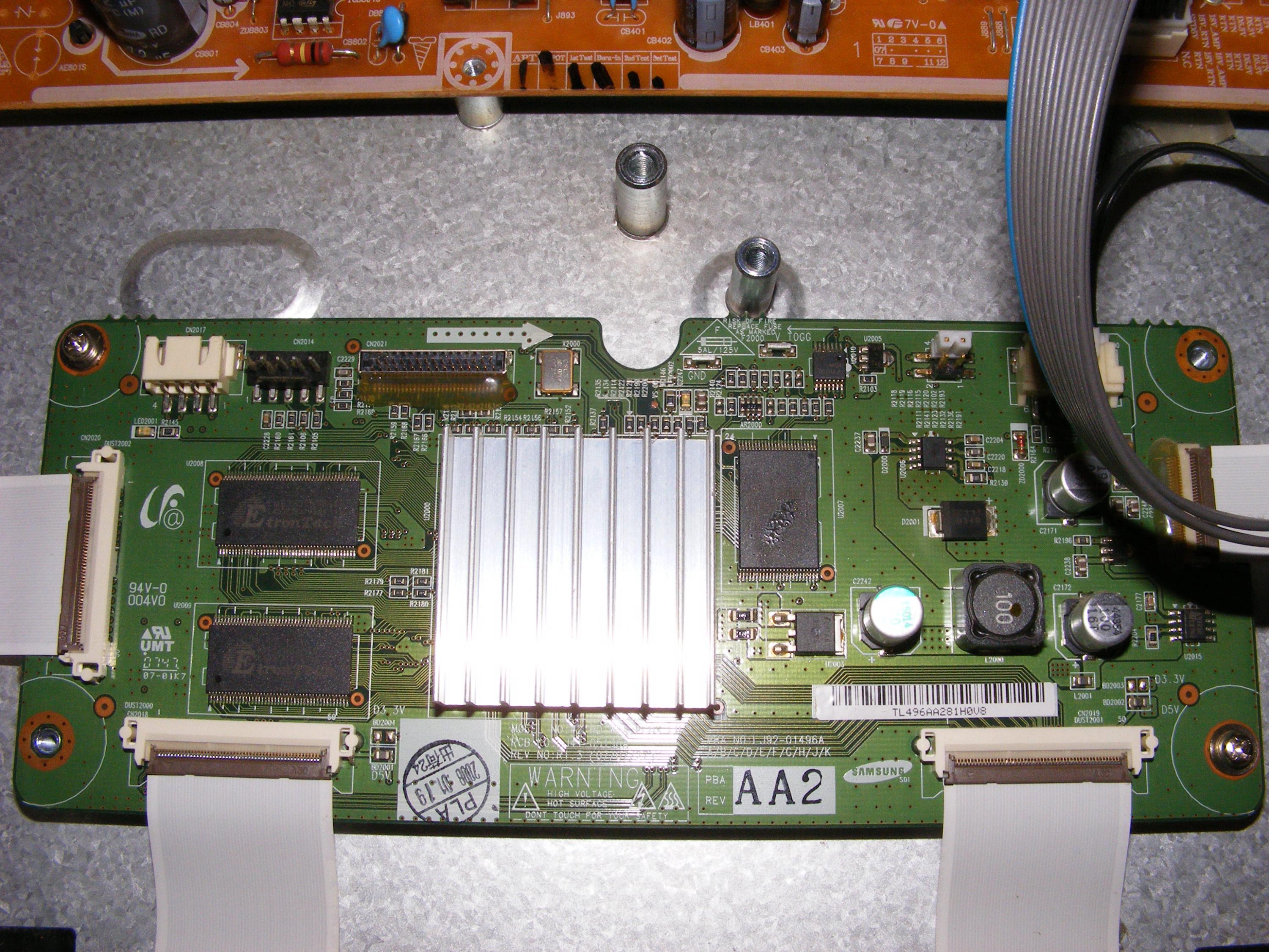

                      Tom I don't have a scope. Think I might look into getting one at some point though. Are you suggesting other 42" boards might work even with different pba numbers? Or is it the case that you can find boards with the same numbers, but configured for different screen sizes?
                      This board is LJ92-01496A. Any chance LJ92-01454A would work? There seem to be more of them about.

                            Hi Guys, just spotted this thread and thought i would let you all know what the problem is, this ctrl board commonly fails after the "Badcaps" in the power supply go bad, the noise on the data lines/supplies causes the 48pin tsop flash chip to become corrupted, it either gives a blank screen as no VS-on from ctrl board or you can get partly blank screen with digital noise. i keep programmed flash chips in stock for this model and the 42in Q96,C97,C96, should anyone need one just pm me.

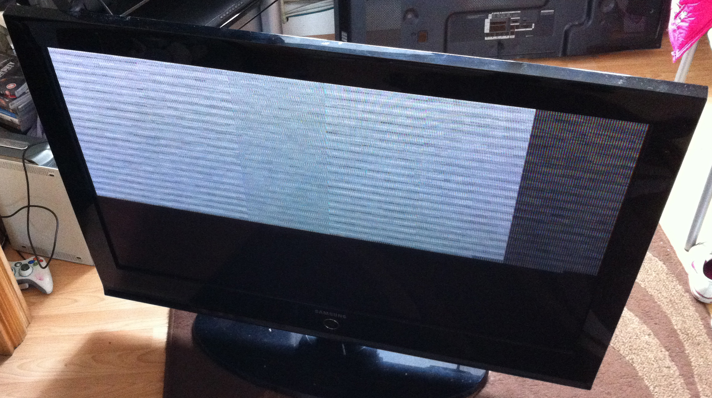

                              Hi I've replaced alot of Capacitors on power Supply board
                              now have all the voltages on the board
                              but have 2 vertical bars displayed on a black screen ending at the middle of vertical height.
                              is possible is teh logic LS92-01496A ?'
                              thanks for a reply
                              AB

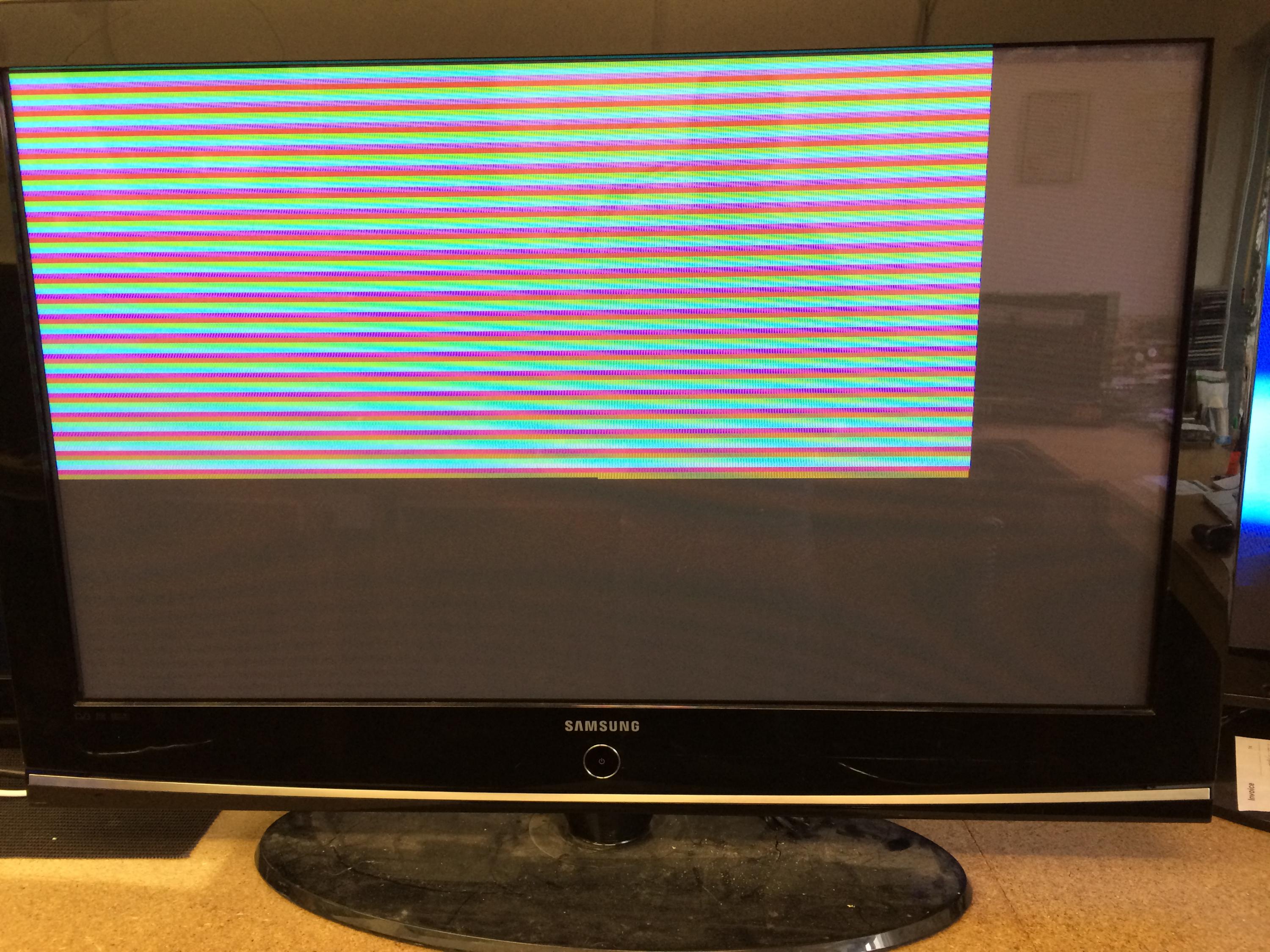

                                  fault symptoms can vary from blank screen with no Vs-on to something like the image in the attached photos when you have very low Vs-on.
                                  replacing just the flash chip on the control board will cure it.
                                  a new programmed chip is available here if anyone ever needs one.
