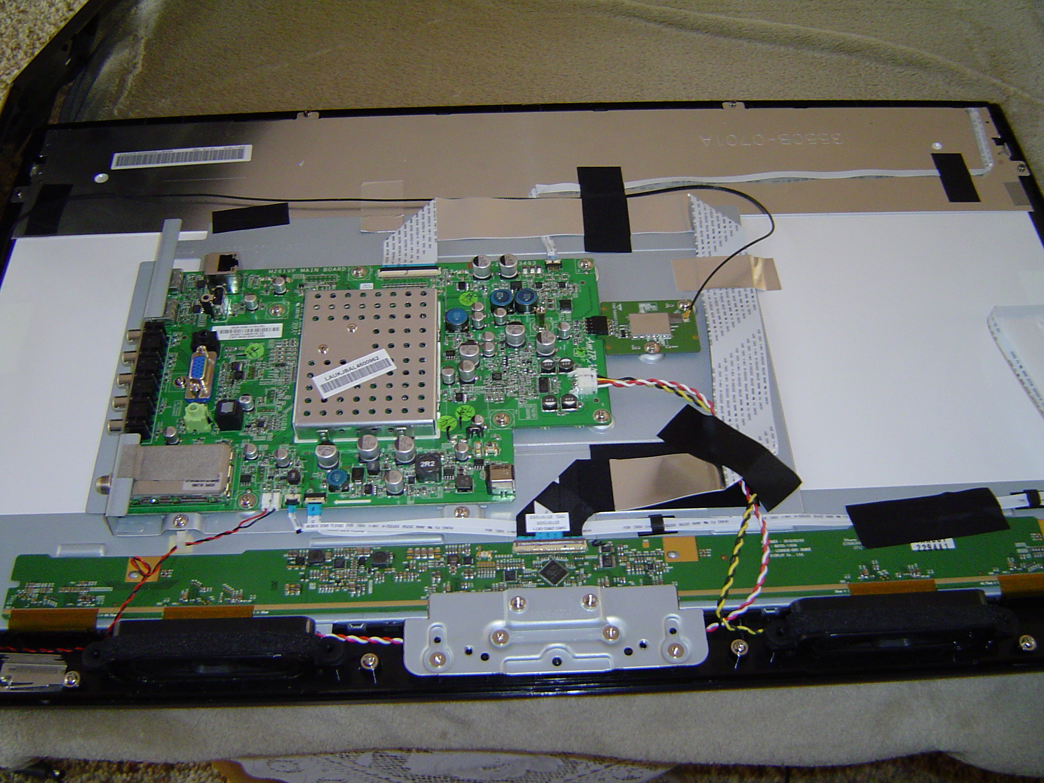

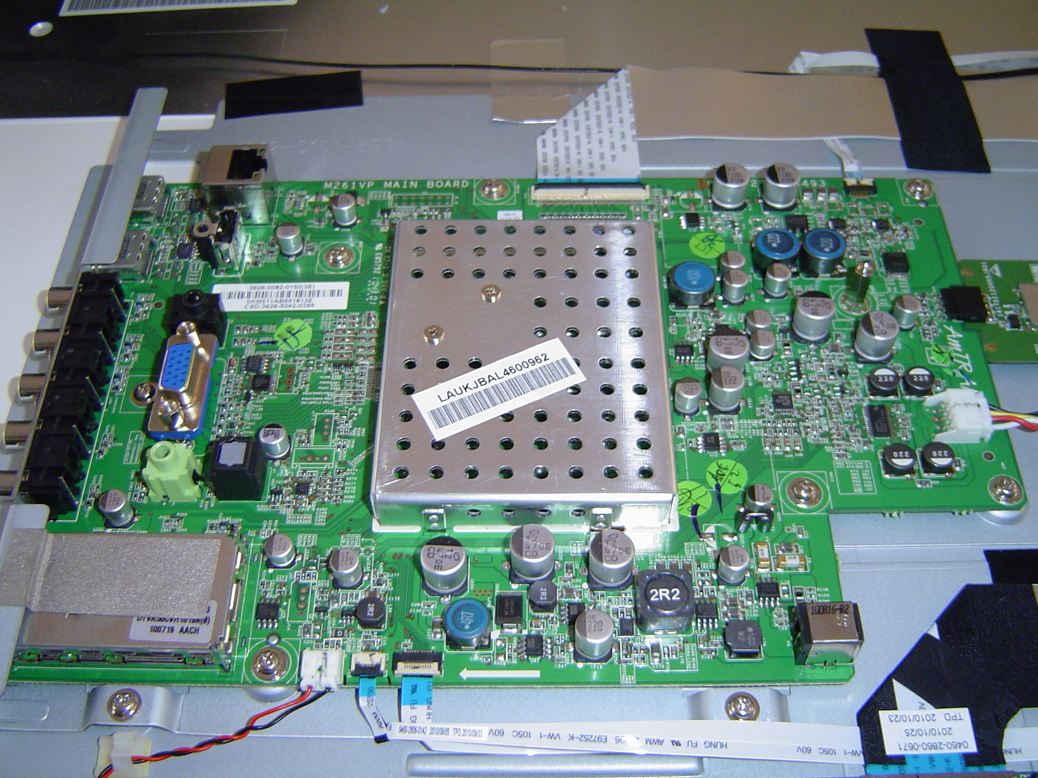

    I have a Vizio M261VP 26" LED/LCD HDTV that will turn on/off and has sound but no video. The LED backlight lights bright and then dims to about half the brightness after 5-10 seconds. There is no video and I can not see the menu when selected.
    The TV is powered from a 19Vdc AC/DC Adapter that checks ok.

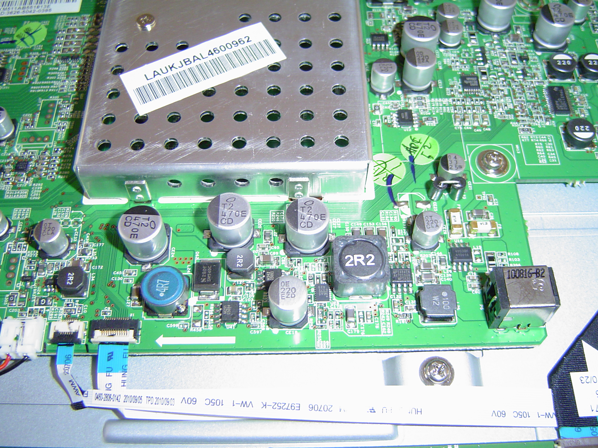

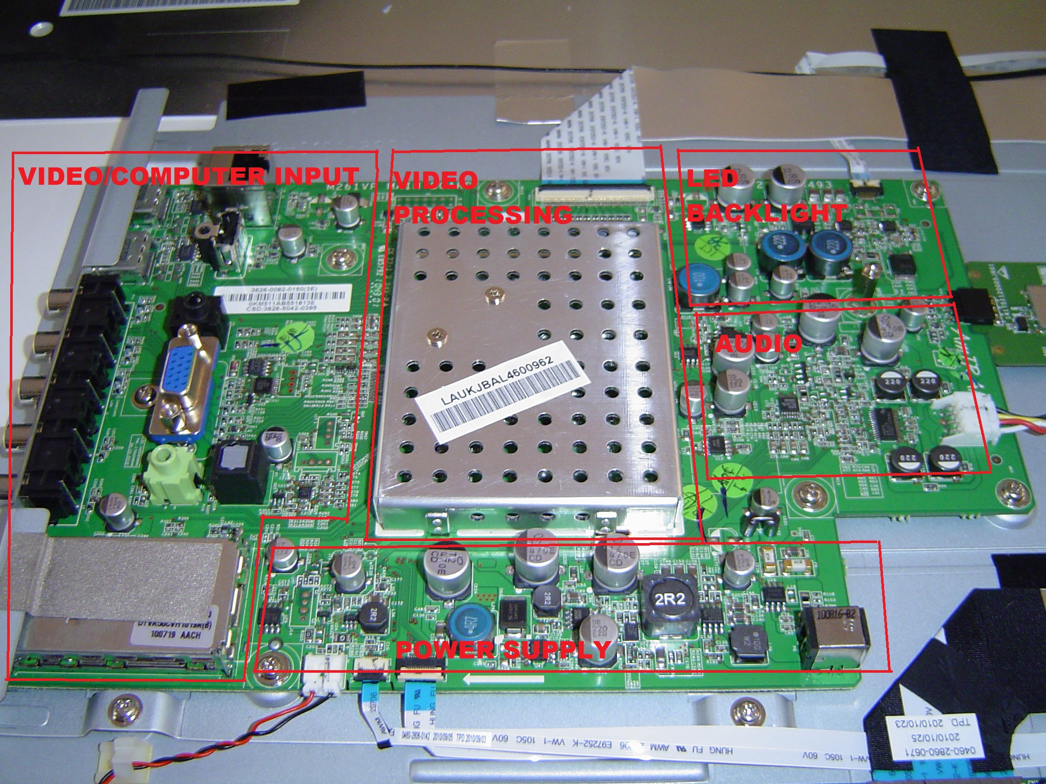

    There are basically only 2 boards in this tv. See attached pictures. The main board part number is 3626-0082-0150(3E)). It contains all power supply circuitry (including for the LED Backlight), audio circuits, video circuits, and all external input ports. The second board is the "t-con" display board. It looks like Vizio uses an LG display assembly part number 6870S-1103A. The "t-con" display board seems to be and integral part of the LG display assembly. There is also a small wireless daughter board for wireless connection to a network.
    I checked the 3 obvious fuses, and I have checked the voltages at various points on the main board/display board and they appear to be normal. I looked for swollen caps and any other damage, but everything looks ok.

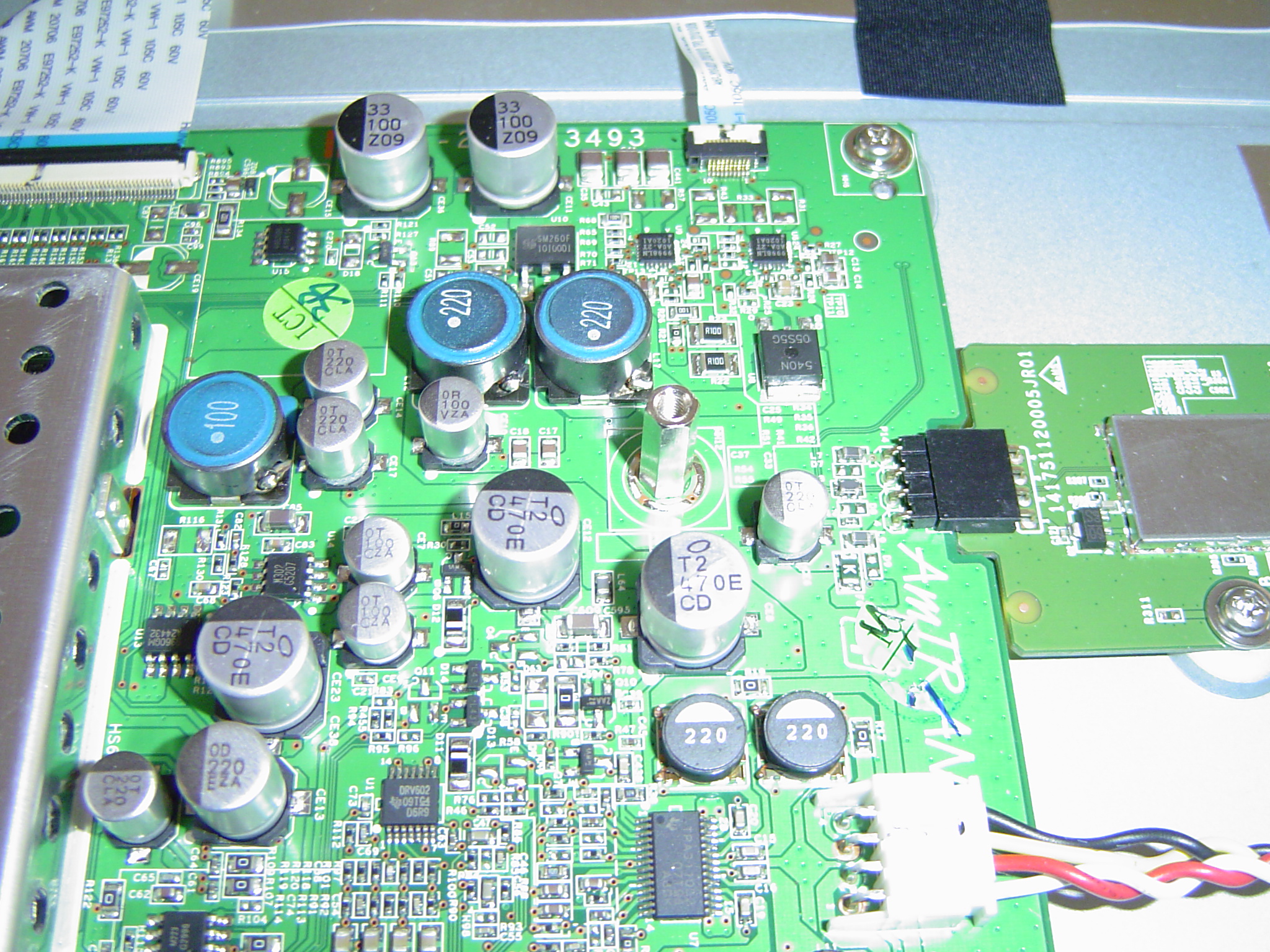

    There is a 10 pin ribbon cable on the upper right of the main board that connects to the upper right of the LCD. I think this is the LED backlight cable. Voltages in the upper right area are around 108Vdc on the Power MOFET and Schottky Diode. Should I assume the backlight is ok since it turns on with the power? Is the dimming normal after 10 seconds?
    From the symptoms is there any clue where the problem may be i.e. main board or t-con display board? Is there any test that can isolate it to which board has the problem and where on the board to look?
    Any help on where to go from here would be appreciated.

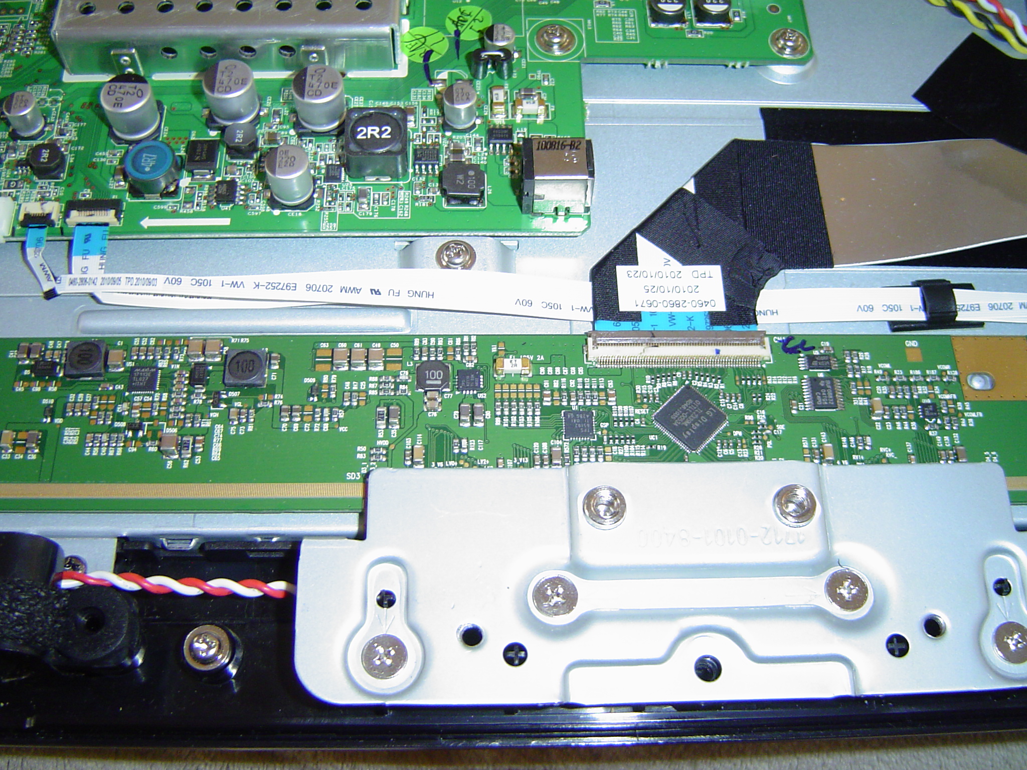

        Thought I would post update on diagnosing no video on M261VP. Since audio and other functionality of the main board seem to be working ok I decided to focus my attention on the T-con board. The T-con board is getting the 12Vdc source voltage ok from the main board. The board has additional power supply components to get the proper voltages to drive the LCD display. 2 chips appear to be doing most of the power conversion the first is a TPS62110 17-V, 1.5-A, SYNCHRONOUS STEP-DOWN CONVERTER and the second is a Maxim 17113E (US1) Low-Cost, Multiple-Output Power Supply for LCD TVs. I checked the voltages on the TPS62110 (US2) and found that the output is zero. I was not sure why so I decided to do a diode check on the various diodes in the circuit. One Schottky Diode marked B340A (D4) connected to the input of the maxim chip measured zero ohms in both directions indicating a short. I guess this is a typical failure mode for Schottky diodes. Not sure whether the shorted diode is causing the 0 volts output on the TPS62110. I will replace the diode and see if the voltage returns to the correct levels. I will provide updates once I have replaced the diode.
        • jimg1948
          • Mar 2014
          • 23
          Re: Vizio M261VP Powers On Has Sound But No Video
          I thought I would post a progress update on diagnosing no video problem in case anyone has the same problem in the future. I removed what I thought was a shorted Schottky diode from the video display board power supply. To my surprise The short was still in the circuit. the diode checked ok. So after more diagnoses I determined bypass capacitor C71 on the display board (t-con) was causing the problem. Removed the capacitor from the circuit and the short disappeared. Reassembled the set without the bypass capacitor and I now get video. The video however is flickering and producing some black horizontal lines. The missing capacitor may be causing to much ripple in the power supply or there may be another problem yet to be discovered.
