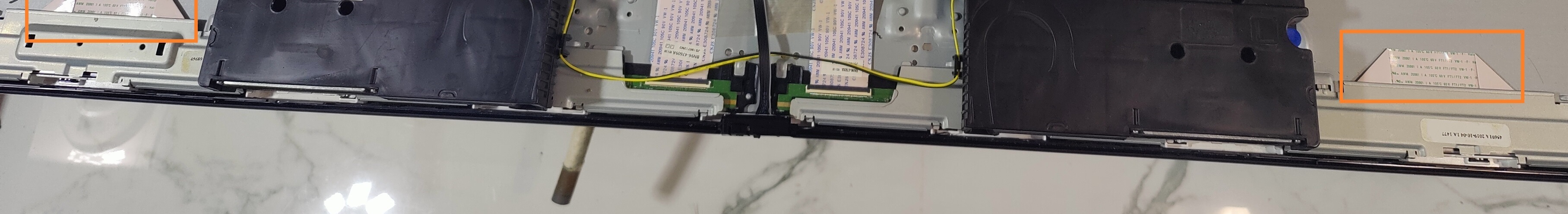

                    #29
                    man yours set 76... on each side of the panel edge buffer boards which are under the speaker you will have U ribbon cable.,,, disconnect one a time see if u have boot complete

                          Diah I already did, post #25 and 26#

                            #33
                            no you didn't... U ribbon see them here have access to them and disconnect one a time

                              #34
                              Yes, I already did it

                                #35
                                post #25 and #26
