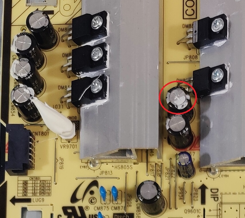

          blown cap !
          • lotas
            • Jan 2016
            • 4589
            • Russia
            No, it's the thermal paste that got in...
            • Diah
              • Feb 2013
              • 6363
              lol my eyes still strong... the cap in red circular are in question,, no pasta on it
              • lotas
                • Jan 2016
                • 4589
                • Russia
                Yes, just like the others...
                This is when thermal paste was applied to the transistors, those that are attached to the radiators, and the capacitors were stained with it.
                • Diah
                  • Feb 2013
                  • 6363
                  let say you are correct... then why they put thermal paste on them... its unusual at Samsung.... mean this caps are under load and heat.
                  • nomoresonys
                    • Jan 2013
                    • 12151
                    • U.S.
                    Looks like someone was just a slob and wiped the excess paste all over everything.
                    • nomoresonys
                      • Jan 2013
                      • 12151
                      • U.S.
                      Ok, so lets follow suggestions, isn't that why you come? Do as suggested in post # 4, report results here.

                        • alfredomfr1
                          • Oct 2014
                          • 318
                          • usa
                          No, is a light effect, cap is ok
                          • R_J
                            • Jun 2012
                            • 9535
                            That is NOT the caps I am talking about
