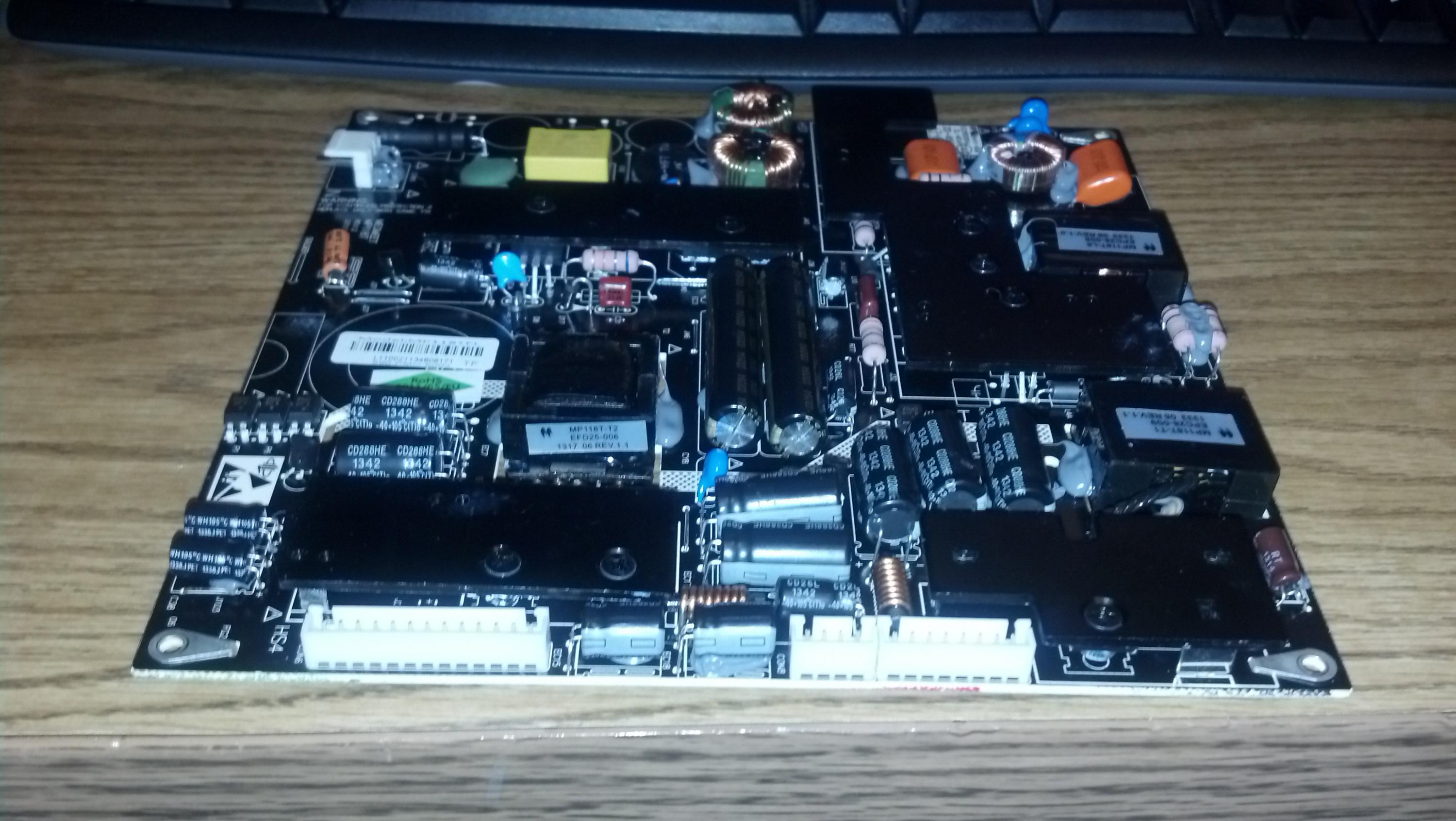

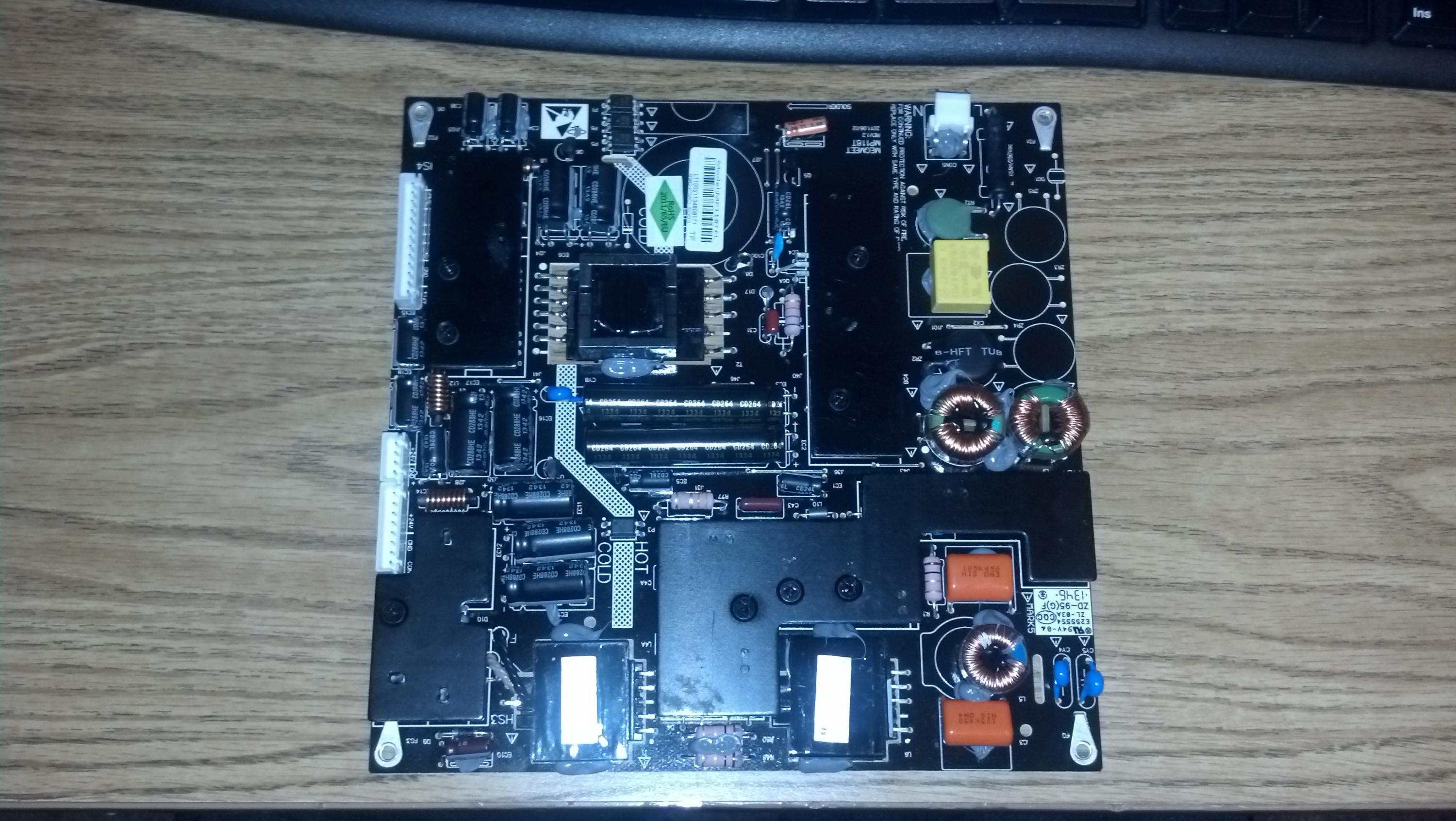

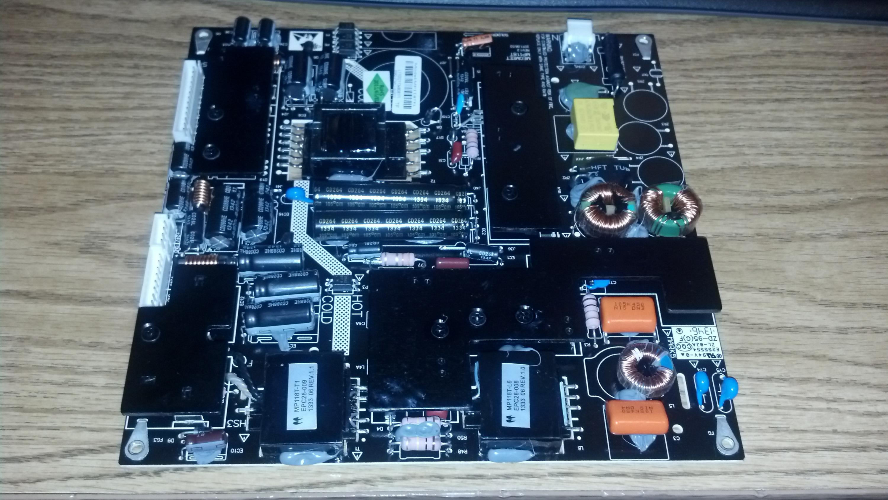

    Need to order a few caps. Those long skinny caps are a value I haven't seen before. They are 47uF 500V. Never seen 500V caps before in a SMPS. These are Chang CD264 series. I'm guessing 450V caps would be a suitable replacement? (http://www.digikey.com/product-detai...421-ND/2618956) or (http://www.digikey.com/product-detai...82-ND/31343380)
    All the caps on the PSU are Chang except for a CapXon, and two 220uF 16V Aishi WH caps, which I plan on replacing with nichicon PW.

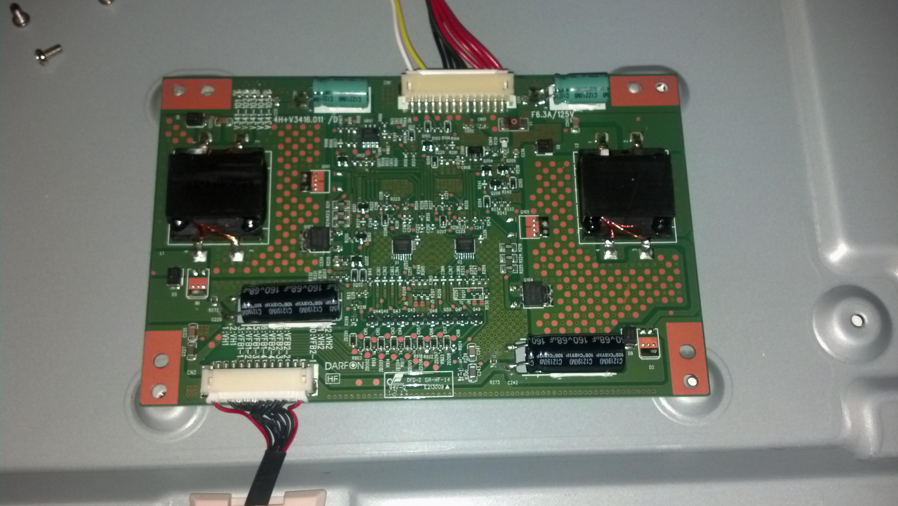

    The (what I think is) the LED inverter board has Taicon, so I was planning on leaving those.

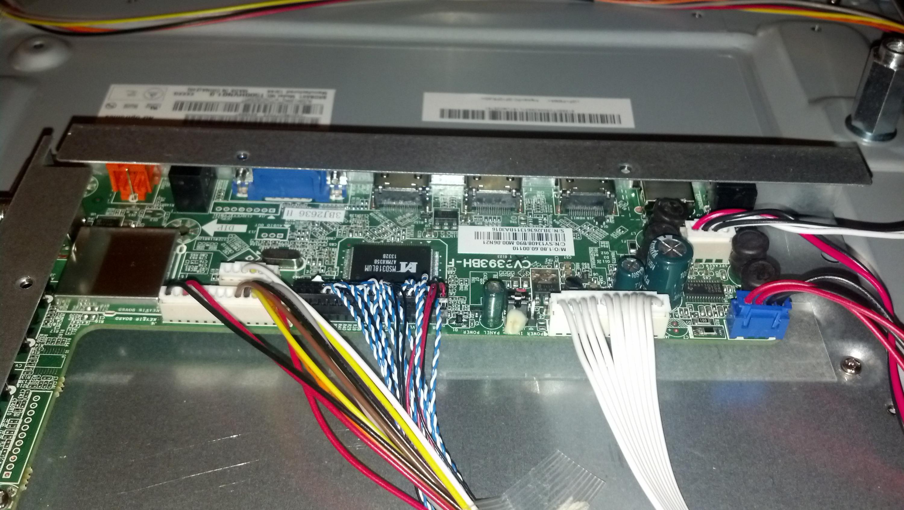

    The mainboard has two xunda caps and a SW cap. I was going to replace these with low ESR caps, or is it not even worth replacing caps on the main board? I want the set to last a long time

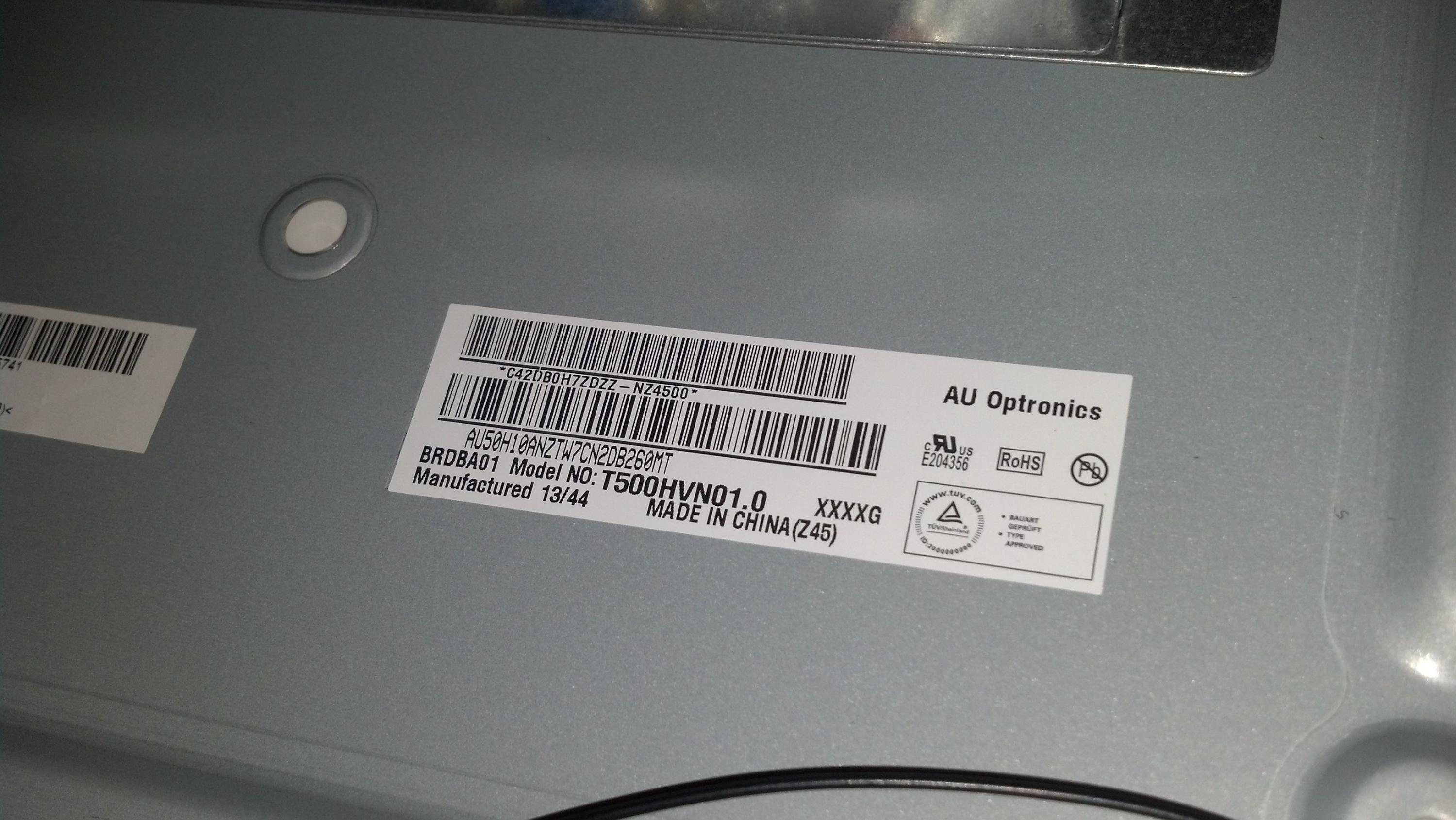

    I uploaded a picture of the panel info so tom can tell me if it's decent or not

    47uF 450V should do it....
    Are they faulty? Blanket-bombing of caps randomly, often fails to sort any problems--especially with a fairly recent set....

      If its not broke don't fix it.
        Re: Westinghouse 50" LED Cap replacements (EU50F2G1)
        Haha, AUO panels are half decent, they at least don't die as much as Samsung panels do.

          Yeah but these are Chang caps with no actual series...They're horrible and who knows when they will pop, I don't trust them!
