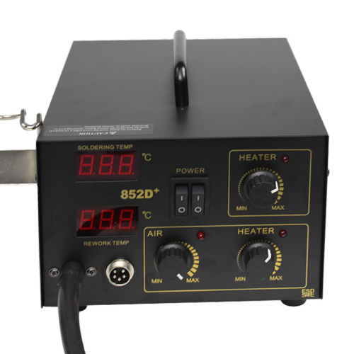

          thanks i wont use flat tv as had rubbish ysus from them befor lol what temp should i set my new toy too to remove the chip ? if i mess it up no lose need to start someware lol
            Re: lg ps8000 vertical lines
            Wrap board in foil, aside from the chip in question.
            Use 350°C moderate air.
            Circle around device and push GENTLY on one edge slowly to remove it.
            Clean pads with flux cleaner (or isopropanyl 90% or greater)
            If all pads are intact I would hand solder chip on.

                          thanks tom ive just got the lot from ebay now just goto wait as the new staion packed up after i removed the first chip got error

                            That is about the level of quality expected from a hot air and soldering station with a two digit price tag...
                            I had an Aoyue968 which was probably made by the same company, nothing but problems...

                              i gues so just didnt want to spend loads as still learning and its just a hobby
                              do you know any gd but cheap ones that would be ok ? just been wacting more of your videos nice work

                                Well I can't exactly follow what I preach - my hot air cost me £40.00 but it's at least slightly upgraded chinese junk... DIGITOOL from Farnell. I bought it from a guy on eevblog forums called TopLoser, he occasionally has equipment at very, very reasonable prices.
                                For soldering I use an ANTEX 690 SD... excellent 65W element, really stable temperature -- second only really to a Metcal... RRP around £200 or approximately £0 when my boss was cleaning out the old gear .
                                For occasional work it's fine, just don't expect high reliability stuff for that low price. I got so frustrated with mine (my one before the DIGITOOL, the AOYUE 968) because after 2 years use I had:
                                - two hot air element failures, one nearly setting the gun on fire (flames were coming out of the end!)
                                - one soldering iron element failure
                                - endless problems with random display lock up, ERR, showing 530C (for temp all the time) etc.
                                - loud buzzing noise continuously when NOT in use
                                - pump vibrations randomly making entire unit shake across the desk
                                ...I paid £139 for that and it was the worst £139 I have ever spent.... NEVER AGAIN!!!

                                  ok so what should i buy lol im waiting for them to email me bk as i cant use it now

                                    As I said, if you only use the unit occasionally, that's probably adequate for you, just don't expect high reliability.
                                    If you come to depend on your tools, you're wanting to look at the £250 to £500 range, units like Hakko, which are high quality Japanese designed...
                                    But that's an awful lot of money to spend on a hobby.
