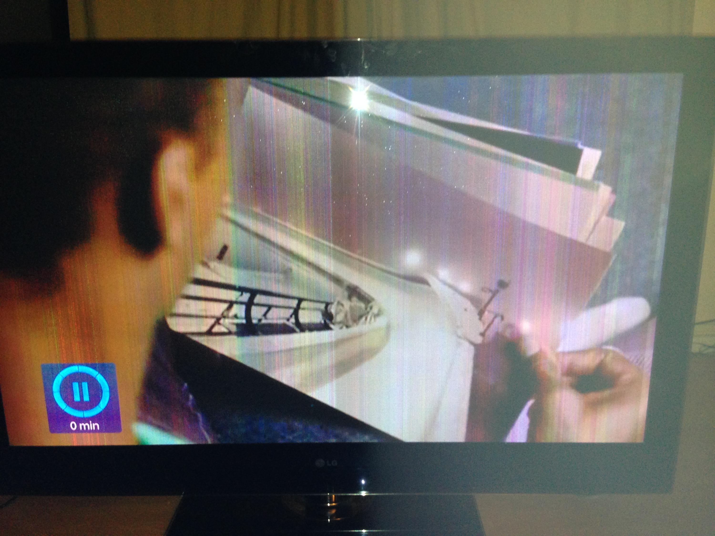

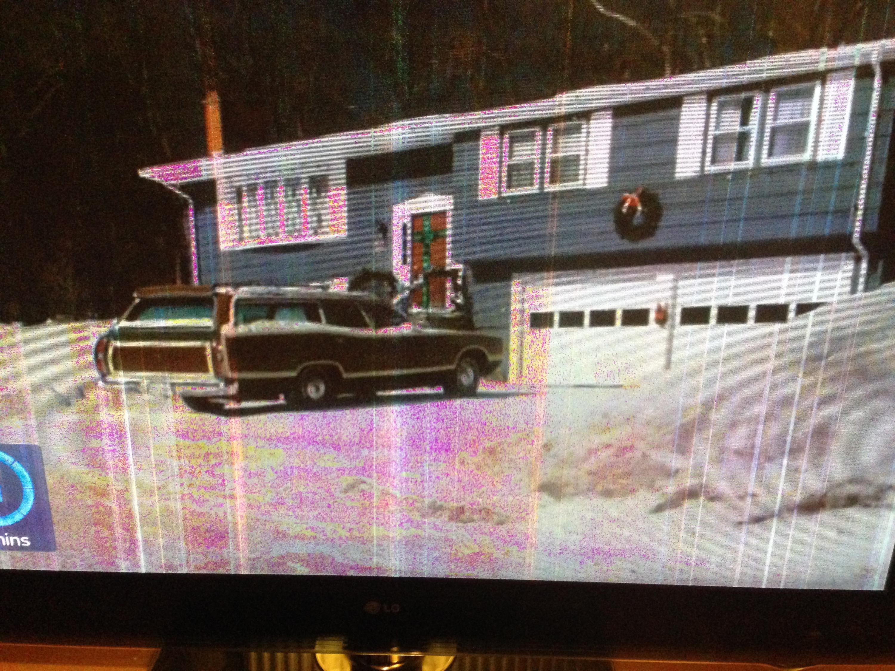

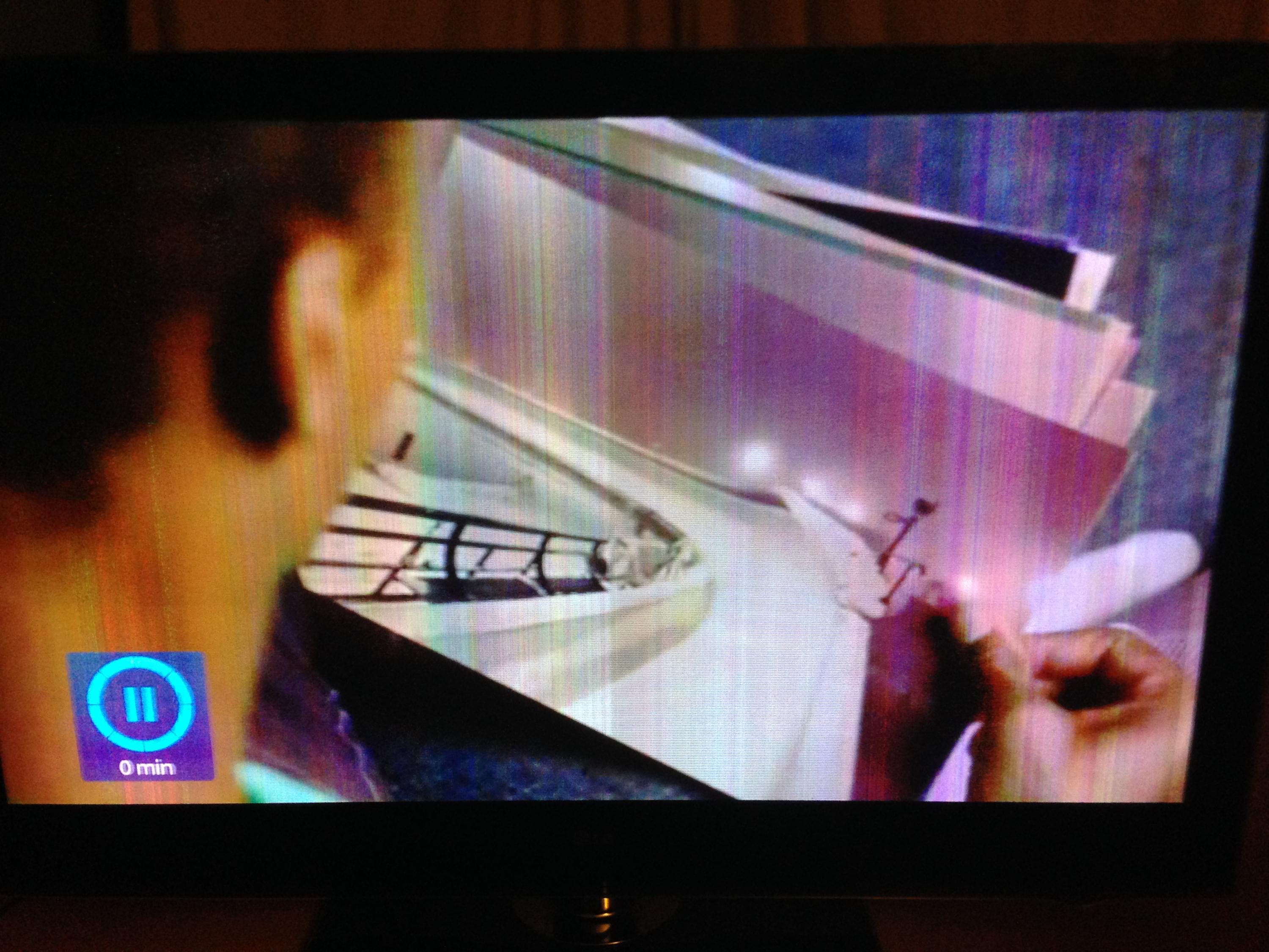

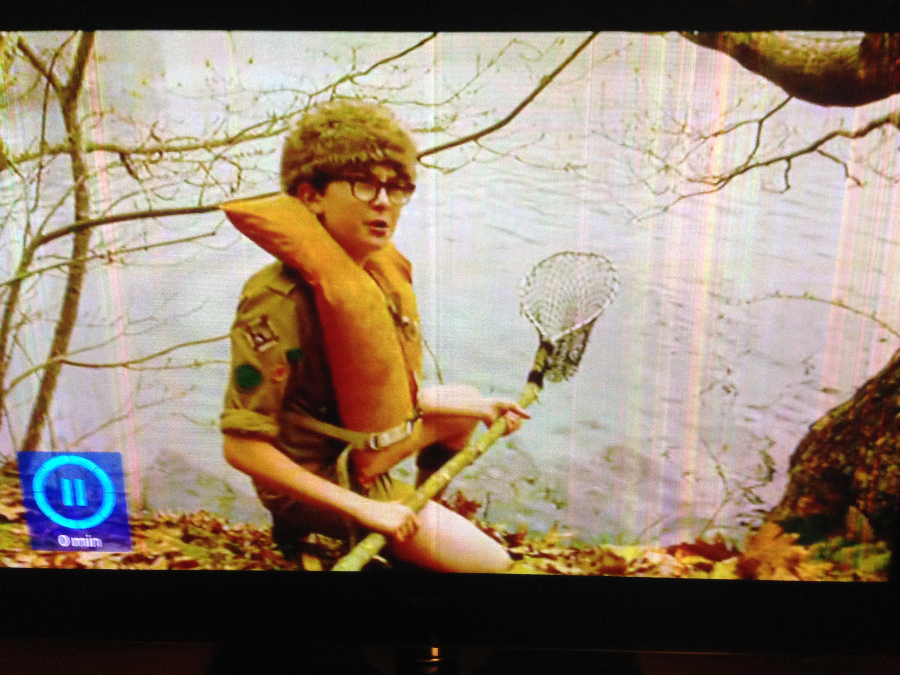

    hi guys been offerd this 60" tv lg ps8000 tv has vertical lines that move could this be fixed or do you think its the panel itself any help plz thanks again
    should also say the lines change in colour

          The lines move? Do they follow bright picture content.
          Probably not panel...
          Could be a Vsc or -Vy voltage problem, or a control board issue.

                          Looks like -Vy is increased too much. I'd jumper control board test patterns.

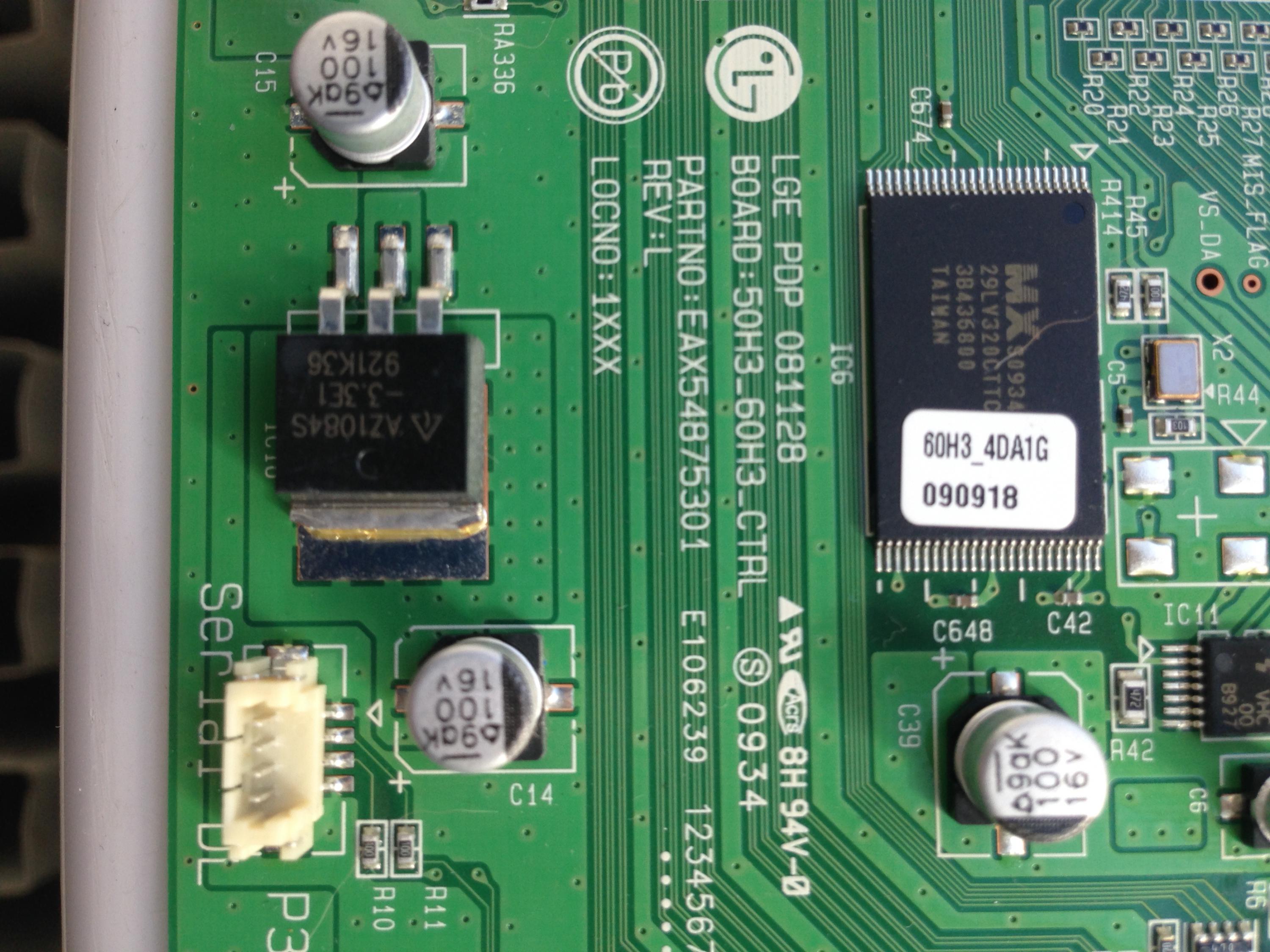

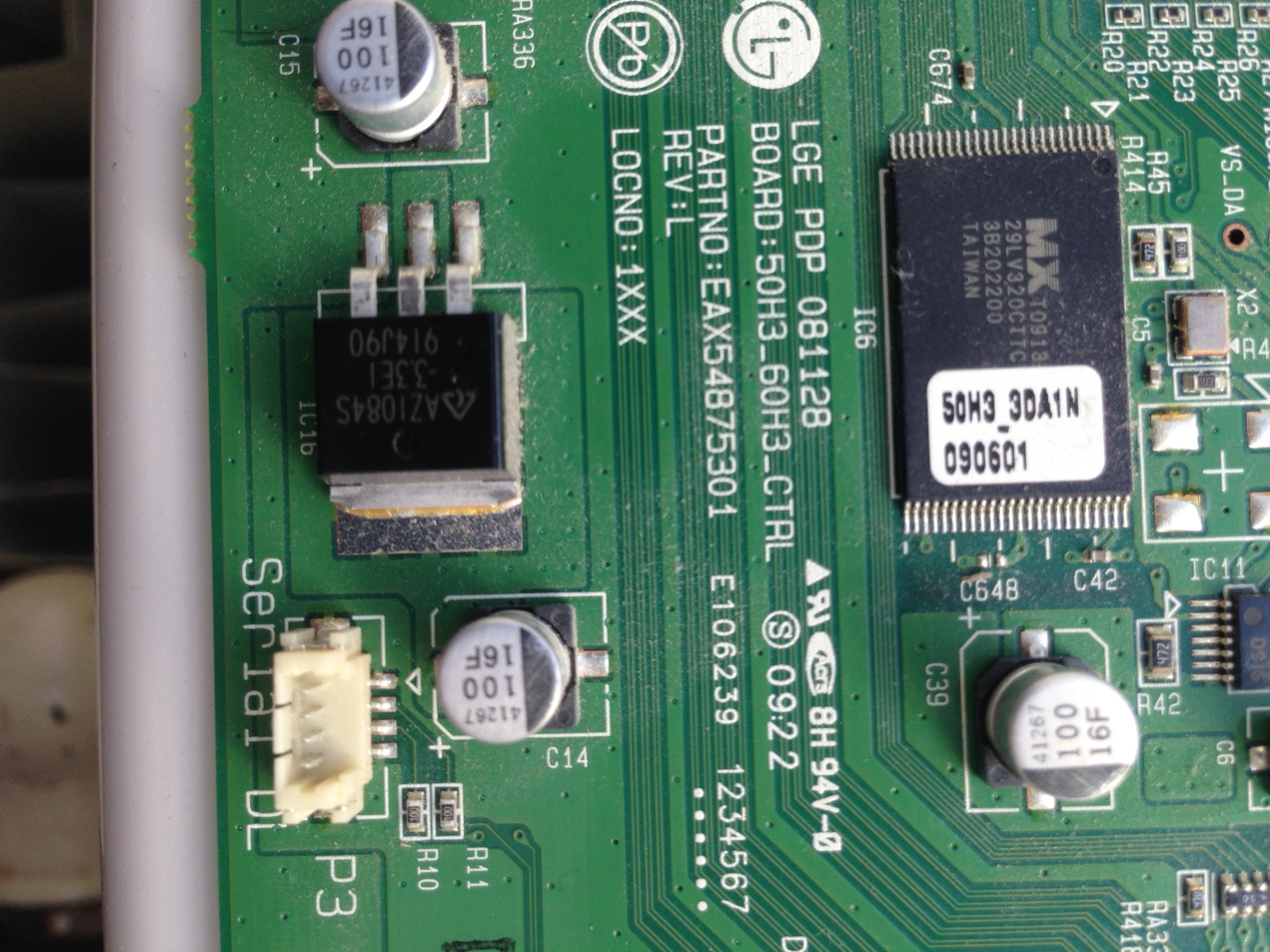

                            they was 1v some 2 v out to low do you know if my spair board ebr54863601 would fit . looked on ebay and for same model theres diffrent part numbers for the ctrl
                              Re: lg ps8000 vertical lines
                              50PS3000 is a completely different model, with a different panel, so I would say no it won't work. In general you can't put 60" CTRL in 50" TV or vice versa because the drive waveforms are bad.

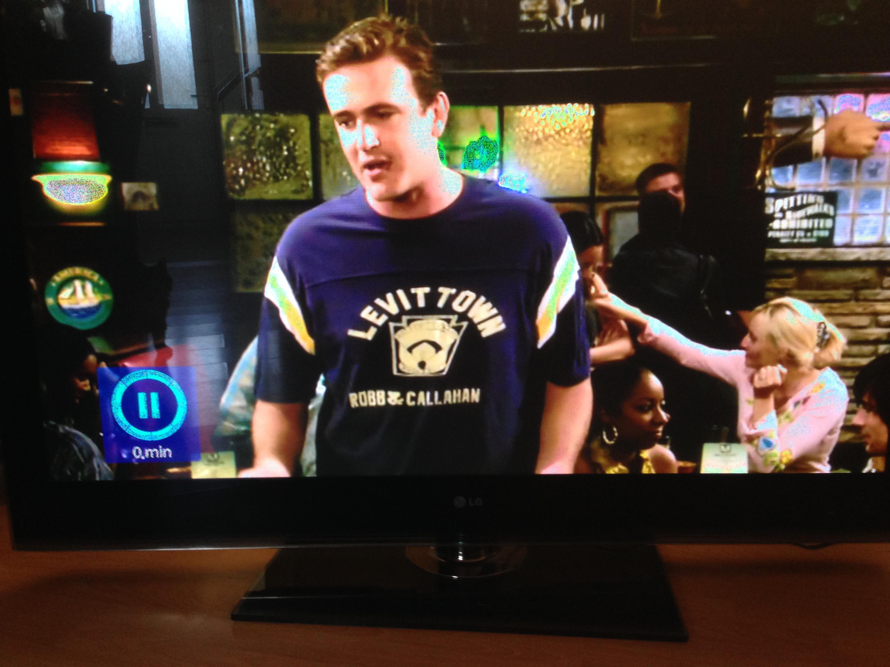

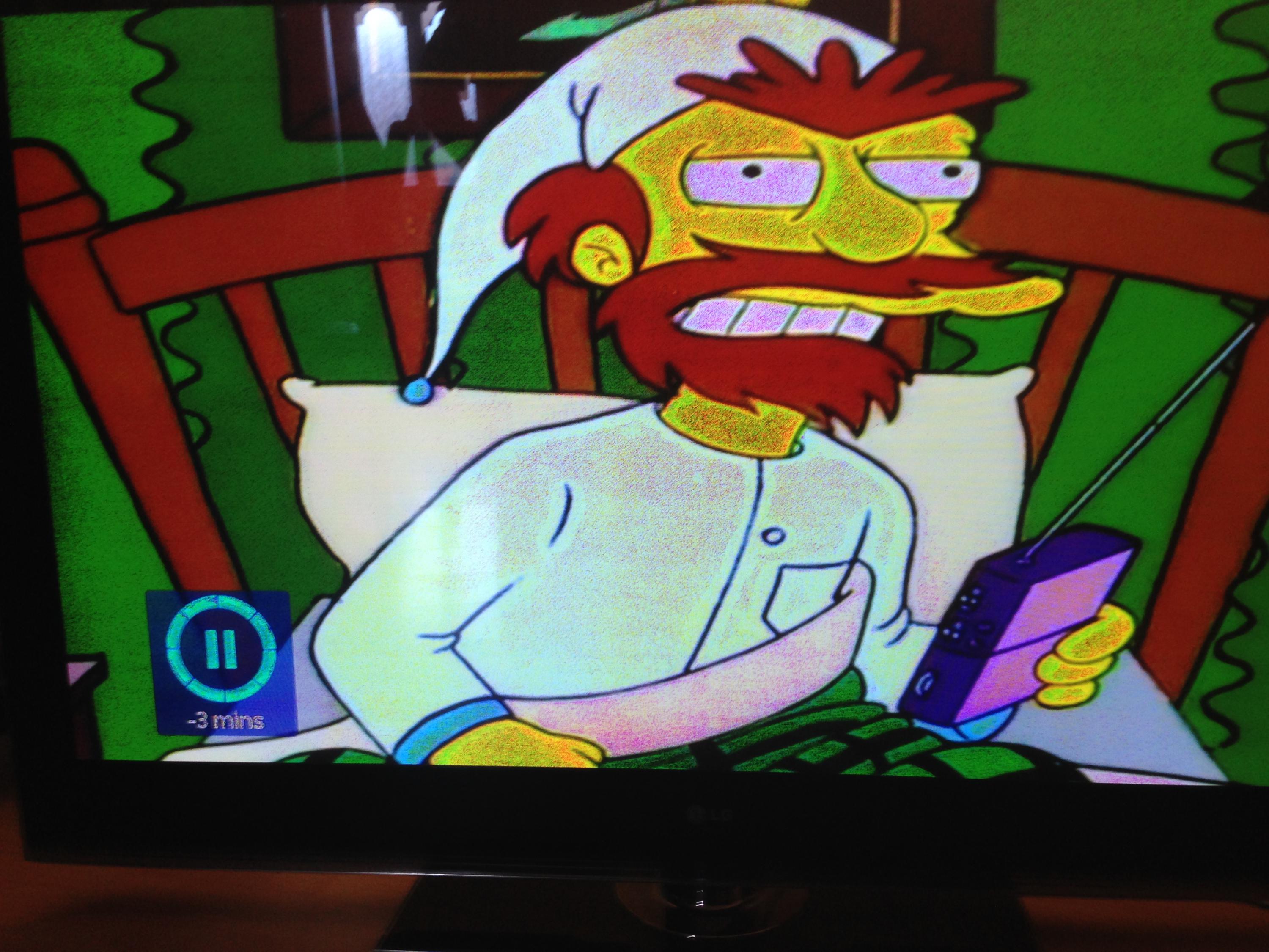

                                well checked borad with my spair and found that the board numbers match but not the sicker number the one i gave you so fitted it and gues what
                                no vertical lines looks 90% better lol done the volts checks again with info you gave now just get green/ blues on light pictures ? but cant be seen on some dark pictures

                                  Well, it could be because 50" and 60" are different panels - pic of fault?

                                    if i adjust vy and vyc i can get rid of the green/blue ? and get clear pic ?
                                    will pic up in morning as in uk times is now 104am lol will also take pic of both boards for you like i said all number on the board do match just not sticker strange

                                      pic for you

                                        both boards check numbers sure should work
