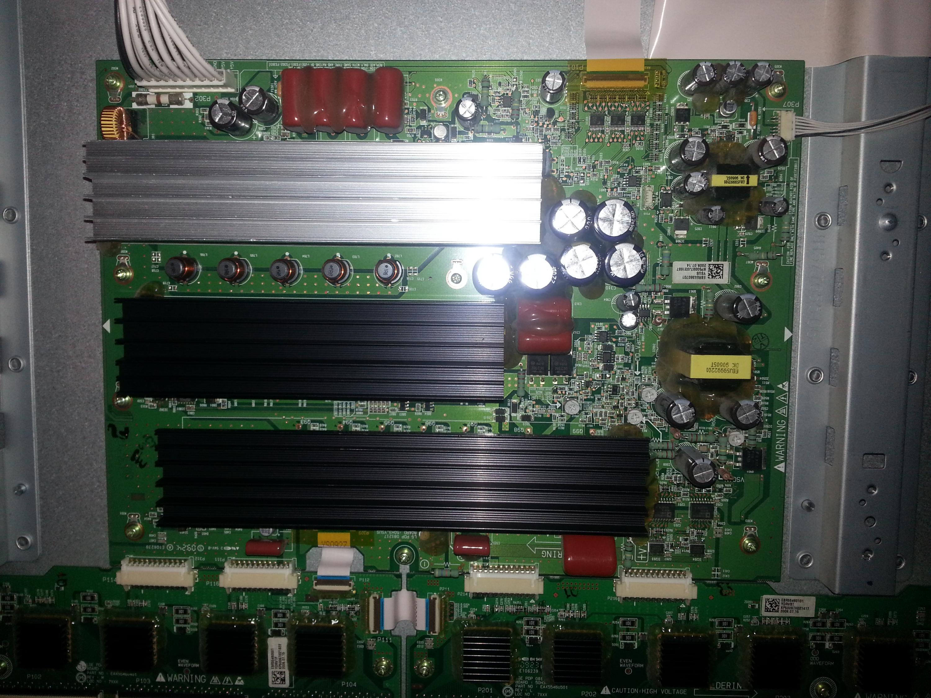

    You just checked them.
    Could be a dried out startup cap, etc.

      Re: lg p's 800 fuzzy picture plasma
      Where are the starter caps on this board are they the bigger ones
        No - the smaller ones - startUP capacitors, they connect to the VCC pin of the controller chips (like that stand up one on the Samsung plasma you're doing.)
          Top middle or bottom

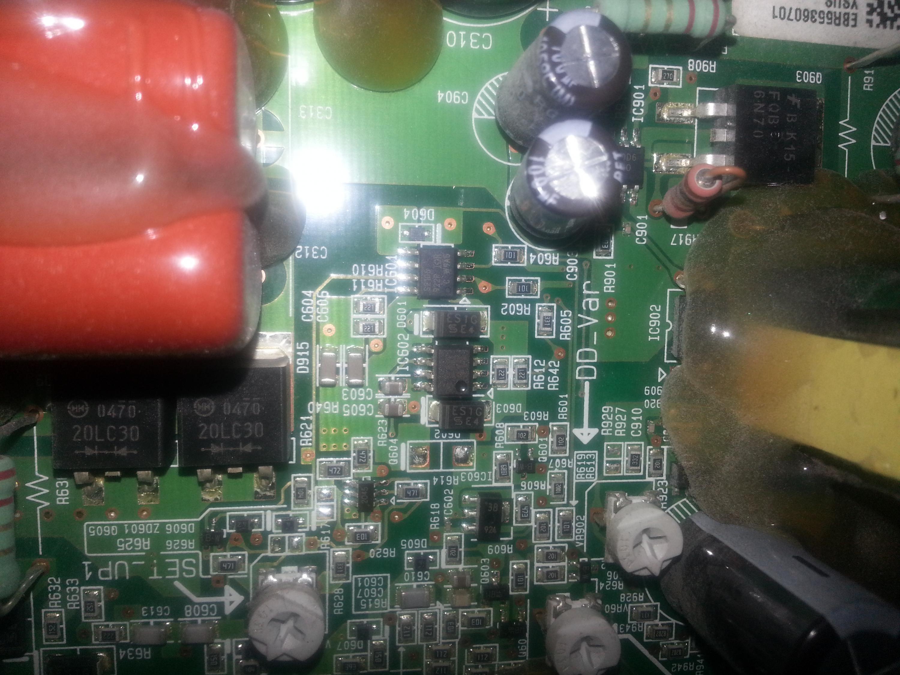

            Haven't a clue - you'd have to locate the controller chip - it's usually near the transformer(s). You can locate a controller IC by googling it's part#. I'd start with that 8 pin smd top left of the transformer.
              I have found ic 402 and the two next to each other are ic602 and ic601
                Should I be getting 17v on one of the legs of ic 402
                  Just ordered a new y sustain so fingers crossed
                    Just got a new y sus and it's exactly the same any ideas
                      #30
                      Check -Vy/Vsc. Still bad?
                      Maybe try without one or other buffer.

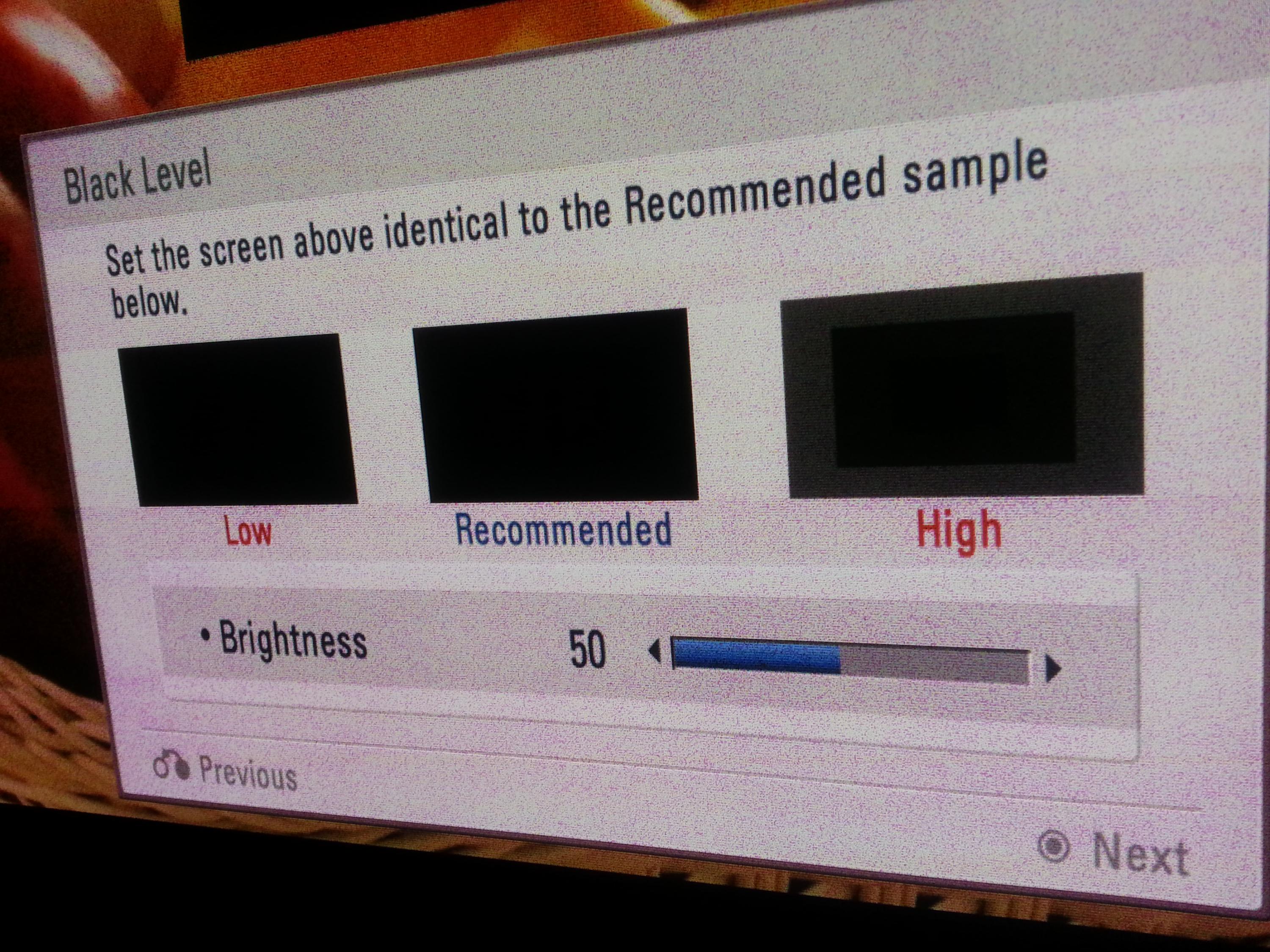

                        #31
                        Yer still going up and down with either buffer in or out

                                #35
                                Yer its just a bad pic with a pink mark if I turn vs up it goes to a nice pic but goes off after a few seconds
                                  #36
                                  That will occur if you increase Vs too high, power supply can only provide so much current.

                                    #37
                                    The pic is good if I turn it up from 194 too 205 but can it stay there or will it damage it
                                      #38
                                      Do -Vy and Vsc stabilise when you do this? What is the rating on the panel for Vs and Va?
