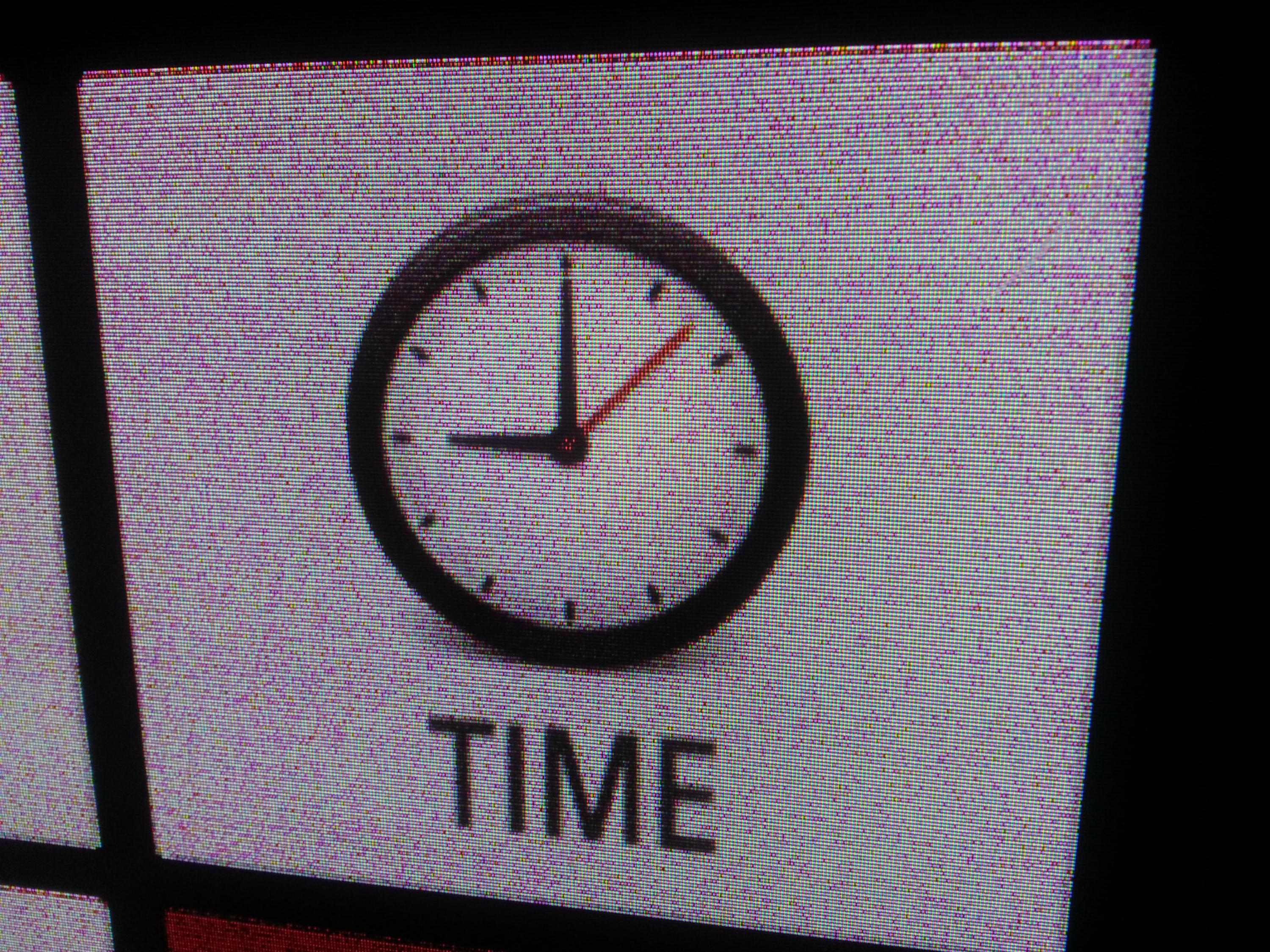

    Anyone know how I can get rid of a fuzzy picture on a lg plasma

        It's leaving a shadow when menu been on as well
          Re: lg p's 800 fuzzy picture plasma
          Pixilated like this

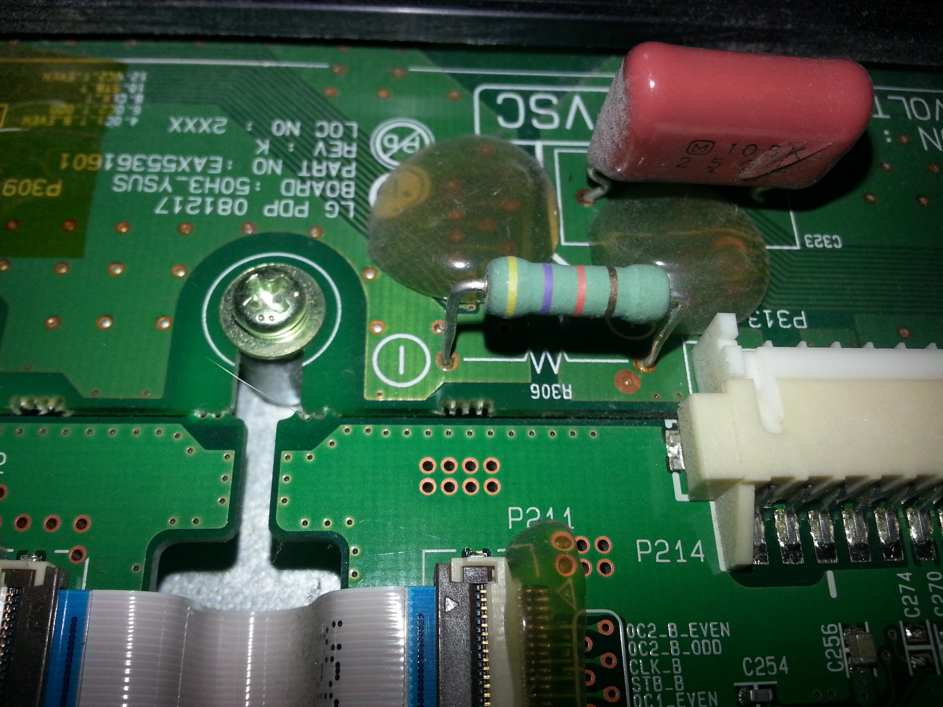

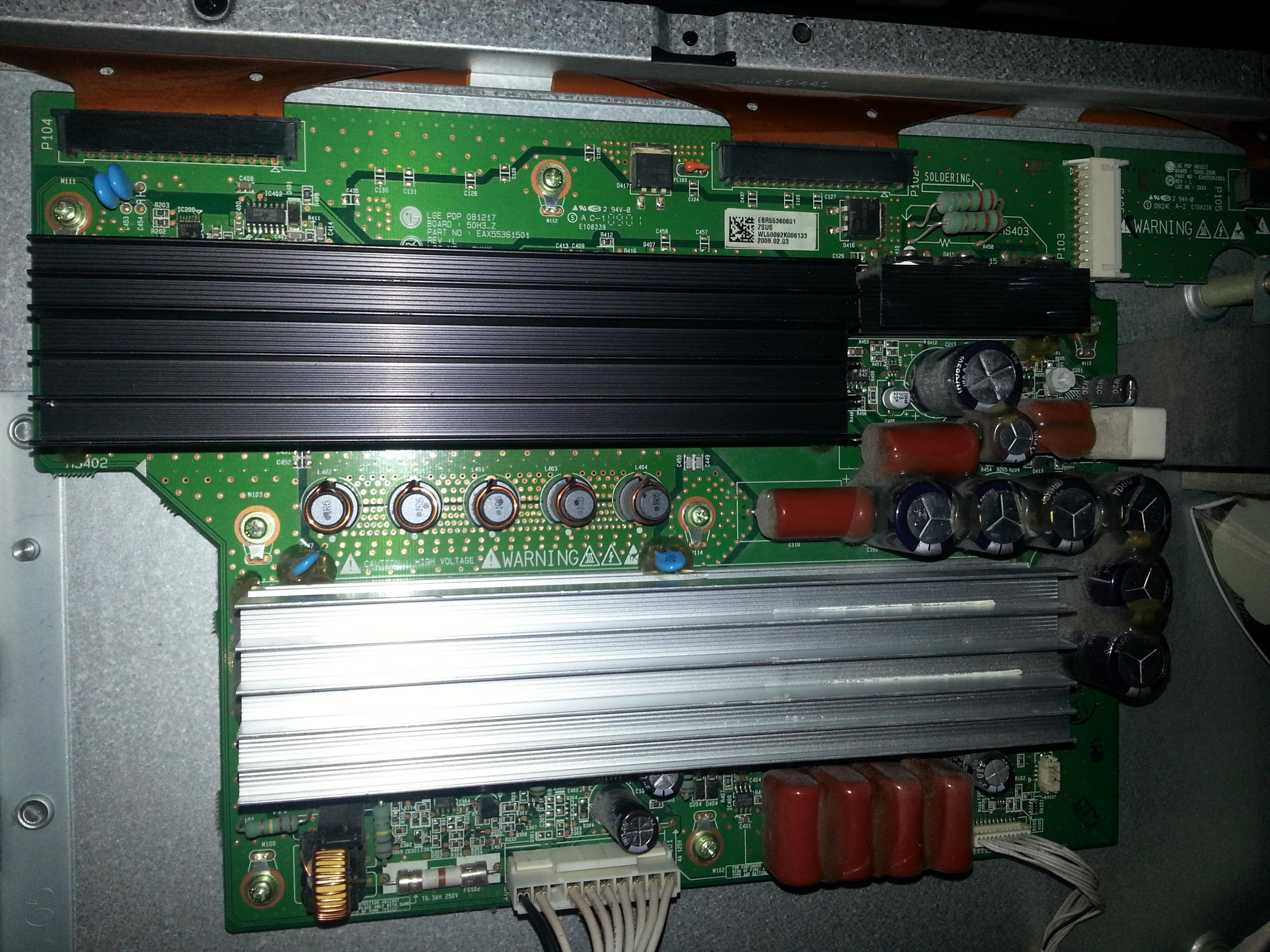

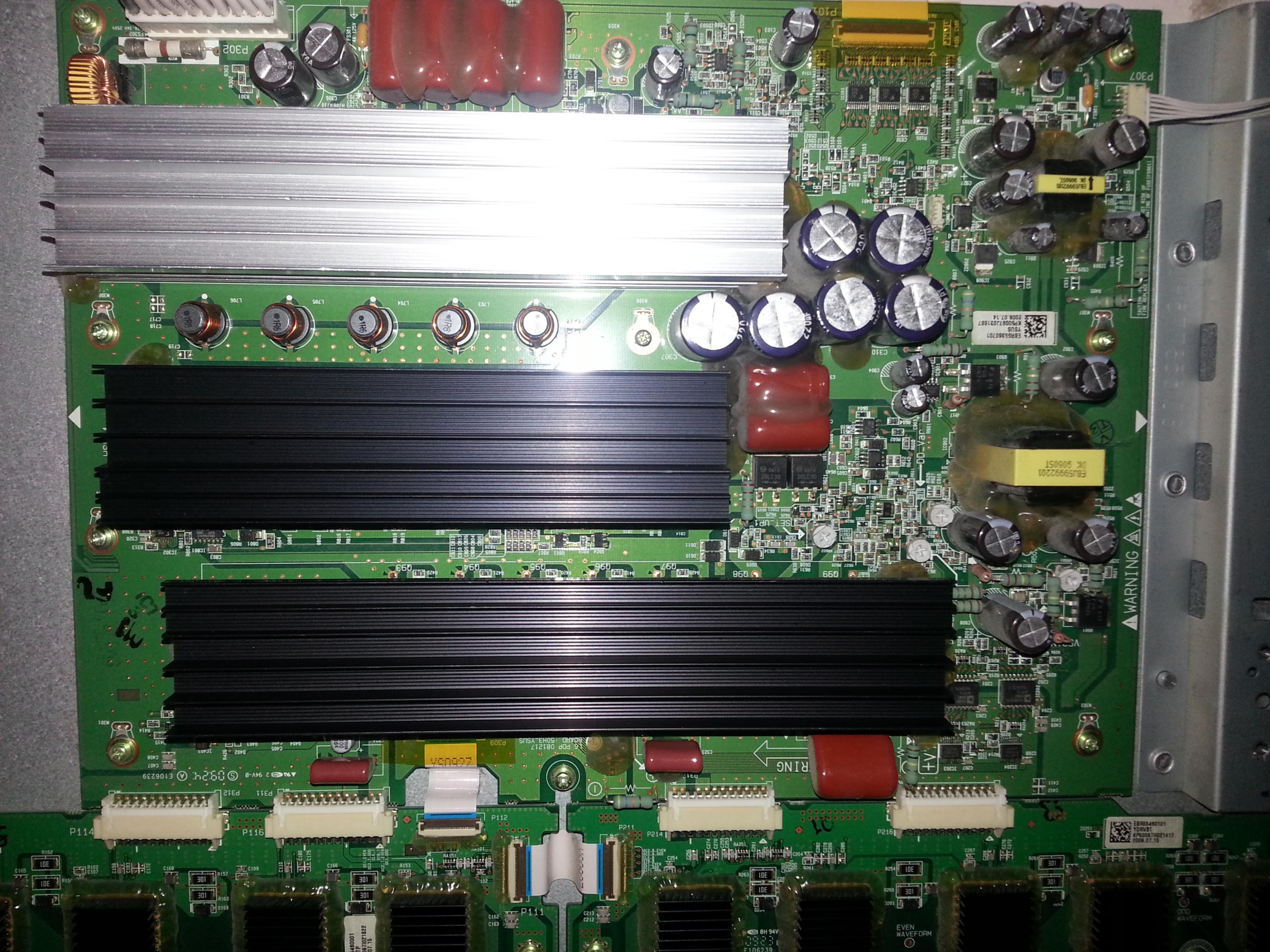

            Looks like Z-sustain or Vset_dn issue; pictures of the boards?

              It also left shadows after the menu is on. Not sure if its the same problem.

                Vset_dn = Yrr so I'm suggesting that as a possibility.
                  Y and x sustain

                        Great
                        Search 50H3.
                        Page 121 - Vs/Va: check these.
                        Page 123 - Vsc/-Vy: check these.
                        Page 128 - Vzbias: check it.
                        **USE YOUR PANEL STICKER - NOT THE ONE IN THE DOCUMENT.**

                            I have checked the vs it was only a bit low and the same with the va but u know when I check the vsc do I earth to the tv or earth black one side red the other of this
                              Red one end, black the other - if in doubt, see the pages I indicated.
                                The vsc and the vy are up and down
                                  Any change when adjusting them?
                                    Only in the pic slightly bit the voltage is still up and down

                                      Looks like you have a Y-sustain fault then.
                                        Any points I can check
