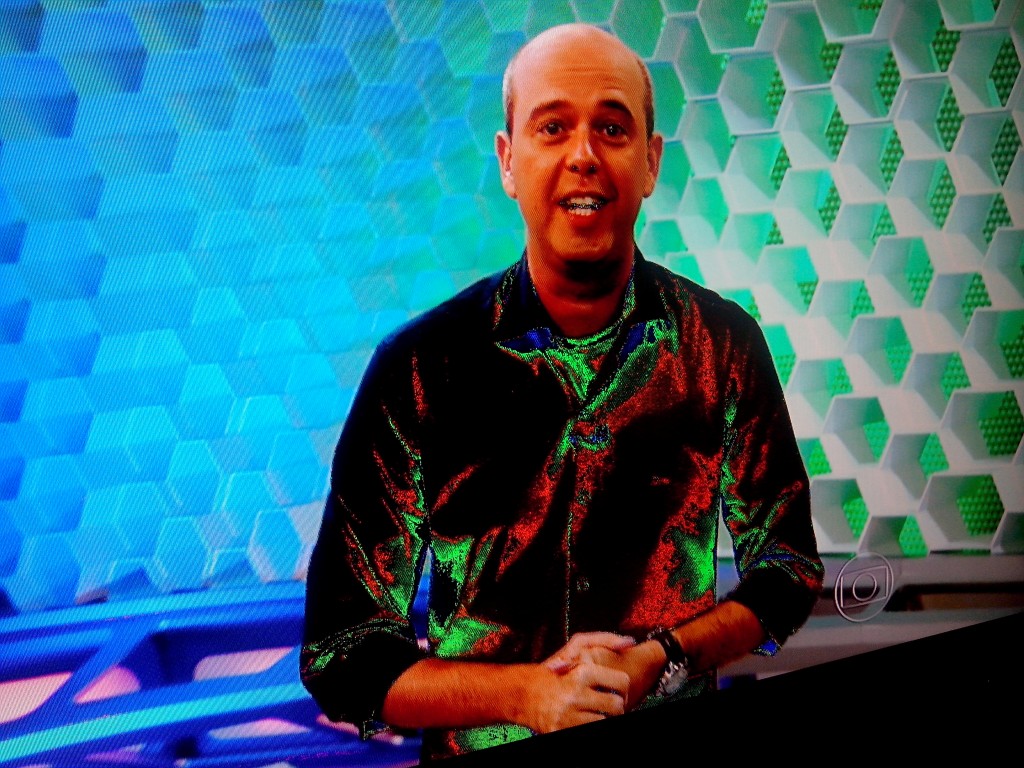

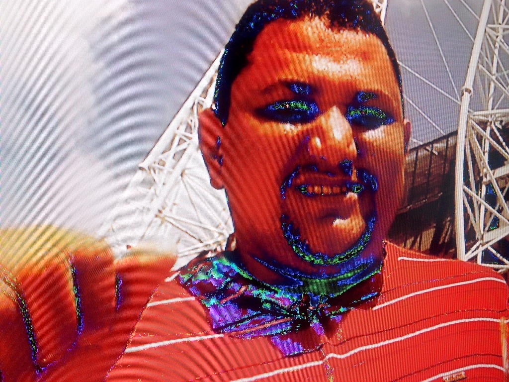

    Hello guys,
    I have a Sony Bravia LCD TV model KLV-37M400A.
    It started to show strange colours at image, like the 2 images attached. I made a video too. You can see here: http://www.youtube.com/watch?v=15-ilEoqPrQ
    When I turn the TV on, it shows the correct image for just about 1 or 2 seconds. After that this strange colours starts to appear.
    Do you know which part of TV can be broken ? What kind of test should I do to prove this ? I just have a multimeter.
    Thank you very much!
  • xredhawk
    • Jul 2011
    • 103
    Re: Image problem on Sony Bravia LCD KLV-37M400A
    tcon or lsvd cable
    • Glitcher
      • Mar 2013
      • 673
      • USa
      First try unplugging, cleaning, and replugging the cable and connections going into the Tcon board.
        T-CON with GAMMA voltage problem.
