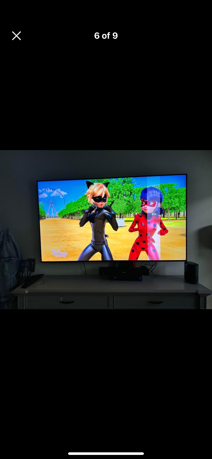

    Anyone fix this issue before???
    I have this Samsung QLED tv that works but has a vertical stripe. I know its most likely the cof chip but curious if anyone has successfully repaired one?

      Squeeze the bezel hard and see if the stripe disappears. Probably someone “washed” the TV screen and shit ran down onto the COF.

        Many years ago I picked an early LED era LG with similar fault, the brighter band plus a small black stripe in the center of it with no image, it was no liquid damage, was bad joints under one COF chip, putting pressure the image recovered almost all, i tried heating it under with the big T shape iron tip but not resolved, maybe heating directly with normal cone tip can work but with my new knowledge i think is not the correct work and a better job can be made, don't ask me, i wanna try it myself before..
