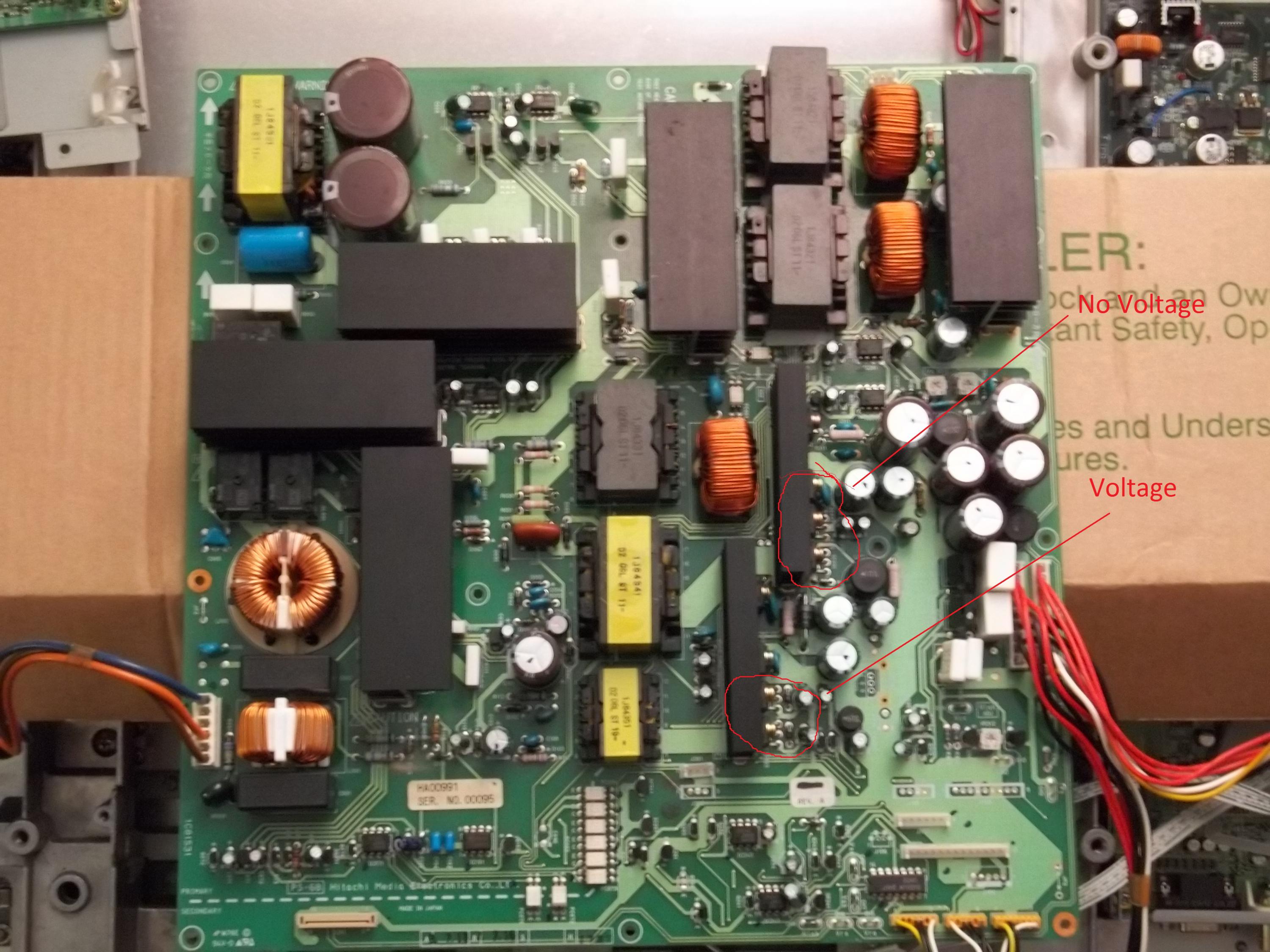

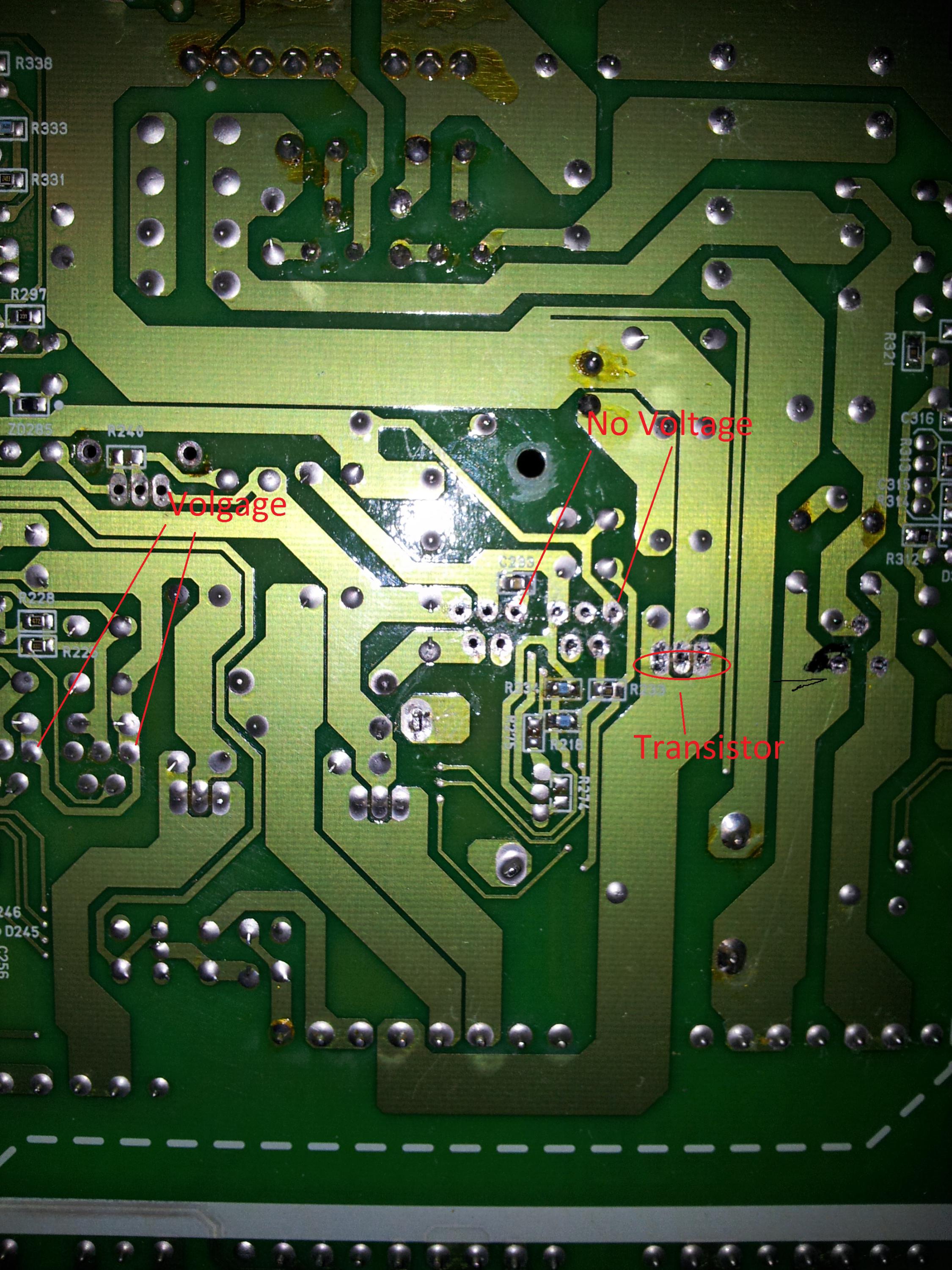

    I am still working on a tv that would only power on for about 6 seconds and then shut off. A couple days ago I found no voltage coming from a couple of the voltage regulators. They are both on the same heat sink. On the heat sink next to it there are 2 regulators also and they had roughly 6 volts coming out. I am trying to figure out where the bad component or short is. I am having a heck of a time. I was trying to determine whether it is one of the transformers or not. There are three transformers in a row and they are all common to each other on certain pins. I'm still not sure how that works. If they're all stepping different voltages why are they all common? And I can't find any results with the part numbers on the transformers or the regulators. I've seen where sometimes transformers have thermal resistors I was thinking that is a possibility. But the voltage must kick on for a quick time if the tv powers fully on. Also, The Diode on the same (no voltaged regulators) sink appears to have its Annodes common with ground. Is it normal to see reverse bias on these boards like that? All the caps seem good. Any help would be appreciated!

    Those are more likely rectifier diodes, TO-220 Common Cathode type. You should get the P/N as printed on the body to verify.
    The board will have standby power supply section that is always on, the other power supplies will be switched on by the PS_ON signal from the main board.
    So what is this power supply board is for? make and model of this TV you are working on?

      Hitachi 42 plasma. Ill post the number later. I know on the working voltage regulators there was 6 volts on one pin and 3 on another pin. There are 5 pins. The component circled probably is a rectified type diode but the 5 pin ones i think are regulators.
        Re: Power supply missing voltage.
        The 5-pin is probably buck switching regulator, or a switched regulator that needs the On signal for the output to be present, not going to know until looking up the data sheets.

          Im still working on the datasheets. I had no luck last night. I was thinking since the one sink has voltage from its regulators that the signal would be present for the heat sink that is not working. Maybe that's not necessarily true i just thought it to be highly possible. But both sinks run off different transformers i think. The transformers show continuity between each other so that's what confuses me.

            Now I have my list of numbers:
            TV: Cmp4121hdu
            PSU: 1C81531
            2 Regulators not putting out voltage:
            SK 8120s
            15 07
            SK 3025F
            Transformers directly in line with the 2 sinks:
            1J84331
            D206LST11
            1J84341
            D206LST11
            • Ashroyer05
              • Sep 2013
              • 162
              • U.S
              SK81201:
