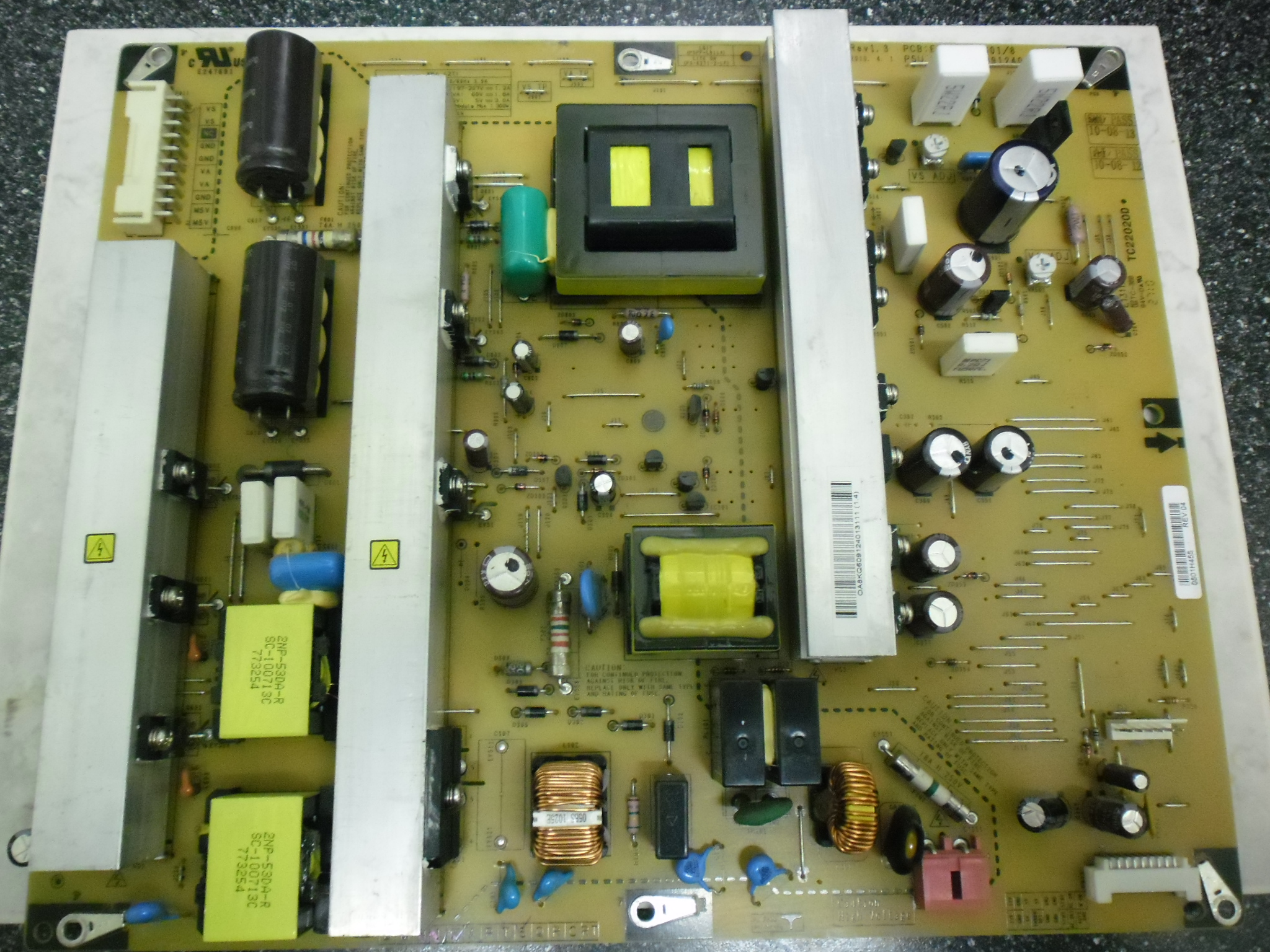

        Re: lg 42pj550 zd Clicking Noise
        I've now got the tv in my position, will be posting pix later, but im too piss Liverpool beat Man U so forgive.
        That diode was bleeping when in circuit so removed it that's the reading im getting.
        was going test the voltage regulator next.

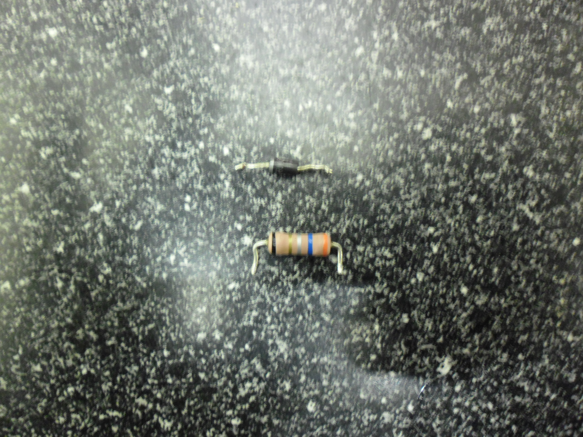

          Did a few more checks, removed this resistor, pink body think it should be 368 or 36.8 ohms? used a resistor color code but couldn't get the 4th & 5th band correct.
          I explain 4th should be silver but only seen grey, and couldn't select the 5th band as black.
          When I test resistor on DMM it reads something like 2.3 ohms.
          From the pictures the diode & resistor has been removed.
          Top of my head locations D304 & R305 near heat shield.

            Changed my DMM that pink resistor reads 000.4? is that correct
            • paulstef
              • Dec 2013
              • 724
              Resistor seems to be 0.36R, so it's ok.

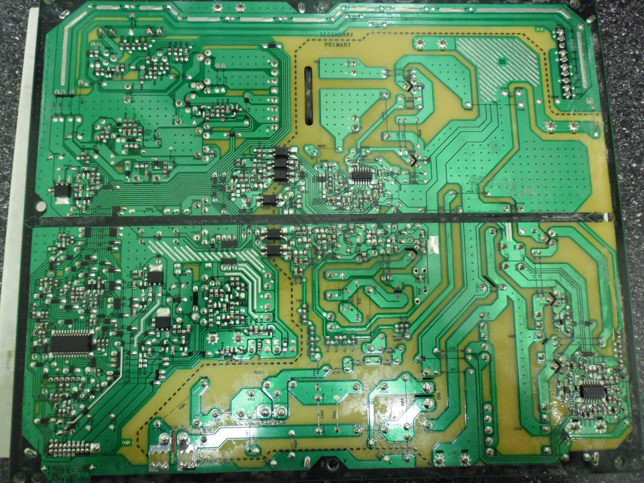

                          • Jahson
                            • May 2012
                            • 245
                            Cheers last time it was on it stay on for 4-5 hours, had to turn it off to go bed.
                            Aint turned it on from ive removed those few named bits. 5w22 resistors, diode, pink resistor.
                            Been on a go slow today coz of all the footy to watch.
                            Will check for dry joints right now, will pick up the cooling spray in the morrows.

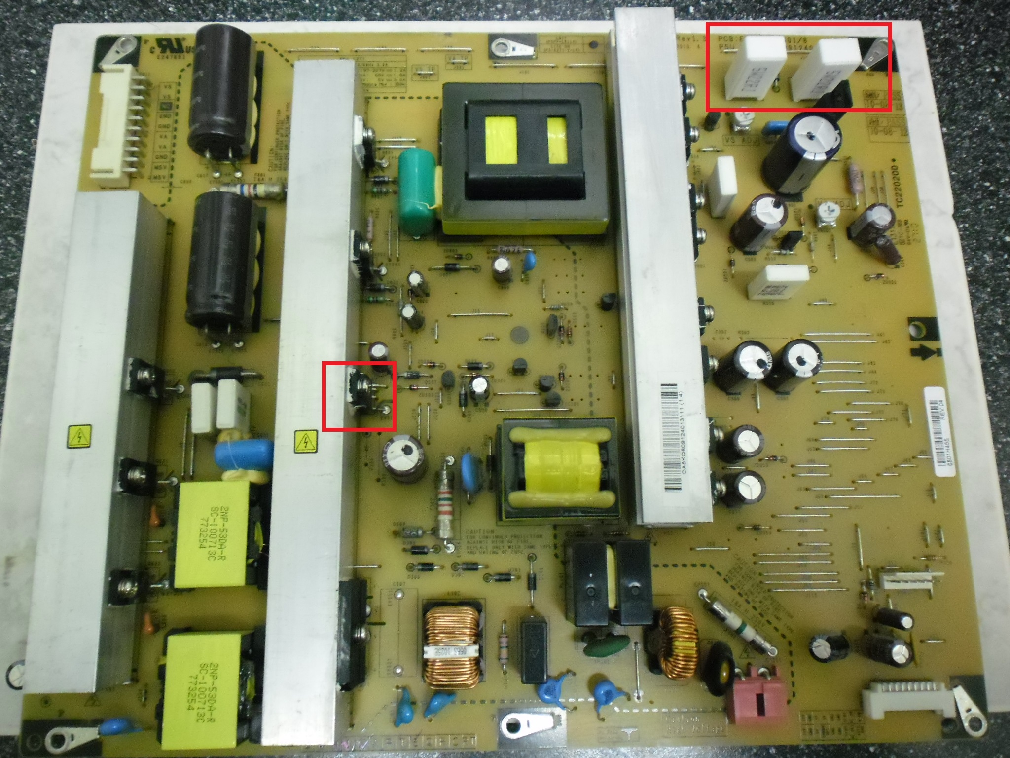

                                      Test the parts highlighted and if If heating/cooling ic701 makes no difference then there are a set of 11 smd resistors on the back in parallel with ic701 they can go bad
