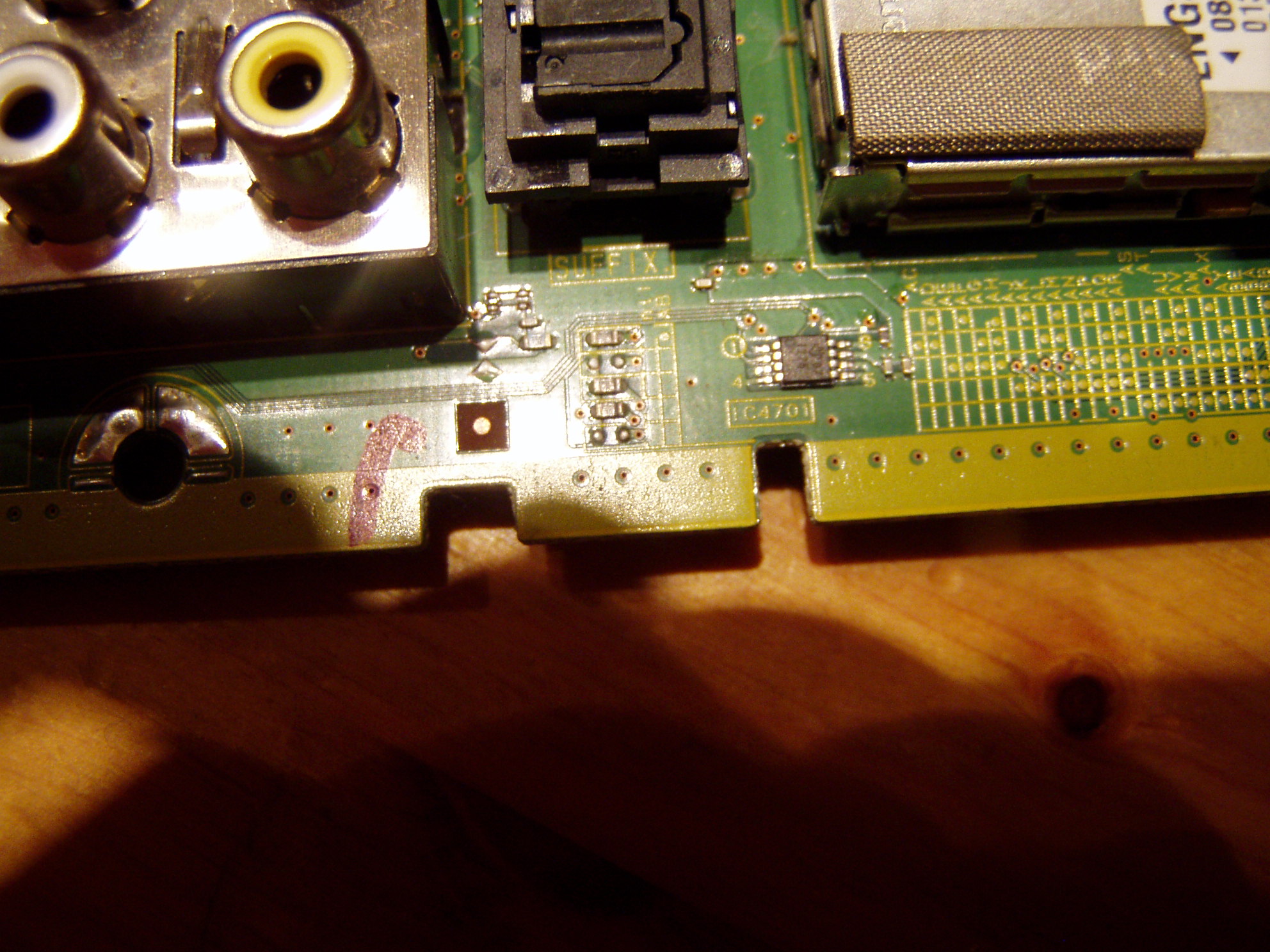

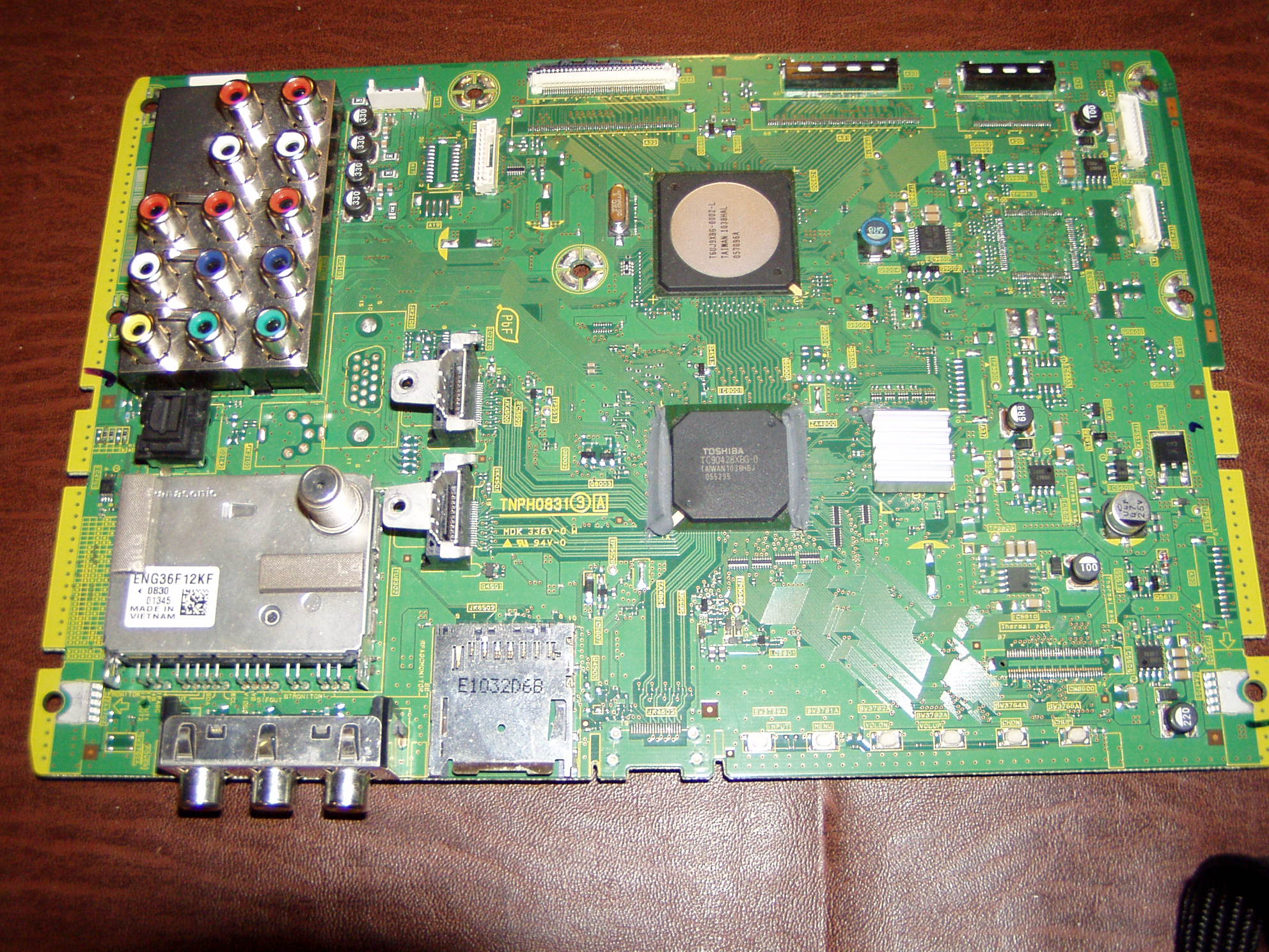

Here is the pics. Mine doesn't have the vga connection. It looks like the AR version has the VGA and the AT do not. Both the AR and AT have the panel number of MC106H30U13 according to Shop Jimmy's webpage. Yet I cannot find an AP version anywhere. My board has resistors on 2,3, and 5.Last edited by dcapper; 02-19-2014, 01:04 AM.Comment

for repair but yours looks damaged on one ribbon connector, an IC is missing and a missing heatsink. Not cheap for what the TV is probably worth.
The only issue with the VGA is it not having a cutout in the rear panel for it. A17,A18 both are factory use only so should not be an issue whether they're present or not.

Yes, the tv is a TC-P42X2. Someone beat the heck out of the board. There is chips missing and ribbon connectors broken. The board is non repairable. I did see some A boards on Ebay but they are the wrong revision numbers. There is AT and AR boards and if they work, I can get one on for around $120. It's actually worth it for me, since I got the tv for free. Why would Panasonic build so many revisions of these boards? Who does that? Stupid in my eyes.Last edited by dcapper; 02-19-2014, 08:25 AM.Comment
