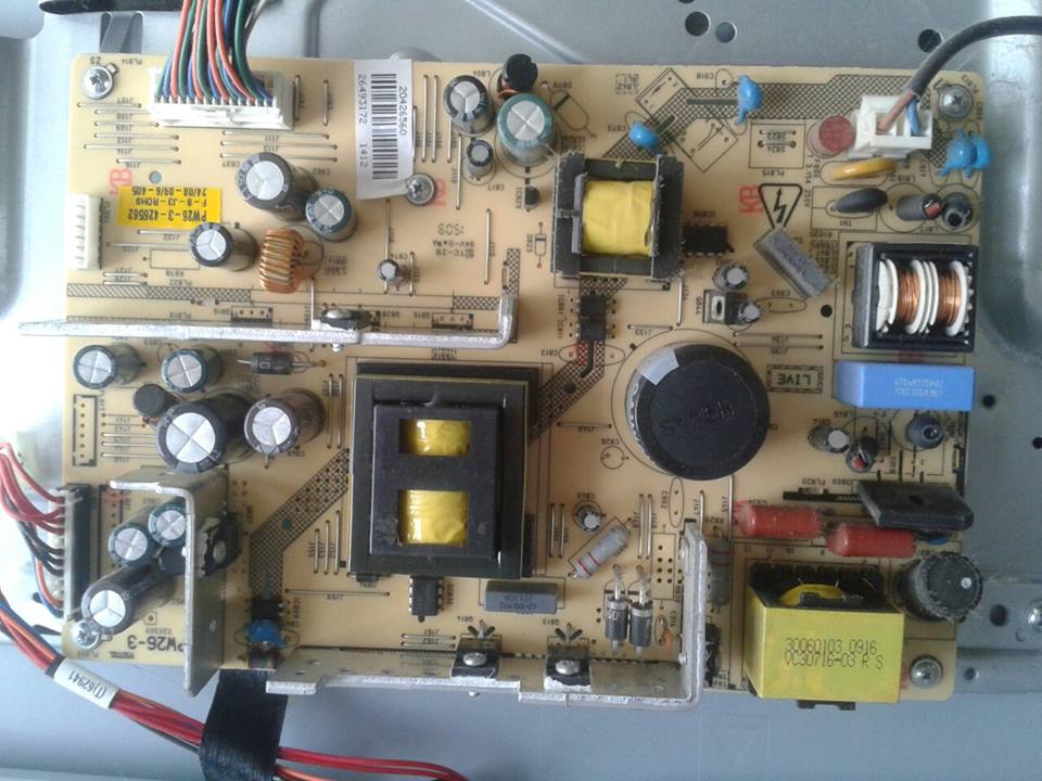

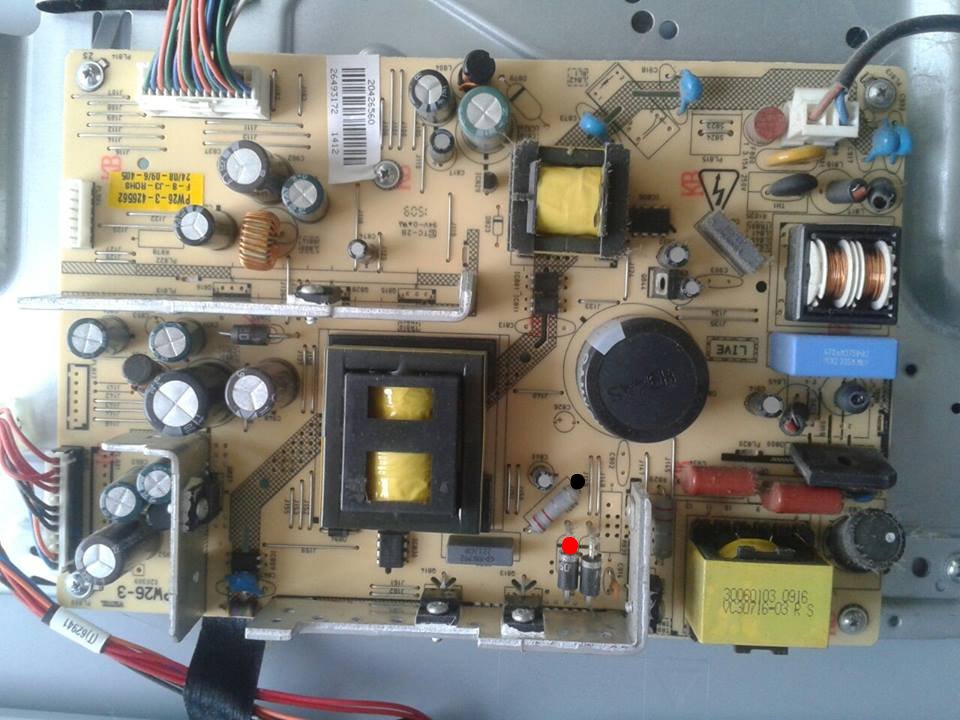

    Hi I got this xenius LCDX32WHD88 (B), when you turn it on the blue led goes off for about 3 secs then comes back on and tv does not power up. The power board is vestal 17pw26-3 v.1. Theres no voltages printed on the silk screen so cant test voltages. Caps look ok, I will test them in a bit, just woundering if anyone got a schematic for it so to test voltages first.

    Re: xenius LCDX32WHD88 (B)
    A quick check of PSU function would be inverter 24V - the red wires running off to inverter.
    SCH also has voltages:-
        Only getting 22 volts on the 24volt net.
        Will check the caps on that net now.
            Check PFC voltage across two points marked should be around 390V when turned on.
              I only see one point, but from there to ground is 220v then when I power up the set it rises to 265v dc.
                Black point on resistor lead, just above that red point on diode. Testing relative to ground isn't valid unfortunately.
                  Oh yea I see it now.
                  Yes I got 390v there.
                    OK in which case PFC is working so I'd look at replacing that little grey box capacitor next to the transformer. No experience myself, but I've heard of others with this problem and that cap caused it.
                        hmmm I just pulled out that cap, The schematic says it should be 12n at 630v
                        The cap I pulled out was 223j630 which I think should be 22n and is measuring 21.9n.

                          Did you manage to check 12V and 5V outputs too? Perhaps 24V is low because backlights not on. Worth a thought, could be bad main board.
                            ahh I haven't got 12v either. sorry about that.
