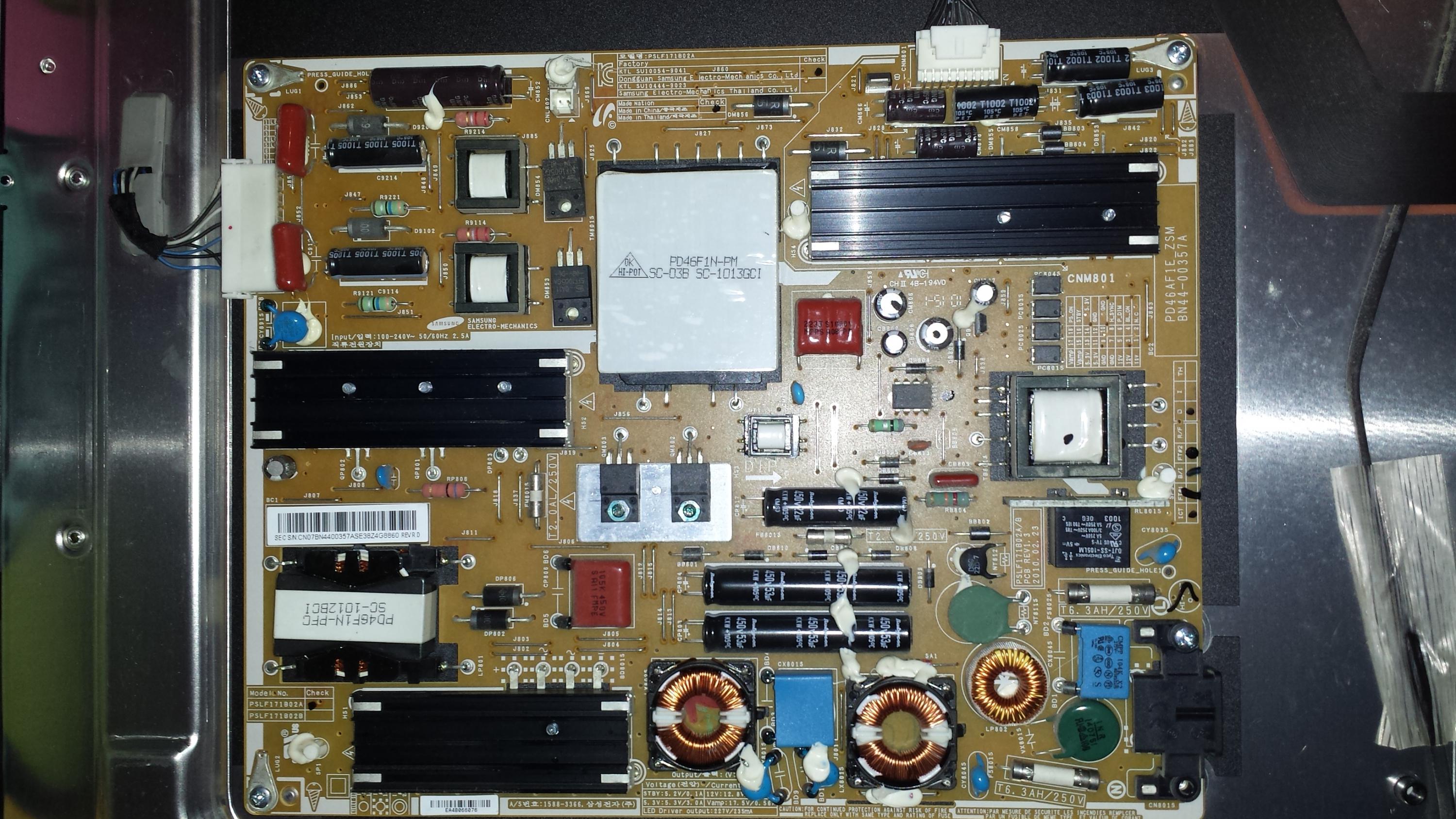

    As per the title, i got a Samsung UE40C6510 (UE40C6530 and C6530 is the same) from the 'Bay.
    PSU: BN44-00357A
    Main Board: BN40-00187A
    Symptoms:
    As soon as the set is plugged in, the relay on the power board clicks (once) and the LED blinks 5 times, stops for a few seconds, then carries on blinking over again.
    If any of the buttons are pressed on the screen / remote then the LED does respond to the input but makes no difference to the screen turning on.
    tried so far:
    I have tried unplugging the main board from the PSU (as per the service manual) which is supposed to make the backlight turn on when plugged in, but again - nothing! This makes me think it is either the PSU or the LED backlight circuit?

        How many wires going to the backlight from the power supply ?
          Re: Samsung UE40C6510 - Power LED blinking - Not booting up
          Hi mmartell,
          Thank you for your time.
          You can just about see in the picture above (the left hand connector on the PSU) there is 8 wires going to the backlight.
          Hope this helps and thanks again,
          Demon

              Sorry I missed the fact that you had the service manual. I asked because some sets need extra jumpers to bring the backlights up without the main board.

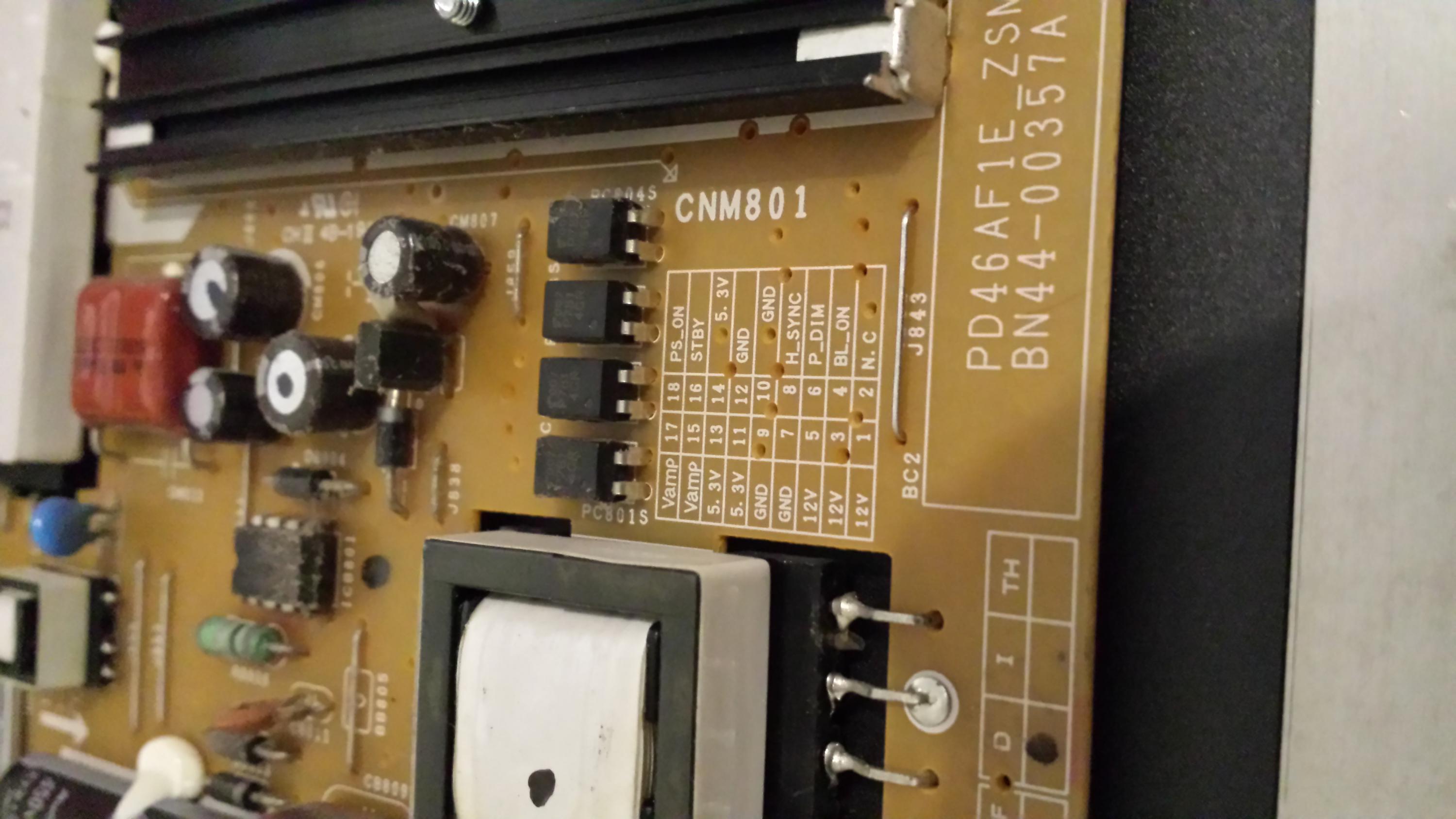

                            I'm not 100% sure. I probed the main filter caps with the main board plugged in and get a steady 388V but get a very small village as soon as the main board is disconnected which makes me think it's not getting the power on signal with that board disconnected?

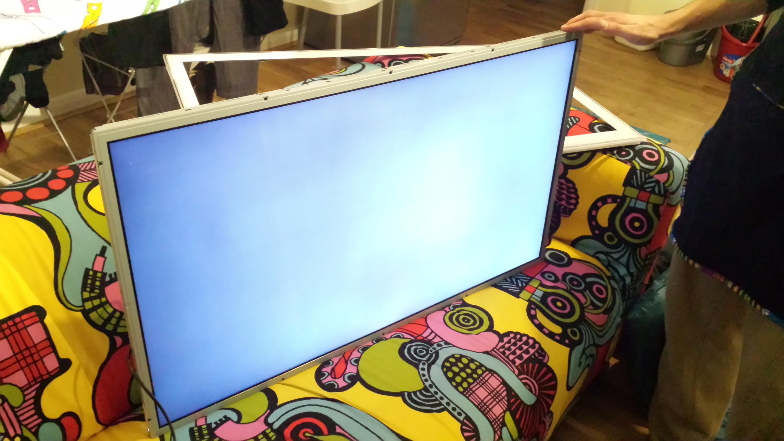

                              It has four pairs of cables so it probably has 4 strings of LED. The black leads are probably the LED return wires. You can use DC Amp meter in series with the LED string, have to do one string at a time but the bad part is that you have to splice in the feeding wires (Grey and Blue) to put the meter in series with the LED string. The string with open LED will not show any current draw when the TV is turn on before the LED driver goes into protection shutdown due to open circuit.
                                Hi Budm,
                                Thank you for the suggestion but the LEDs do not turn on at all (not even 2s to black) so I'm not sure if what you suggest would provide any readings?

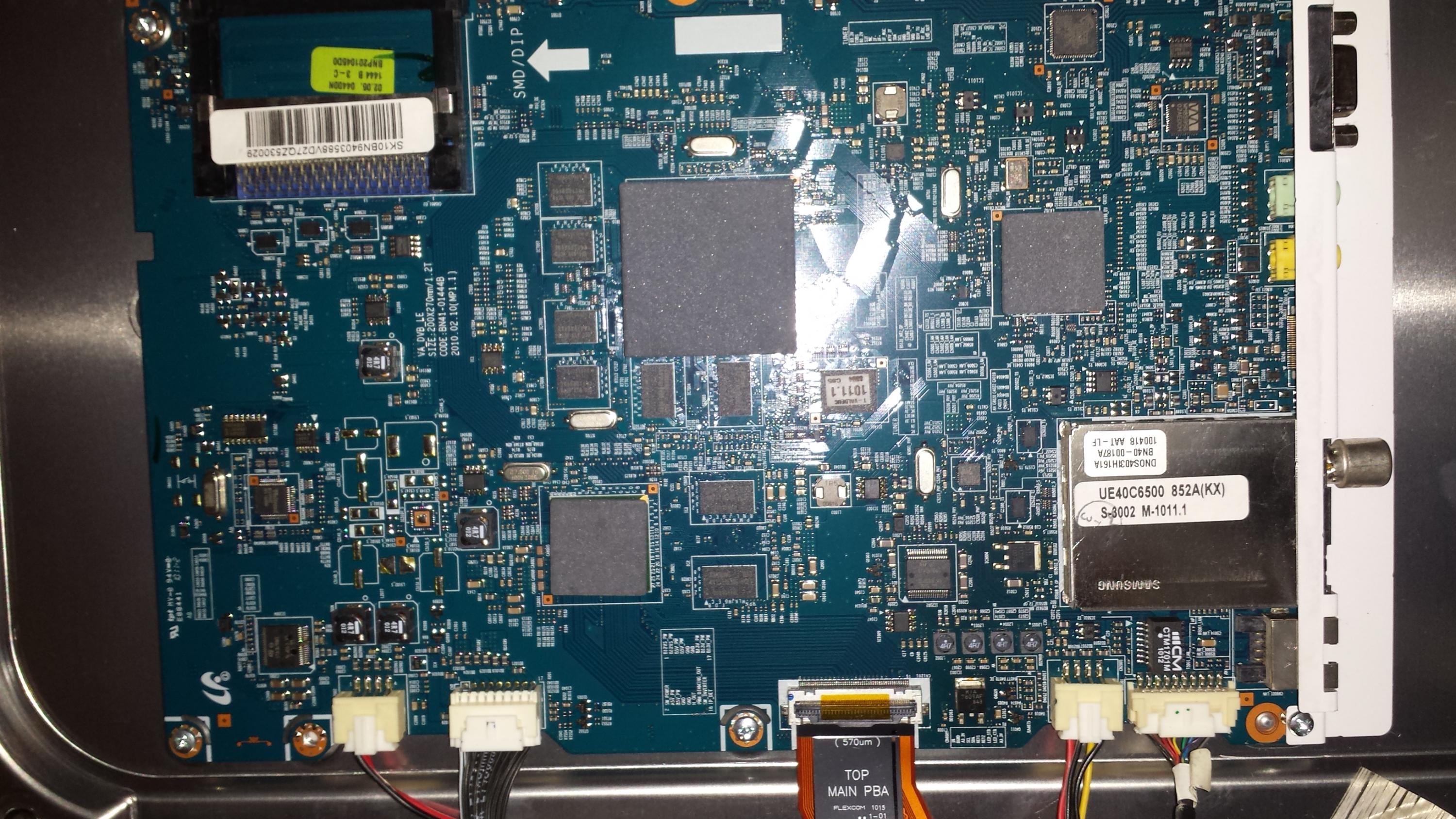

                                One thing I have noticed is a abnormal looking IC on the main board... I will try and get a picture.

                                  OK, then just to be sure, hookup the DC meter to chassis ground and one of the 4 feeding wires to see if you do have any DC there at all, if not, then the main LCD drivers may be dead. I need to look at the diagram to see how it works.
                                  Follow-up, this unit has 4 LED strips, two strips in series per string, so it has two strings with two power supplies for LEDs as shown on page 1.

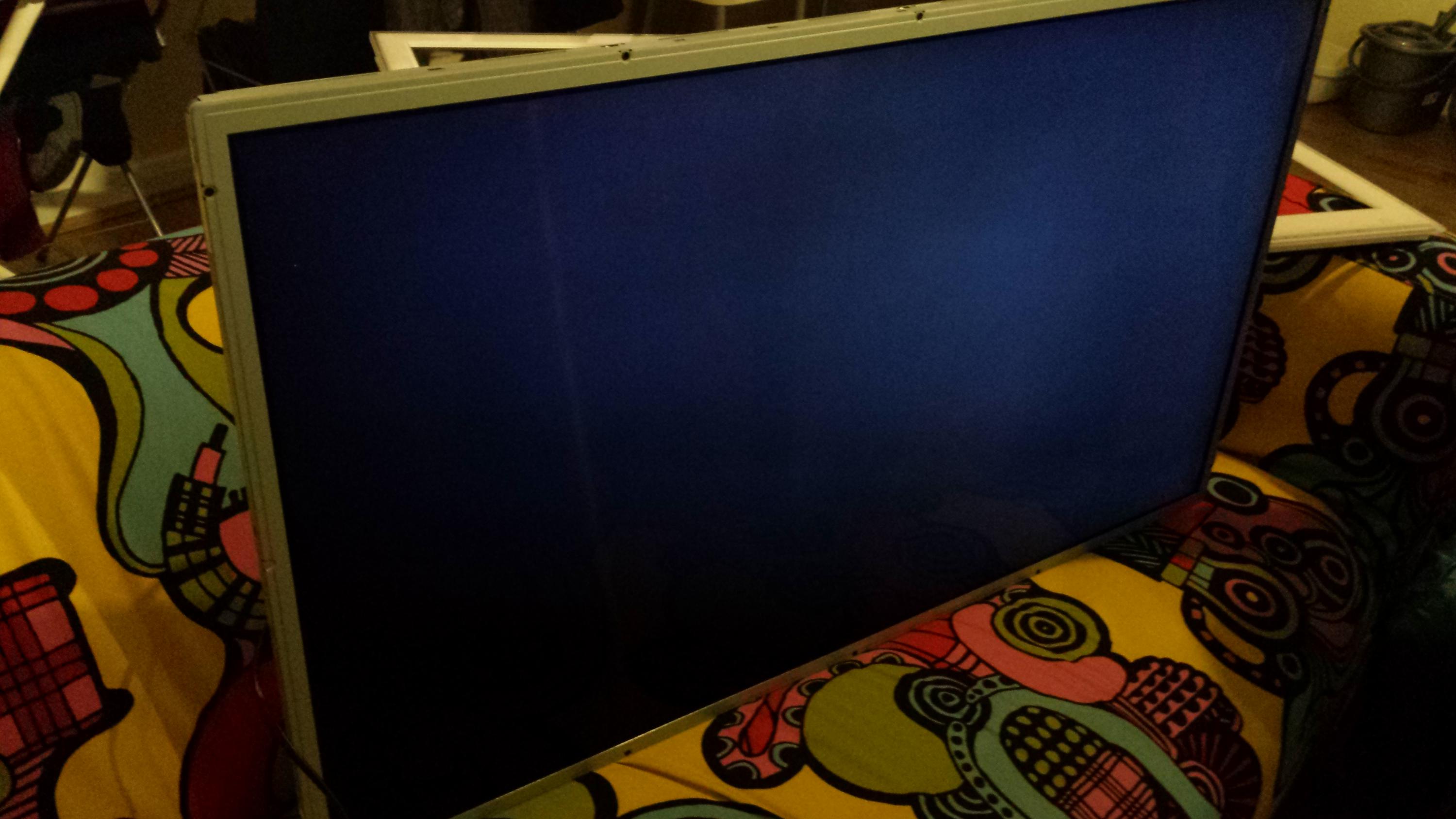

                                    thanks very much for the help so far. I actually managed (Somehow?) to get the LED circuit to boot up! I was removing the connector between the PSU and main board (while the TV was plugged in) and while the connector was half seated, the backlight lit up and remained on... as soon as the connector is fully seated or completely out it turns back off...
                                    Interestingly, the backlight seems to cycle through bright and Dim as the standby LED flashes. As the LED flashes 5 times then stops, the backlight goes dim for a second (while the LED has stopped flashing and is off) and then gets bright again when the LED starts flashing again...

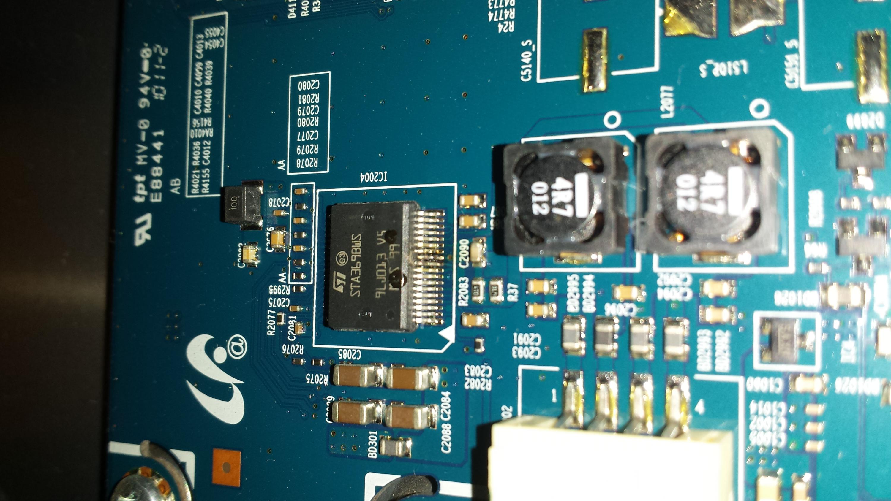

                                    I have also attached a picture of the component which looks a little fried... What do you gents think?
                                    EDIT: Just discovered the main board P/N is BN41-01444C - not what i originally stated...
