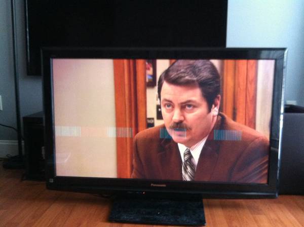

    Panasonic TC-P46C2 Horizontal Defect
    Thinking of buying a tech special plasma. There's a horizontal defect going across the lower half of the display. Possible Y buffer, or whatever Panasonic calls it? lol.

    I expect that will be A board doing that.
      Re: Panasonic TC-P46C2 Horizontal Defect
      I would agree as there was a picture in training manual with that fault which was A board IIRC

        Ok....maybe I'll pass on this one, unless i can get it cheap. The A boards for the panasonics are over $100 US. The guy is firm on his selling price too. Thanks everyone.
          Yeah it's only a 720p TV too.
