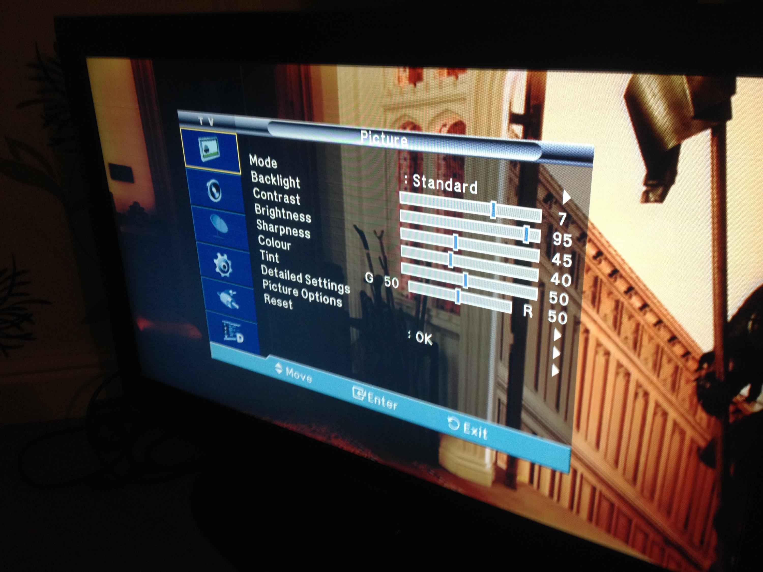

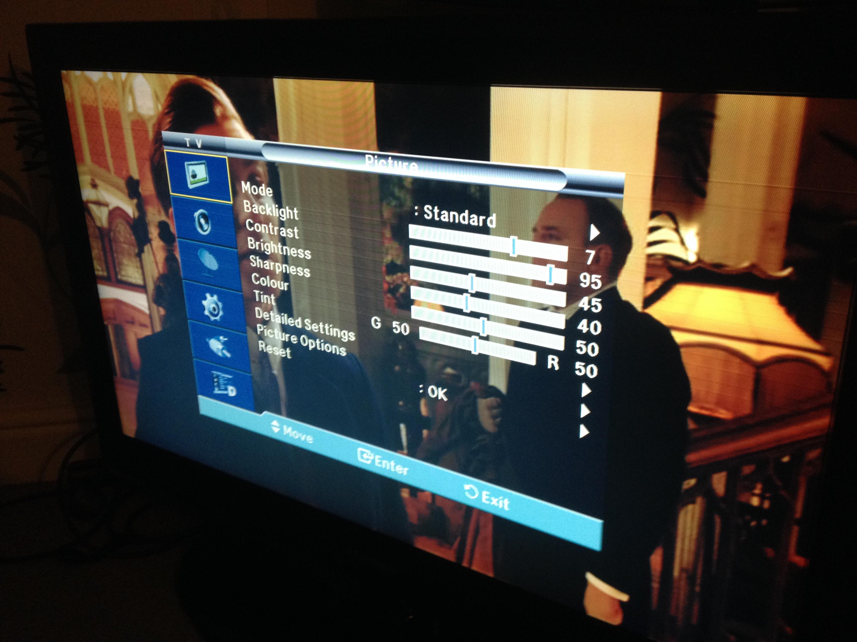

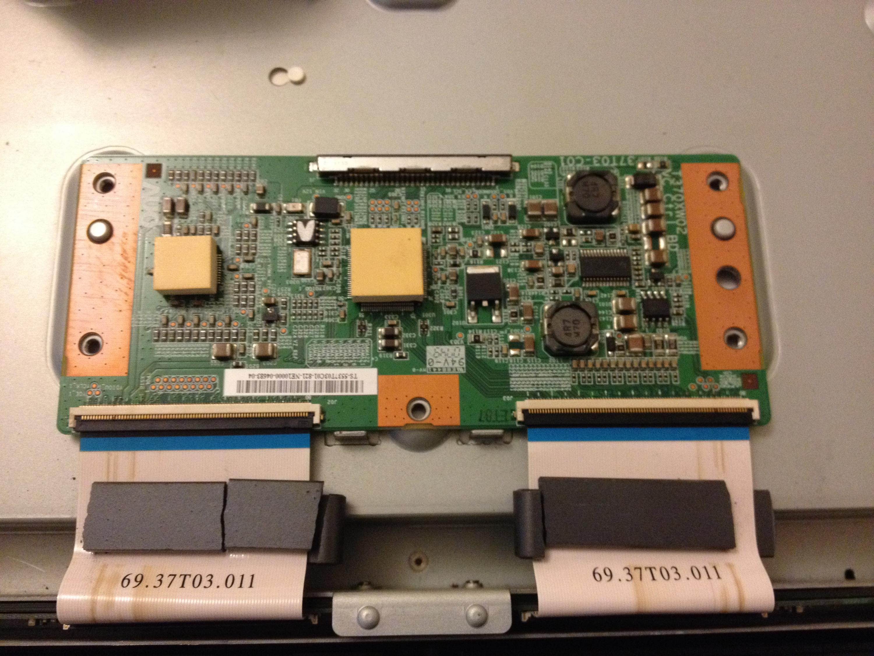

    37 LCD got it with no sound and hdmi plugs bent ( quite a mess )
    manged to make the bent pins good on the HDMI sockets and got the picture working but still no sound - it said feature unavailable when you tried to turn up or down.
    Did a factory reset and that brought the sound back

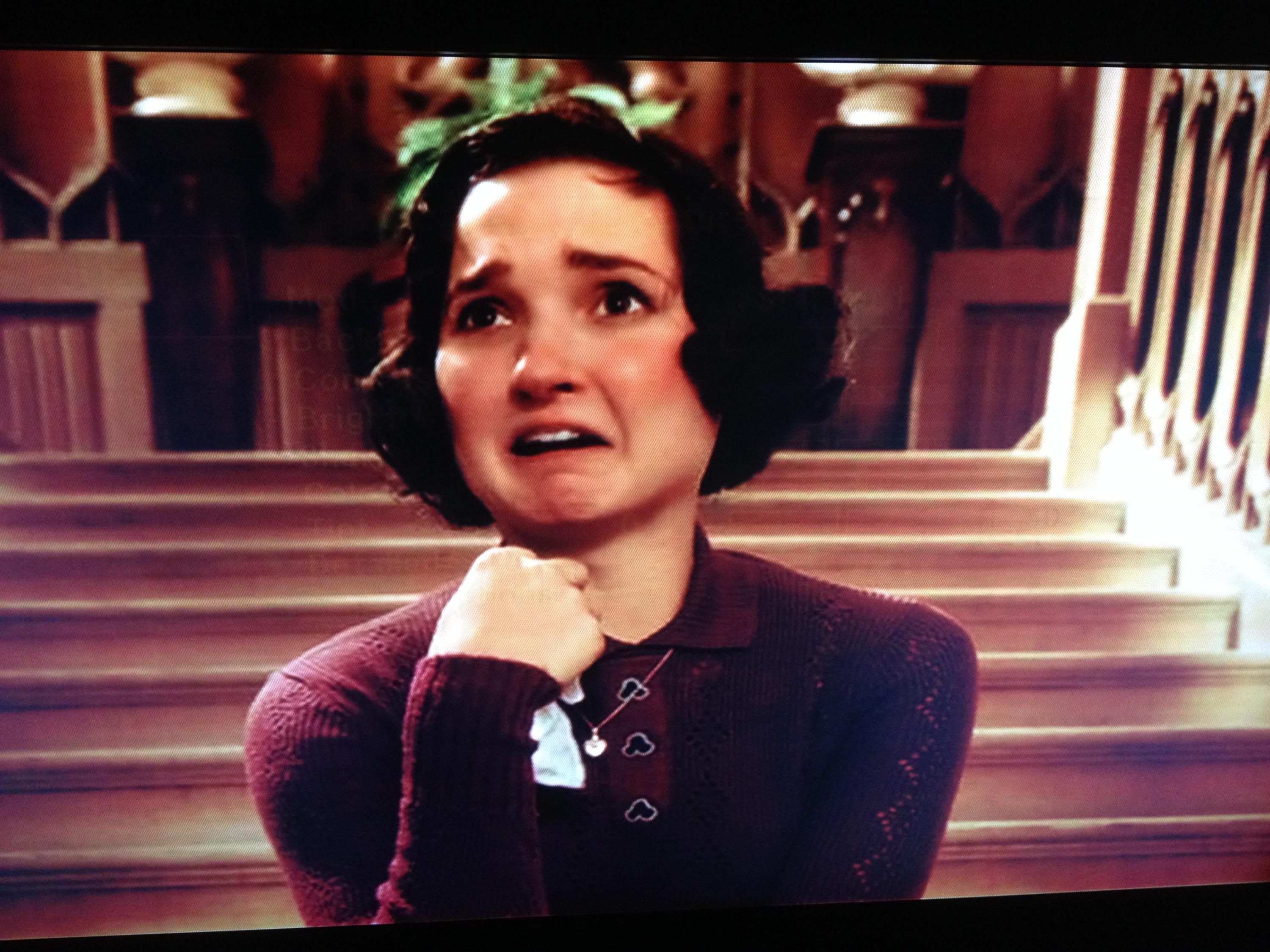

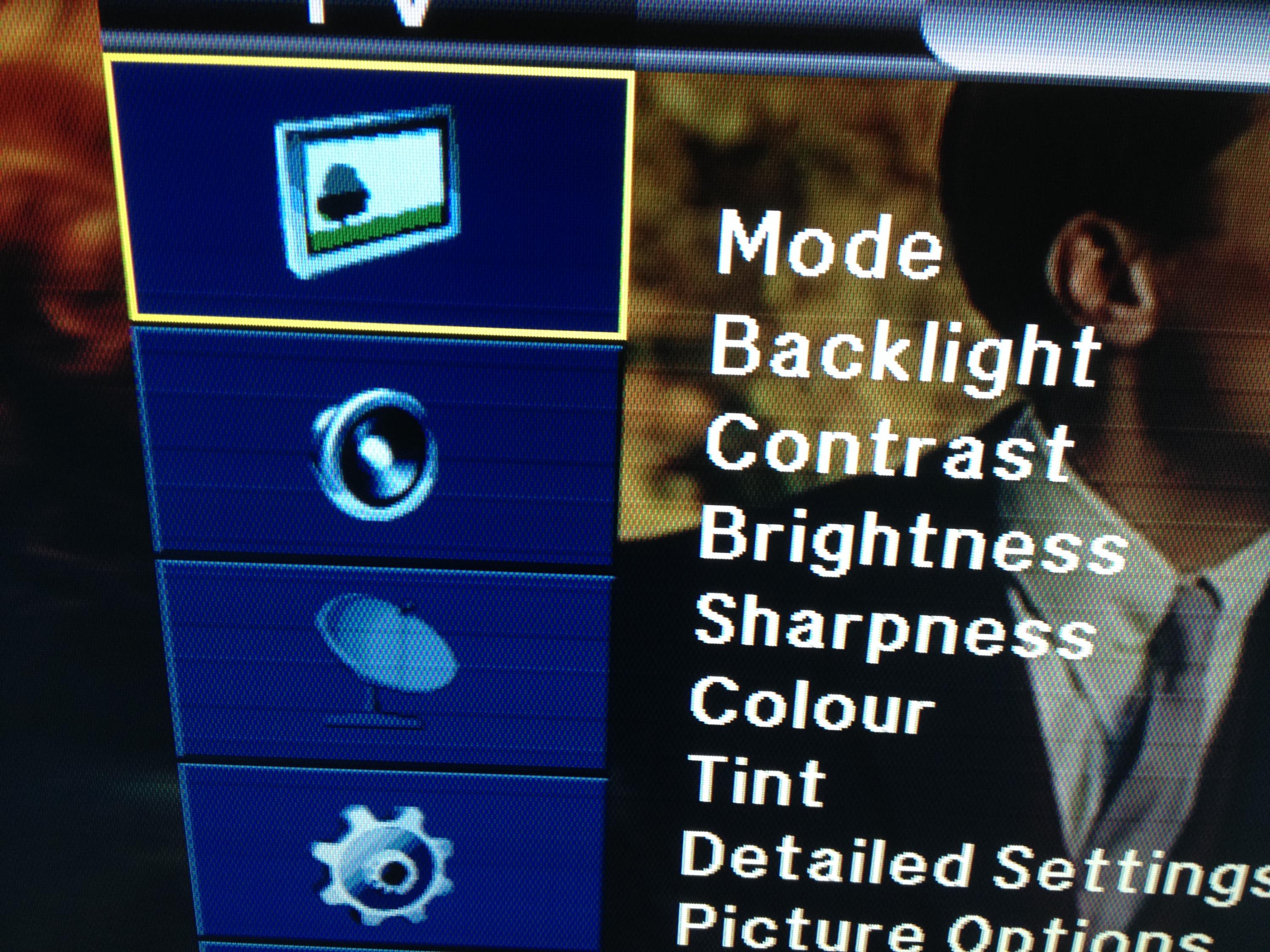

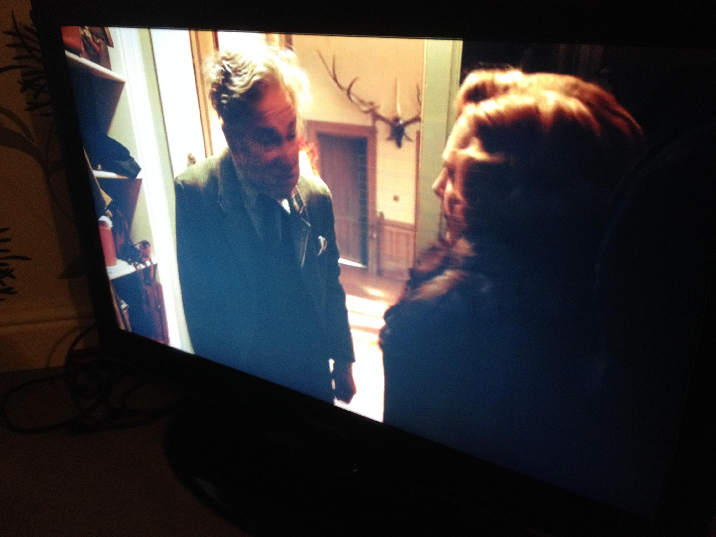

    TV works but it has terrible image retention and you can see the refresh rolling down the screen
    tried all settings and nothing has made it any better
    Now iv read it might down to it being a cheap panel but unable to find any sticker on it - in the service menu it has it as chu ?
    please see the pics - could the t-con or main be causing this ?

      I'm guessing CPT / Chungwha panel, this is pretty much par for the course for them. You can check TCON board VCOM voltage, low or high VCOM would cause this effect but it cannot always be adjusted. It will also cause the odd/even pixels to flicker which I think I can see in the photos.

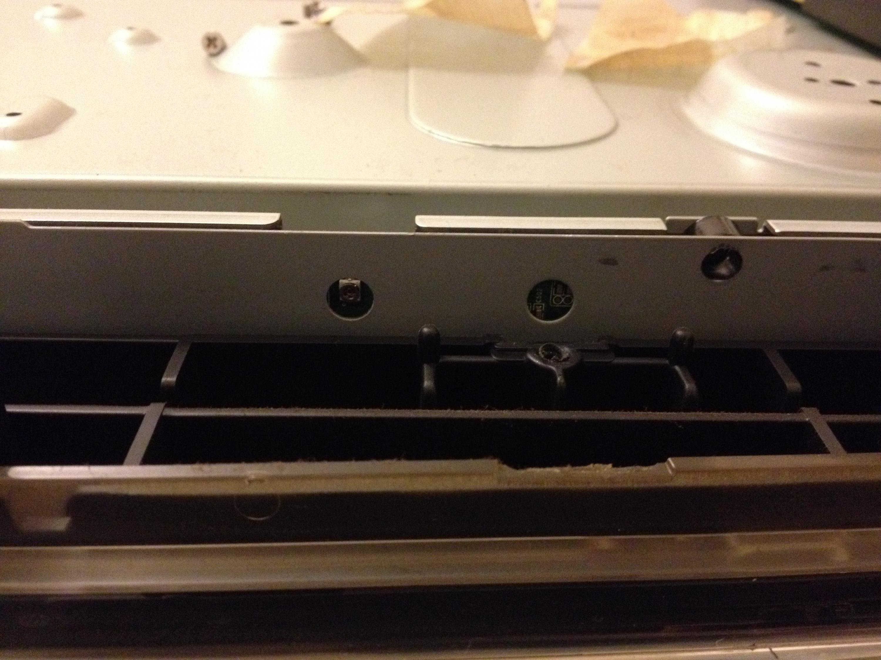

              Hi tom and all i have stripped it down to the tcon and bottom of the LCD
              how do i measure the VCOM and adjust ?
                Re: Samsung LE37A456C2D - image retention issue
                Looks like an AUO panel, huh. Not normally known for this. Anyhow, that potentiometer is the adjustment. Can you see points marked VCM/VCOM/VCO and AVDD? The VCOM should be half AVDD within about 0.2V.

                    The best pattern for adjusting VCOM is this. You should adjust it for minimum flicker - it will still flicker slightly, but get it as low as possible.
                    http://www.techmind.org/lcd/
                    I'd select pixel dot inversion or line paired pixel dot inversion. Full screen on VGA with "JUST SCAN" turned on (in aspect ratio settings) - you want absolutely no scaling and to have exact panel resolution.
                    Factory reset would not affect it.
                            Adjust while on - you want that pattern up and to be looking at it while doing the adjustment to find the best point.

                                    when i did try adjust it i didnt notice any change with the ghosting what so ever
                                    could it be a main board prob or tcon ?
                                      I would say panel then t-con. TBH I have seen this problem before on LCDs but never tried to fix it. VCOM adjustment should help with the flickering and image retention but no guarantees.
