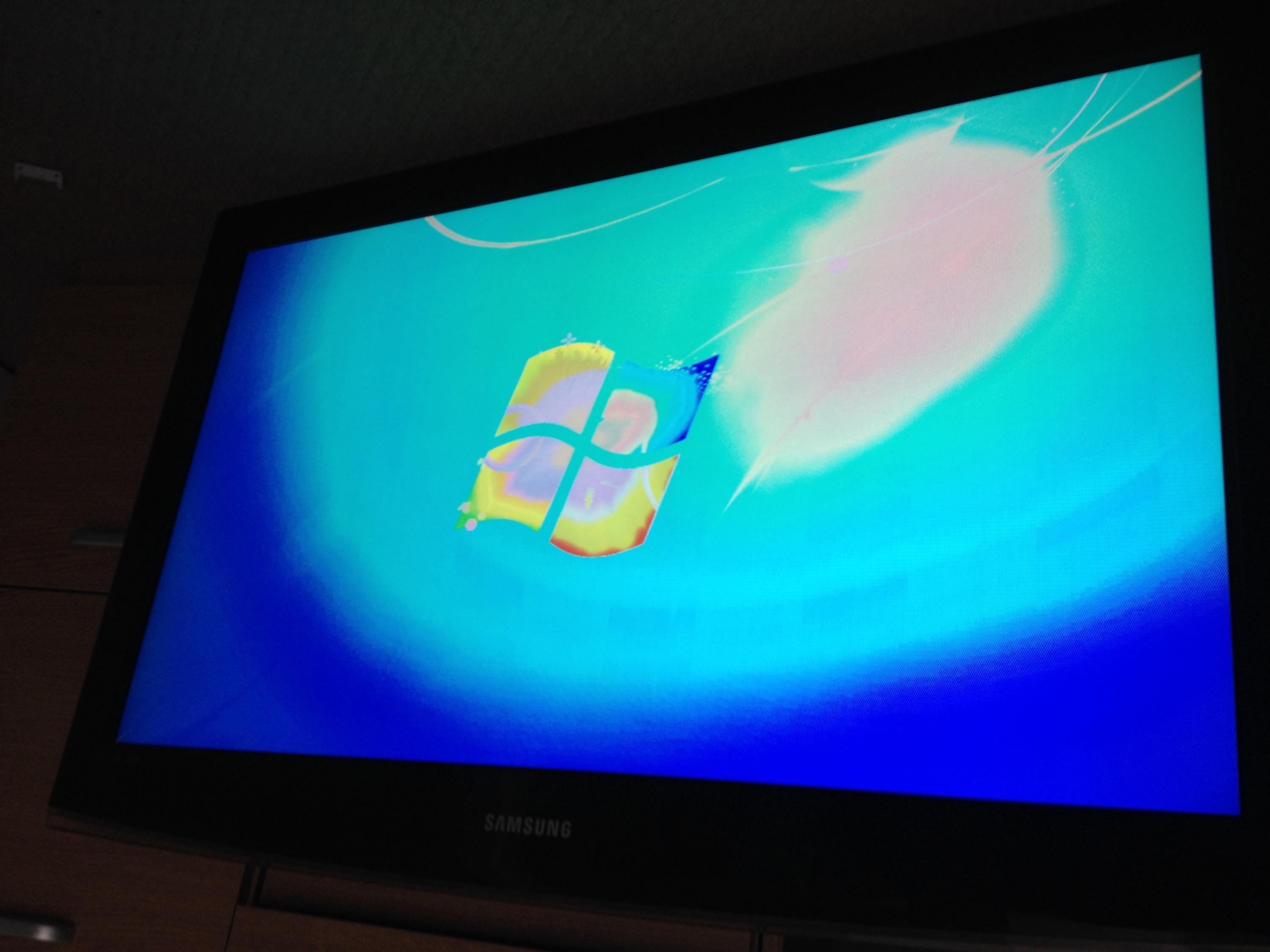

Samsung LE37A456C2D - image retention issue
    Re: Samsung LE37A456C2D - image retention issue
    Panel or t-con, main would not cause this, panel more likely.
      ok thanks tom - i will try a tcon as i cant try a panel lol

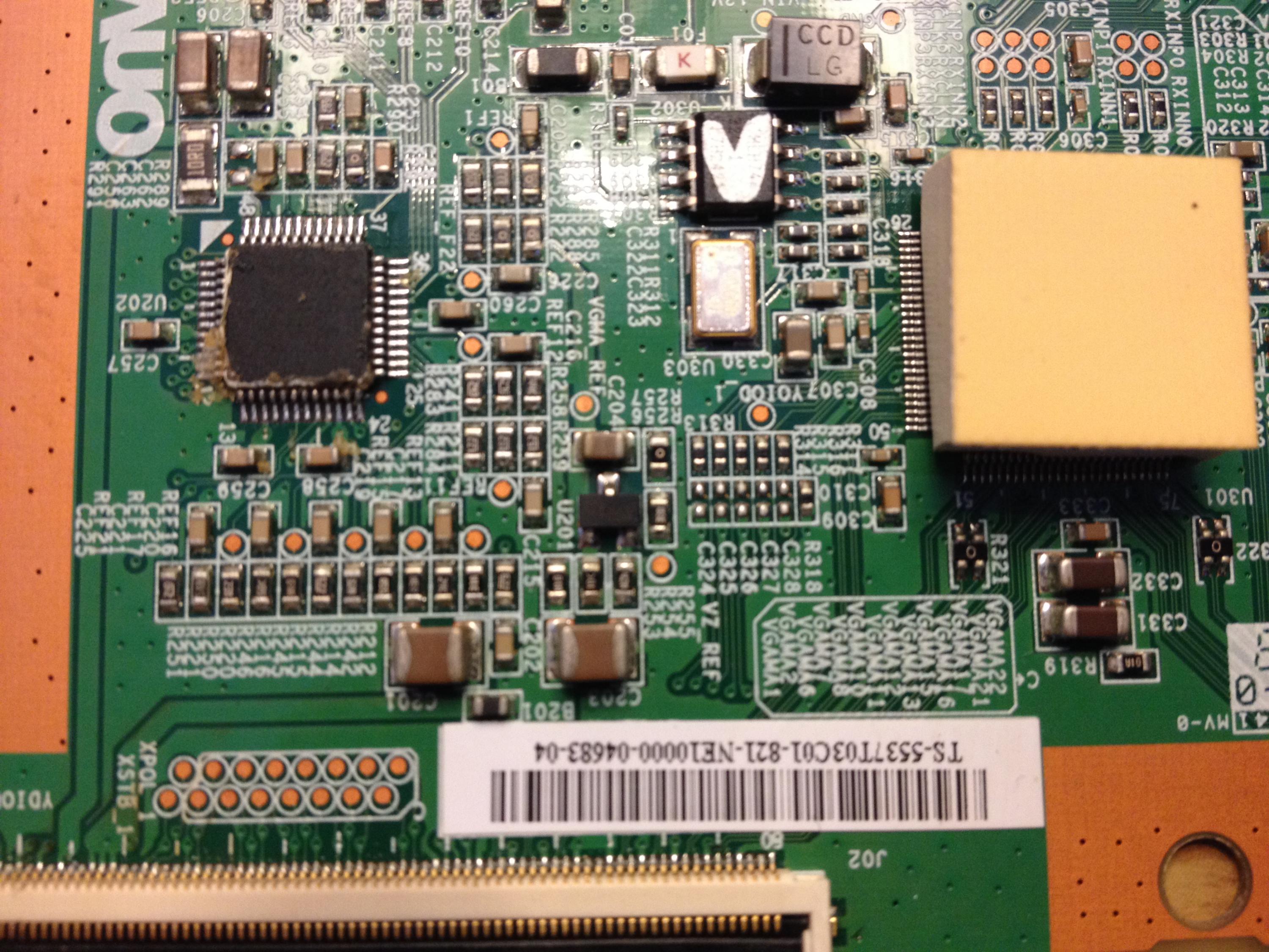

                ok got the new tcon - bought as "tested"
                so i have good news and bad news
                good is the image retention does not happen anymore
                now the problem is colour washed out like an xray sort of thing
                iv read this is the gamma chip is that correct also how difficult is it to replace?

                  Can you see any points marked VGAMA1 thru VGAMA22 or so? Test the voltage on each.

                    #29
                    this is bad IR tcon so i take it that refers to the IC in the top left of the pic ?
                      #30
                      The group of test points marked VGAMA1, etc. You will have to find some of the missing ones (need to get all from VGAMA1 thru VGAMA22 or whatever it goes up to.)

                        #31
                        there are 16 points there and only 14 on the lable
                          #32
                          There's a box around the gamma points. The other two are independent points for other signals.
                          You also need to find VGAMA3,4,5,9,18,19,20 which are going to be scattered elsewhere around the board.

                            #33
                            update on this - gamma tested bad - got a new chip installed and tv works fine now
