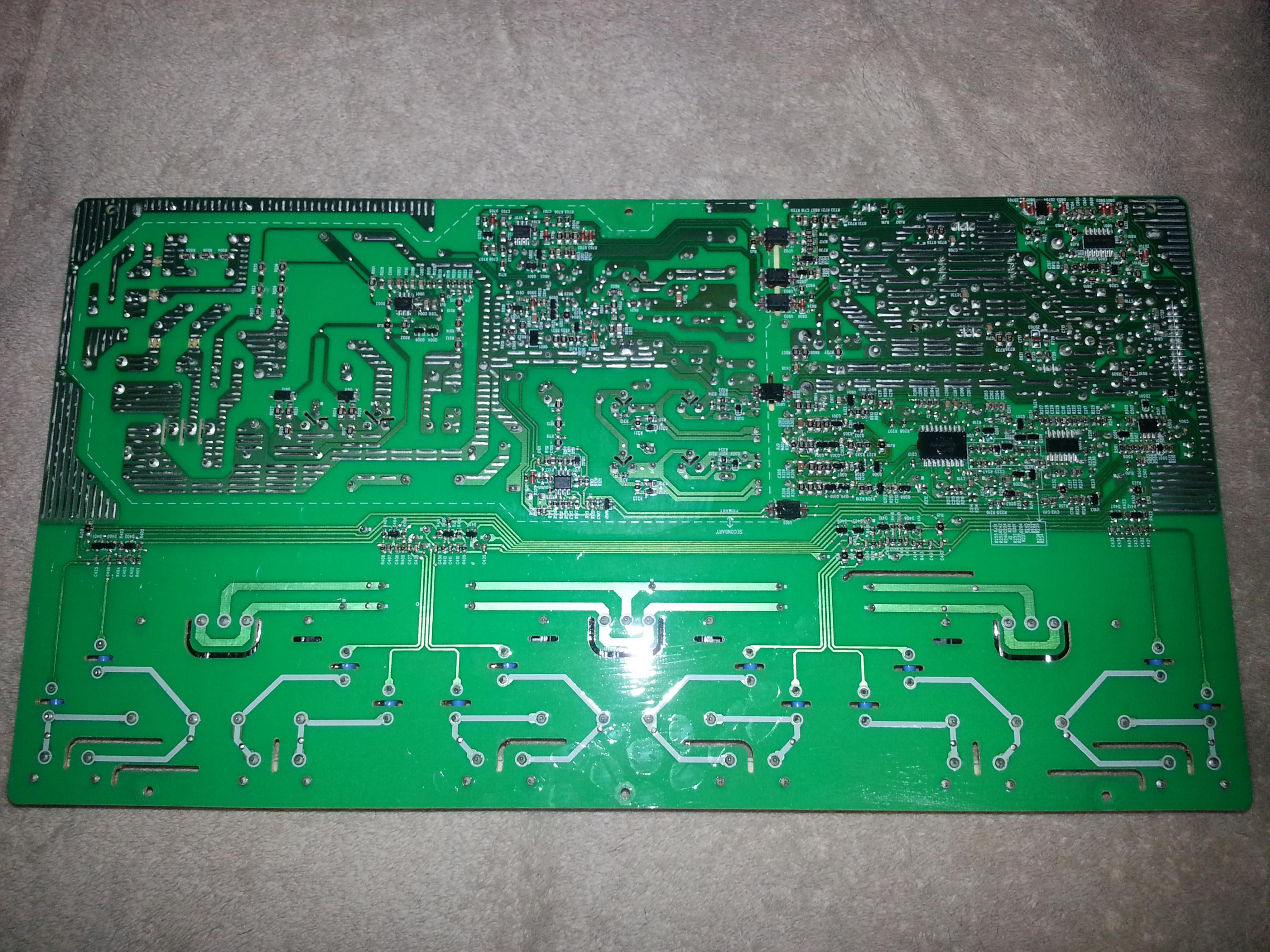

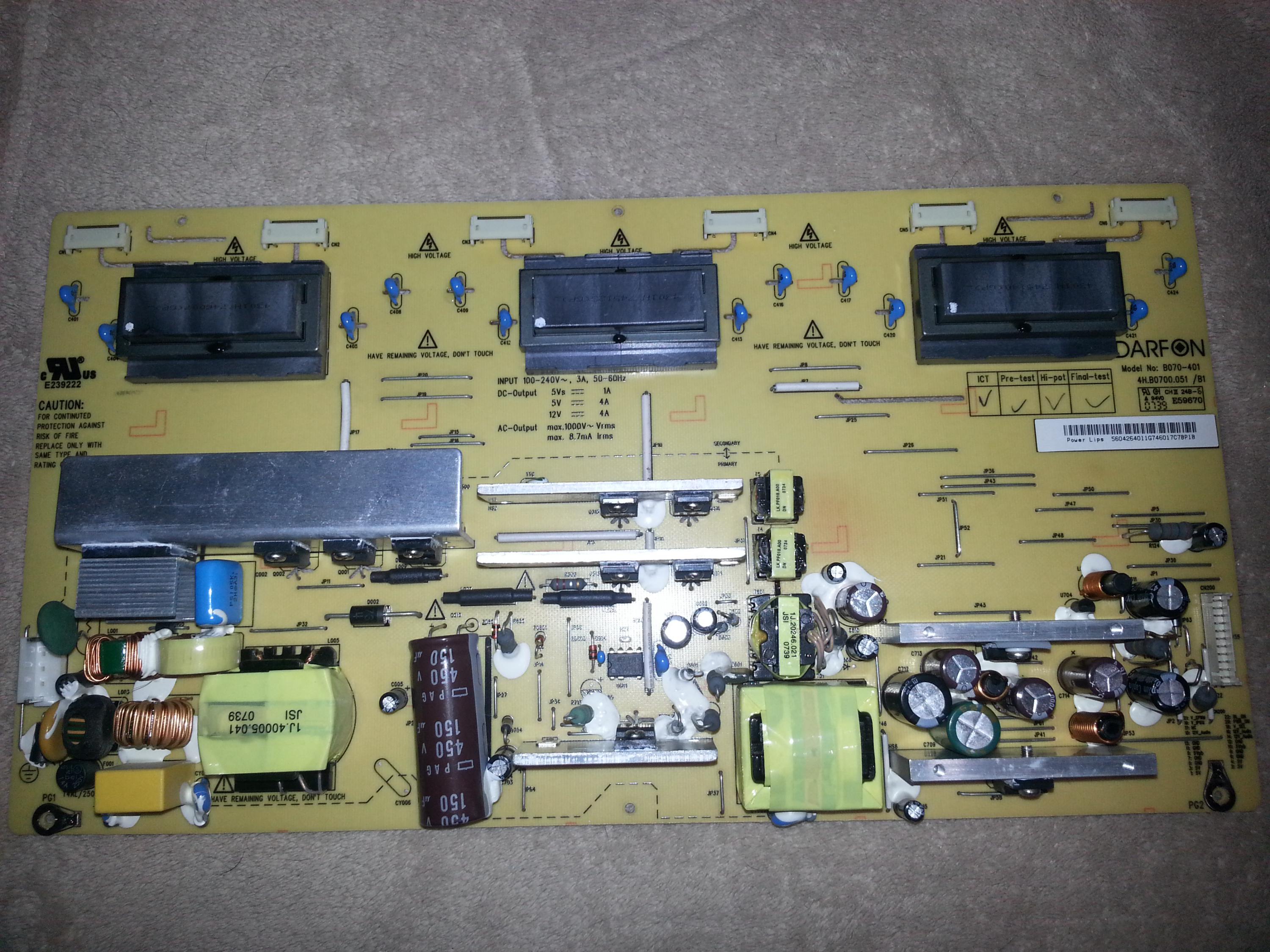

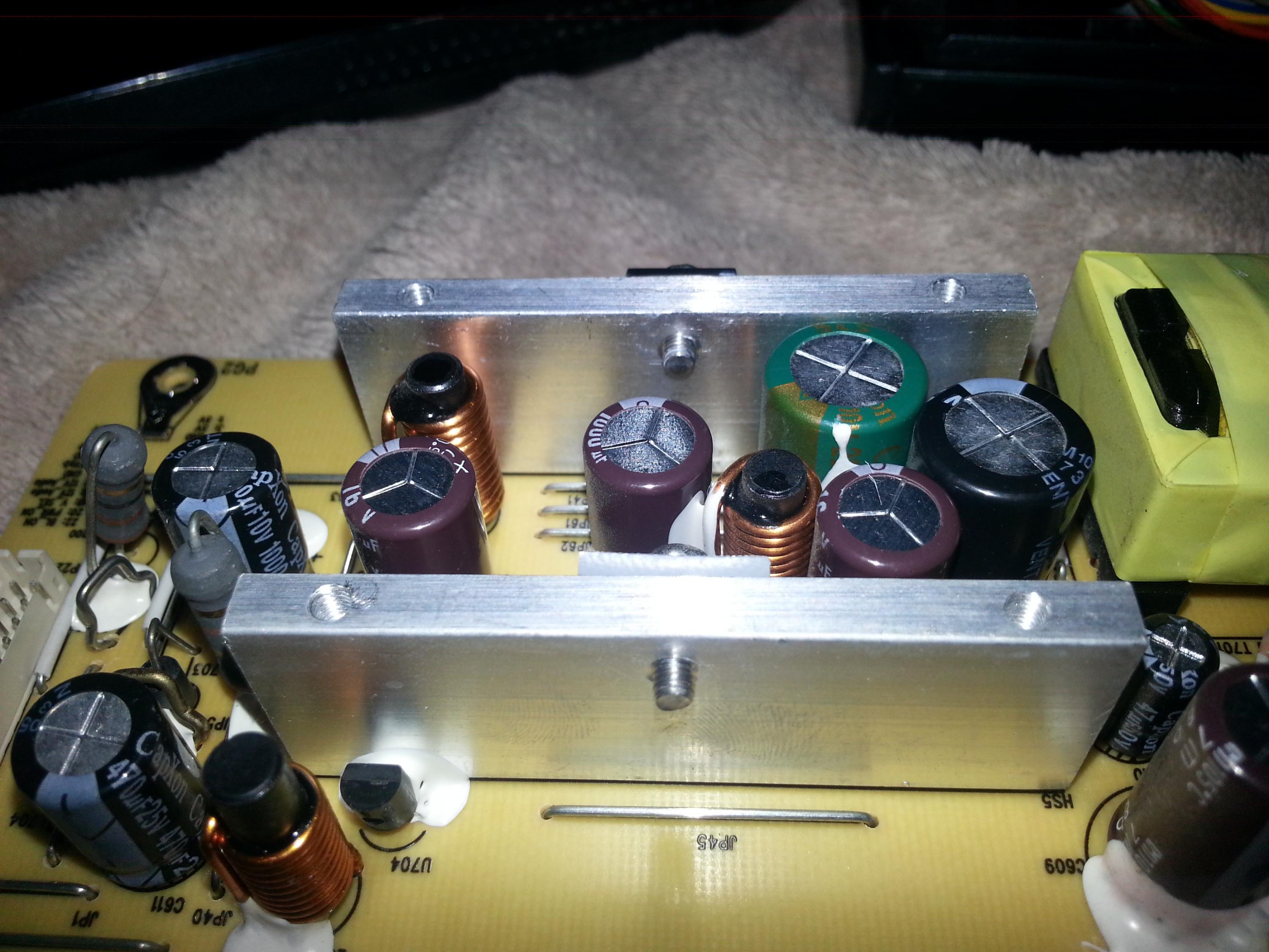

Hello I am new to forum and the tv fixing and have been doing some reading about the Westinghouse SK-32H240S and having the "w" come on then go out after a few seconds. if I leave it on it turns to orange. I have taken the board off and I see no obvious signs of a problem? could there be a blow cap without the top being pushed. here are some pics of the board.
Westinghouse SK-32H240S trouble
Re: Westinghouse SK-32H240S trouble
You need to replace with good quality caps panasonic fr fm or fc or nichicon or rubycon equivalents bought from a good supplier. Caps from radioshack are not suitable for this purpose and there are many fakes on ebay.Please upload pictures using attachment function when ask for help on the repair
