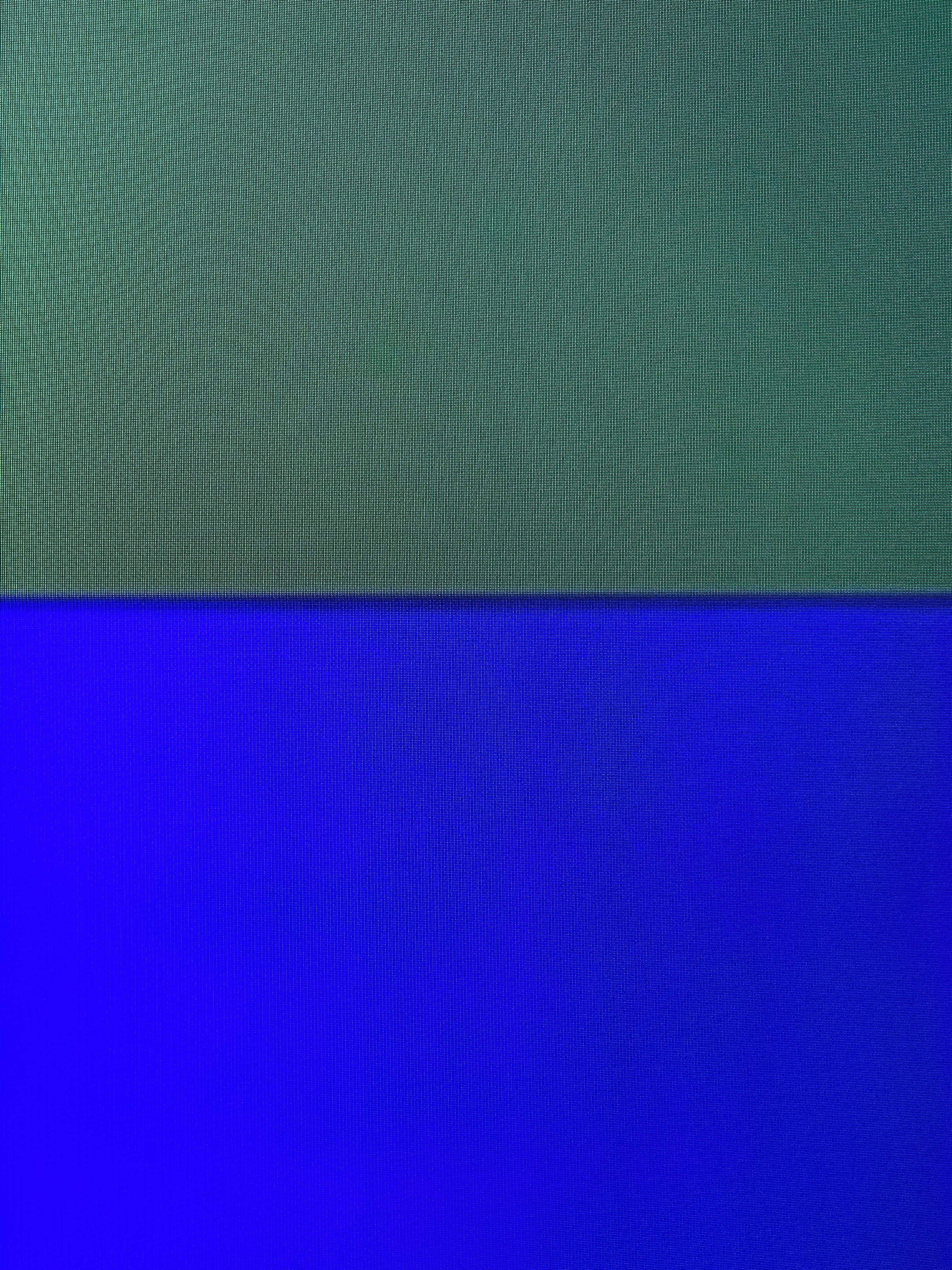

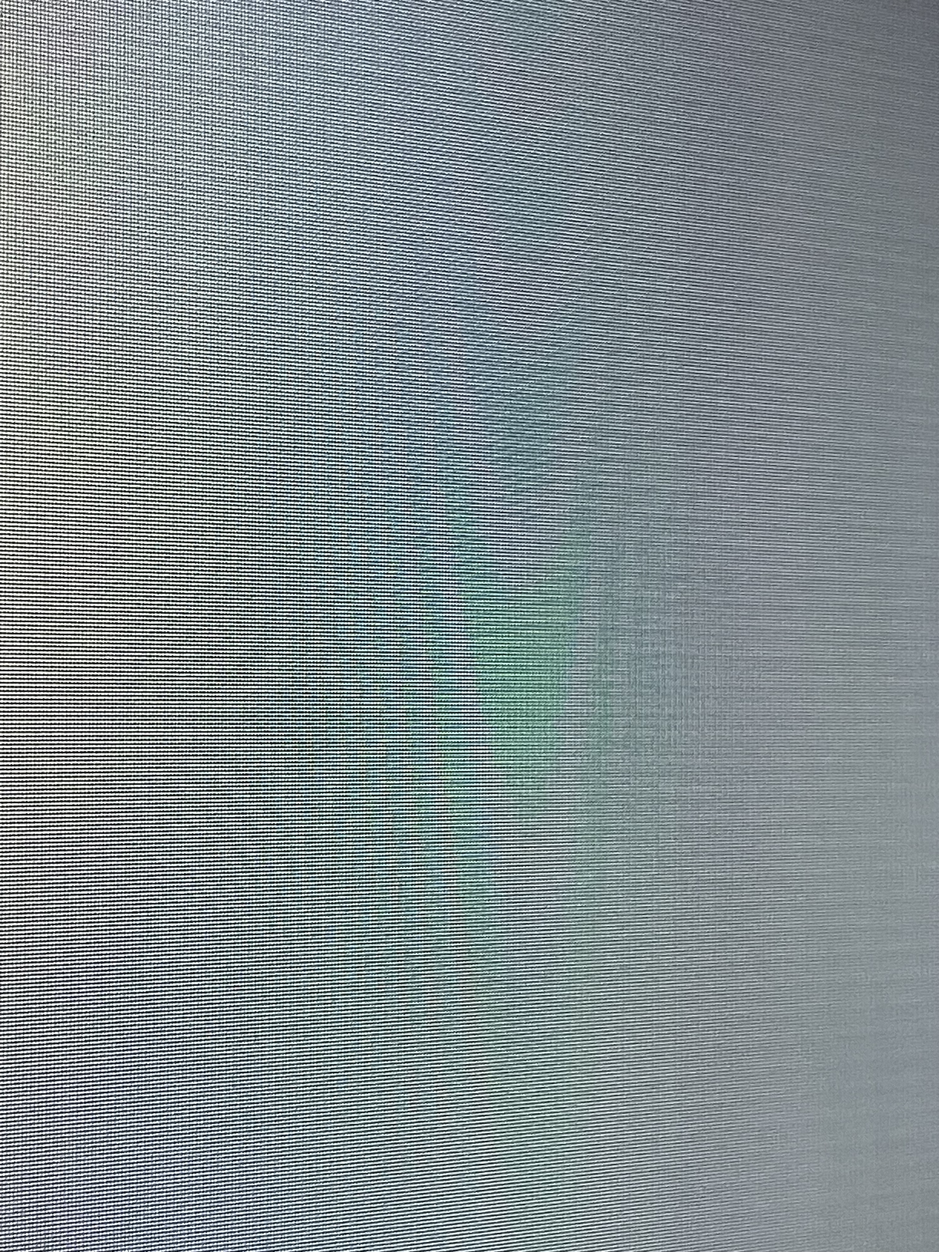

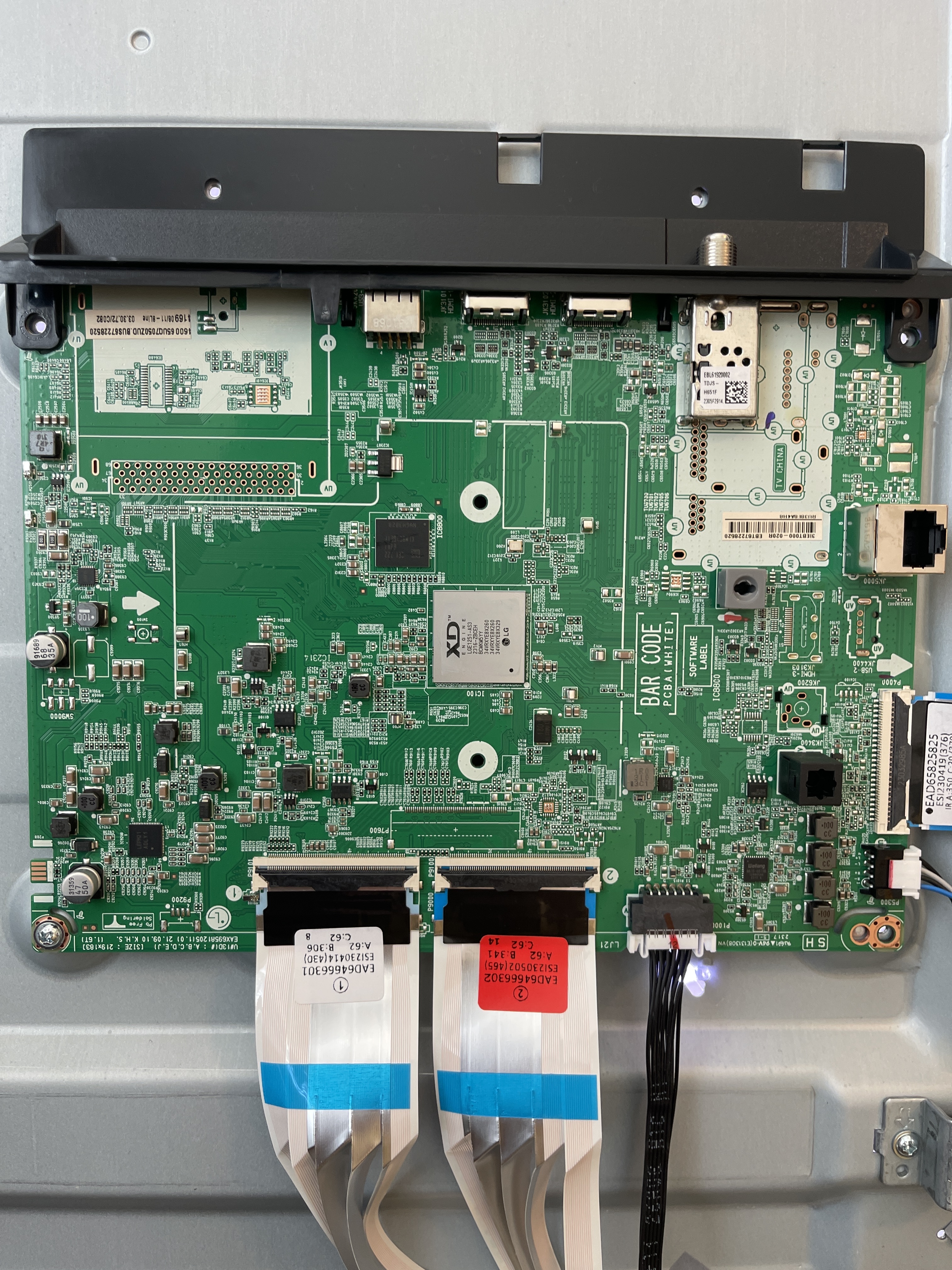

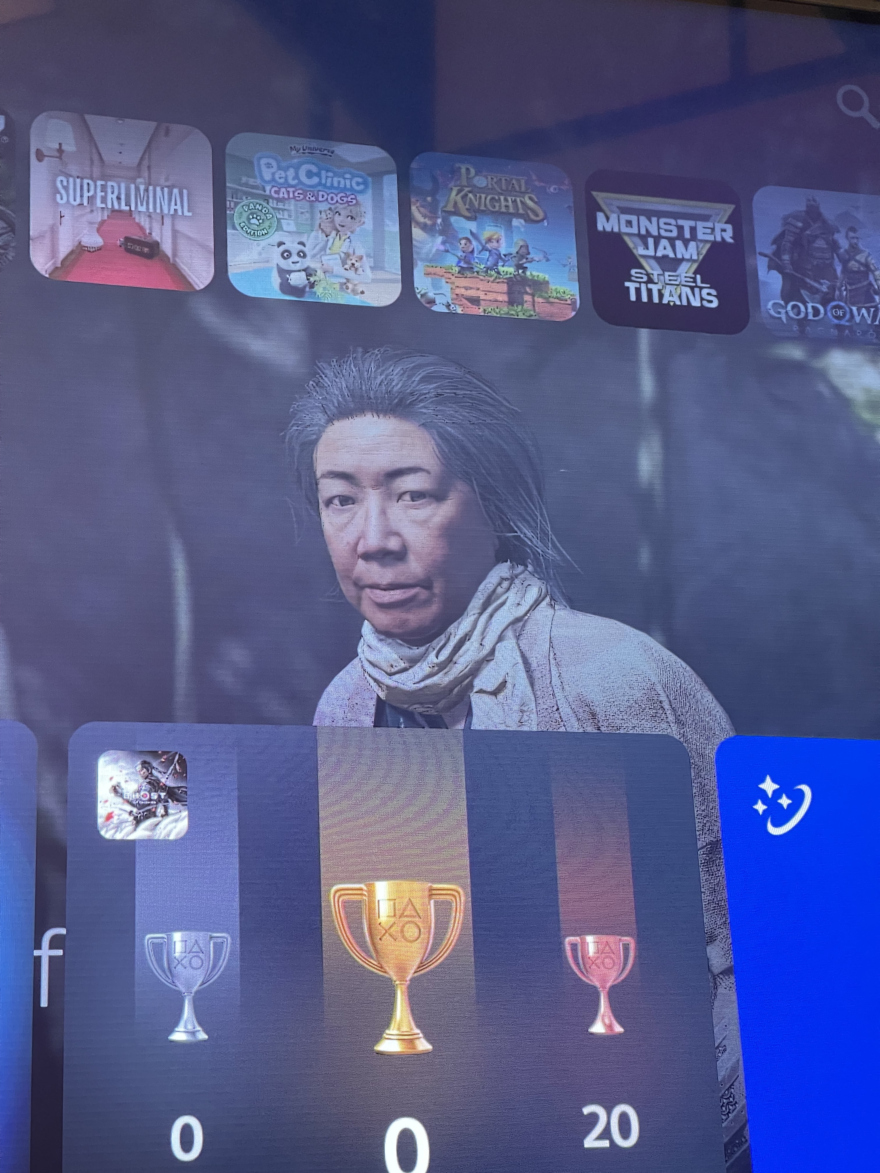

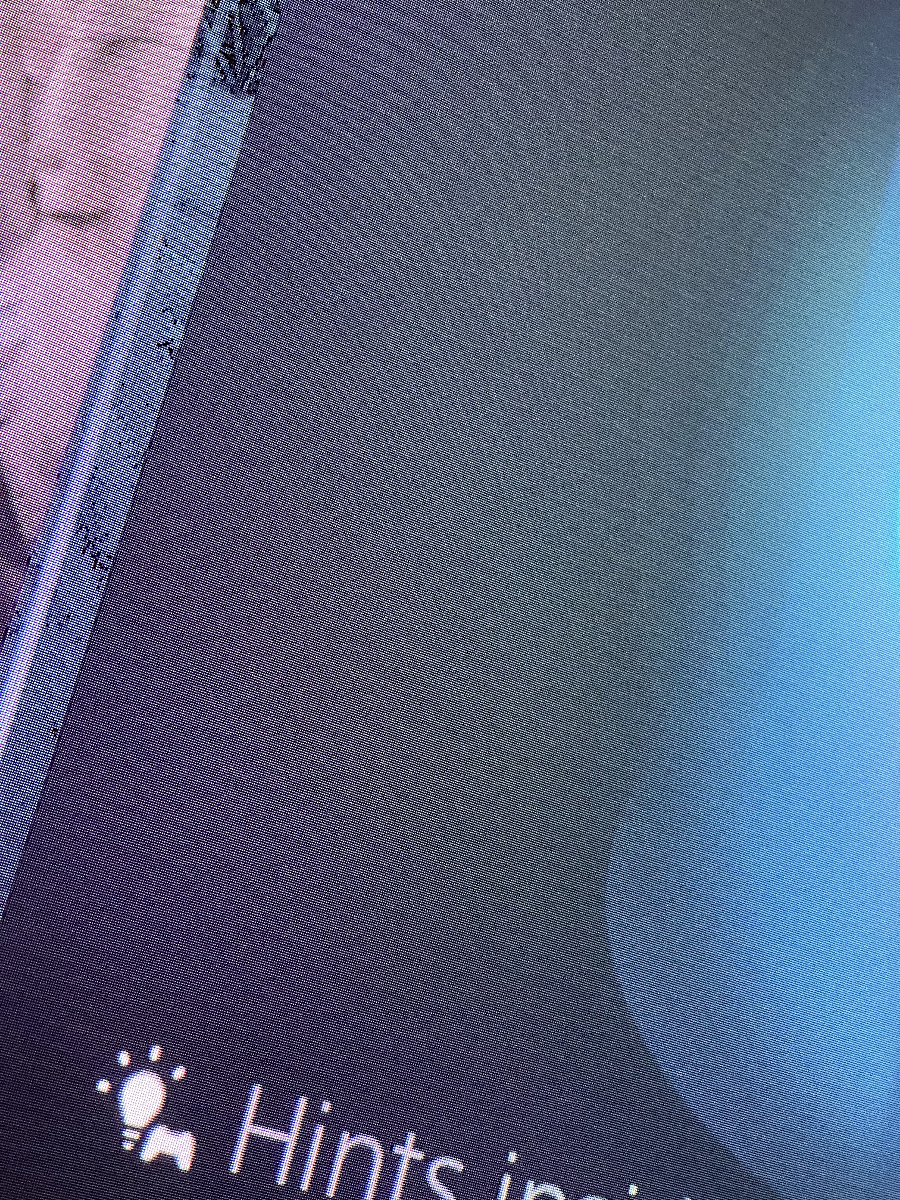

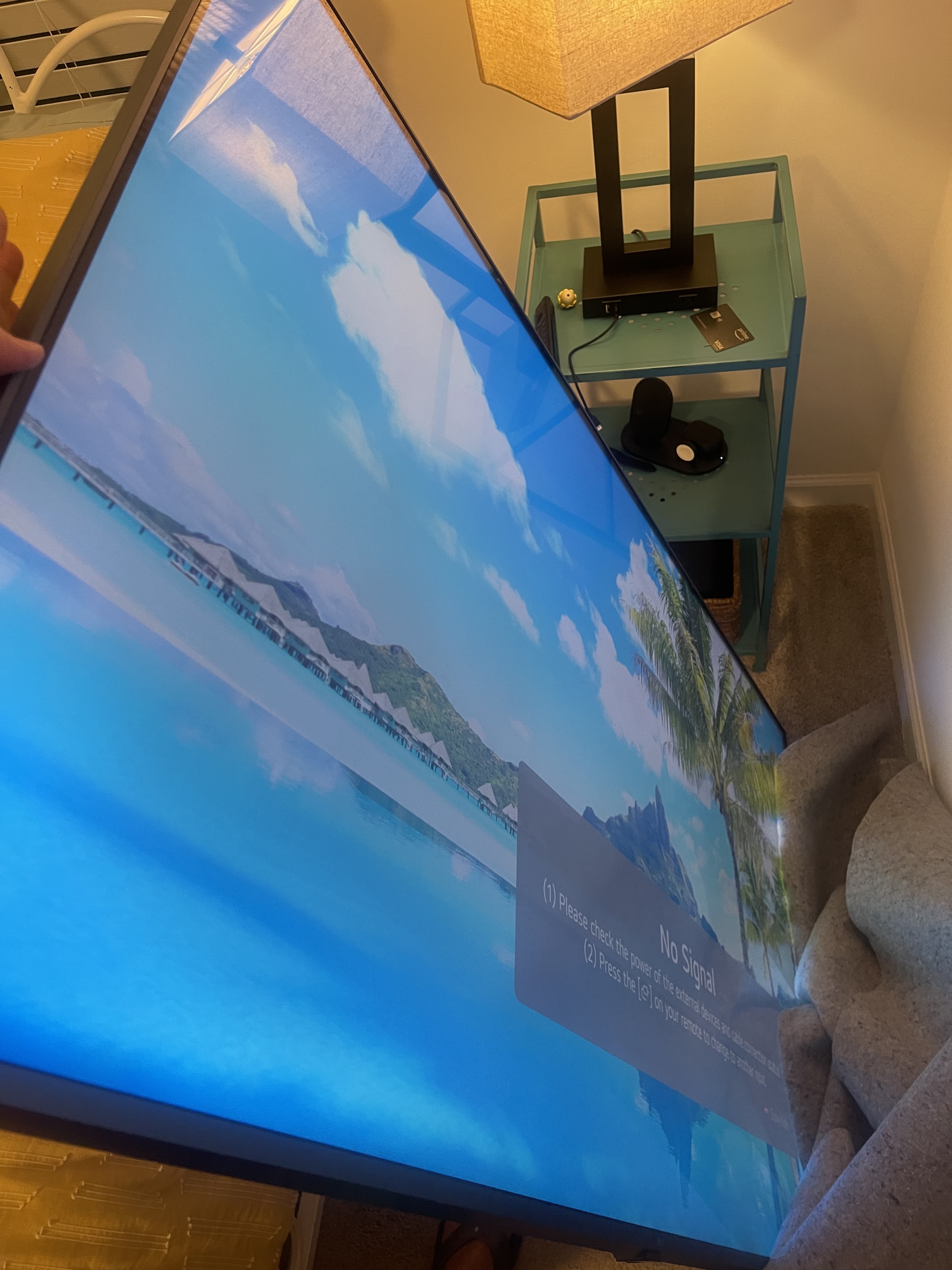

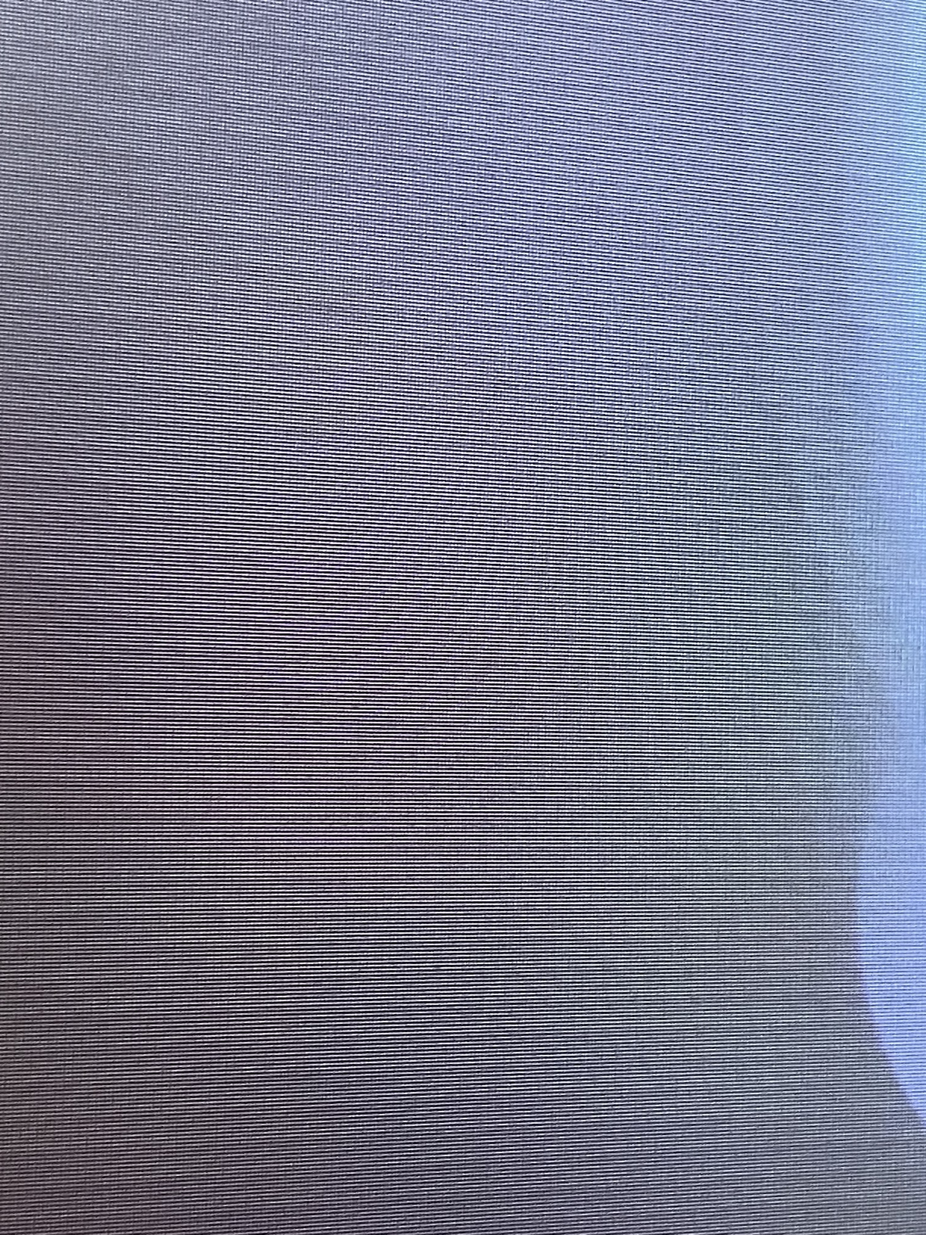

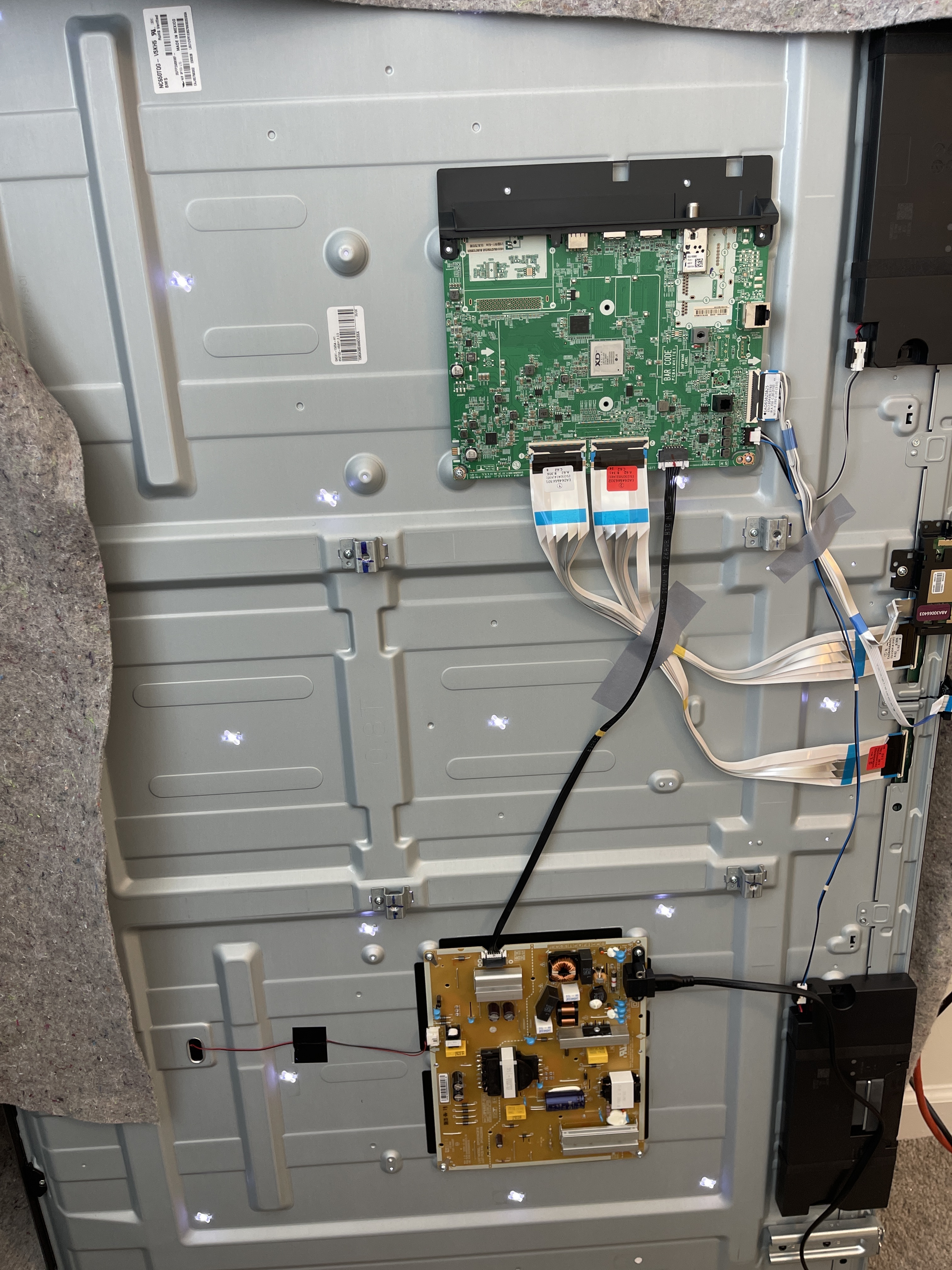

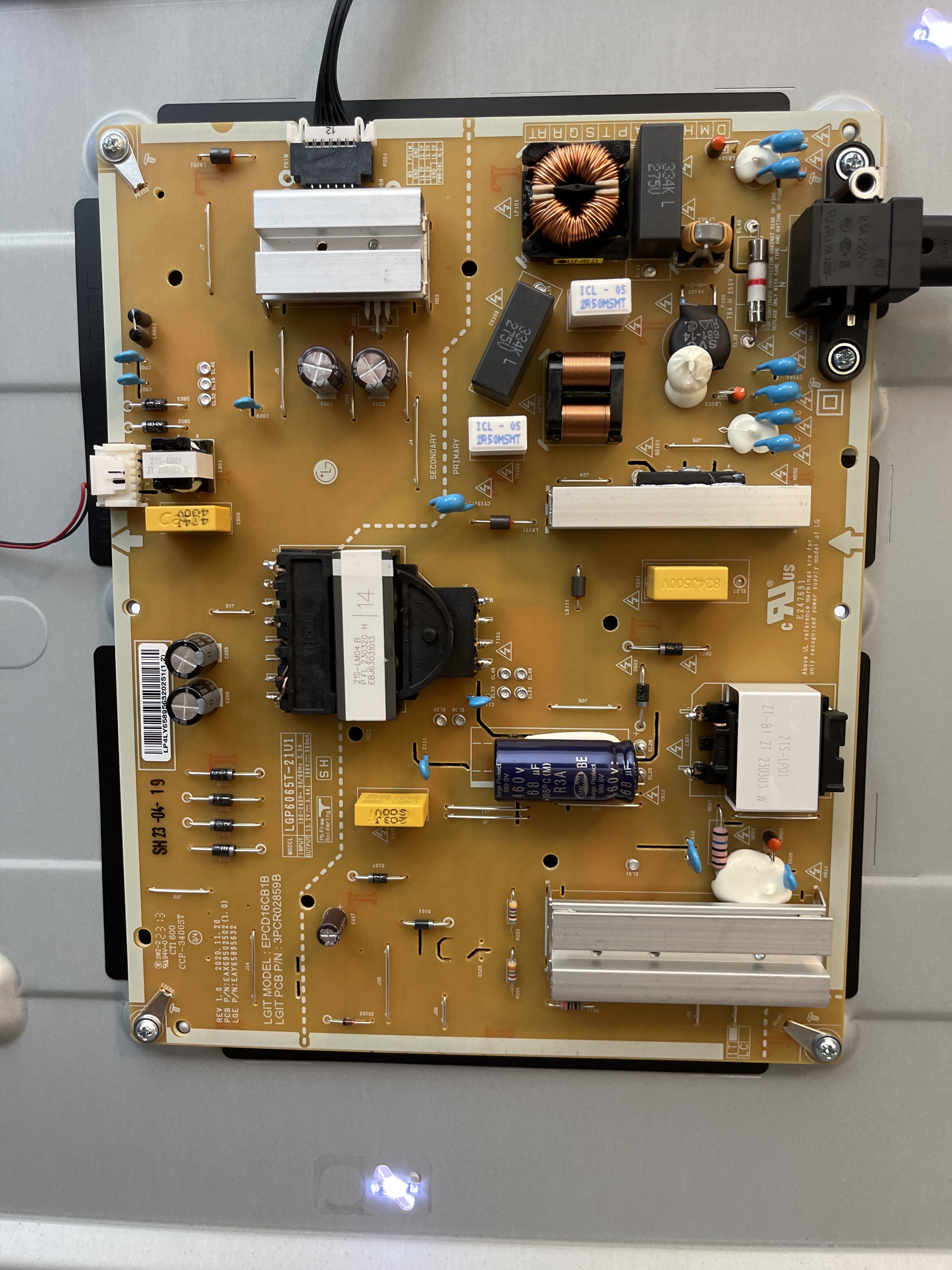

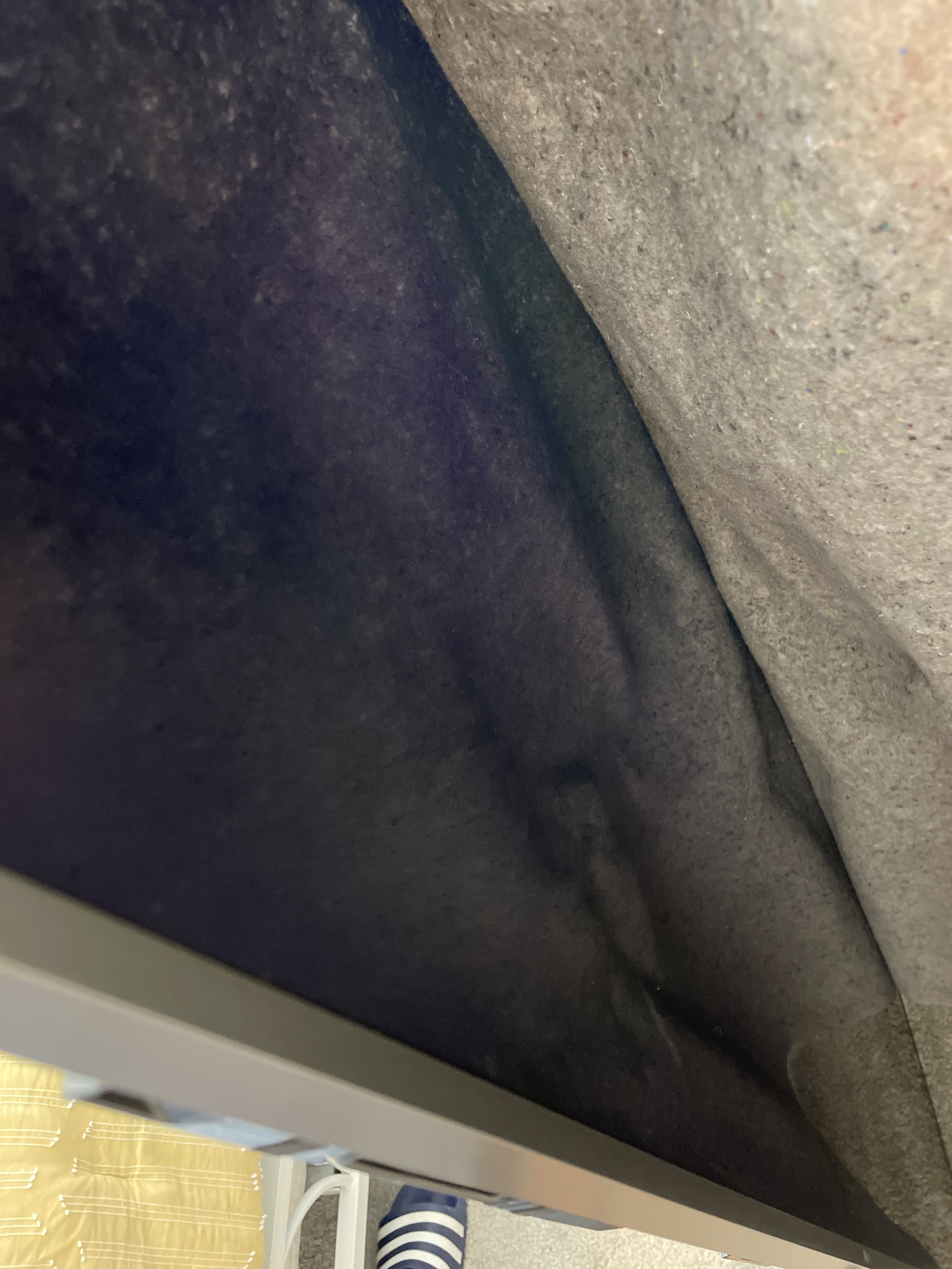

Try our *UPDATED* boardview, bios, & schematic search. Over 2.3 million files for download!
LG 65UQ7050ZUD No Picture Backlight On
  • ChattFix
    • Oct 2021
    • 79
    • US
    LG 65UQ7050ZUD No Picture Backlight On
    Hey everyone, I have an LG 65uq7050zud with a black picture but backlight is on. I tested the measurements from the PSU and they check out. I can’t find any service manual so I’m suspecting the main board. Any advice before I replace the board? Found them for around $60
    Premium supporters get full download access and other benefits.
  • EazyBone
    • Jun 2023
    • 1438
    • United states
    • Anything I can do with my hands
    Just with experience I would be suspect of the panel. Did you try disc each side of ribbon cable to get 1/2 or 3/4 picture yet? Or tape any of the ribbon pins just to test to see? Alot of lgs I get in America are bad because of panel issues with same symptoms you talk about.
    • ChattFix
      • Oct 2021
      • 79
      • US
      Originally posted by EazyBone
      Just with experience I would be suspect of the panel. Did you try disc each side of ribbon cable to get 1/2 or 3/4 picture yet? Or tape any of the ribbon pins just to test to see? Alot of lgs I get in America are bad because of panel issues with same symptoms you talk about.
      I checked the panel by removing the left and right side ribbon and still didn’t get a picture. I’m also not getting any audio. A weird thing I notice is when I turn the tv off I hear a clicking sound coming from the main board. Near the main IC. I uploaded a video of it.
      Premium supporters get full download access and other benefits.
      • EazyBone
        • Jun 2023
        • 1438
        • United states
        • Anything I can do with my hands
        Just removing each side doesn't necessarily work sometimes, continue on with tape on both sides covering like 10 pins at a time. Take a couple minutes and check that.
        • Diah
          • Feb 2013
          • 6736
          SHORT OR CUT of VCC 3 V ON PANEL BOARDS
          • ChattFix
            • Oct 2021
            • 79
            • US
            Originally posted by EazyBone
            Just removing each side doesn't necessarily work sometimes, continue on with tape on both sides covering like 10 pins at a time. Take a couple minutes and check that.
            I’ll do the tape tonight!
            • ChattFix
              • Oct 2021
              • 79
              • US
              Originally posted by EazyBone
              Just removing each side doesn't necessarily work sometimes, continue on with tape on both sides covering like 10 pins at a time. Take a couple minutes and check that.
              So I looked at where the diodes are on the board and noticed ribbon 1 has them all. I placed tape on maybe 10-15 just to give it a shot and the picture is perfect. I’m kinda confused because I read how this should degrade the picture or lose potential colors?
              Should I just leave it and call it fixed until it fails?
              Premium supporters get full download access and other benefits.
              • EazyBone
                • Jun 2023
                • 1438
                • United states
                • Anything I can do with my hands
                If you go YouTube and watch screen test video ( type that) and look and see if there is lines or discoloration. But probably panel is shorted somehow.
                • ChattFix
                  • Oct 2021
                  • 79
                  • US
                  Originally posted by EazyBone
                  If you go YouTube and watch screen test video ( type that) and look and see if there is lines or discoloration. But probably panel is shorted somehow.
                  So it seems I am missing some horizontal lines. Should I start trimming the tape to see how good I can get it?
                  Premium supporters get full download access and other benefits.
                  • EazyBone
                    • Jun 2023
                    • 1438
                    • United states
                    • Anything I can do with my hands
                    Up to you. But hey, saved ya $60 lol.
                    • ChattFix
                      • Oct 2021
                      • 79
                      • US
                      Originally posted by EazyBone
                      Up to you. But hey, saved ya $60 lol.
                      Haha exactly. I put it back together and called it a day. How long do you think it will last?
                      • EazyBone
                        • Jun 2023
                        • 1438
                        • United states
                        • Anything I can do with my hands
                        You never know. My guess is 6mo
                        • snirsnir
                          Samsung QE65Q67AAUXXH (65" QLED) - Bootloop, no logo, no hot components found
                          by snirsnir
                          I have a Samsung QE65Q67AAUXXH (2021 QLED, 65").
                          Panel: CY-QA065HGSV1H
                          Main board: BN41-02844A (BN94-16448X) - T-CON integrated, no separate T-CON board.
                          SYMPTOMS:
                          - Immediate bootloop on power-on - backlight flashes on for ~1 second then shuts off, repeats endlessly.
                          - No Samsung logo, no picture at any point.
                          - Sound never plays.
                          WHAT I'VE DONE SO FAR:
                          1. Disconnected both 90-pin ribbon cables from mainboard → TV powers on, backlight stays on steady. No bootloop. Confirmed mainboard and PSU...
                          04-23-2026, 06:10 AM
                        • Tr0ll
                          by Tr0ll
                          Original T-con:
                          First replacement T-con:
                          10-07-2023, 07:48 PM
                        • triplefour
                          by triplefour
                          09-13-2023, 10:43 PM
                        • usmantemuri
                          TCL 55-Inch TV No Picture, Only White Screen After Ribbon Cable Test
                          by usmantemuri
                          I have a 55-inch TCL TV with a T-Con board model ST5461D04-1-C-7.
                          I saw on the internet that if one of the panel ribbon cables is disconnected, the TV may display half of the screen. However, in my case, when I disconnect either ribbon cable, that side of the screen turns completely white. The same thing happens on the other side as well.
                          There is no picture at all—only a white screen appears when either ribbon cable is removed.
                          08-01-2026, 04:47 AM
                        • Mgiffune
                          by Mgiffune
                          06-09-2024, 10:28 AM
