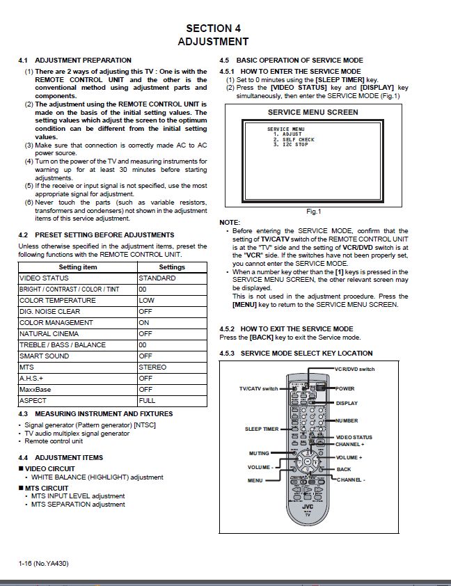

    Here's a quick rundown, I've done tons of research on this but haven't found the answer I need yet. So I put it to you guys to see if you may have an answer for me.
    I have a JVC LT40X887 TV that had an issue with the power supply and needed the transformer reflowed. So unfortunately I tested it with the back off, and you guessed it. I was booby'd. So now of course every thing is all buttoned up and the TV is fixed but, you guessed it, HDMI's aren't working. So I researched and found I need to reset the hdmi's via self check in the service menu. Only problem is I don't have the original remote.
    So my questions:
    Do I have to have the original remote to access the service menu or can this be done via the button on the tv
    Or is there a way to reset this via jumpering pins on the board itself.
    Any help will be greatly appreciated, thanks in advance.

    Yes you will need the Original JVC remote attached is the procedure

      Ok thank you, was afraid of that. Guess I'll have to find an oem remote
