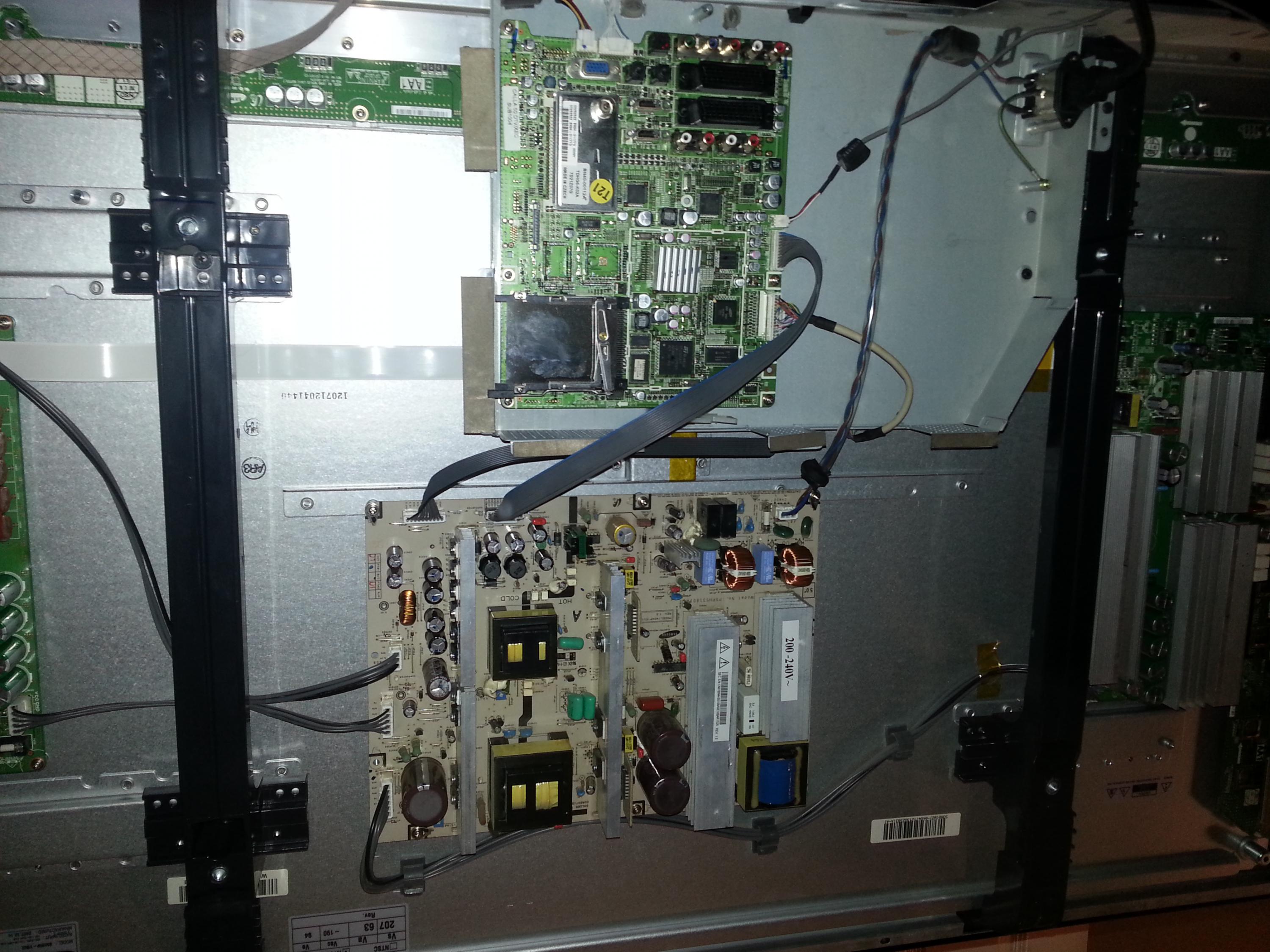

              Re: samsung 50 inch plasma
              It powers up makes start up noise but no pic if I take x main out I get stable power to the y main to the black connectors but I unplug the y main and leave the x main in the power fluctuates up and down on the x main black connectors to the buffers but it only fluctuates when the ribbon from the t con board is in if the t con is out it is low but stable
                OK, if you get startup tone, you can just do the jumper on the test pattern mode (control board). From your description it sounds like a bad X-main (when unplugged you should still get a picture, just dim or purple.)

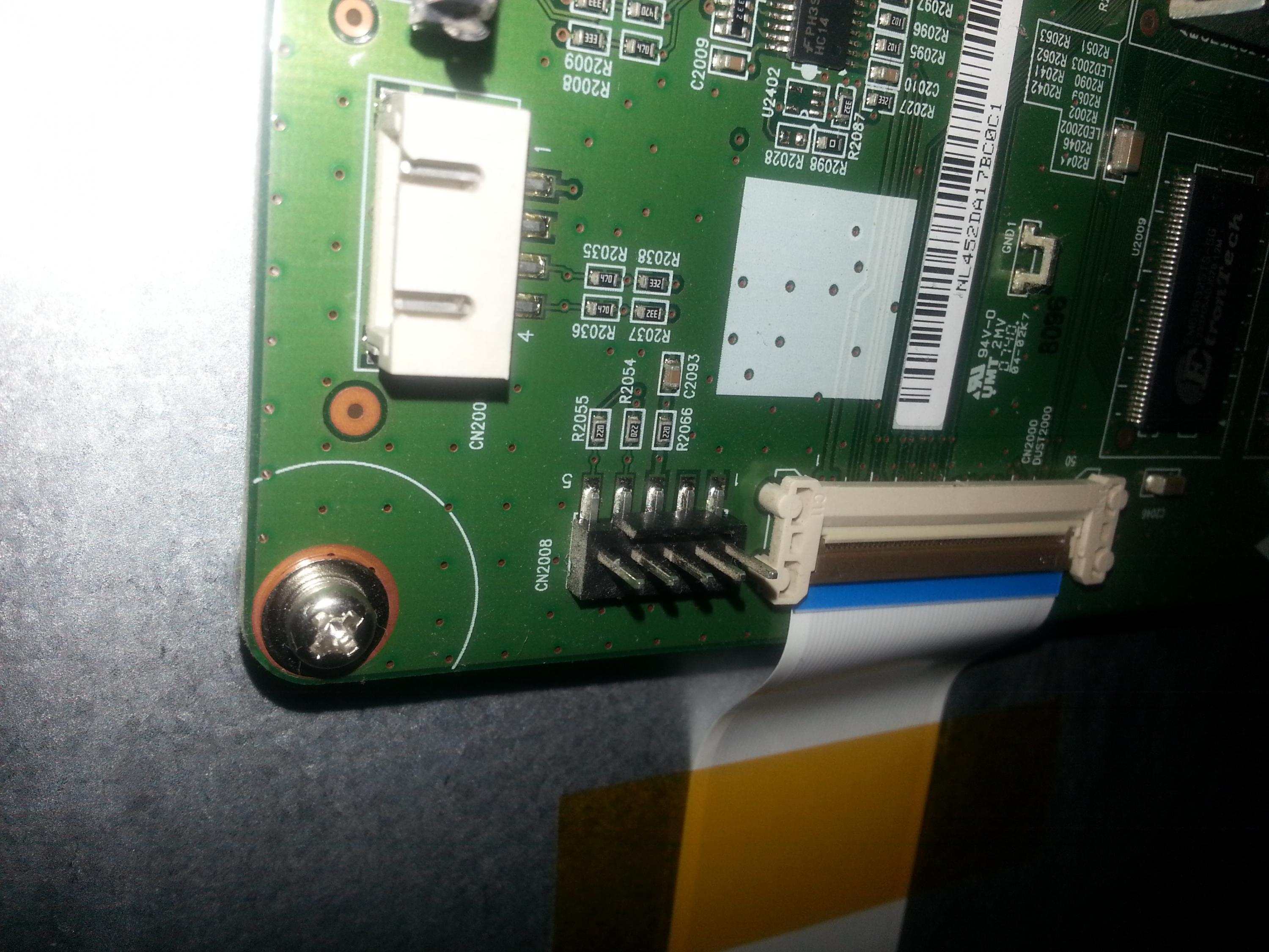

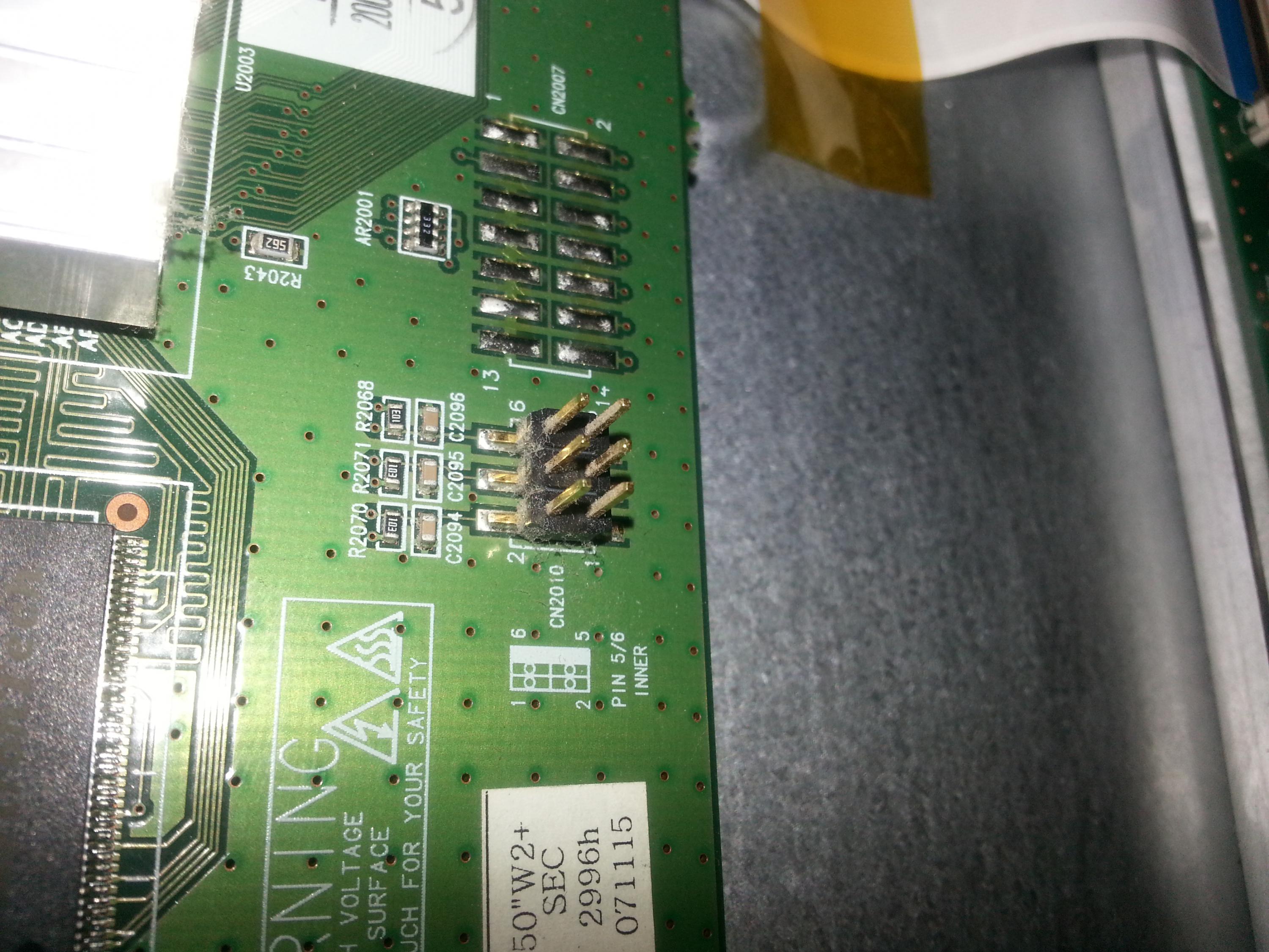

                      Ok I have two plugs one of the top left in a line and one on the bottom
                        Picture please my imagination fails me.
                          These
                              2nd one pins 5-6.
                              Ve a little high probably means someone's had a little play around to get rid of image sparklies.
                                I have tried pins 5 and 6 get nothing

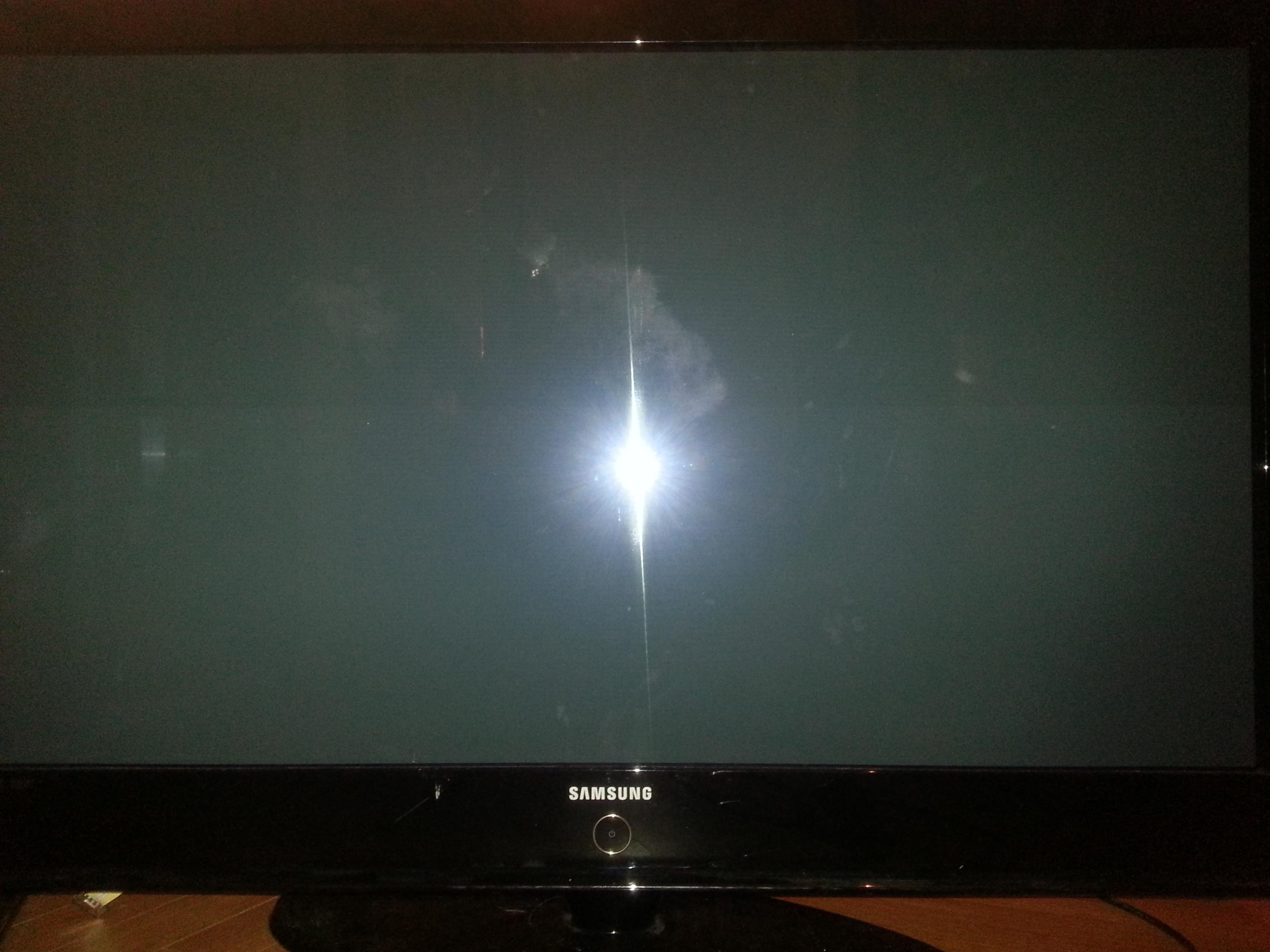

                                    Break through if I take the top buffer off I get the bottom half of the screen on but it's got a black spot in the middle of it
                                      Picture please?
                                        But dark but solved the dark parts never had a ribbon to the x main in
