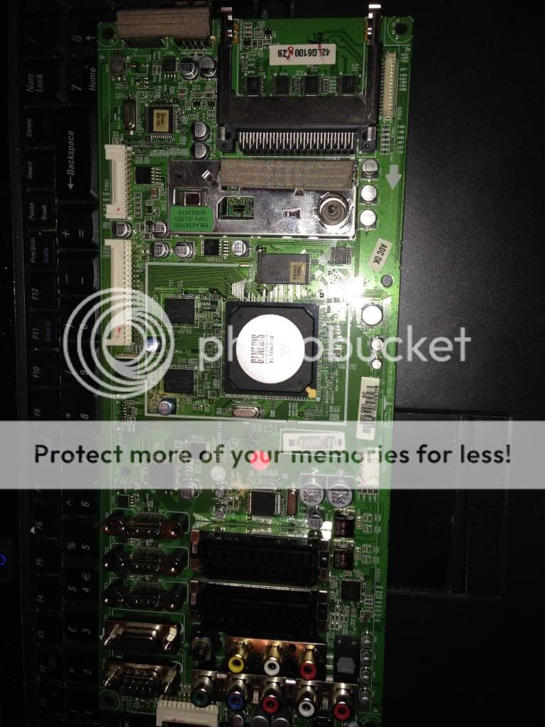

                Re: 42lg6100 horizontal lines going up and down screen
                Post a pic of your main board?
                  thanks tom, wasnt sure if you wanted main power board or main av board..if its powerboard i'll redo pics...
                      i've done abit more checking about on the chips on the av board and found something that looks abit out of the norm... would this cause horizontal lines on all inputs?? thanks in advance.. also any ideas on replacing these coils will be amazing...
                        I think that's just glue. I'd try checking voltage regulators.
                          thanks tom but i think something leaked as when i wiggled the coils it lost picture and comes back.. i think im just going to go with a new mainboard as i've wrecked this one by trying to take the tuner off..also the end pin in the bottom right of that circuit on the black strip is clearly there on the front but on the back its not on the mainboard.. time to hunt down a cheap ld89a board i guess...
