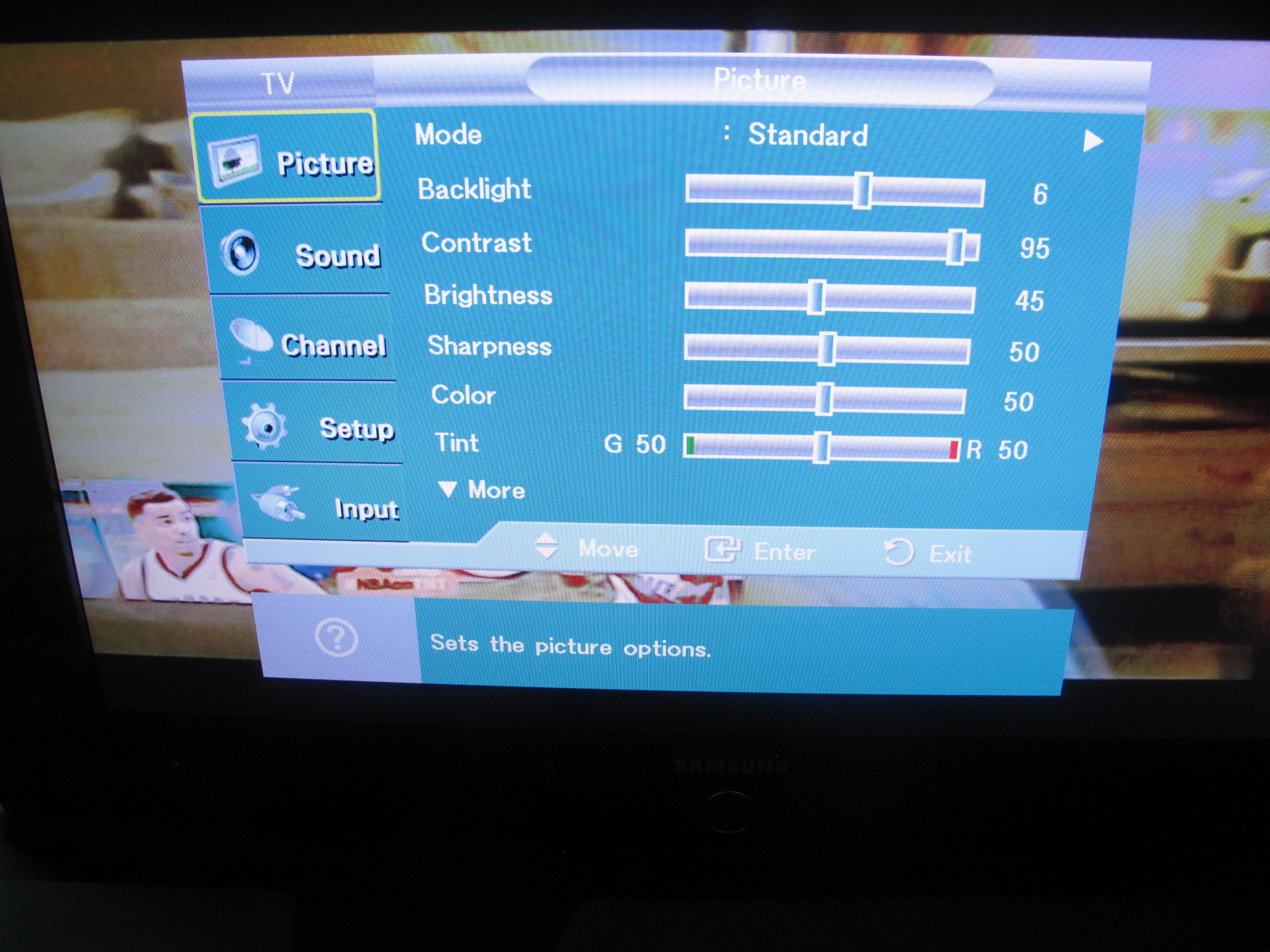

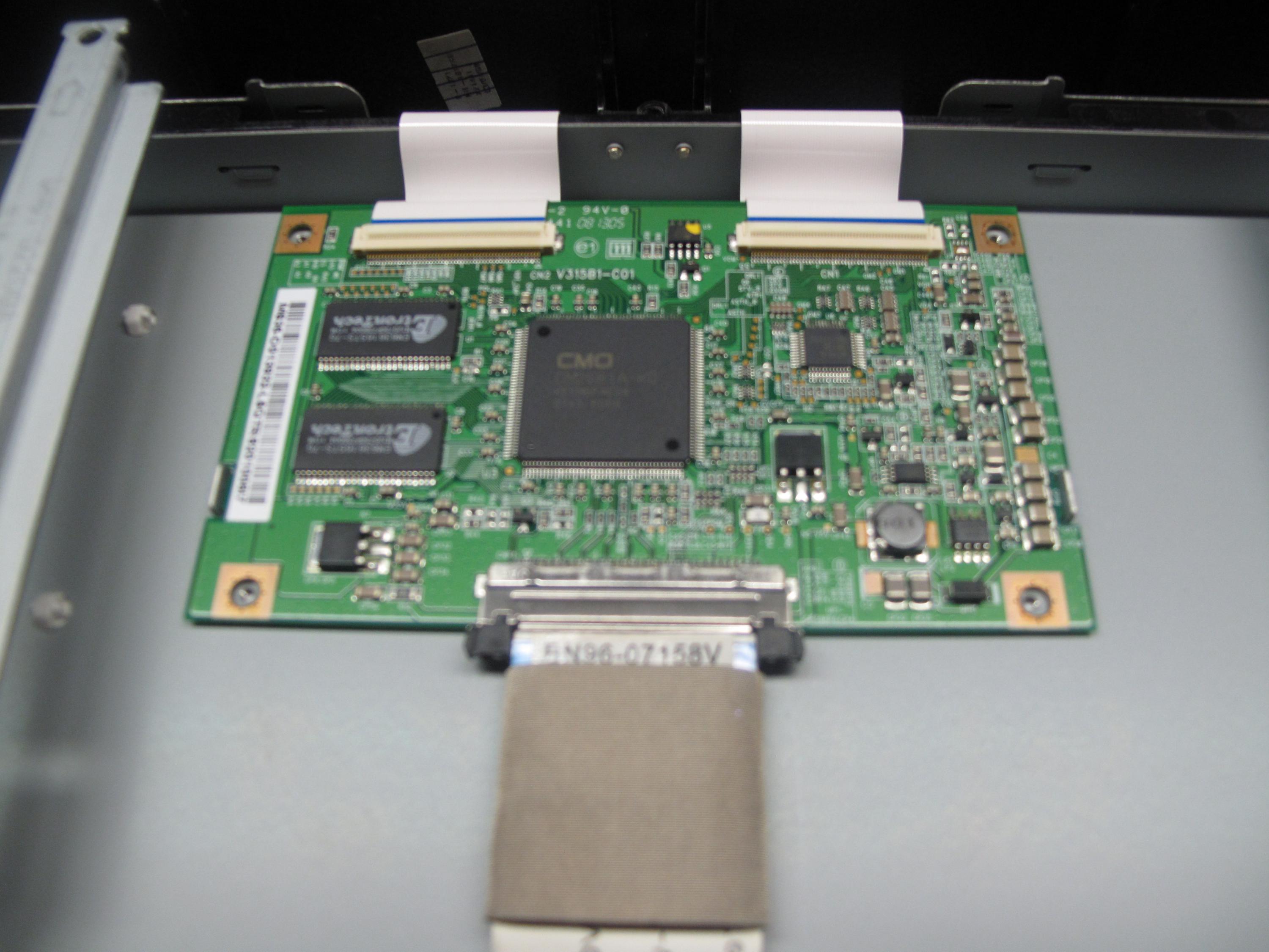

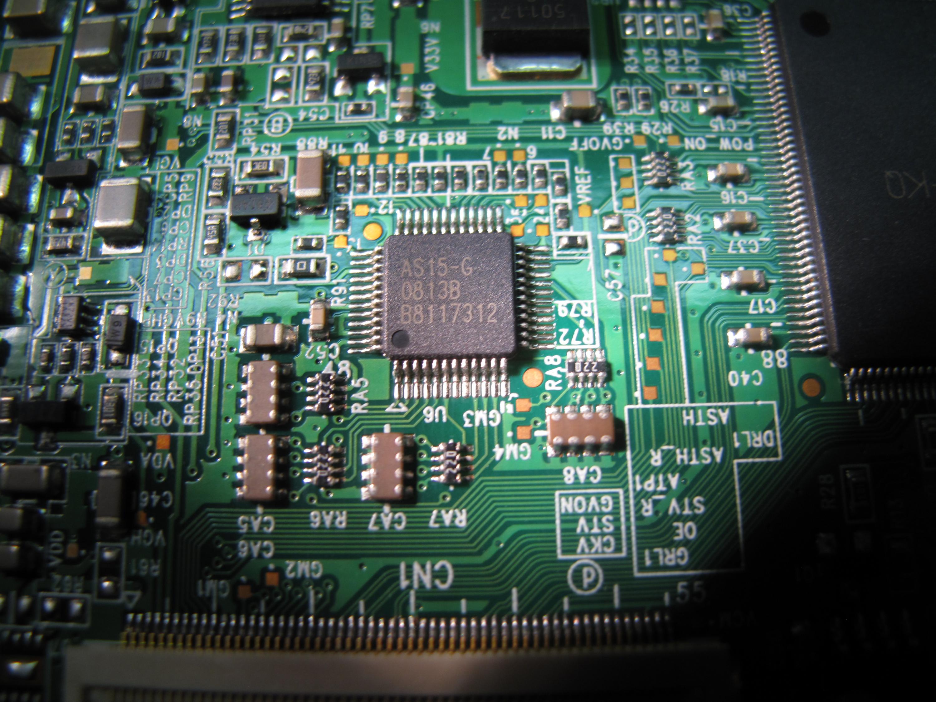

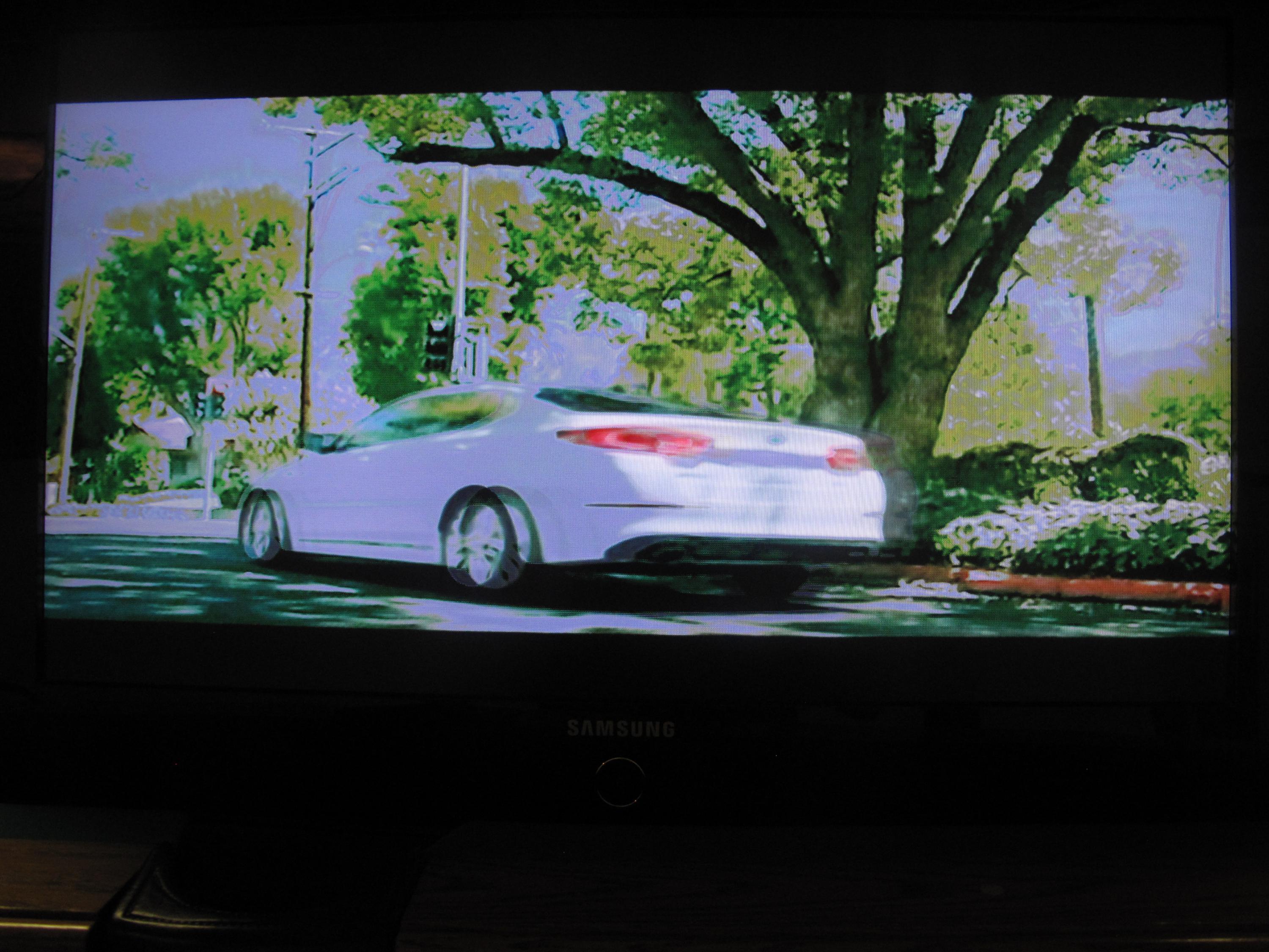

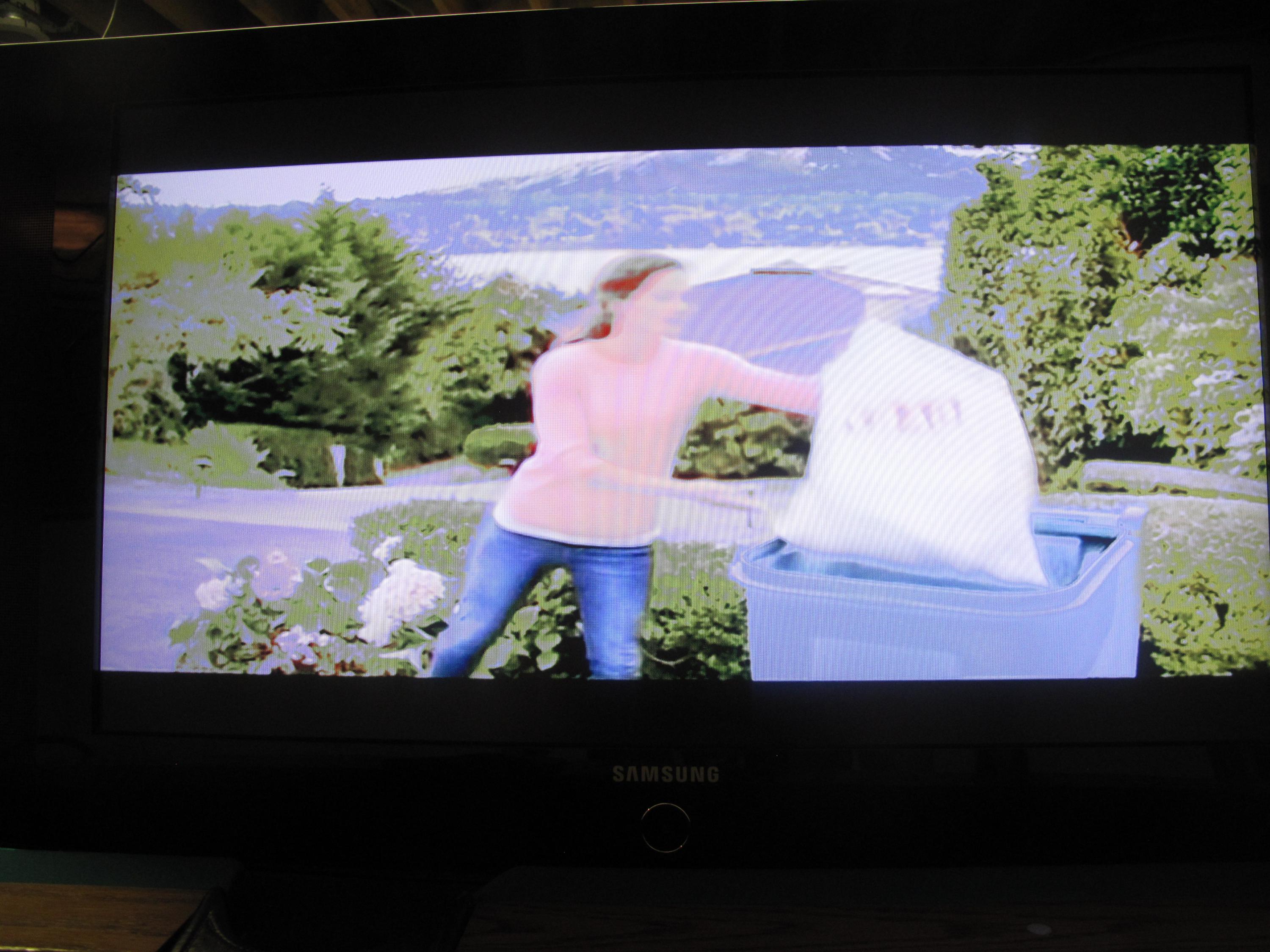

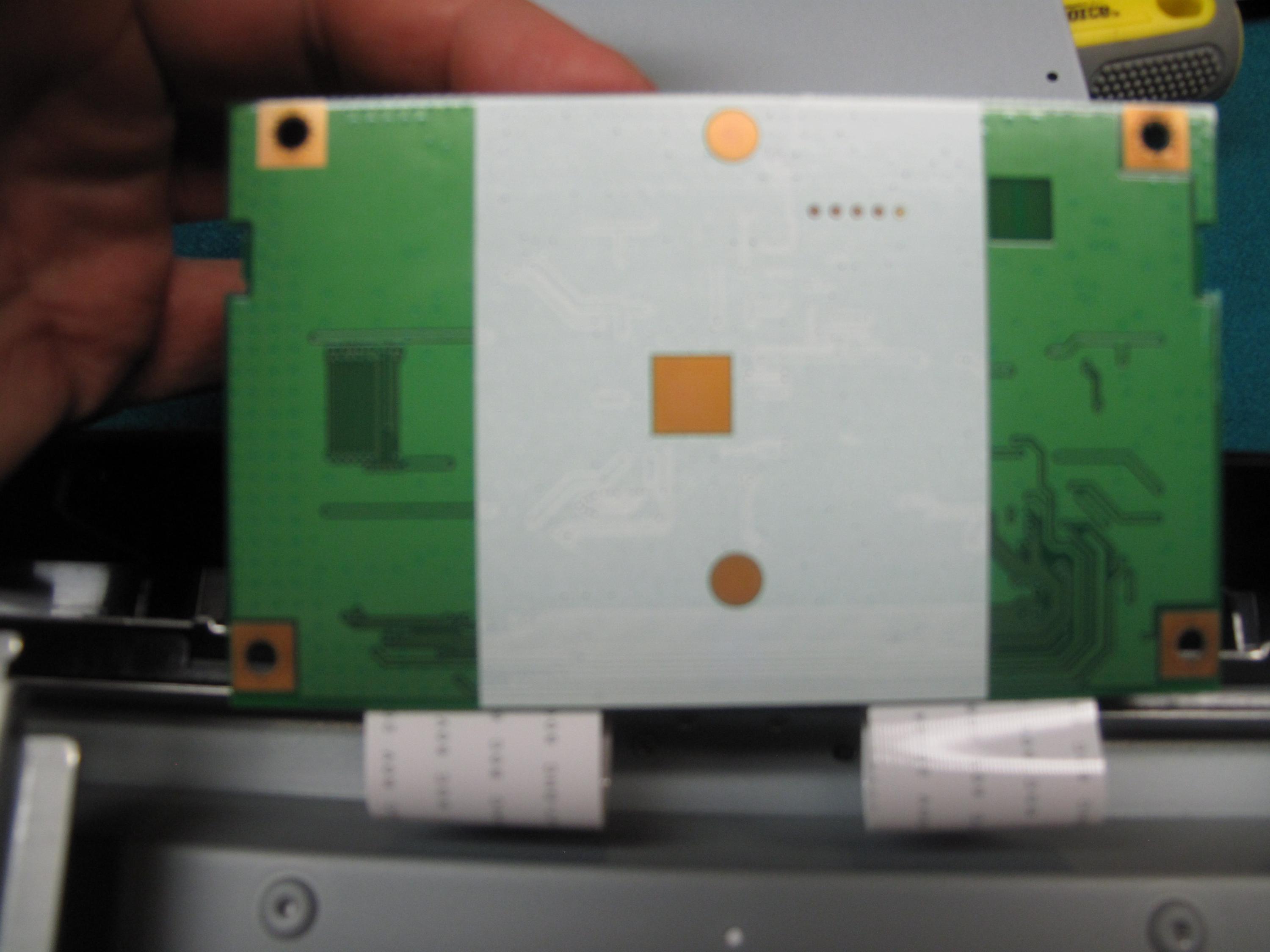

samsung ln32a330j1d picture troubleshooting
  • jcyow
    • Feb 2014
    • 12
    • usa
    samsung ln32a330j1d picture troubleshooting
    Trying to troubleshoot this tv. It's been working fine since last year when I had the no power/ replace the caps and everything's fine incident. However, the picture has started to go. It looks like a faded negative with odd color which is present using both component and coax inputs. No odd colored lines, no distinct solarization.
    I've done both factory resets without resolution to the problem. But when I pull up the onscreen menu, the menu itself looks fine. Back of the input board does have some odd light tan color to it here and there but visually the boards look fine and there is no dust inside.
    The picture doesn't look as bad as some of the the posts which required a tcon board replacement, but then again, I can't be sure what exactly happens when a tcon goes/is going.Thought?
    Re: samsung ln32a330j1d picture troubleshooting
    Take the screen shot of the screen and the T-CON board, it sounds like Gamma problem.
    • jcyow
      • Feb 2014
      • 12
      • usa
      Re: samsung ln32a330j1d picture troubleshooting
      ..as requested:
        Re: samsung ln32a330j1d picture troubleshooting
        Does the small square IC with lots of pins just below the right ribbon connector on the T-con board as AS15 printed on top?
        • jcyow
          • Feb 2014
          • 12
          • usa
          Re: samsung ln32a330j1d picture troubleshooting
          yes. AS15 -G
            Re: samsung ln32a330j1d picture troubleshooting
            Can you post a closer pic of this IC? There are usually test points near it.
            • jcyow
              • Feb 2014
              • 12
              • usa
              Re: samsung ln32a330j1d picture troubleshooting
              as req:
              • jcyow
                • Feb 2014
                • 12
                • usa
                Re: samsung ln32a330j1d picture troubleshooting
                is the thought that the tcon is shot or just the ic? and which would be more intelligent to change?
                  Re: samsung ln32a330j1d picture troubleshooting
                  I would say it is the AS15G IC Gamma voltage reference is bad, you can report the readings as TOM requested.
                    Re: samsung ln32a330j1d picture troubleshooting
                    You can try checking each point marked GM1, GM2, GM3 up to about GM20 (may be a few less) and report the voltage measured on each, which will definitively confirm if the gamma voltages are bad and if the chip or t-con needs replacement. You can replace either, but the chip is much cheaper, just a few dollars.
                    Note: GM# not just plain number. The chip acts as a voltage buffer. It has inputs 1-20 and outputs GM1-20, you should check GM1-20.
                    Last edited by tom66; 02-13-2014, 02:59 PM.
                    • jcyow
                      • Feb 2014
                      • 12
                      • usa
                      Re: samsung ln32a330j1d picture troubleshooting
                      Apologies, TOM, I didn't realize you had asked for numbers. will get them up as soon as i figure out how to do it. Much thanks.
                      • jcyow
                        • Feb 2014
                        • 12
                        • usa
                        Re: samsung ln32a330j1d picture troubleshooting
                        Think i might just get the tcon board since nobody in my area will solder a new ic. Thoughts on where? Or does everyone just roll the dice on ebay?
                          Re: samsung ln32a330j1d picture troubleshooting
                          First, I think it's a good idea to check those voltages: if they are bad, order a new board. And yes you will be rolling dice I'm afraid. I know there's someone on ebay doing repairs to similar boards - maybe they can help.
                          • jcyow
                            • Feb 2014
                            • 12
                            • usa
                            Re: samsung ln32a330j1d picture troubleshooting
                            ordered the new board for my 32", installed and all is well. However, my samsung 46" is now starting to do about the same thing including the picture sometimes shrinks into the corner. if i turn it off and on it corrects itself but i think it's just trouble starting to happen! What's with this company? I think it's time to seriously take a look at sony!
                            • jcyow
                              • Feb 2014
                              • 12
                              • usa
                              Re: samsung ln32a330j1d picture troubleshooting
                              And i would be remiss if i didn't say thanks to all for the valuable input!
                                09-07-2024, 05:50 AM
                              • TR103
                                by TR103
                                - it keeps rebooting
                                01-22-2025, 04:12 PM
                              • YellowJacket
                                Samsung QE55Q60RAT - no picture
                                by YellowJacket
                                Hi friends,
                                a friend of mine gave me this TV to fix, with common SAMSUNG TV issue - damaged panel. Turning on, sound is present, but no picture. So I went directly to standard process, connecting two pads together with a wire ( see in the picture ), and then removing flex cables. With right flex connected, there was half screen working, but still no picture ( disappearing colors and similar weird stuff ) + working sound. With left flex connected, TV is restarting + working sound. I supposed, left side is damaged, so I then blocked all 8 CLK pins ( going from 0R resistors on the second...
                                07-30-2024, 01:31 PM
                              • Dobsuk
                                Samsung UE50TU8000K no picture or lanes on it
                                by Dobsuk
                                Hi guys, i am dealing with one Samsung 50TU8000K which was without picture - just was resetting itself constantly. Saw some videos and read some post about simmilar issue and the advise was to try to tape cut off method and started to put tape on some of the pins on this ribbon cable:
                                And then i had picture but with lanes. Tried different pins and combination but could not managed to make it work without any lanes so far. Will keep playing with it though.
                                The weird thing is that i tried it again without any tape on the pins and now i have picture with just few lanes...
                                04-25-2023, 07:34 AM
                                09-06-2024, 11:40 PM
