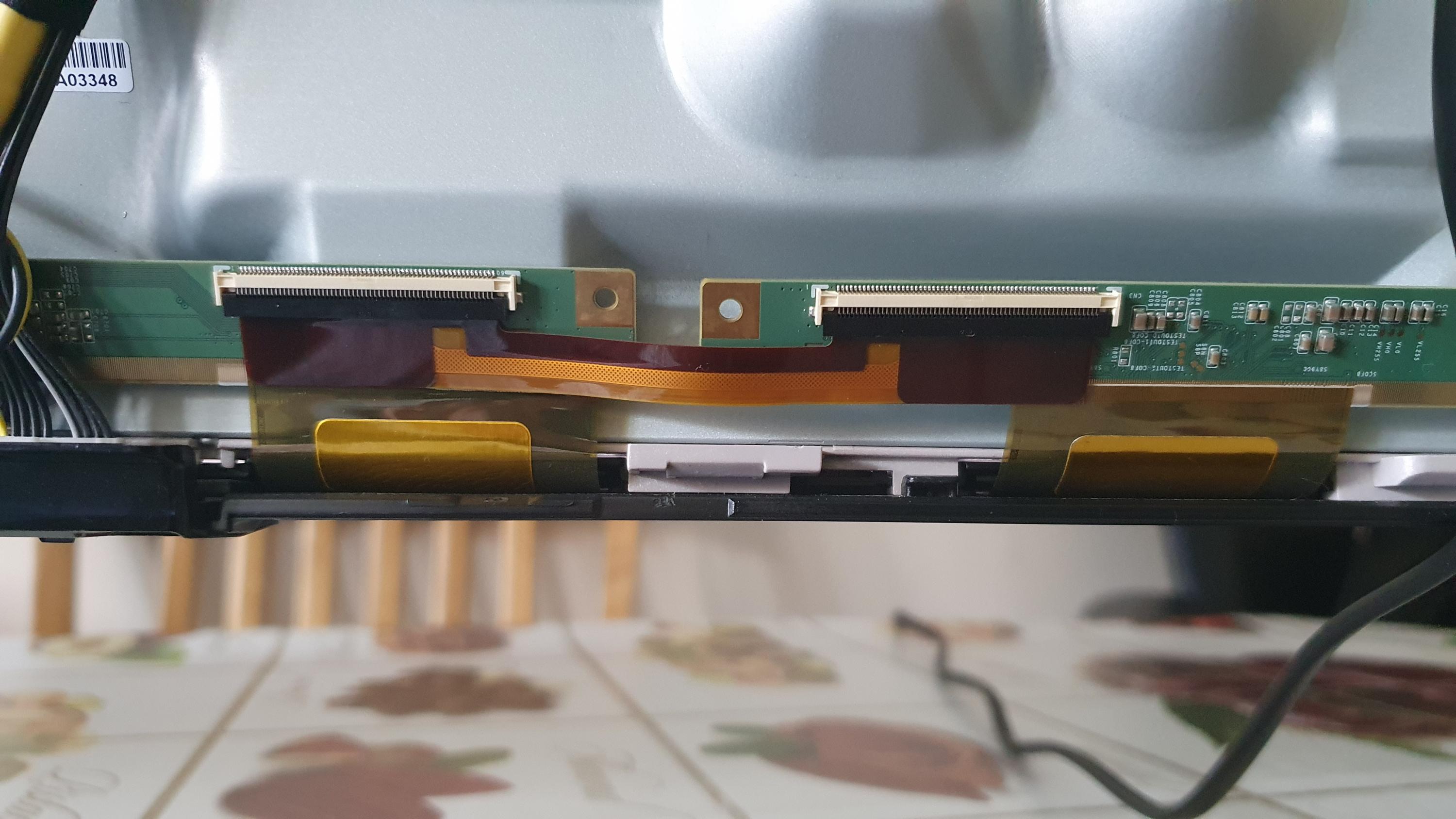

    Hi guys, i am dealing with one Samsung 50TU8000K which was without picture - just was resetting itself constantly. Saw some videos and read some post about simmilar issue and the advise was to try to tape cut off method and started to put tape on some of the pins on this ribbon cable:

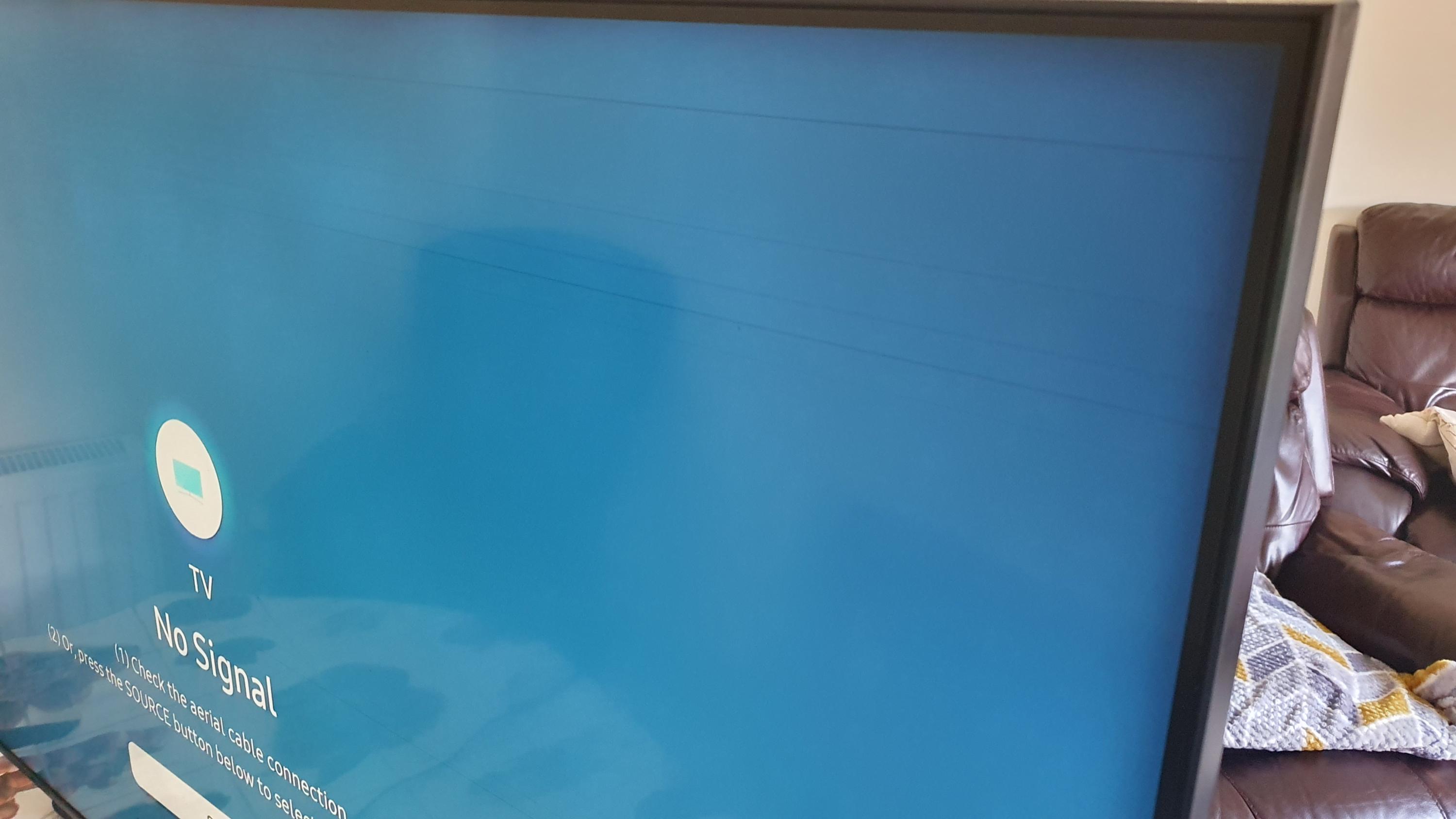

    And then i had picture but with lanes. Tried different pins and combination but could not managed to make it work without any lanes so far. Will keep playing with it though.

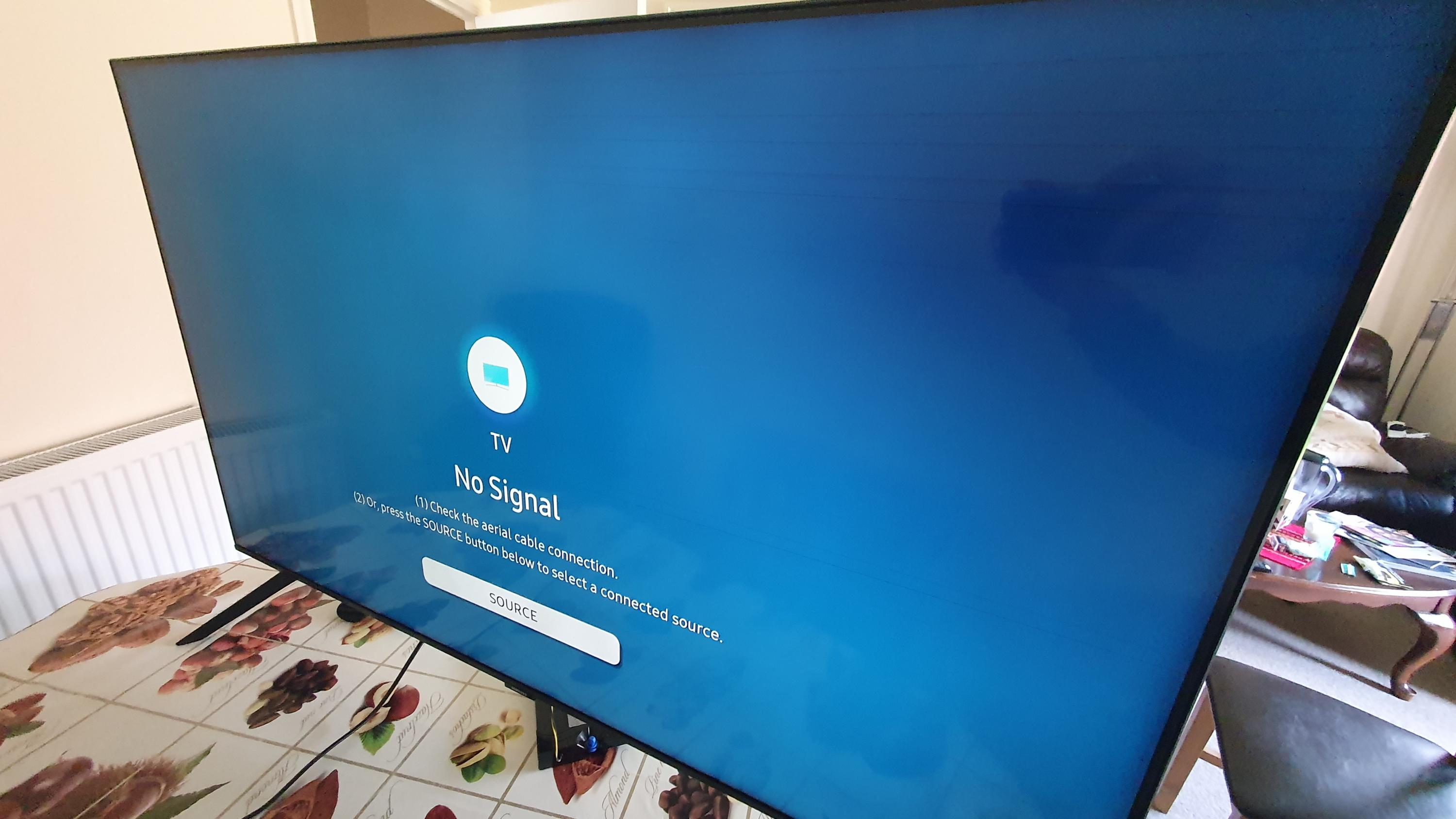

    The weird thing is that i tried it again without any tape on the pins and now i have picture with just few lanes on the rhs of the screen, watching it in front of it.
    And i am wondering now what could happened so to have picture now and should i keep trying to cut some of the pins with tape by any chance to make the picture without any lanes?
    Any advise will be really appreciate.

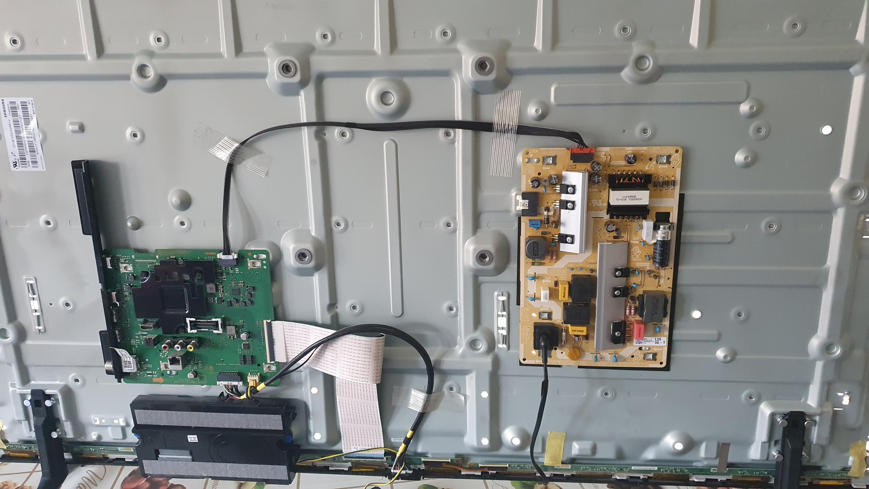

    This is the set from back view:

    I noticed today that one of the horizontal lines is flashing slowly...if that helps somehow.

      The fault did not go away by itself is all I can say, the TU series is known for lasting 1 year then developing horizontal lines or have no image at all.
      Put the tape back and mask the pins until you don't get lines and/or flashing.
      This "recovery" is common, the longer the TV is off, the more time the panel will last until it gets into terminal state.

            Posted a slide summary on Samsung 4K panel connections. Can help you understand what all the flex connection pins are
            https://www.badcaps.net/forum/showthread.php?t=118541
            A couple of additional notes
            • Use small paper cutouts to block off pins can go faster
            • You are probably blocking off CKV* and CKVB*. I think there are 4 of each. And STVP1. This older panel repair doc seems to suggest STVP1 has to be masked off in conjunction with the right CKV* CKVB* signals.
