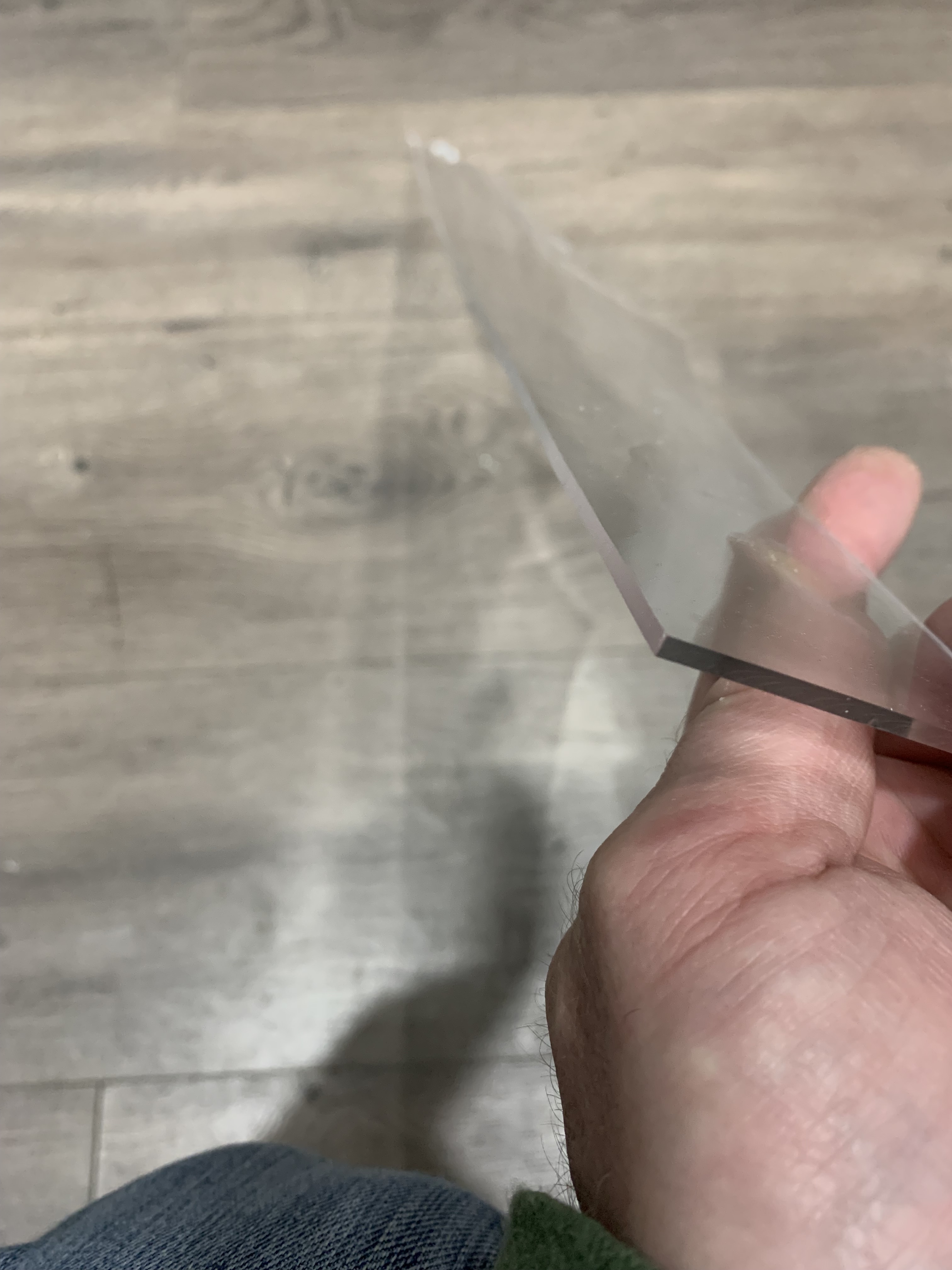

Awesome. I have several that need trimming to better sizes.
Once I get the stuff over the next few weeks I may ask again. Appreciate it.
I tried the knife thing.. doesn't work well for me. Snaps in wrong places etc I think this is gonna be perfect.
Cutting new light diffuser question
I used a long level I had as a guide with 2 clamps for the router to keep it straight and then just hung the plexiglass off the table.
I used a bit with a roller (flush trim bit) and used the table as a guide also for the bit itself.
also make sure to protect the diffuser as it scratches very easily from sliding moving it when flat.
I used blue painted tape where the router went to project it and some towels
Hope this helps. Let me know if you have any other questionsLeave a comment:
I forgot to take a pick at the time. I can get one of the piece I cut off Monday
it’s the exact same looking as factory edge though.Leave a comment:
Have a picture of the edge that the router created or the edge of the other way?Leave a comment:
Update:
i tried to score and cut like Daido mentioned and it does give a clean cut edge. However I couldn’t get it to snap in 1 piece. Maybe with a better setup and even pressure.
Router worked great though and gave me a clean cut edge as well. It’s a lot of mess though compared to Daido way.
Leave a comment:
I figured the best way is similar to that cutter they use at Lowe's for plexiglass. Using the razor blade and snap I'll have to try.
Are you in Tampa storyteller?Leave a comment:
A clean score with a sharp stanley knife works for me. I just snap it off at the table edge. Works every time.
The score has to be constant.Leave a comment:
however i think it will break , i wish you the best luck.
we can consider too if we don't have same size diffuser, , we can use the Tablet LCD principle, they use normal transparent plastic fiberglass plate have width same to LED size , they arranged it as following
White carton paper ---- the plate ---- 2 light filter ( horizontal & vertical ) -- LCD ---- touch folie
we use only White carton paper ---- the plate--- LCD --- then the reset of filters. . also need to paint the 3 edge of the plate with white...i never do it. just because i have allot of diffuser collect them over years.
by the way this method now days used at sign plate in supper market cashier table... etc.Leave a comment:
Eazybone: I know the razor blade was last choice as it will take several (maybe hundreds) of cuts but I know it will work. I’ll update everyone one the router attempt when I do it.
The melted ones you can sand a little bit but everyone is different and will get different results. It’s never the same for each one unfortunately.Leave a comment:
I believe that they employ a cnc router to cut light guide plates to the dimensions that are wanted,Also sometimes they use laser cutters .Anyways it would be very interesting
to know what kind of results you get.I have heard of people who had cut away melted edge of lights guides and getting good results but never done it myself.A router should get a
very smooth edge so you could get excellent results.
Leave a comment:
could you please explain what is a router? i think this cutter is more suitable on a hard ground :https://www.temu.com/kuiper/dn9.html...oaAuQ-EALw_wcB if it is not that what you mean whit a router
Leave a comment:
I don't. I have a couple diffusers and just trying to see if there was a tried and true way. Router seems like a good idea. Razor seems like a terriblly long tedious process. I cut some junk ones of these with razor and feel like itd take like 1000 cuts
Let me know if you find a way. I also have a 65 that isn't cracked but it's melted a little, and it warps the light paths. You have a way to save them? Sanding edges or somethingLast edited by EazyBone; 03-30-2024, 12:40 PM.Leave a comment:
I have 2 ways to try. First being a router and second being a razor knife. Hoping the router works as it will be the cleanest. I’m going to test the router first on the cracked 40” one
Do you have any experience or suggestions? I'm open to try something elseLast edited by Storyteller12; 03-30-2024, 12:27 PM.Leave a comment:
by howardc64Problem
This is an LG edge LED lit LCD Display. The LEDs are on the bottom edge of the display. There are 2 bars (left and right) Each bar has many LEDs and a 6 pin connector. Each pin drive several LEDs thus is the highest current flow / heat junction. The weak lead free solder gradually fails with thermal expansion/contraction cycling and increases resistance. PSU will compensate up to a point, then when the current is too high, PSU just shut down the backlight causing a dark display. I have even seen one which the connector just fell off as solder points became completely detached....-
Channel: Troubleshooting Computer Displays
This specification for the LENOVO ThinkCentre Edge 71 can be useful for upgrading or repairing a desktop PC that is not working. As a community we are working through our specifications to add valuable data like the ThinkCentre Edge 71 boardview and ThinkCentre Edge 71 schematic. Our users have donated over 1 million documents which are being added to the site. This page will be updated soon with additional information. Alternatively you can request additional help from our users directly on the relevant badcaps forum. Please note that we offer no warranties that any specification, datasheet,...09-12-2024, 03:36 PM
This specification for the LENOVO ThinkCentre Edge 71 can be useful for upgrading or repairing a desktop PC that is not working. As a community we are working through our specifications to add valuable data like the ThinkCentre Edge 71 boardview and ThinkCentre Edge 71 schematic. Our users have donated over 1 million documents which are being added to the site. This page will be updated soon with additional information. Alternatively you can request additional help from our users directly on the relevant badcaps forum. Please note that we offer no warranties that any specification, datasheet,...09-12-2024, 03:36 PM
This specification for the LENOVO ThinkCentre Edge 71 can be useful for upgrading or repairing a desktop PC that is not working. As a community we are working through our specifications to add valuable data like the ThinkCentre Edge 71 boardview and ThinkCentre Edge 71 schematic. Our users have donated over 1 million documents which are being added to the site. This page will be updated soon with additional information. Alternatively you can request additional help from our users directly on the relevant badcaps forum. Please note that we offer no warranties that any specification, datasheet,...09-12-2024, 03:36 PM
This specification for the LENOVO ThinkCentre Edge 71 can be useful for upgrading or repairing a desktop PC that is not working. As a community we are working through our specifications to add valuable data like the ThinkCentre Edge 71 boardview and ThinkCentre Edge 71 schematic. Our users have donated over 1 million documents which are being added to the site. This page will be updated soon with additional information. Alternatively you can request additional help from our users directly on the relevant badcaps forum. Please note that we offer no warranties that any specification, datasheet,...09-12-2024, 03:36 PM
- Loading...
- No more items.
Leave a comment:
