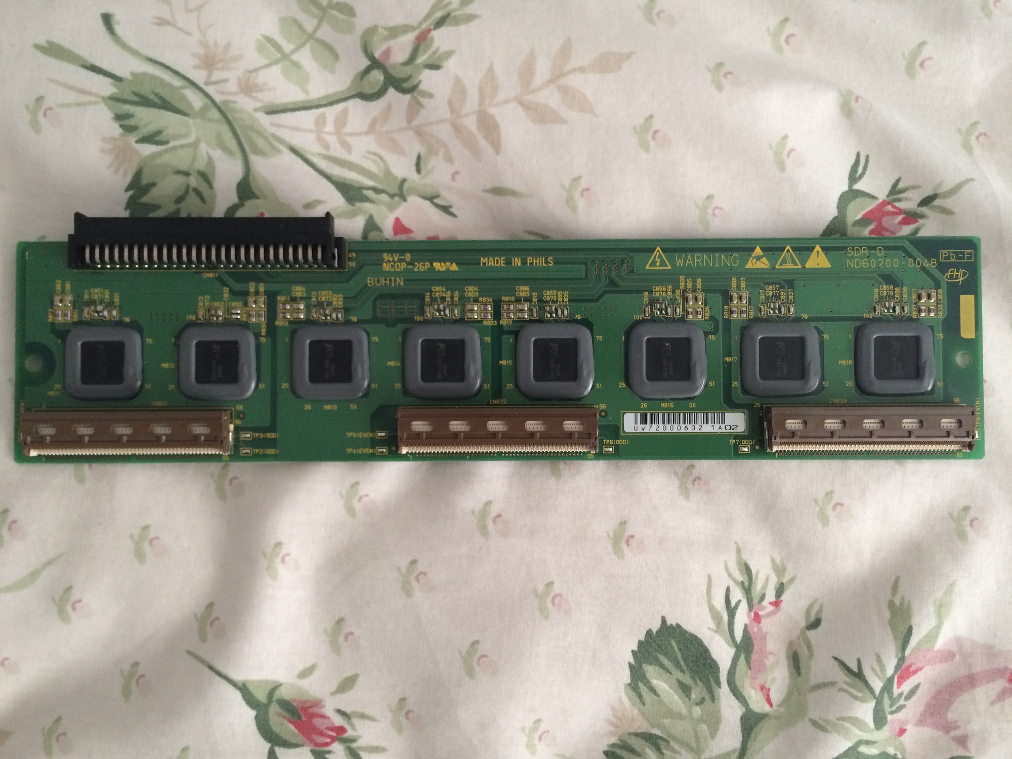

    Hey I got a P50S601 Hitachi that I found the lower buffer board to be bad. Unplugging the lower board, the top half of the screen shows perfectly.
    Buffer board model: ND60200-0048
    There are 8 Buffer ICs, how would I know which IC's are bad and need replacing?

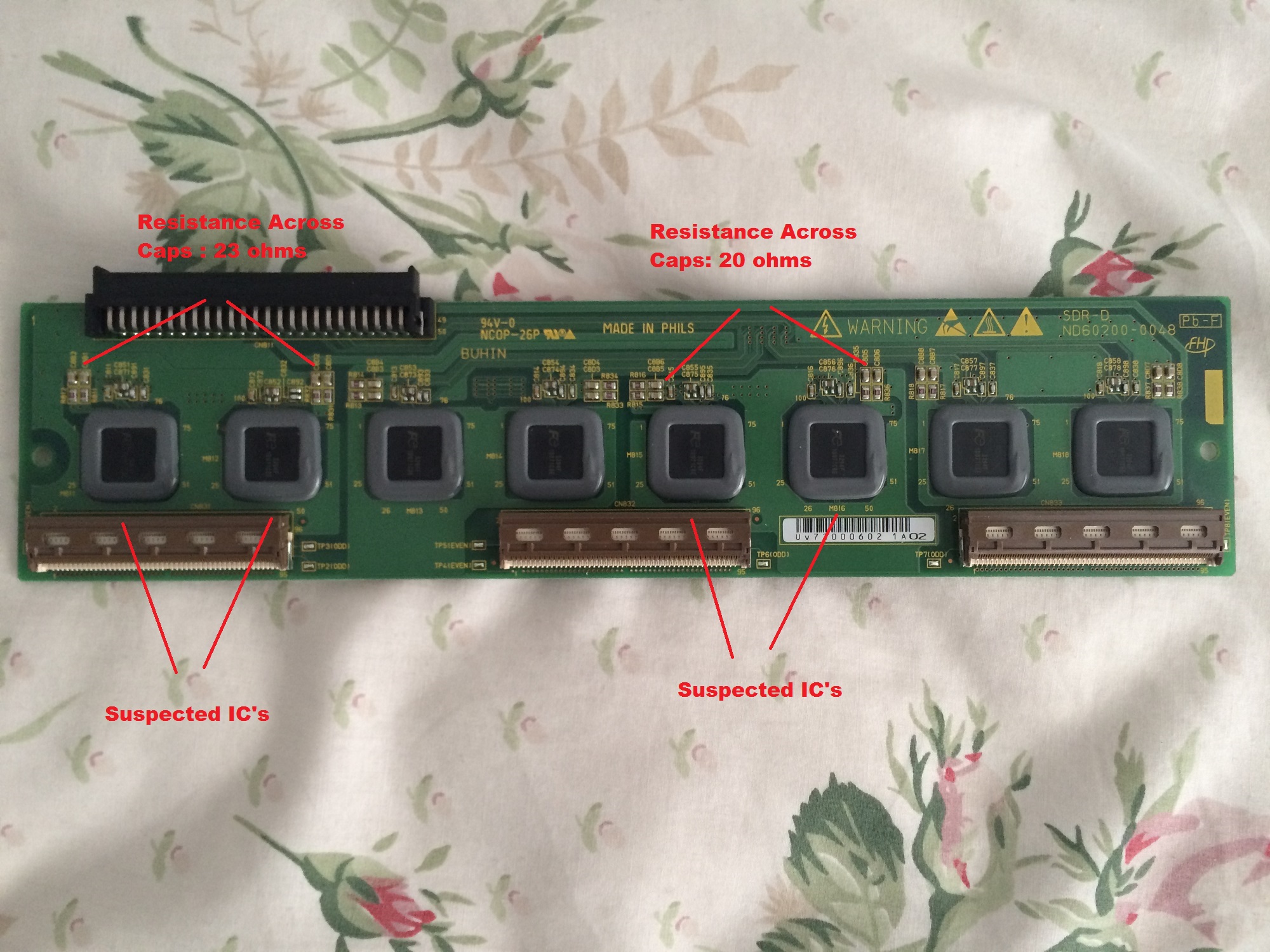

          There are no burnt holes on any of the ICs, but I did the buffer test similar to the Samsung buffers and there is definitely a short. But it doesn't show me which IC is bad.
          I've been reading around the site and on google and it said that by measuring the capacitors next to the chip if it reads shorted then its bad (It didn't said exactly how to measure or where...). By I just probed around and notice there might be 4 chips that seem bad. HOWEVER I feel like the chips seem to be paired in two in parallel, so it may be just two chips that are bad, but im not certain.
          Each chip is $16, so itll cost about 60$ to replace all four. Theres a service on ebay offering to repair the board for $60 so I guess that could be less work for me, BUT I don't trust it as much.
          If it is just two chips I can save $30 by fixing it myself.

            Are the traces not visible ? You should be able to check the output pins for short against ground at the input connector and trace the pins back from the ouput connector to the faulty ic.

              But the chips may be in parallel, it wouldn't tell me which of the two are bad?
                Re: Hitachi Buffer IC replacement
                No, each chip only drives a specific part of the panel. You could also try applying current to the board (low level) and see what gets hot.

                  I'm not sure if the test I did even confirms. I just measured around and looked for any differences comparing to the working upper buffer board. I found that measuring across the caps shown next to the relative chip, that four of them showed shorted.
                    With your other buffer, look at the where the VSCAN voltage is, between the large thick traces and the slightly smaller one. You can measure it on a meter, should be around 140V.
