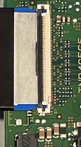

                          why you are still considering on panel... you did the 12V test and removed the half screen and you got clean half white and black.. do you wish to scrap the panel ?
                          so my questions... did you removed the masking you did before on LVDS cable at Panel side ? and if used before scotch Tape... be sure you clean the pins as it left glue behind. which ,make bad contact.....
                          after you clear the issue above,.. try mask at MB LVDS sockets pins 49-50-51 then turn on .. see the screen what it will show. ( this test to stop first p+ p- which drive panel with interrogated T-CON to start test pattern ) ... hopefully it will work on yours Panel.
                          Click image for larger version  Name:	image_331474.jpg Views:	0 Size:	58.6 KB ID:	3242005

                              #34
                              I masked the last 3 pins as in your diagram with red box. However, the display is still black.
                              Is it possible that the main board is working for audio and HDMI identification by laptop (Panasonic) but the video output is failed? Perhaps the video processor is bad or something similar? Thanks.

                                #35
                                this is sign of issue look like no LVDS cable connected or no Data from Mainboards.... this why you need to find sign of life on Mainboards like the Optic Audio output if it lit red or not. no mean MB didn't work., yes need to check first LVDS cable pin to pin from both side of connectivity
