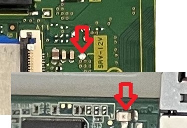

Panasonic LED TV TC-40A420U - Replaced Backlight LEDs but now no image/display or garbled
  • signal.quest
    replied
    I tried another used main logic (A) board and got slightly better results. I could see some text. This makes me think all of the logic boards I am trying have different issues. Or could this mean the LCD panel or integrated TCON has failed? Please see the attached pictures and let me know your thoughts. I greatly appreciate your help.
    Leave a comment:
  • signal.quest
    replied
    I tested the cable and it tested good. I then replaced the logic (A) board with the same model from ebay (it was used). The replacement board briefly powers on the backlight then goes into standby mode. I suspect the replacement board is bad. Maybe it has a power issue that is easily repairable? I check caps for shorts and did not find any. Do you have any advice on logic board troubleshooting/repair? Thanks.
    Leave a comment:
  • Diah
    replied
    Originally posted by signal.quest
    I masked the last 3 pins as in your diagram with red box. However, the display is still black.
    Is it possible that the main board is working for audio and HDMI identification by laptop (Panasonic) but the video output is failed? Perhaps the video processor is bad or something similar? Thanks.
    this is sign of issue look like no LVDS cable connected or no Data from Mainboards.... this why you need to find sign of life on Mainboards like the Optic Audio output if it lit red or not. no mean MB didn't work., yes need to check first LVDS cable pin to pin from both side of connectivity
    Leave a comment:
  • signal.quest
    replied
    I masked the last 3 pins as in your diagram with red box. However, the display is still black.
    Is it possible that the main board is working for audio and HDMI identification by laptop (Panasonic) but the video output is failed? Perhaps the video processor is bad or something similar? Thanks.
    Leave a comment:
  • signal.quest
    replied
    I did try to clean all connections on the ribbon cable and board receptacles. This did not make a difference. Next, I will attempt to mask the pins you suggested. Thanks again.
    Leave a comment:
  • Diah
    replied
    Originally posted by signal.quest
    Yes, I have 12V after removing everything. Can you please tell me what other test points on the panel I need to check for specific voltages? Is there a way I can test for shorted lines on the panel? Thank you.
    why you are still considering on panel... you did the 12V test and removed the half screen and you got clean half white and black.. do you wish to scrap the panel ?
    so my questions... did you removed the masking you did before on LVDS cable at Panel side ? and if used before scotch Tape... be sure you clean the pins as it left glue behind. which ,make bad contact.....
    after you clear the issue above,.. try mask at MB LVDS sockets pins 49-50-51 then turn on .. see the screen what it will show. ( this test to stop first p+ p- which drive panel with interrogated T-CON to start test pattern ) ... hopefully it will work on yours Panel.
    Click image for larger version  Name:	image_331474.jpg Views:	0 Size:	58.6 KB ID:	3242005
    Last edited by Diah; 03-25-2024, 08:15 AM.
    Leave a comment:
  • signal.quest
    replied
    Yes, I have 12V after removing everything. Can you please tell me what other test points on the panel I need to check for specific voltages? Is there a way I can test for shorted lines on the panel? Thank you.
    Leave a comment:
  • Diah
    replied
    if you put every things back and removed the jumpers you did before.. and screen remain black....check the LVDS cable and be sure too you have 12V on Fuse FP1 from both side.
    good luck
    Leave a comment:
  • signal.quest
    replied
    EazyBone, thanks for advice. I will try to do that soon. I reseated the yellow connection cables and now the faint clicking sound on the main board has gone away. But still black screen on display.
    Leave a comment:
  • EazyBone
    replied
    Tedious but to test lvds cable you can turn multimeter to beep beep mode and go pin by pin and test if each one has continuity from one side to next. This helped me once and I found cable to be bad. It only had 9 pins though so it wasn't so bad. Interesting journey here so far.
    Leave a comment:
  • signal.quest
    replied
    I just connected laptop to HDMI and randomly pressed the side buttons until I heard audio coming from the laptop. Sadly, still nothing but black screen on LCD panel. I tried again to tap the connector on both board with no success.
    Leave a comment:
  • signal.quest
    replied
    I tried cleaning and reseating the LVDS cable on both mainboard and panel sides. I also tried applying pressure to the cable connector. But there is still black screen. I noticed this time the mainboard makes a faint (hard to hear) ticking sound when the power is initially connected. This sound repeats each time I disconnect and reconnect the power. I also have never heard audio coming from the mainboard when I had laptop connected to the HDMI to play video file.
    Leave a comment:
  • Diah
    replied
    Originally posted by signal.quest
    My sincere apologies. I have now disconnected the LVDS cable and jumpered the 12V connection points that you suggested. The results are now a complete black screen when both yellow connection cables are connected. When the cables are disconnected the screen is white where the cables are disconnected and black on the opposite side. You are correct that there are no colored lines down the center now. Please tell what is next to test. Thank you very much.
    its okay... no more test.. don't play with panel any more. its fine.i suspect the LVDS cable or the LVDS socket at mainboards side..... i don't know how you stored the TV till you worked on it again...
    clean reset at mainboards side... play pressure on the MB at several area and on the sockets see if there any change
    Leave a comment:
  • signal.quest
    replied
    My sincere apologies. I have now disconnected the LVDS cable and jumpered the 12V connection points that you suggested. The results are now a complete black screen when both yellow connection cables are connected. When the cables are disconnected the screen is white where the cables are disconnected and black on the opposite side. You are correct that there are no colored lines down the center now. Please tell what is next to test. Thank you very much.
    Leave a comment:
  • Diah
    replied
    Originally posted by signal.quest
    Since, I blocked all pins using tape but the 12V source on the LVDS cable on the panel side of the connection isn't that the same as jumpering trom the points you mentioned? If not, what am I not understanding about this?
    Before disassembling the TV I did not test using a flashlight (torch) to see an LCD image. I was not aware of that method until after I had already taken it apart.
    I have watched youtube videos and I am concerned about the panel side tabs or a shorted line. I fear that I was not aware enough when reassembling the panel and might have accidentally damaged something. I also am not confident I placed the diffuser sheet layers in the correct order. I still think I should see some image even if I have an error?
    diffuser sheet order never being problem as you can correct them if they are wrong.
    about your masking the LVDS cable... the end of the cable had 2 faces contact. when you mask one face the other will be in touch.... and if you masking the 2 faces you had add thickness to the LVDS which make the contact pin at socket went inside to catch the new thinness....
    disconnecting LVDS the only one things we can work with out adding any another damage or issue which make you lost.
    this detail explanation not only for you.... but who didn't follow the adviser.. then all of us will be in lost., no need to spend time any more... stay check Youtube and your mind please.
    Leave a comment:
  • signal.quest
    replied
    Since, I blocked all pins using tape but the 12V source on the LVDS cable on the panel side of the connection isn't that the same as jumpering trom the points you mentioned? If not, what am I not understanding about this?
    Before disassembling the TV I did not test using a flashlight (torch) to see an LCD image. I was not aware of that method until after I had already taken it apart.
    I have watched youtube videos and I am concerned about the panel side tabs or a shorted line. I fear that I was not aware enough when reassembling the panel and might have accidentally damaged something. I also am not confident I placed the diffuser sheet layers in the correct order. I still think I should see some image even if I have an error?
    Leave a comment:
  • Diah
    replied
    yours Point 1: you have the lines distribution at the middle because the LVDS was in place.. so we cant say right now which exactly caused this.lines.
    points 5 , when i wrote to take the 12V from LVDS socket... it mean we disconnect the LVDS totally, and jumpers thin wire between this 2 points as in photo.
    you disassembled the screen... and start to repair LED, but before that did you saw picture on the screen with touch light ???
Name:	1.jpg
Views:	159
Size:	39.0 KB
ID:	3241306
    Leave a comment:
  • signal.quest
    replied
    I did the following tests:
    1. I disconnected both yellow highlighted connections in the picture you sent. This created a white screen on the disconnected side and colored lines in the center. Please see picture.
    2. I tried to disconnect just 1 of the yellow connection cables. This made a black screen on both sides, but the colored lines in the center.
    3. I checked the panel circuit for shorts on the capacitors but did not find any.
    4. I checked the panel board and found 12V, 3.3V, and 24V at different sections. I did not check all possible points. Please let me know specifically what is important to check?
    5. I used tape to block all lines on LVDS cable except the 12V line to provide power to the panel. I checked the board to ensure it had voltages, but the panel stayed black.
    Please tell me what to check for next. Thank you. I greatly appreciate it.
    Leave a comment:
  • Diah
    replied
    Originally posted by signal.quest
    The power supply from the TV only outputs 5V, 16V and 24V. The logic board provides 12V. Not sure how I can provide the 12V easily without another supply? Can I just power the backlight with the TV supply and the LCD with a dedicated bench supply?
    take the 12V from LVDS socket on main boards and connect it to the fuse FP1
    Leave a comment:
  • signal.quest
    replied
    The power supply from the TV only outputs 5V, 16V and 24V. The logic board provides 12V. Not sure how I can provide the 12V easily without another supply? Can I just power the backlight with the TV supply and the LCD with a dedicated bench supply?
    Leave a comment:
  • JSBJSB
    Panasonic OLED TX-65GZ950E no image
    by JSBJSB
    so I have this problem with this OLED that had a LED blinking issue at first.
    It was blinking twice so it means according to similar service manuals (I cannot find the proper one) EVDD 24V SOS, Panel or TCON Fault.
    Also, the connector from PSU to TCON which supplies 24V was burned (changed it) and saw threads about this topic but didn't relate completely to mine.
    First thing was to tape the signal ERRORDETECTION so it would try to initialize. And it didn't so I unplugged the panel from TCON.
    Then it started up and went to green light...
    05-14-2025, 02:39 PM
    09-12-2024, 02:20 PM
  • Jaime Morillo
    by Jaime Morillo
    08-18-2025, 11:38 AM
  • Pipolups
    Corsair K70 LUX RGB dying LEDs
    by Pipolups
    Hi there !
    I'm having an issue for several weeks with my quite old K70 LUX RGB keyboard. I haven't used it for few months, and once I setup up again my desktop computer, I got several dead LEDs on that keyboard. I tried the Corsair troubleshooting thing (disabling options in iCUE, ...) but nothing changed so I conclude that for some reason some LEDs went in retirement...😅
    Decision taken to change these LEDs as I have access to desoldering iron and binocular magnifier, I wrote a ticket to tech support, hopping to obtain the LEDs reference and... They refused to tell me 🙄...
    10-08-2024, 11:58 AM
    HP ProBook 430 G6 + Image Load & Asset Tag Notebook 400 Specification for Upgrade or Repair
    This specification for the HP ProBook 430 G6 + Image Load & Asset Tag Notebook can be useful for upgrading or repairing a laptop that is not working. As a community we are working through our specifications to add valuable data like the 430 G6 + Image Load & Asset Tag boardview and 430 G6 + Image Load & Asset Tag schematic. Our users have donated over 1 million documents which are being added to the site. This page will be updated soon with additional information. Alternatively you can request additional help from our users directly on the relevant badcaps forum. Please note that we...
    09-06-2024, 10:56 AM
