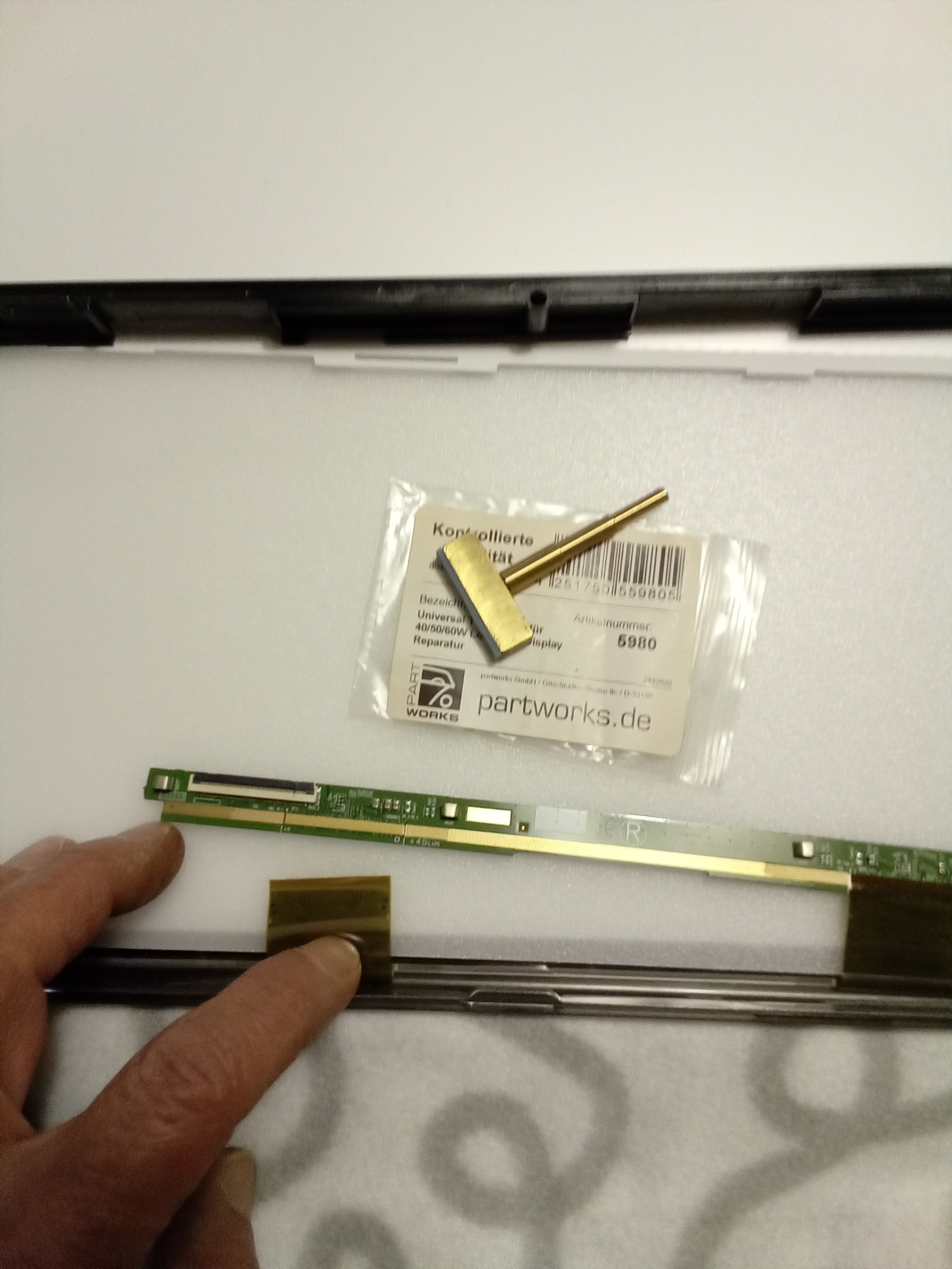

    Accident happens have bumped off a Cof and want to restore it but can't find the right way to do it. have looked at several videos but can't find anyone who uses the T type of soldering that I think is the easiest and I have it but have never used it. Is there anyone who can tell me how to use it and how much heat should i have, preferably a small tuto would be very good
  • Answer selected by bohaboha at 03-14-2024, 03:40 PM.

    On AliExpress
    • EazyBone
      • Jun 2023
      • 1351
      • United states
      I thought this wasn't possible, curious if someone knows also

        Need new ACF tape but time ago it was sold in expensive reels, now i don't know, probably there is at shorter quantity

          Flux, some low-temp solder, and practice in some other boards to get a hang of it. Not much to it, clean the stripes, position correctly ( the hardest part ) and slide/press with the T tip.
            Thank you all for your replies
            EazyBone:I thought this wasn't possible, curious if someone knows also here : https://www.youtube.com/watch?v=t36YT7-5GTY
            Davi.p where can i find ACF tape ?
            rogfanther :can you say how high or low temp have to be used.of course i will practice ​

                Tank you Davi.p. can you tell me how hi or low temperatur should i use whith the t type soldering

                      A single subpixel vertical line is due to bad soldering on the cof (the chip), bad cof output (shorted internal transistor etc..) or oxidation and bad insulation on the flat output joint to the glass panel , in each case the T type tip is unuseful! T type are intended for simple little monochrome lcd displays like for handheld calculators, termostat, alarm keypads..

                                bohaboha i was replying to eazybone, in your case the T could be ok, but the rubber strip reduces the heat much so must use high power.. a 80w iron minimum

                                  is the ACF tape a must or can i use something else ? if so what can i use? because i do not have it just now
                                  • Davi.p
                                    Hobbist Tech
                                    • Sep 2009
                                    • 4421
                                    • Italy - Milan
                                    What do you want to use, a strip of cheese? Obviously need acf, is a special material

                                          you say i have to use high power 80w but in the market all i find is 30,40,60w and even my own is same 60w
