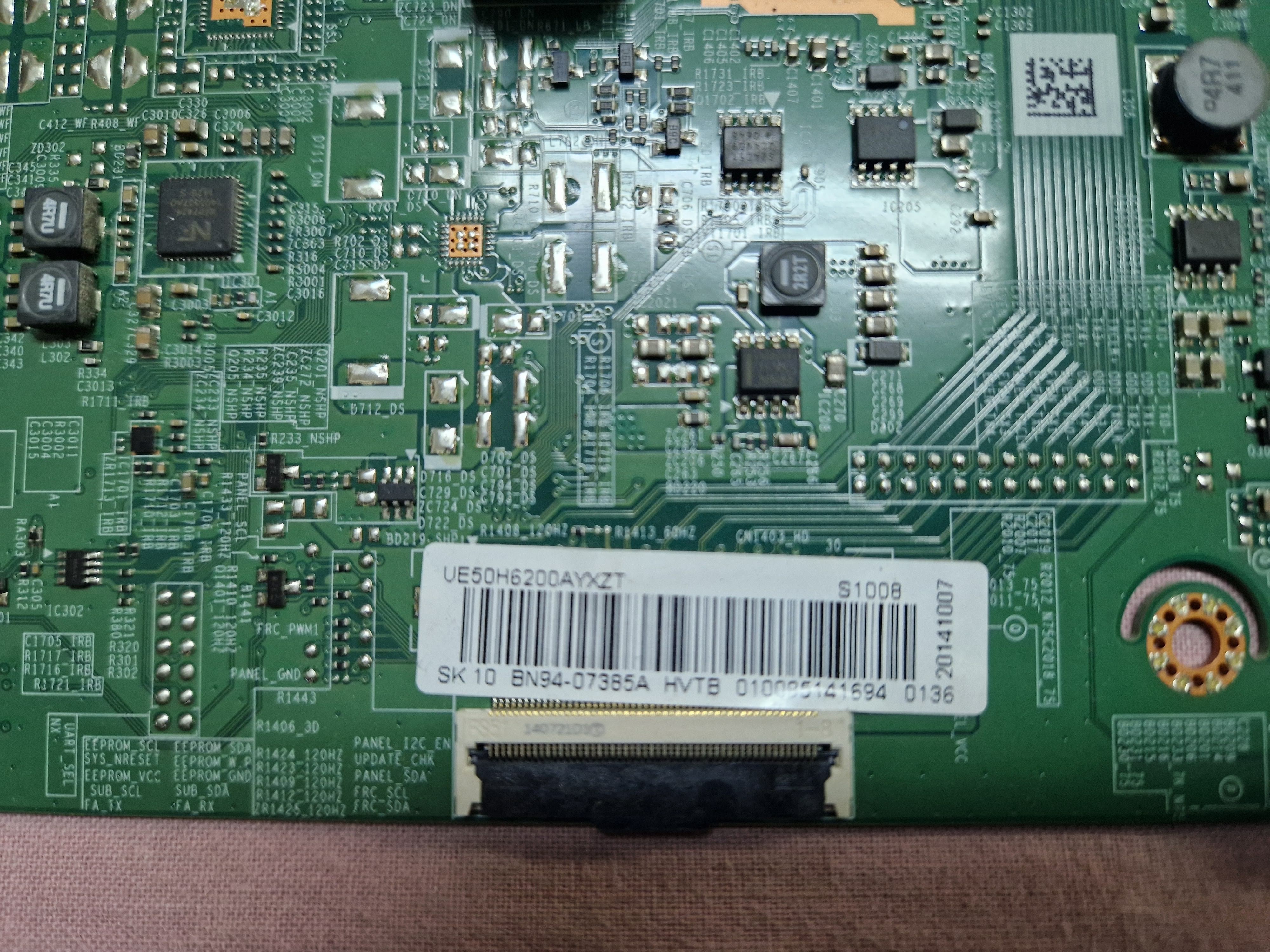

    I am after an SPI dump for this set. Fault is after the LOGO appears, the remote command stop responding and a blank screen is shown. Backlights and screen are 100% good as have tried another board of a another model but similar screen type.
    Exact model code is UE50H6200AYXZT
    BN94-07385A (BN94-07385E good as well)
    Anyone has some information please?

    I have flashed the 25Q40 and TV set fixed.
    Have found all the firmware information in this sister site https://shorturl.at/hKS13
