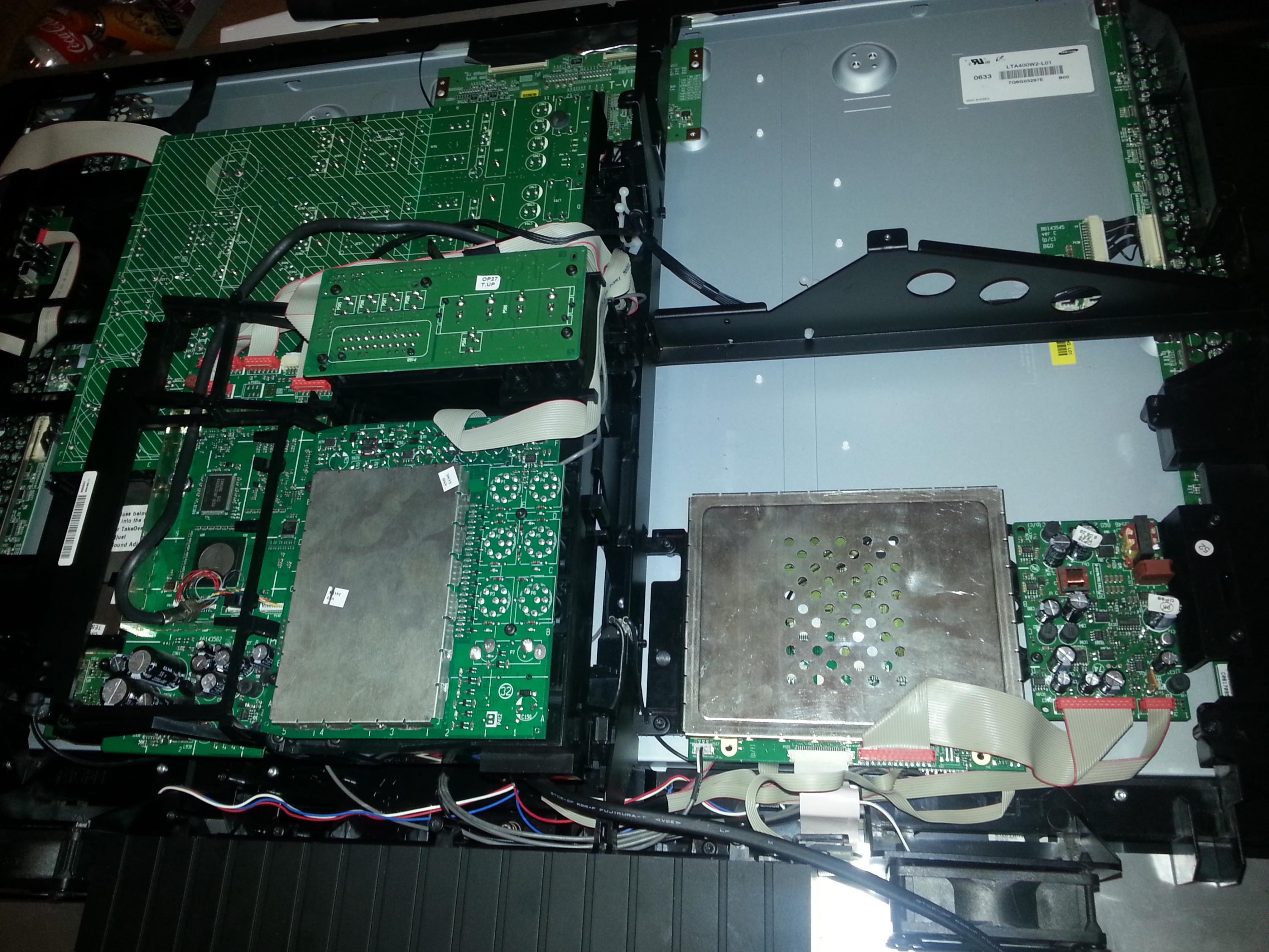

    Beo vision mk2 7-40 samsung insides back light on screen but no picture
  • selldoor
    Slow Learner
    • Dec 2010
    • 7870
    Re: reward for anyone one who fixes this bang and olfsen
    You have had enough posts now to know we are lost without pictures.- Bit like the tv!
    Moreover you have been through many tests with Tom - so rather than us wheedle each step why not do some basic testing or if you have already done it tell us what you find/found. From what you say it could be power supply, main board, Tcon, cables.
    What is the history of the set - died in action - found in a bin?

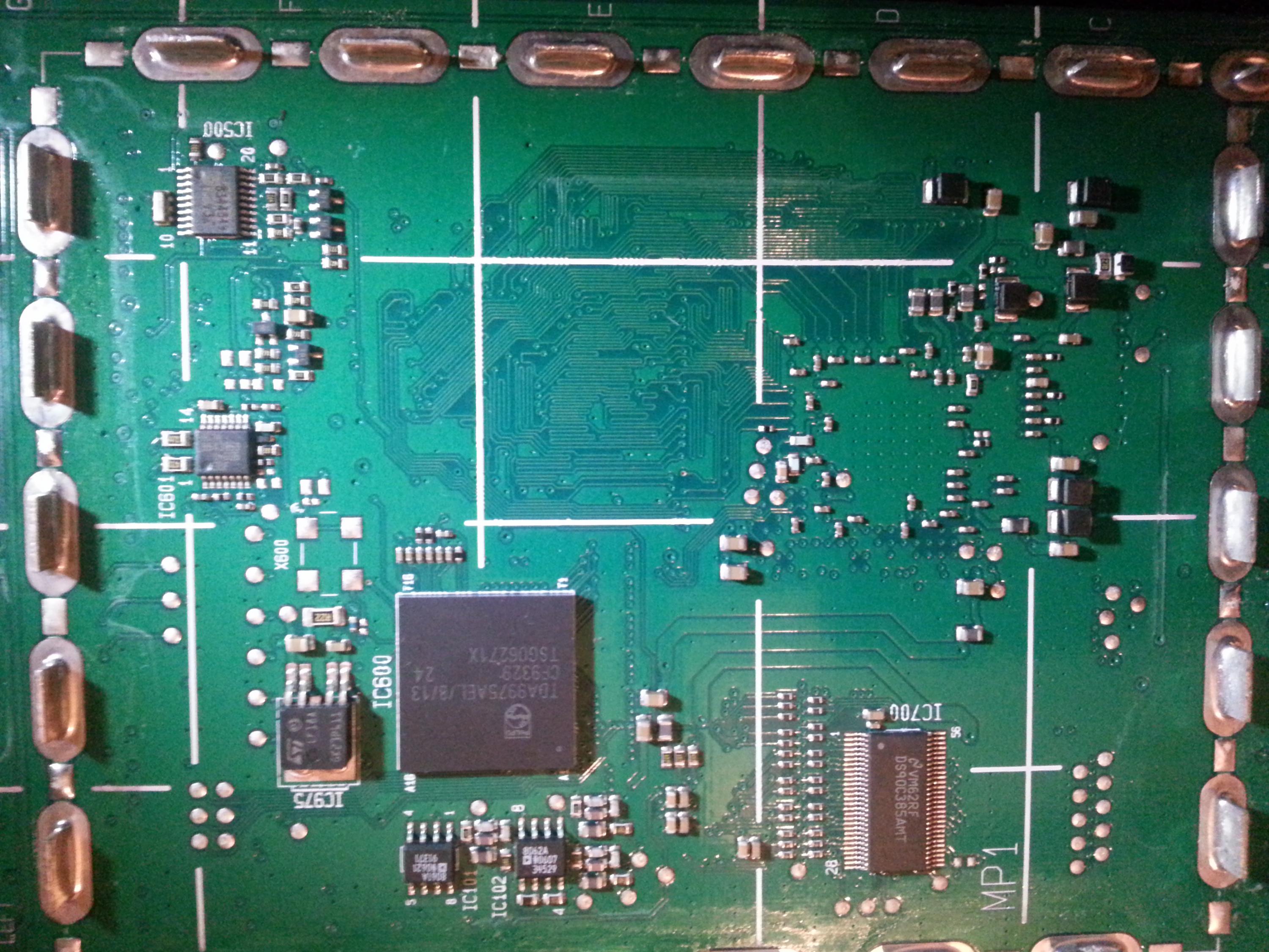

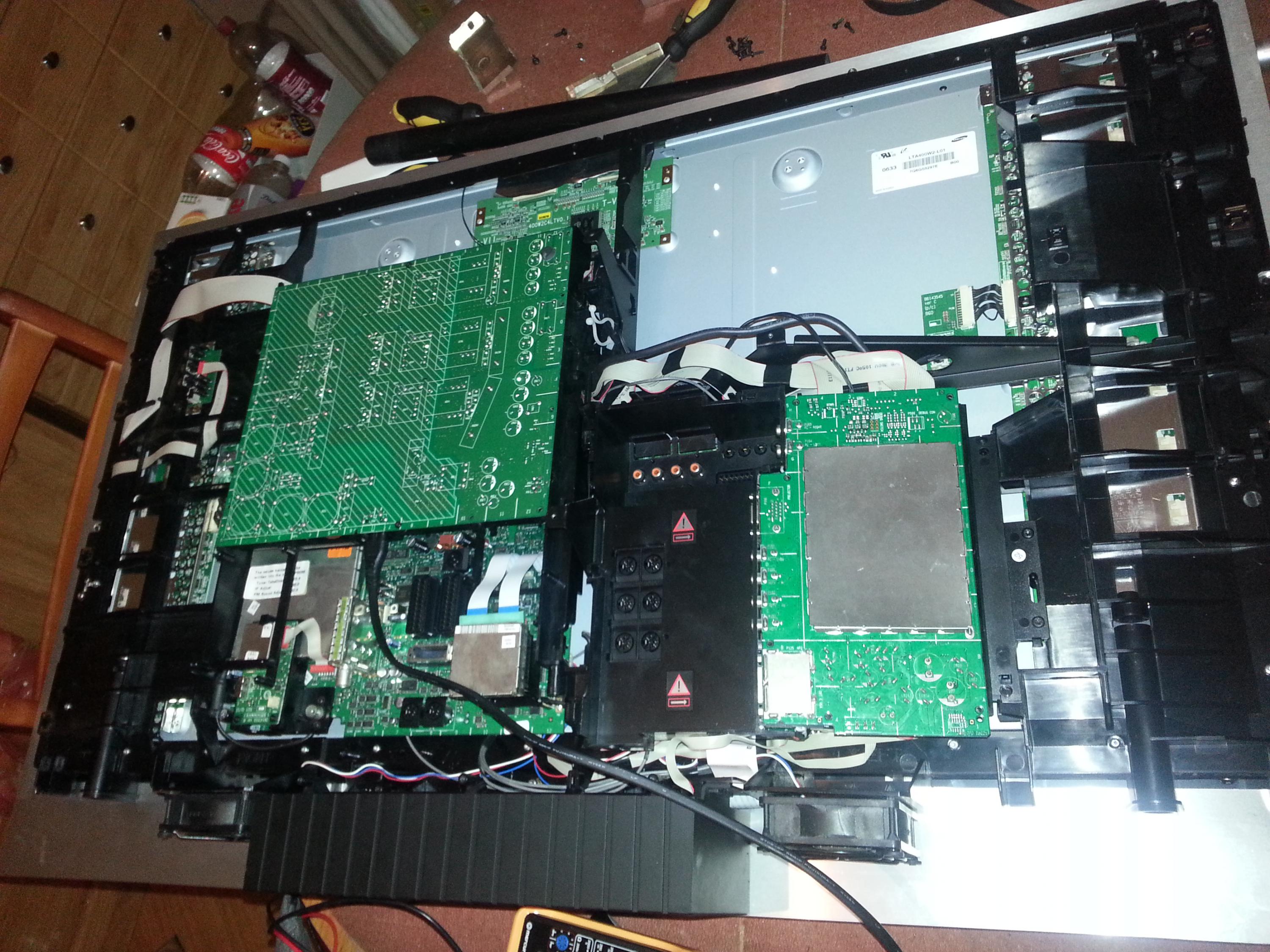

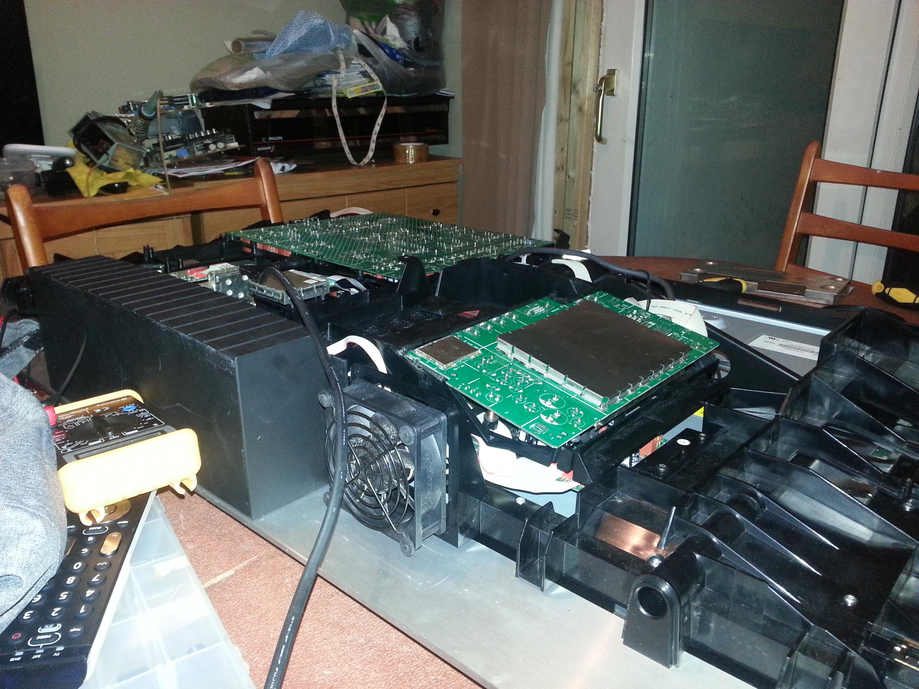

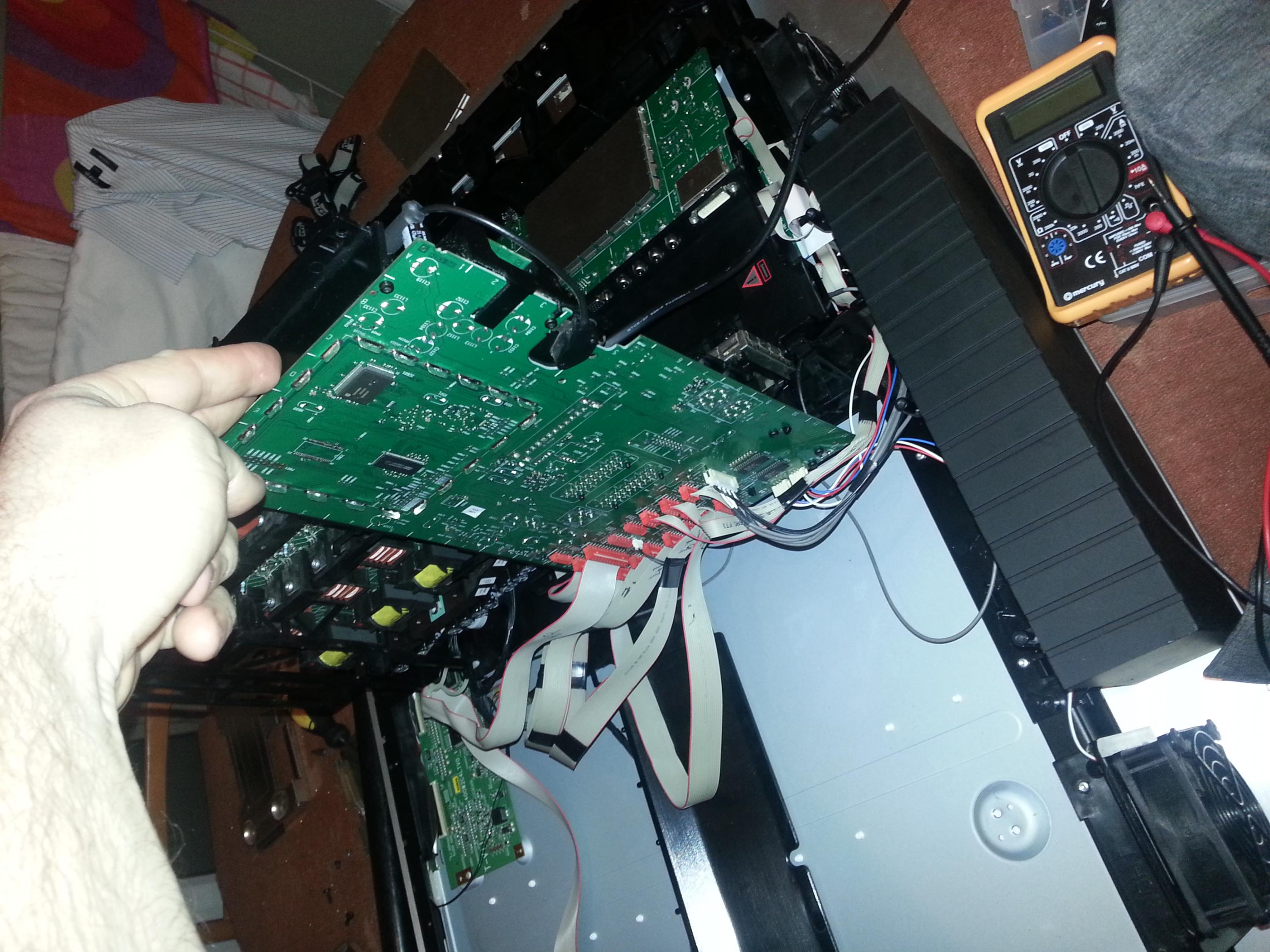

      I have been doing it but this tv has 10 boards in total !!! Turned on watchin went to black screen with back light
      • adamp91gvm
        • Jan 2014
        • 699
        • uk
        here is pics

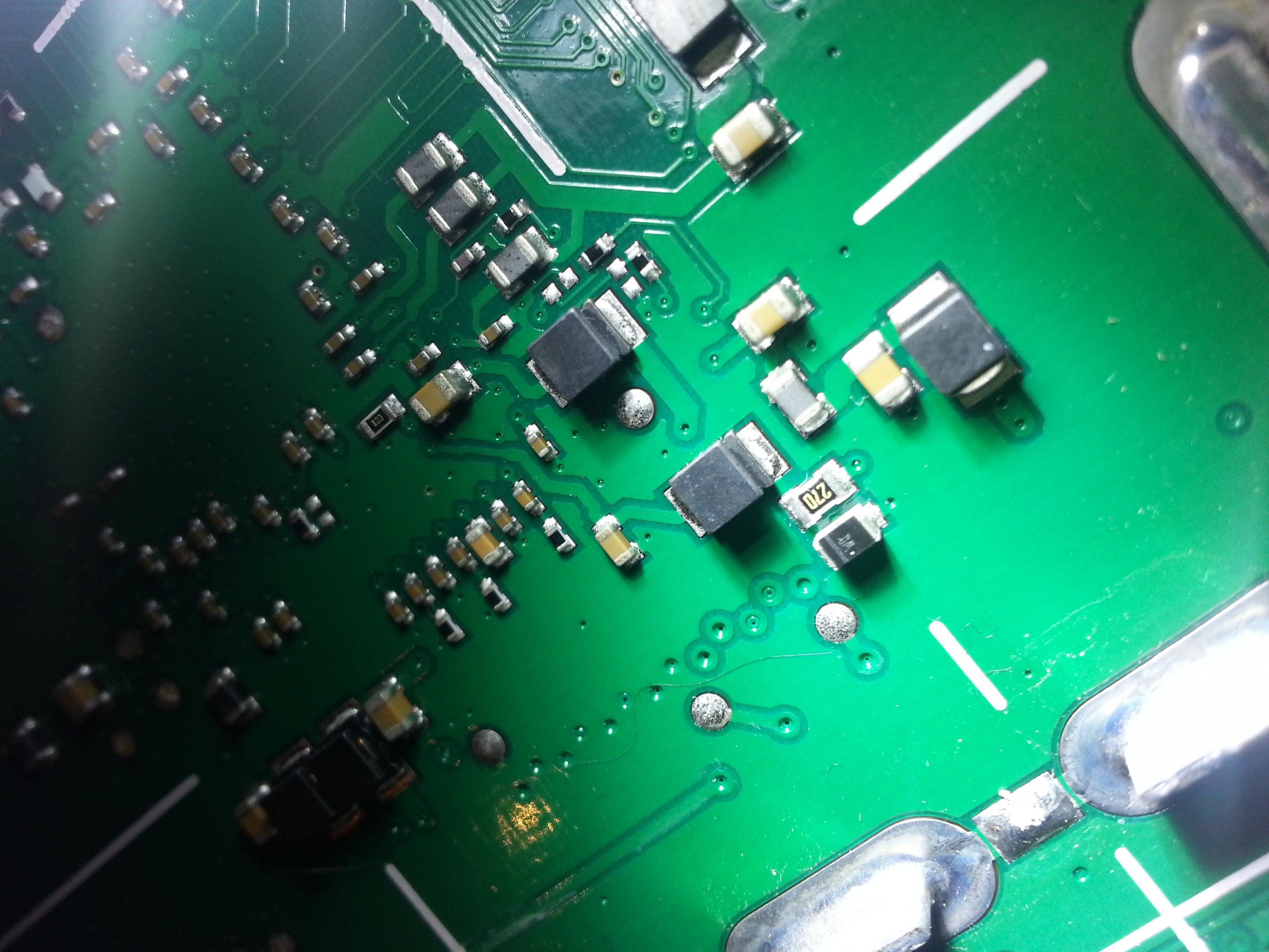

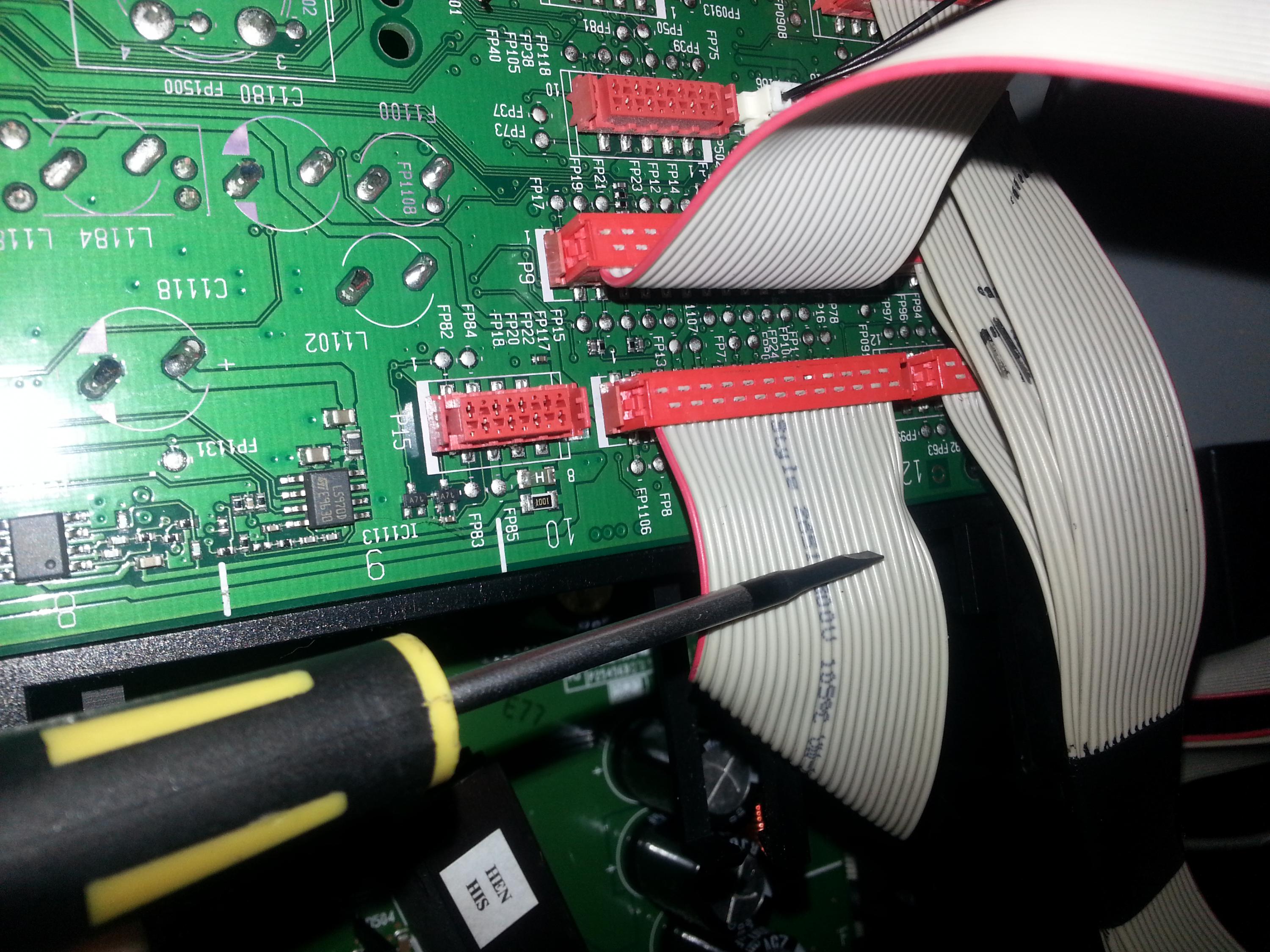

          Anyone see any fuses on here ?

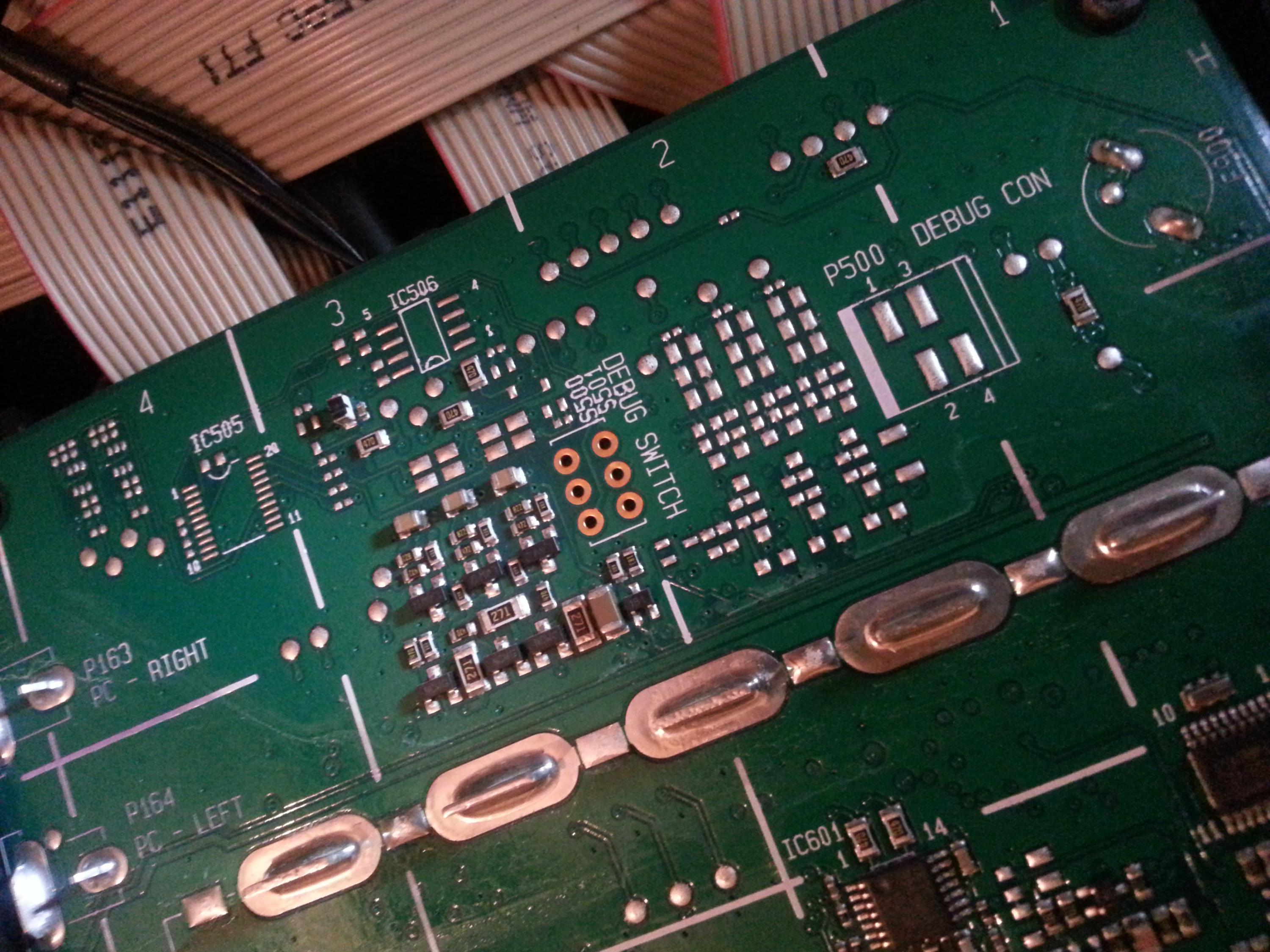

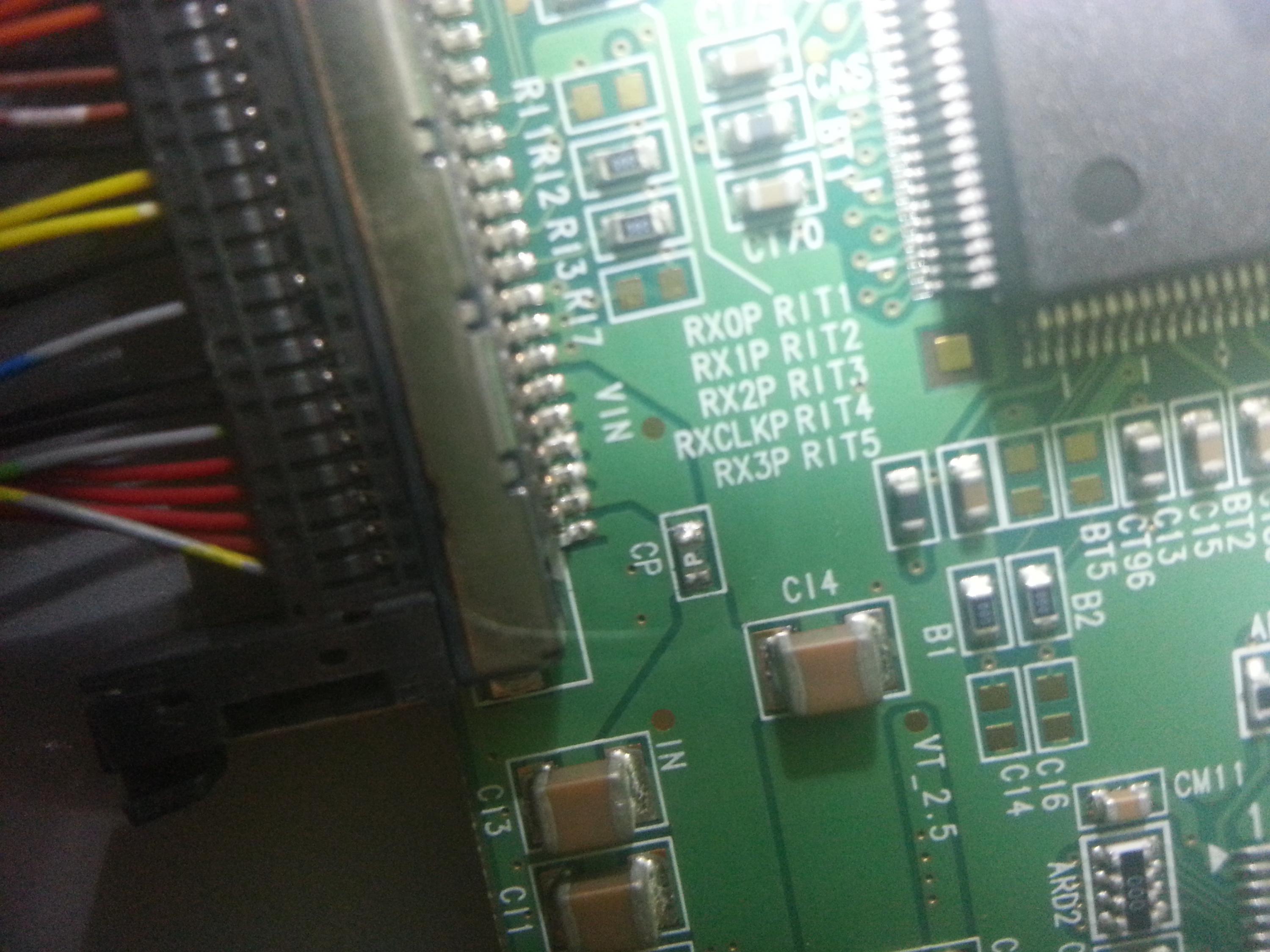

            What is this ? I'm getting power to one side and nothing to the other on the other side of this board is the wire that goes to the control board bellow the 270
              Err--What part you on about!
              There's like, maybe 50 in that picture.....
                        In Pic 3 in the first group of 4 - on the left hand side just to the left of the group of
                        red cable connectors there looks to be a red barrel fuse - is it - and if it is test it.

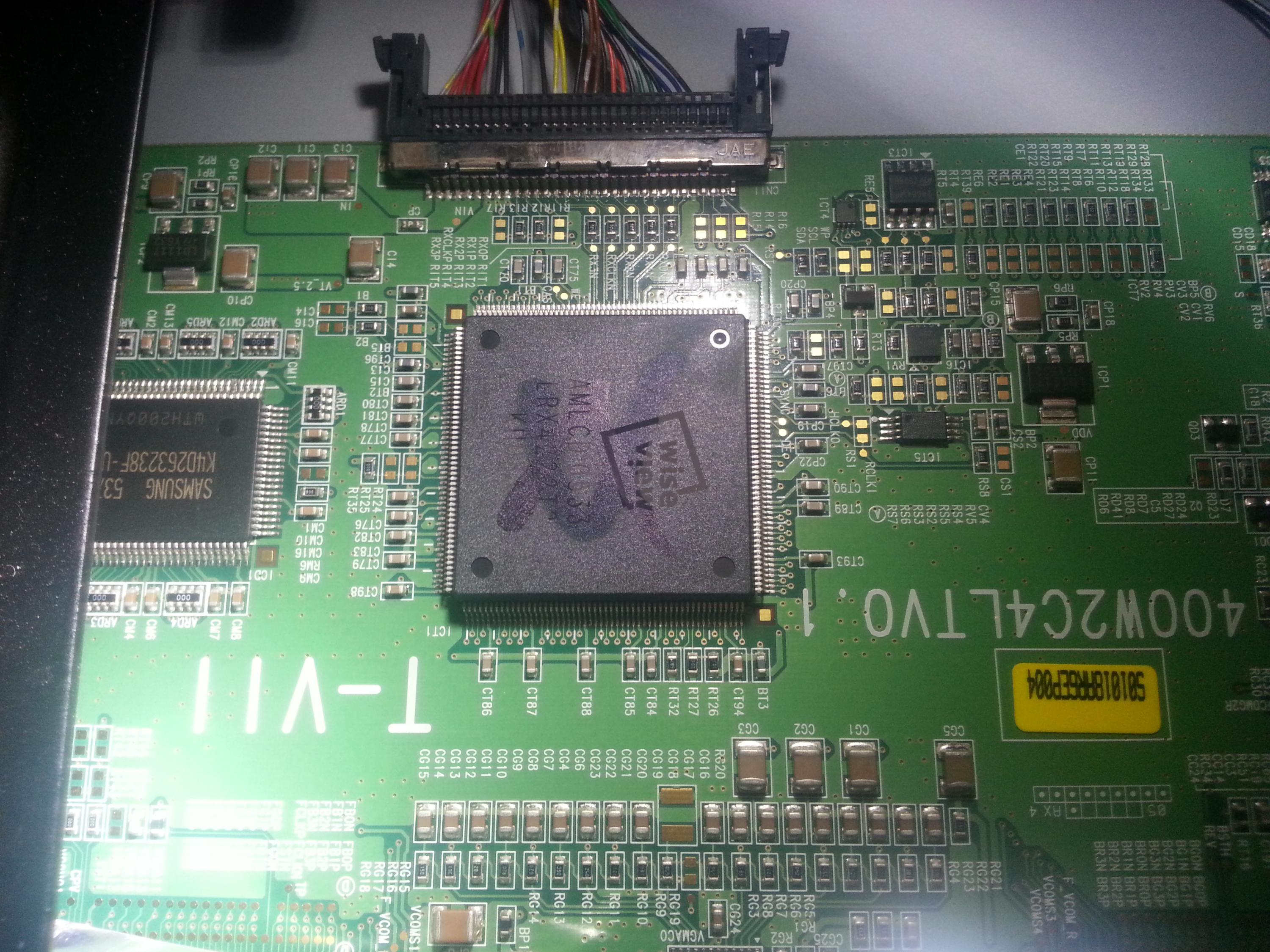

                          When you say "you get power to one side" you need to clarify. A voltage on one end, wrt (with respect to) ground, is not necessarily "power" on one side. Is that what you mean? Plenty of components act like that, typically, they are parallel parts. It is not necessarily a fault.
                          Have you checked the fuse on the t-con board and the voltage at both ends of that fuse?
                            Where is the fuse on this t con ?
                              This with the p on im getting 5.13v into it but only 0.10v out
                                  The "P" is a fuse. It commonly blows on these sets, so you can try replacing it.
                                  T-con fuse is first place to check when no picture with backlight symptom is presented.
                                    Remember the fuses on the panasonic are these the same ?
                                      Different, but as a quick test (and ONLY as a test) you could use it.
                                      For full repair replace with 3A 32V (or higher) 0603 type fuse, e.x.
                                      http://cpc.farnell.com/multicomp/mc0...20This%20Range
                                      • adamp91gvm
                                        • Jan 2014
                                        • 699
                                        • uk
                                        My friend u have won the reward booted up perfect inbox me your pay pal I want to get u a drink on me thank you
