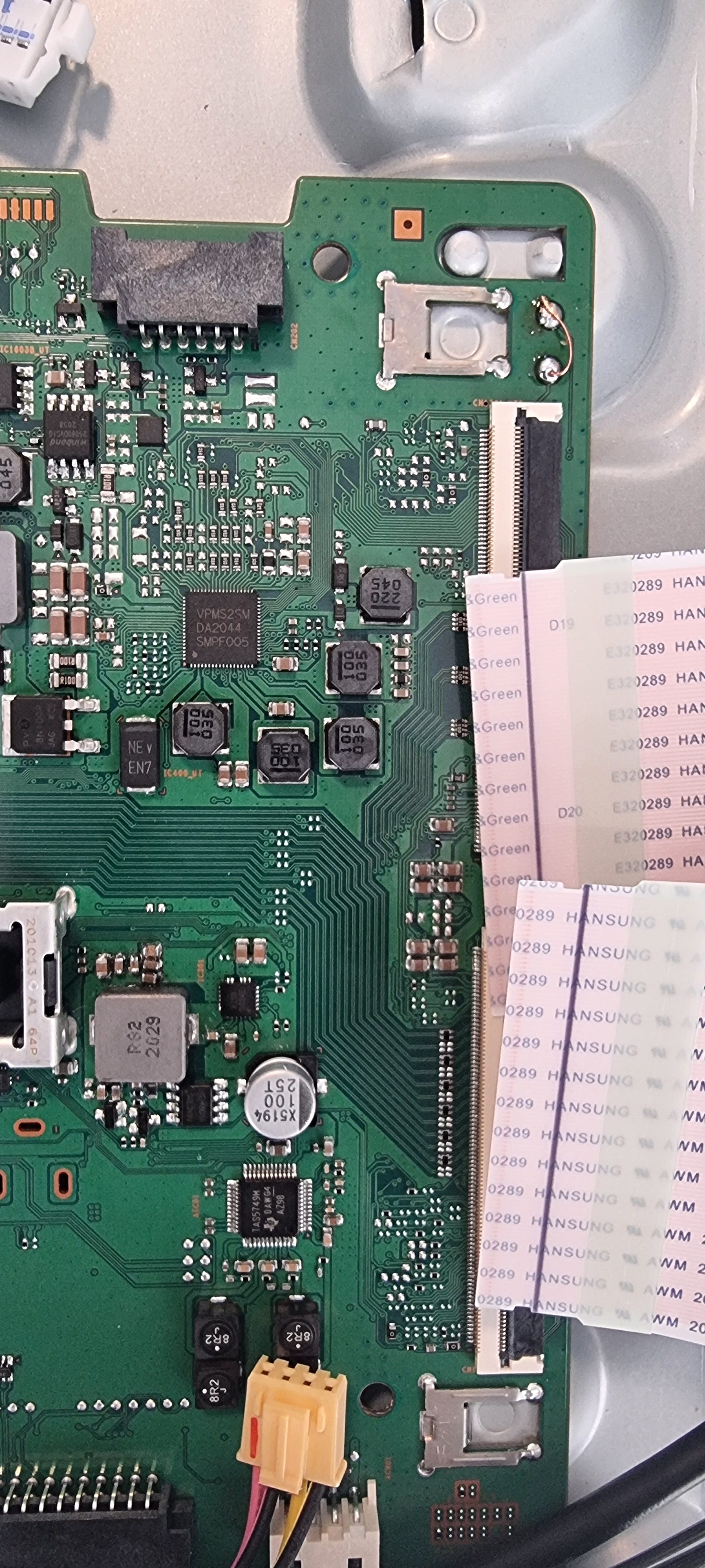

    I added the jumper and tried each LVDS cable one at a time and then without any of them connected. The outcome was the same in each test: no change. Same sequence of backlight/standby light blinks.
    Is it perhaps time to consider flashing something? If so, I unsure what as I see x2 Winbond ICs (one close to the GPU/CPU and the other next to the power connector) and an eMMC IC.
    I added a photo of what I jumper--pretty sure I got it correct as you photo was very clear/helpful Lotas.

      remove all masks from LVDS... and rework your Jumpers soldering its bad. on one points

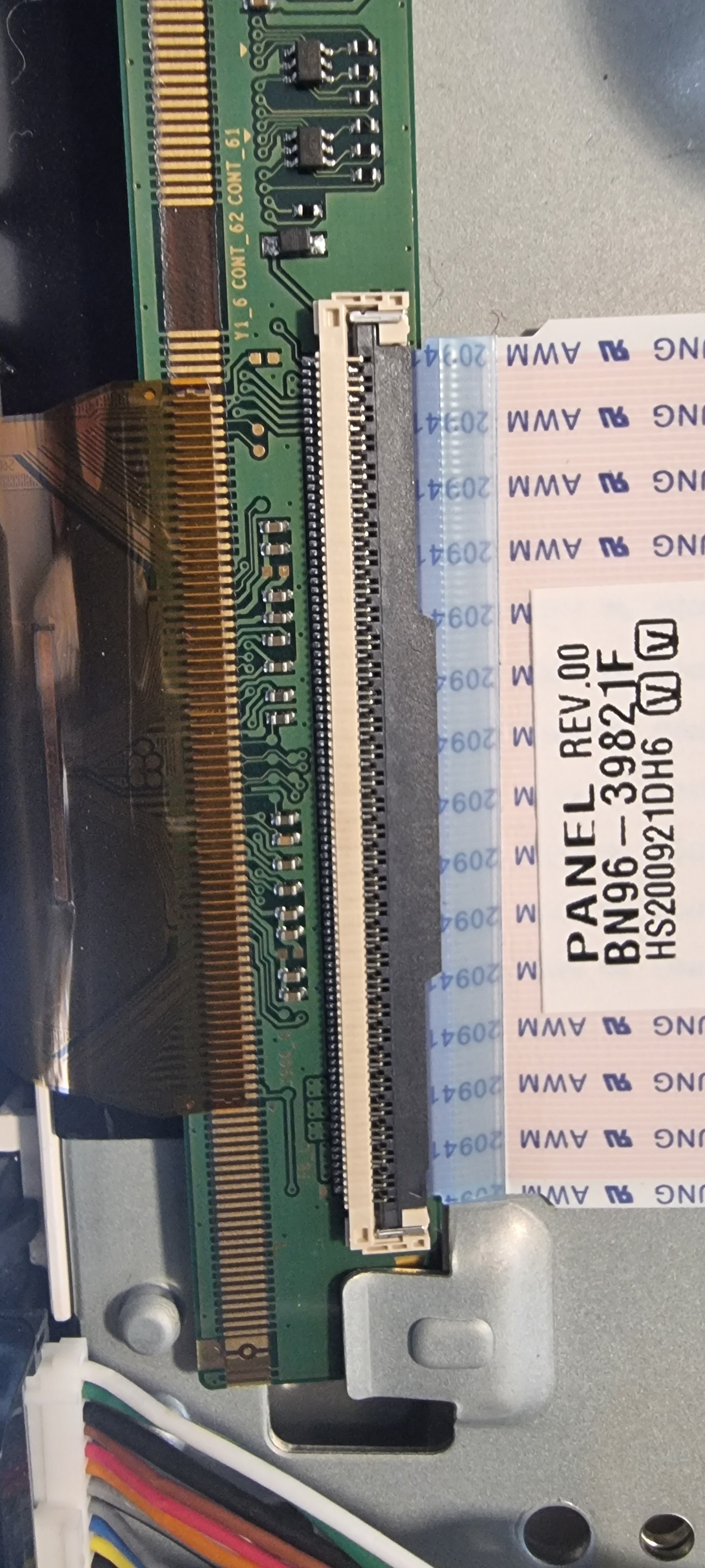

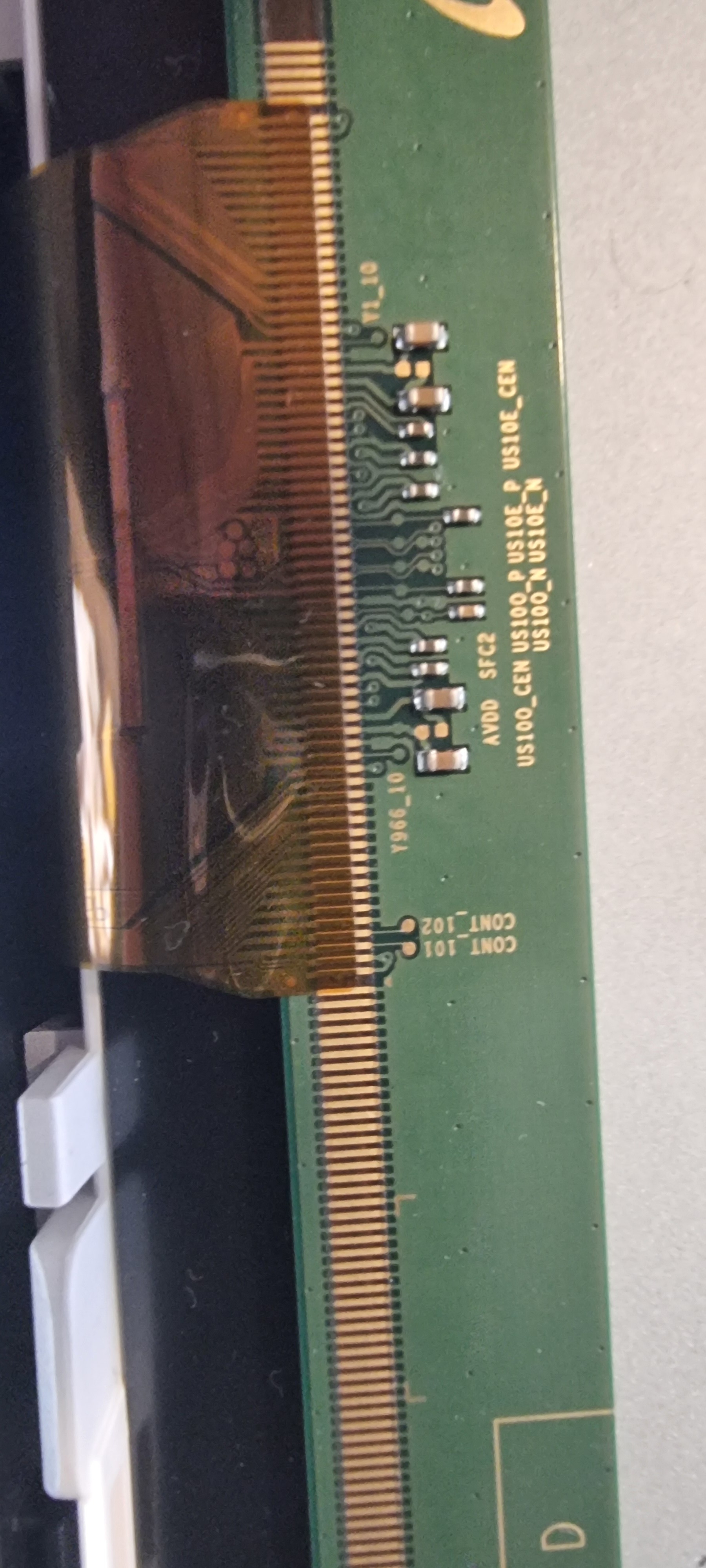

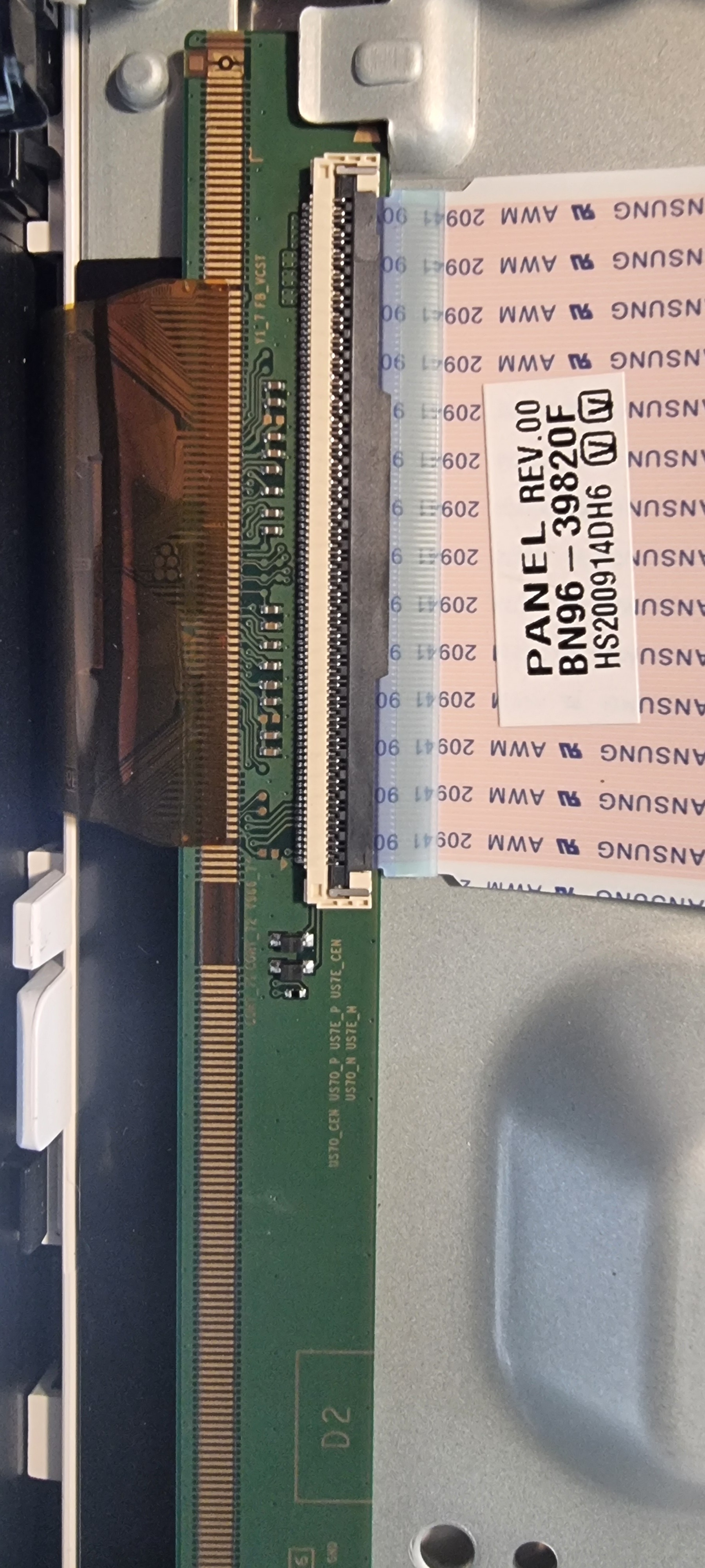

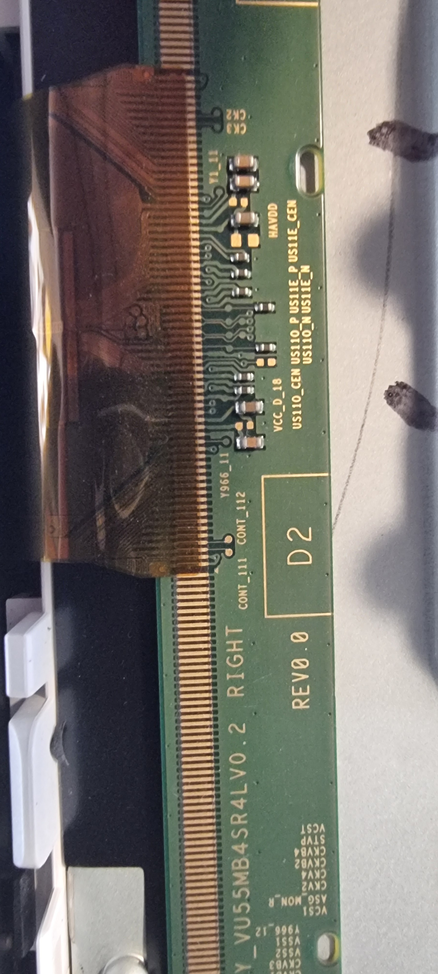

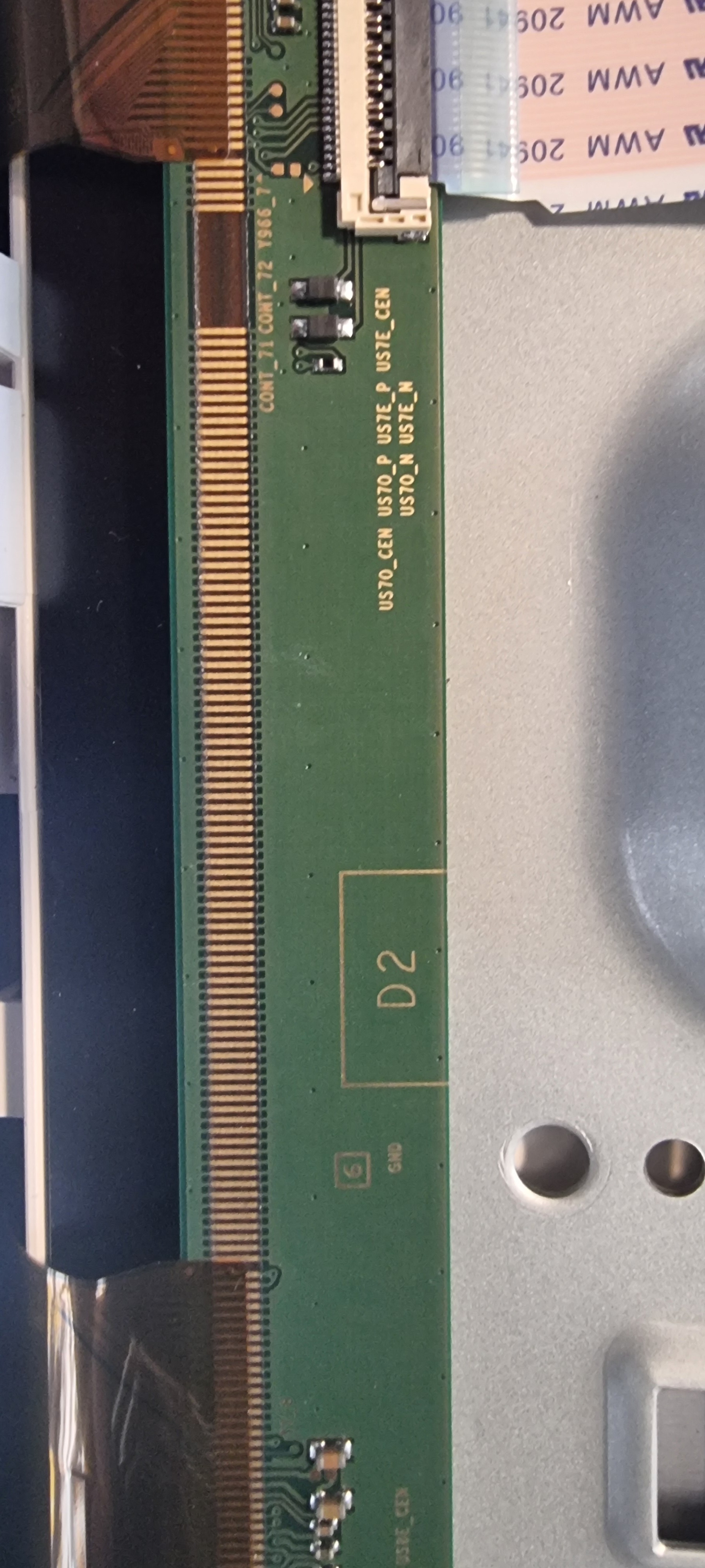

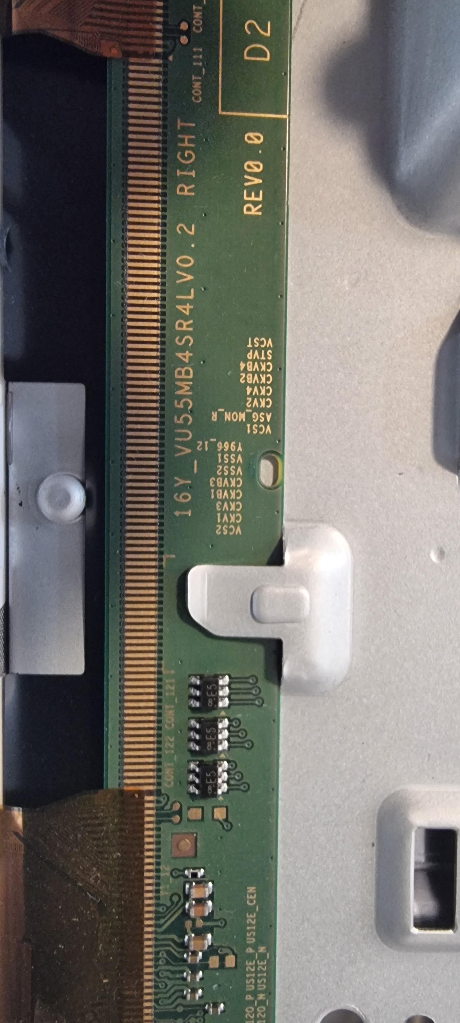

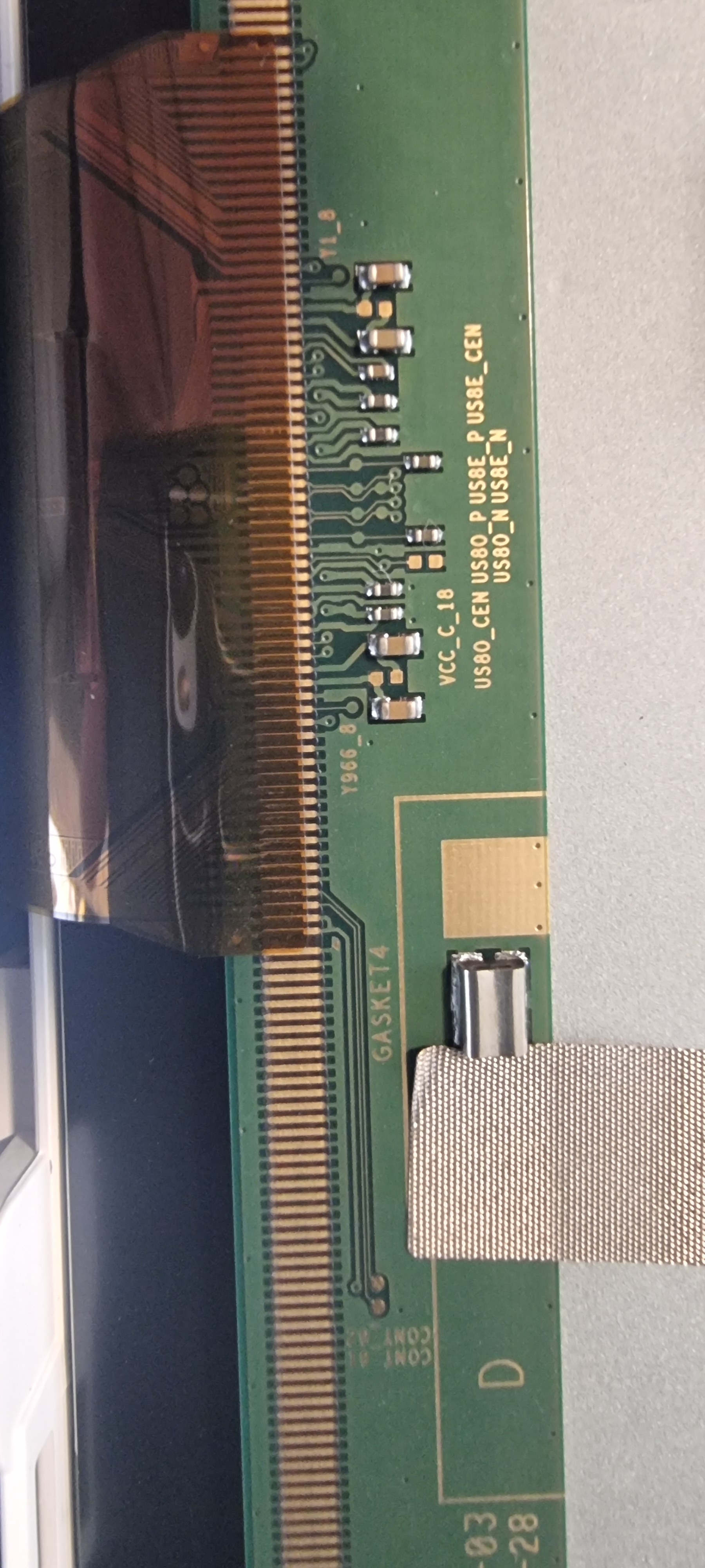

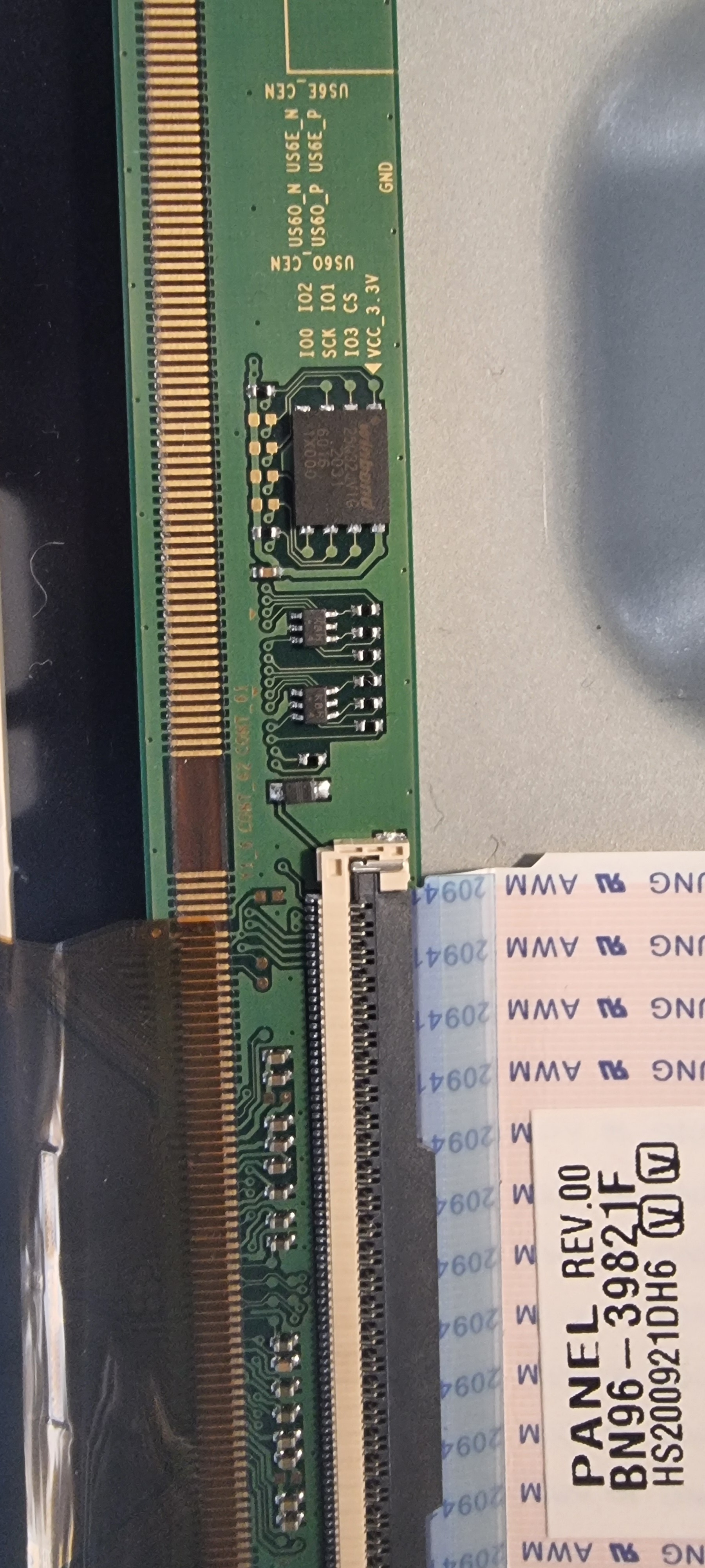

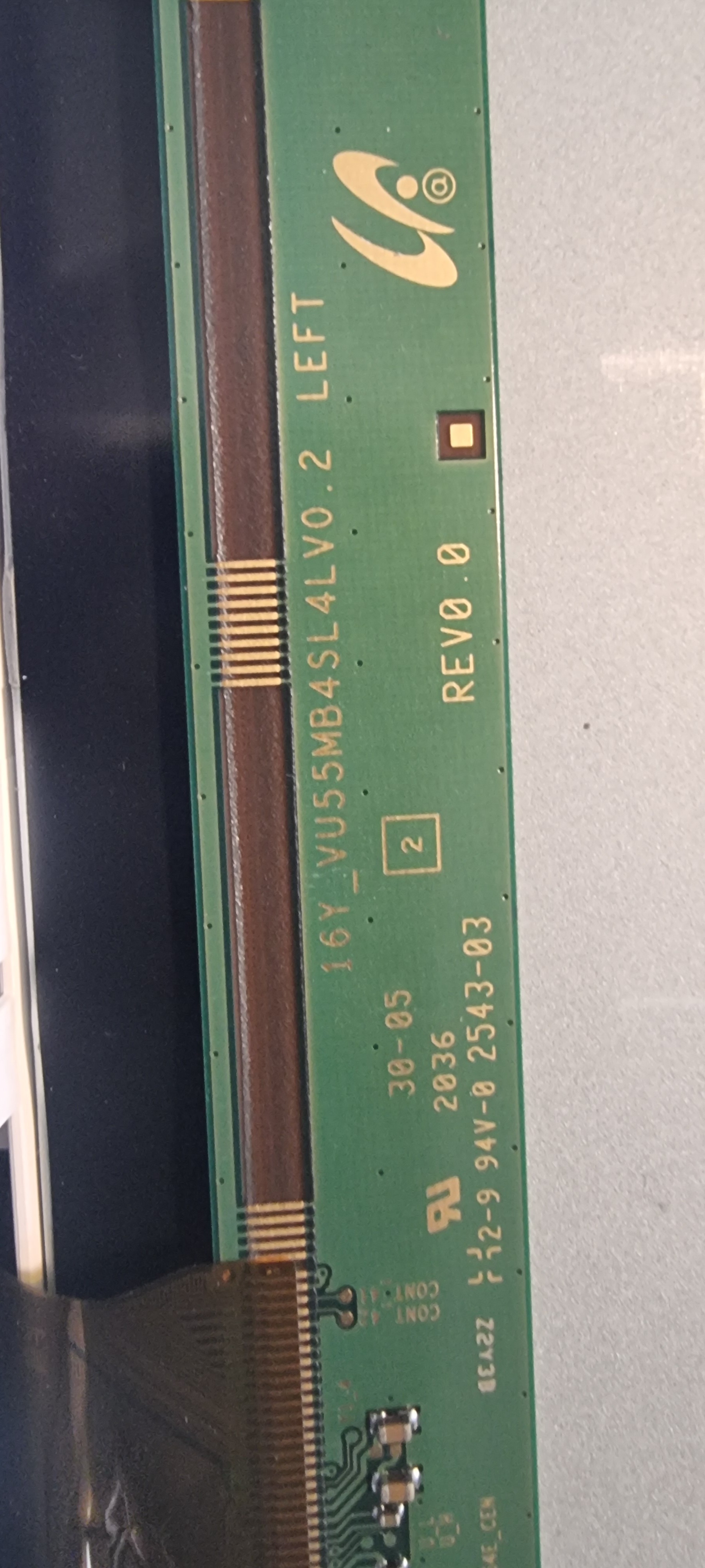

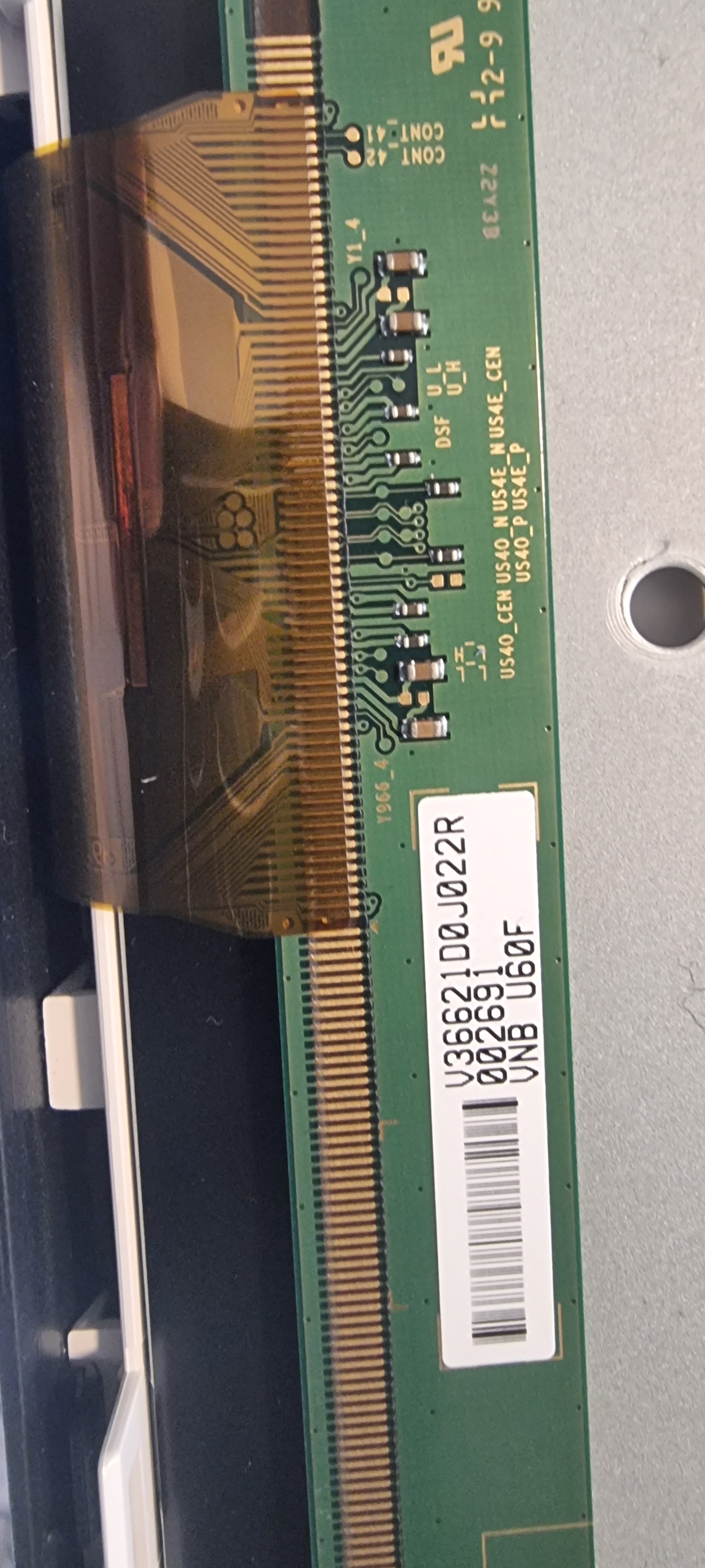

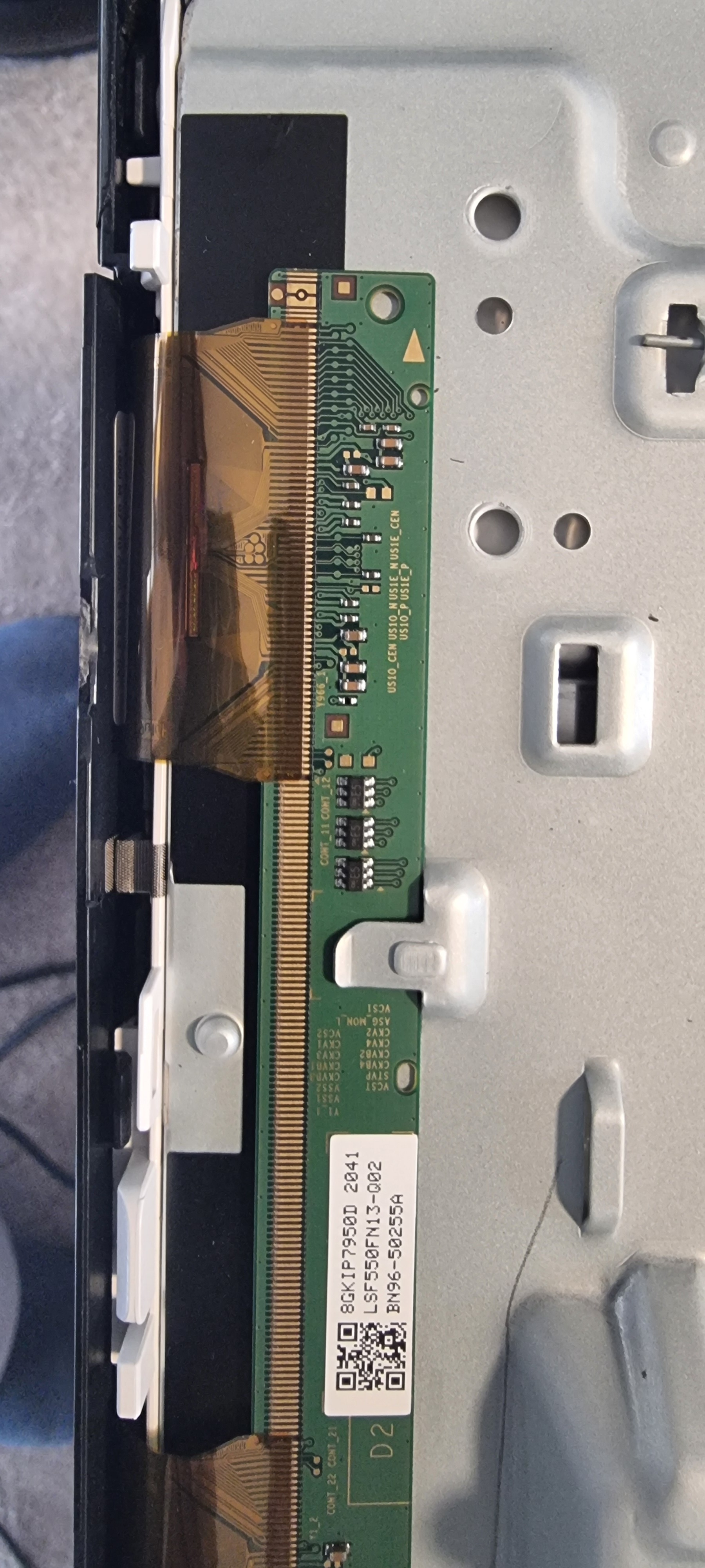

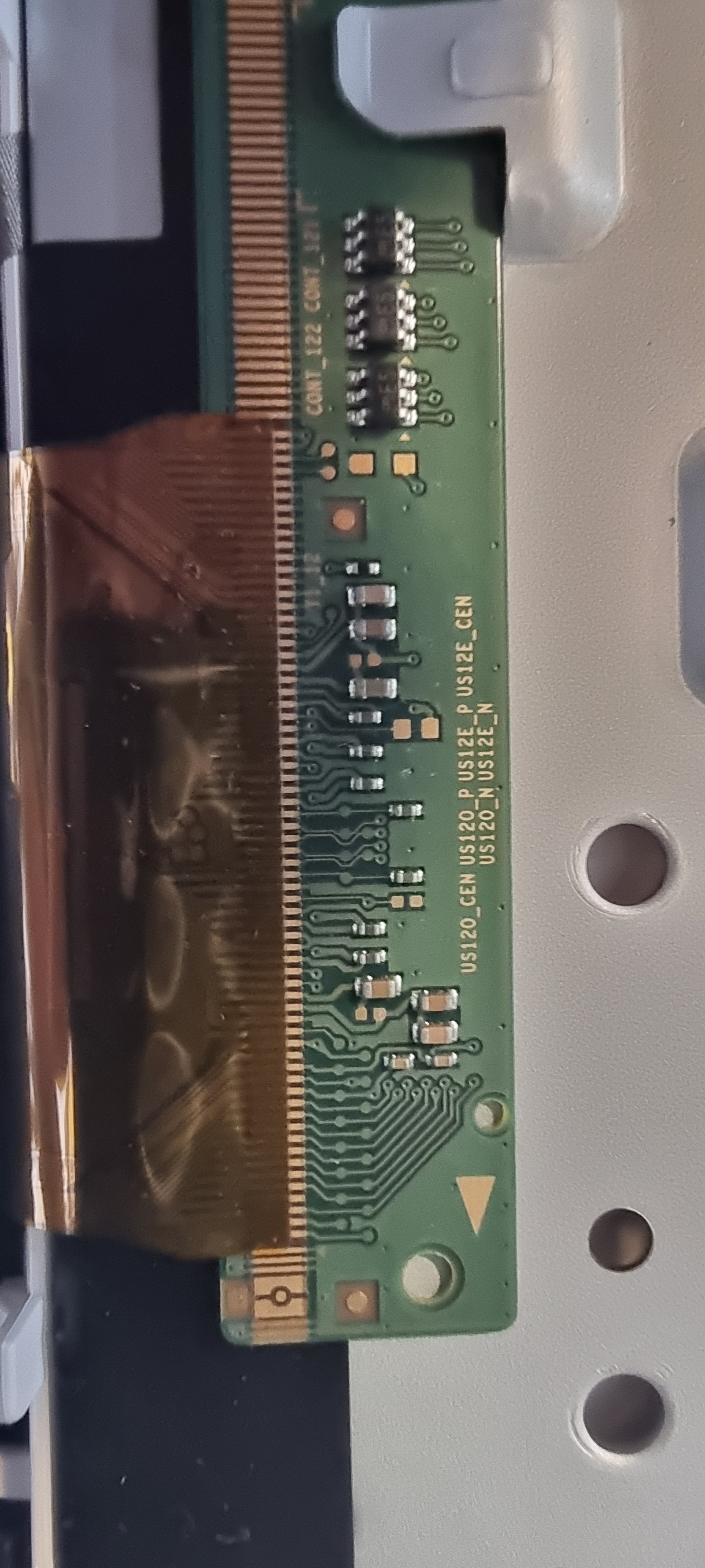

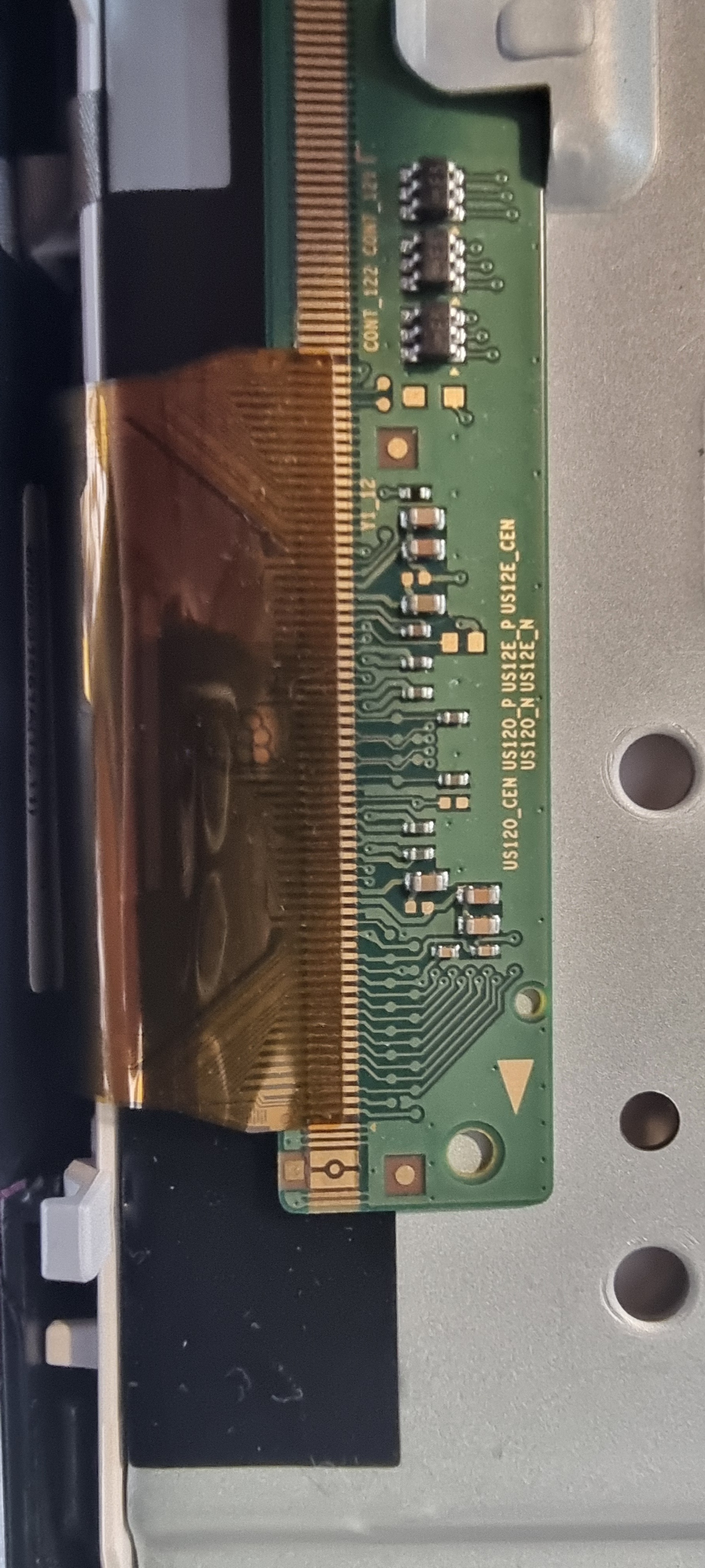

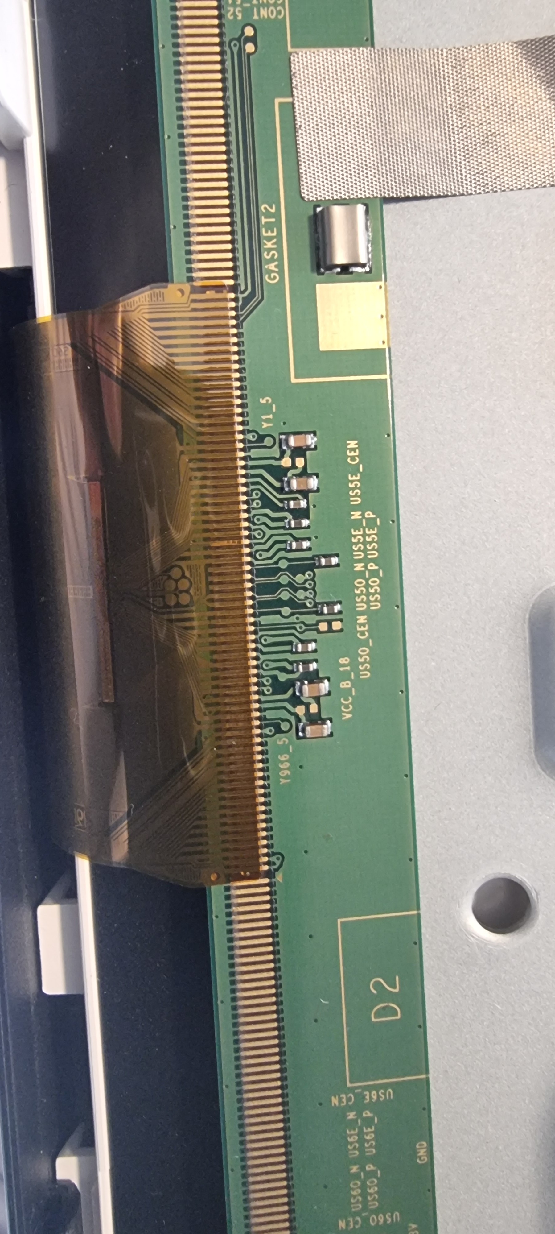

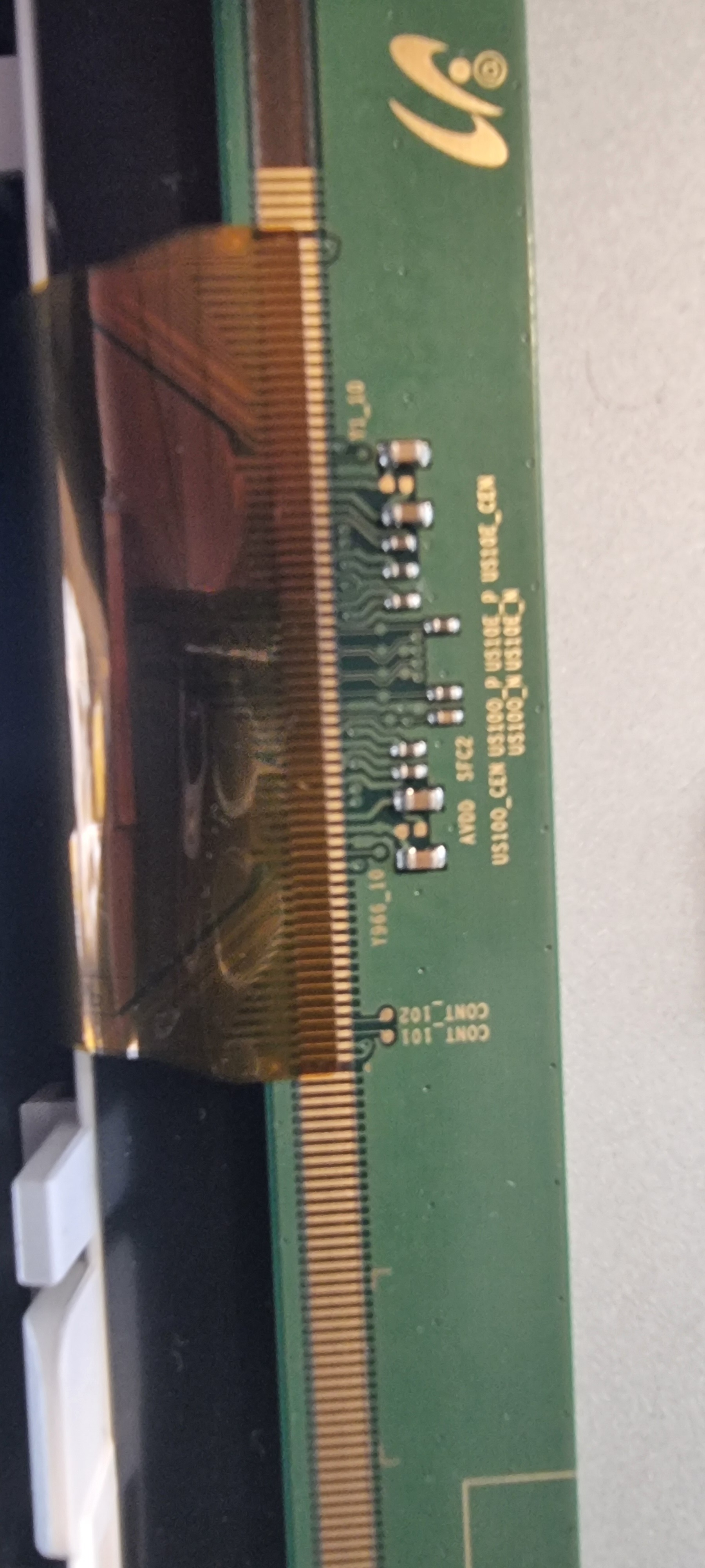

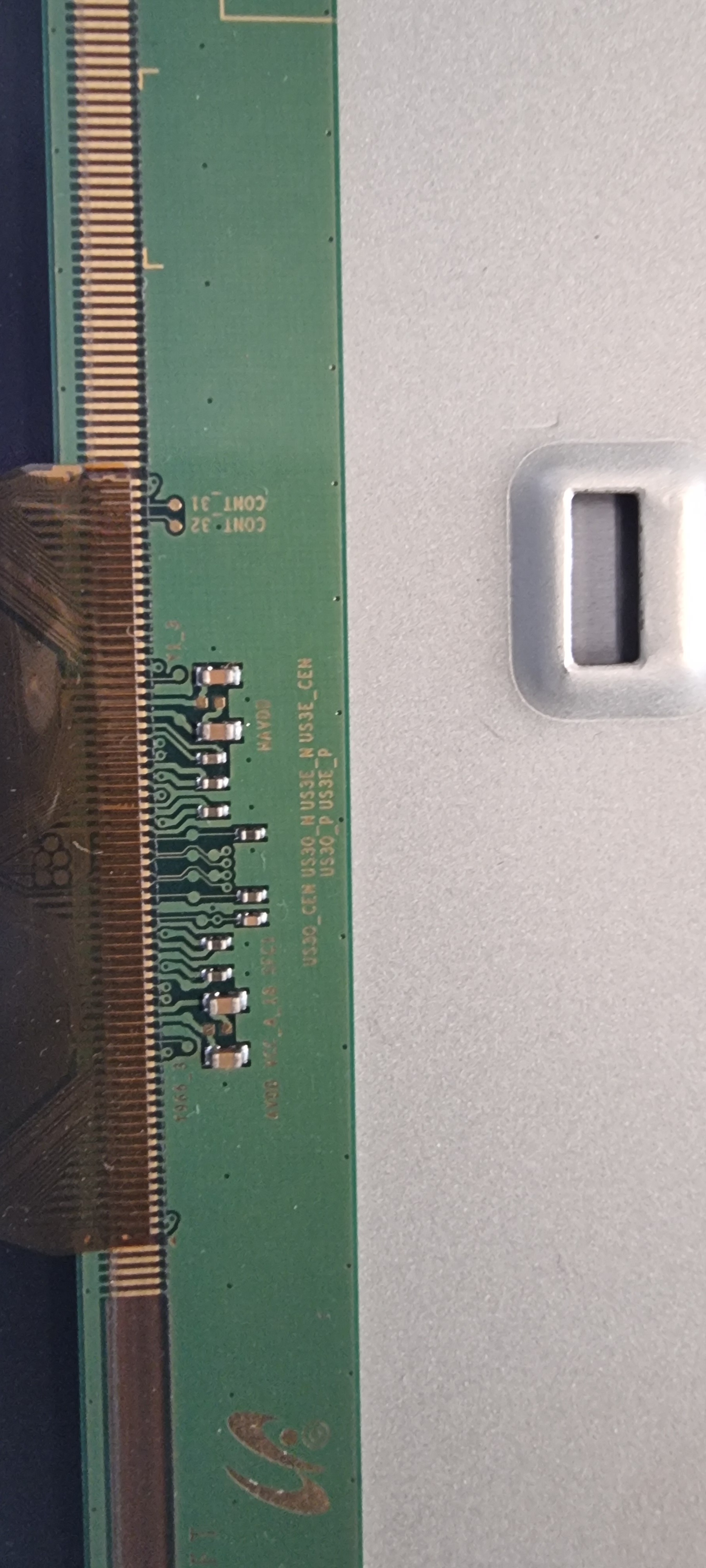

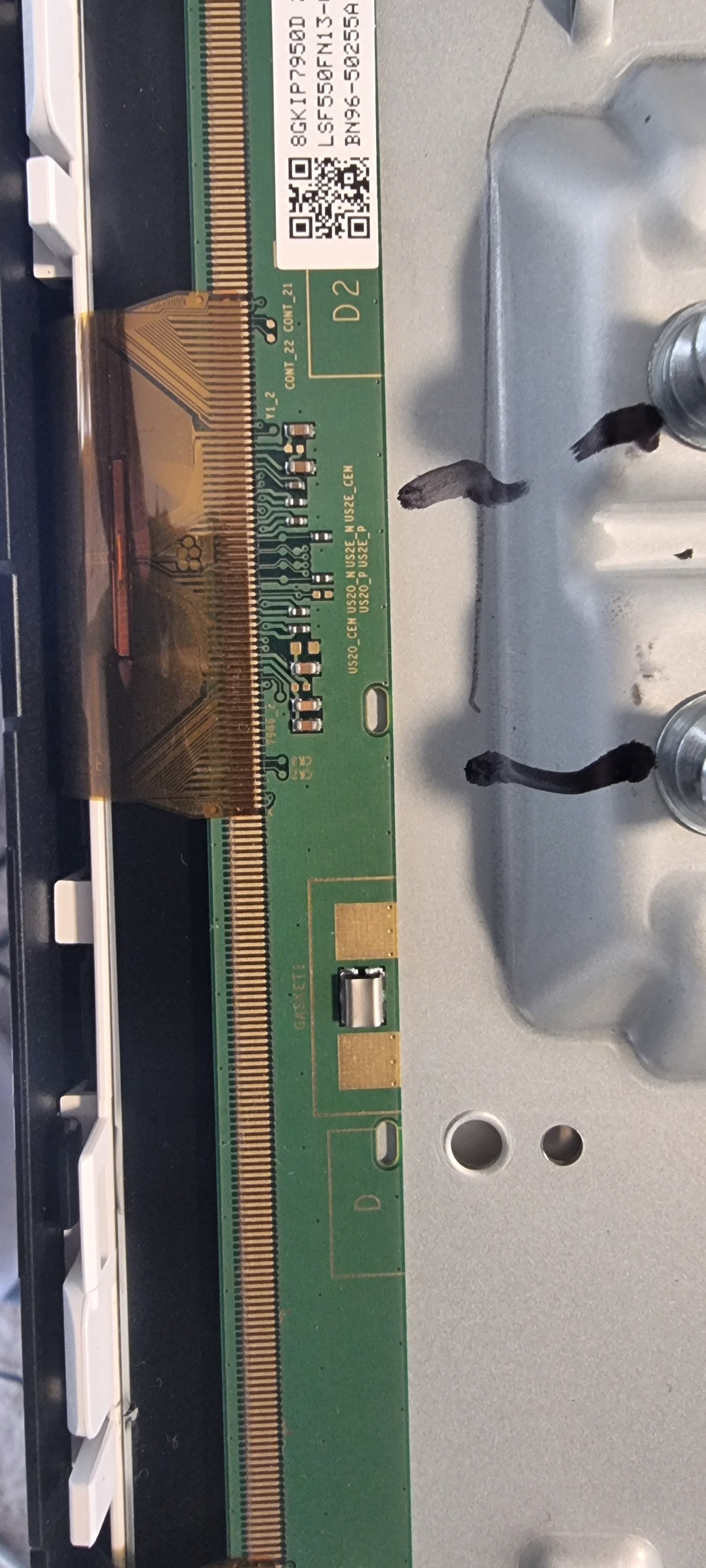

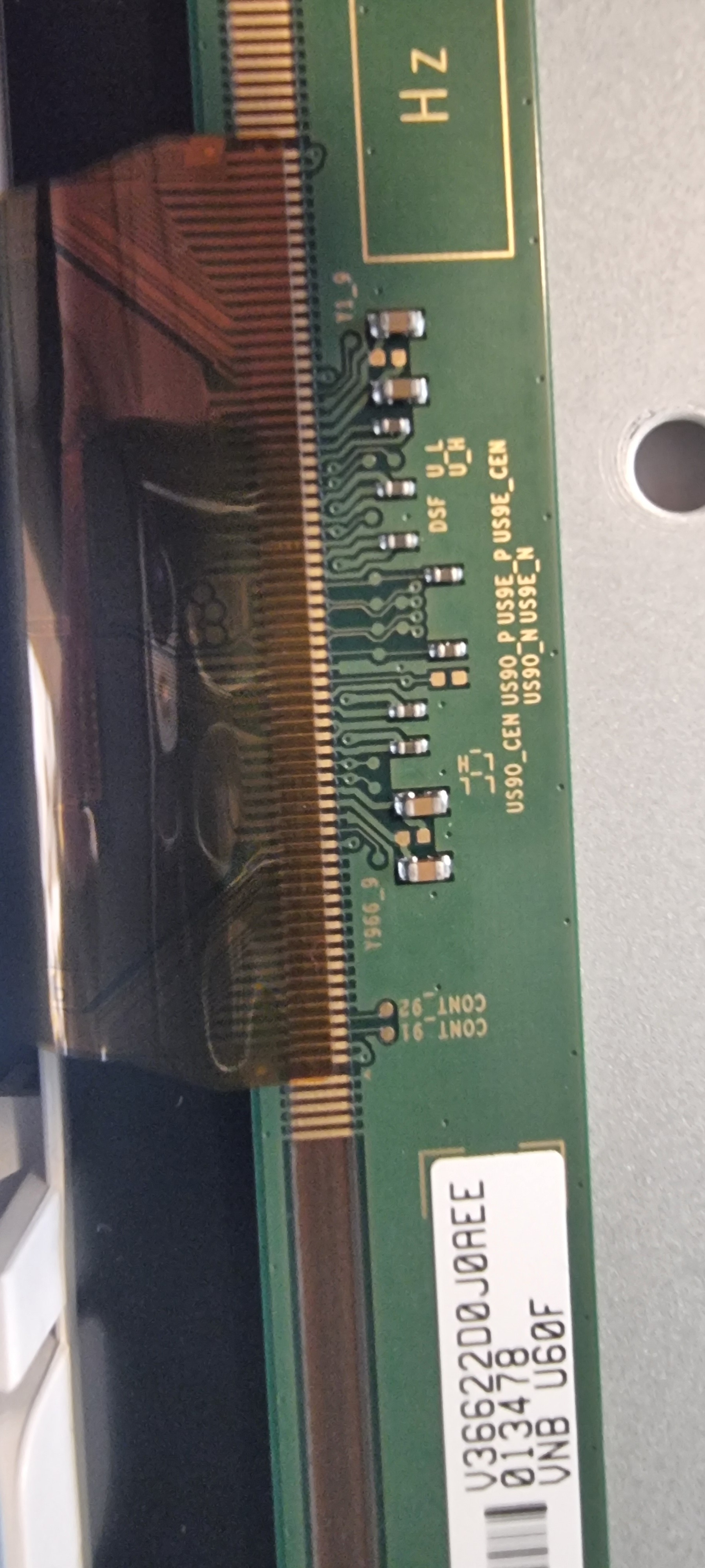

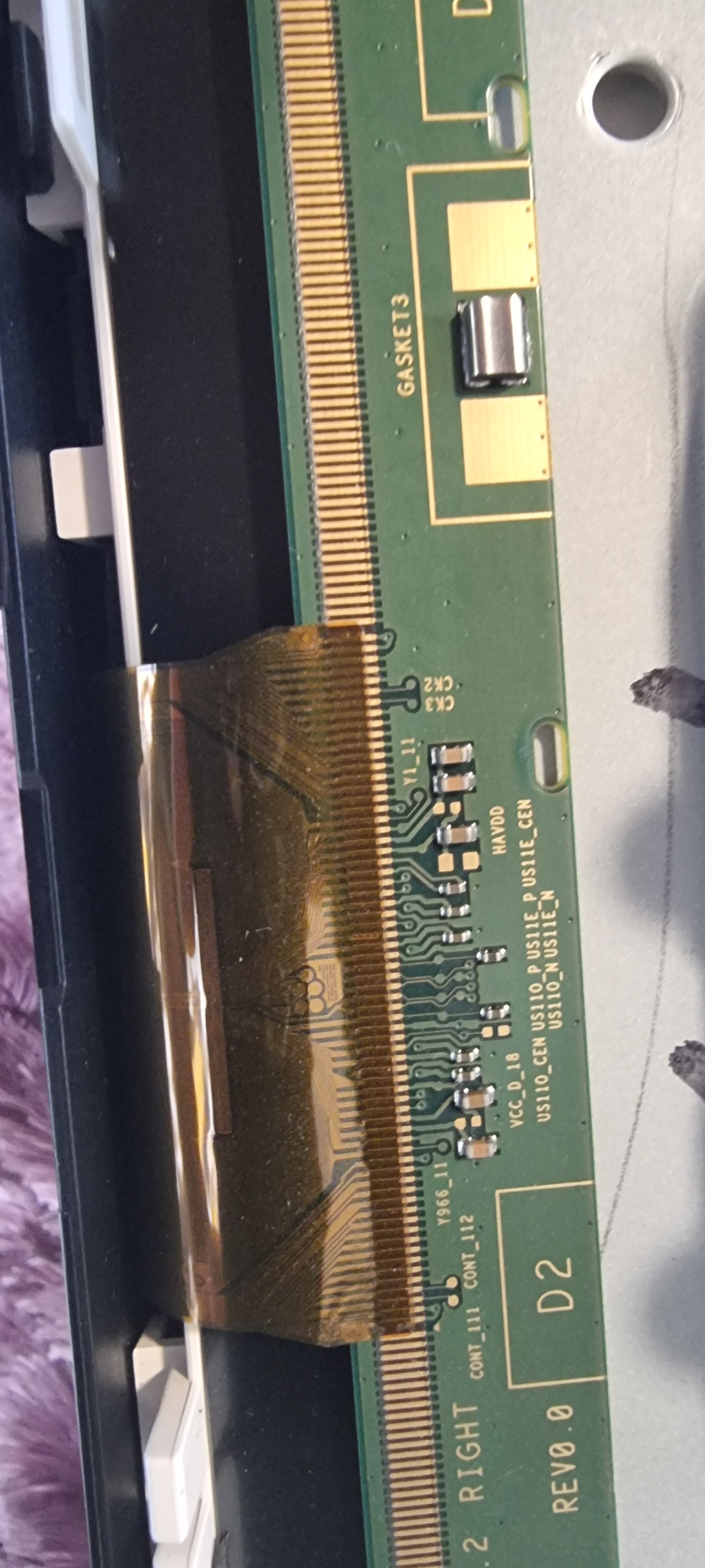

          remove yours jumpers.. and remove the metal cover of yours panel buffer boards , upload clear photo of the left and right side,,, le see if there ESD diode pack installed
          • learnmore
            • Mar 2022
            • 100
            • England
            Okay, jumpers removed. Here are the panel buffer boards photos.
            • Diah
              • Feb 2013
              • 6363
              disconnect the panel LVDS from Mainboards and test these in diode mode as Diode 1 & 2 maybe they are the same on one boards... i cant tell however test any you have such parts

                ok, I guess I'm check for shorts in these small smds
                • learnmore
                  • Mar 2022
                  • 100
                  • England
                  Did some diode, resistance and continuity checks on the panel smd, nothing usual found...

                    if you did all correct... we need fo back to PSU.... put all sockets LVDS in place... and power on.... test all pins on the socket of the PSU which it go to MB... tell the V. if it fluster and how much... dont forget to write pin NO and the name of it as in print chart of the boards
