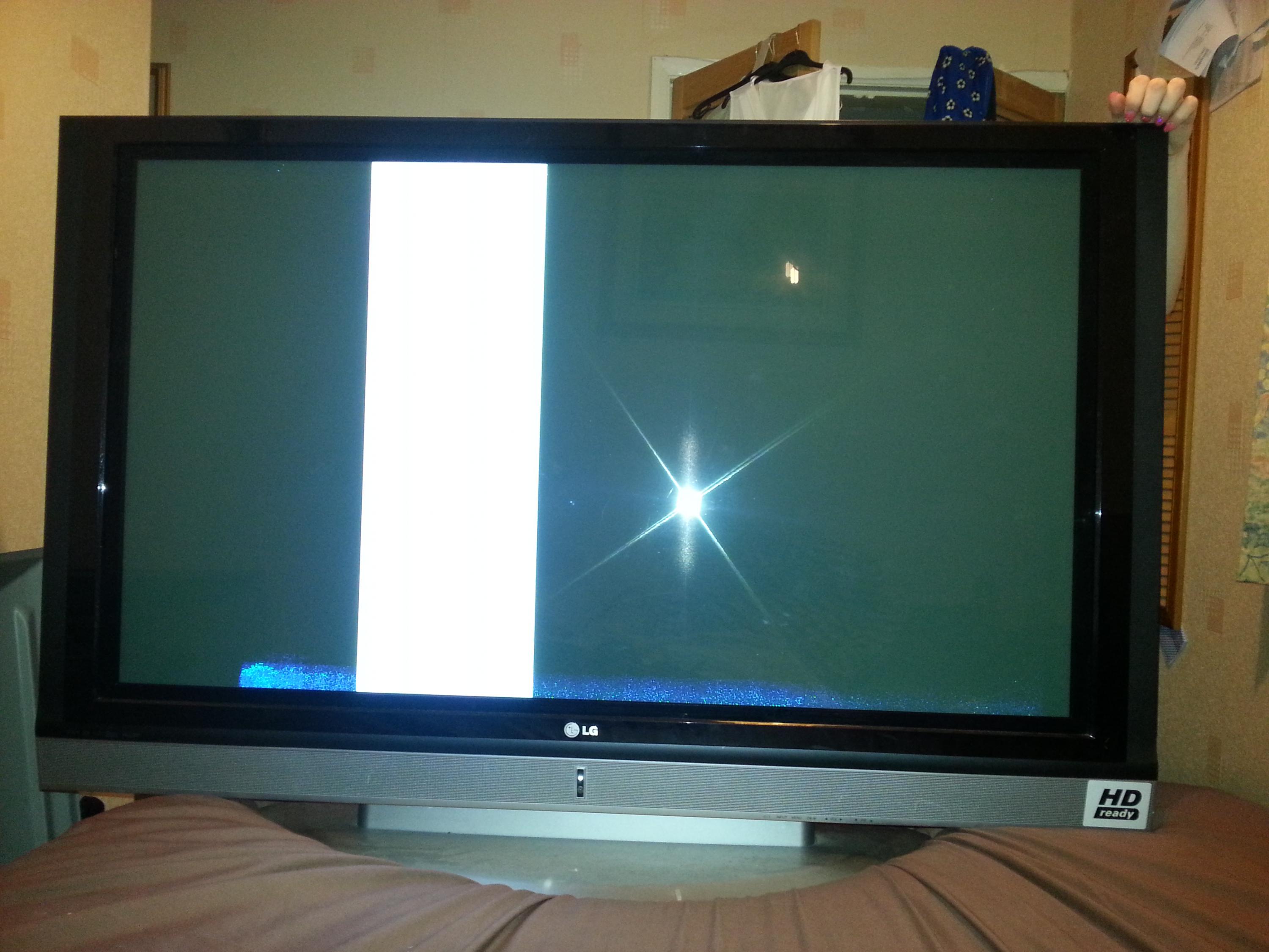

    My tv has started doing this. Any help would be greatly received. The white block bounces around the screen
    Re: LG 50PC1DA problem
    See here:-
    http://blog.coppelltvrepair.com/2010...-lines-in.html

        You could also repair your board. You need to test each buffer as detailed in that link to see which is bad. eBay boards are a crap shoot. A great deal do not work at all.

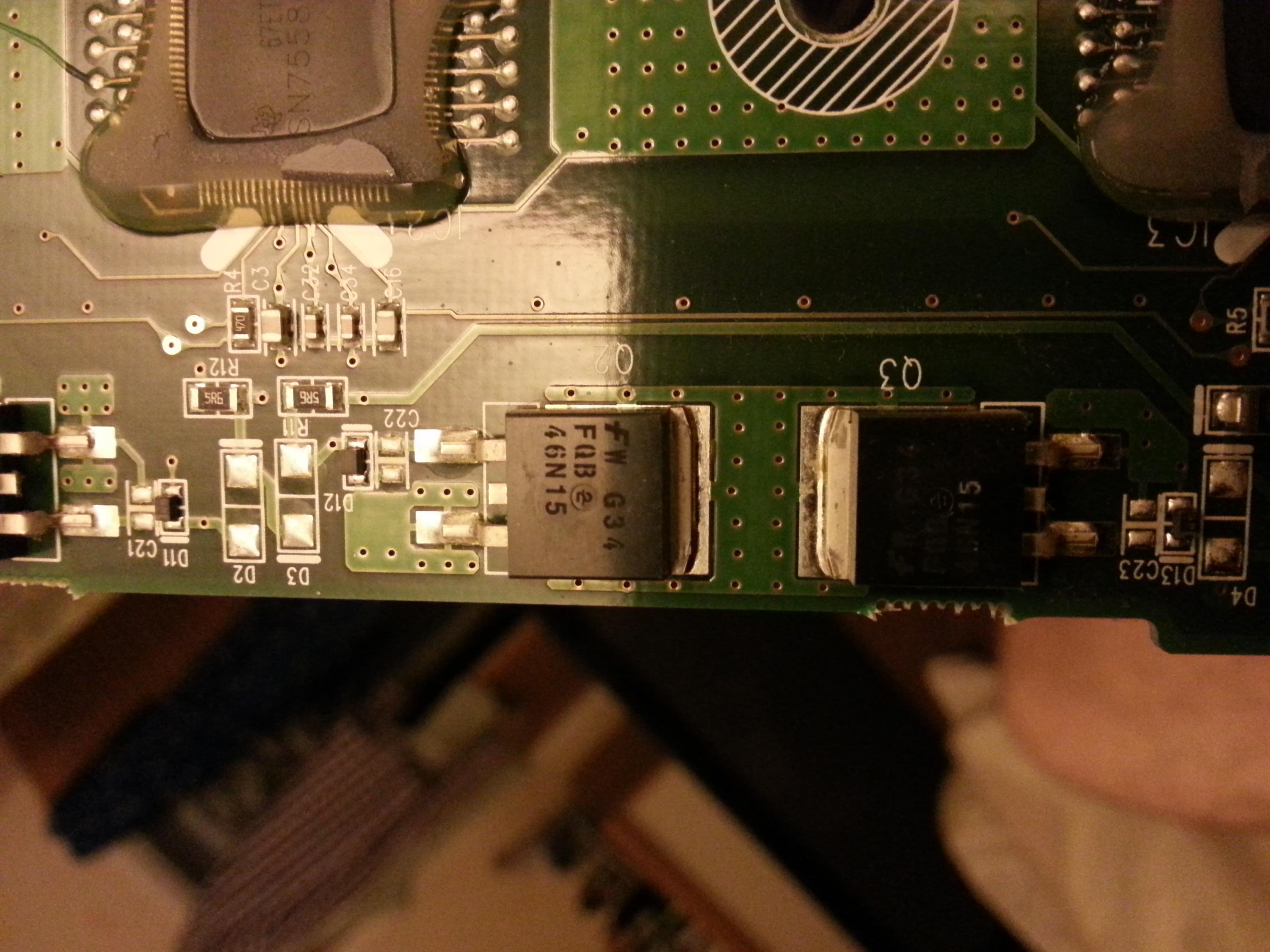

                Just for my knowledge what are FETs and is it these that you replace ?
                  They are the three-leaded (if including the metal tab) devices at the top right of the board.

                      Hi where can I buy these in u.k ? Is there a repair kit.see pic ?
                        £10 from China for 10.

                              Ok so i waited for the chinese new year to pass and ordered a load of FETs for the telly . They arrived and i had 6 new ones fitted to the buffer boards. On plugging back in bingo everything spot on .see pic 1
                              After two days i switched on and was watching telly for approx 2 hrs then the picture started flickering black and white , you could see a distorted pic through the black . if you press the menu button this was also messed up you could just make it out. I switched it off left it ten mins then switched back on and everythng ok. approx ten mins later it started again. sound is always spot on .

                                video file is corrupt, but flickering dark mono/distorted colour picture suggests Z-SUS IPM failure.

                                    The video-file you linked to--doesnt work!!
                                    --Replace the Z-SUS board.

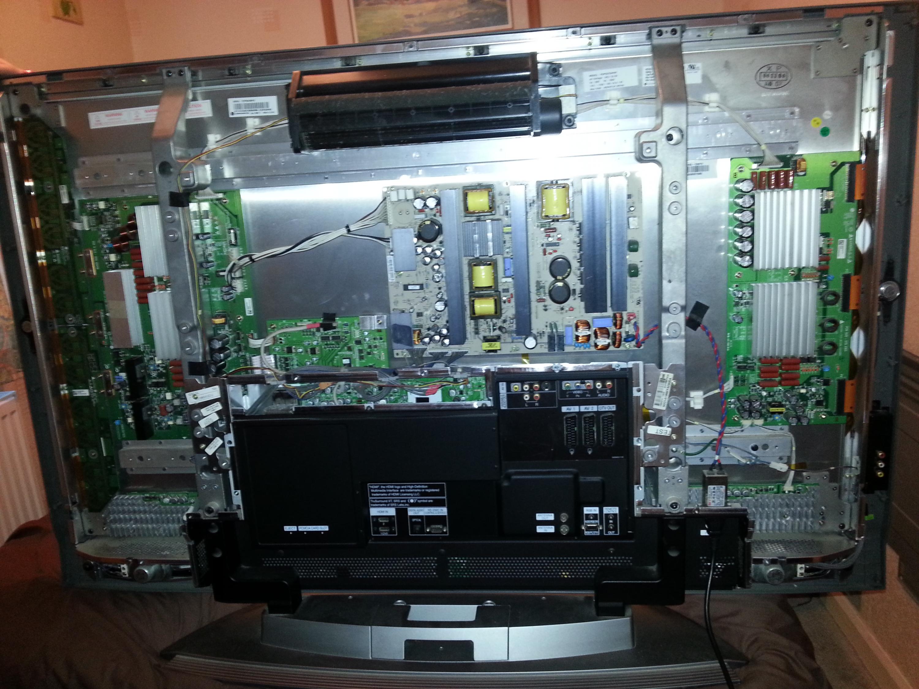

                                        Hold on -- could still be a Y-sustain fault. You'd want to check the -Vy, Vsc and Vzbias voltages to be sure... post a picture of the sustain boards if you need help with this.
