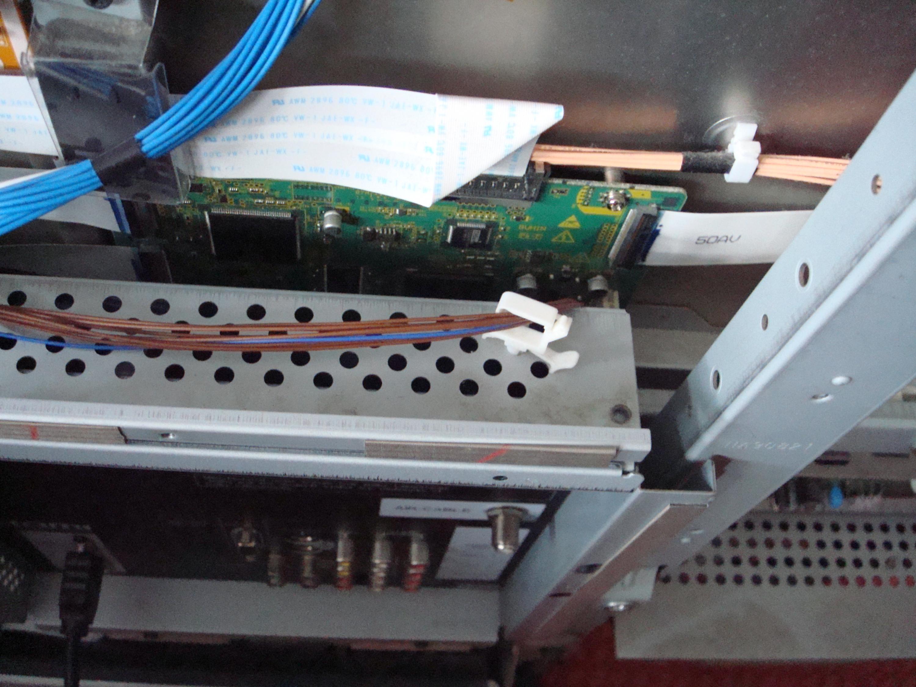

      Re: Hitachi P50H401A fixed but flashes of black
      Vs=87.7, Va=65.2v matching sticker on panel.
        Do Vs or Va drop out when panel blanks?
        Does panel glow go away when it blanks?
        • Videojoe
          • Sep 2013
          • 47
          • Us
          I just measured Va and Vs and waited for the screen to blank again and yes, both voltages drop out completely to 0 for a second or two until the video comes back on. I do believe the glow disappears also. I guess with no voltages present, the glow would disappear. What does this tell us Tom?
            Check VSAGO and VCEGO on power board. Do these drop out too? If not, then the power board or sustains are causing the drop out.

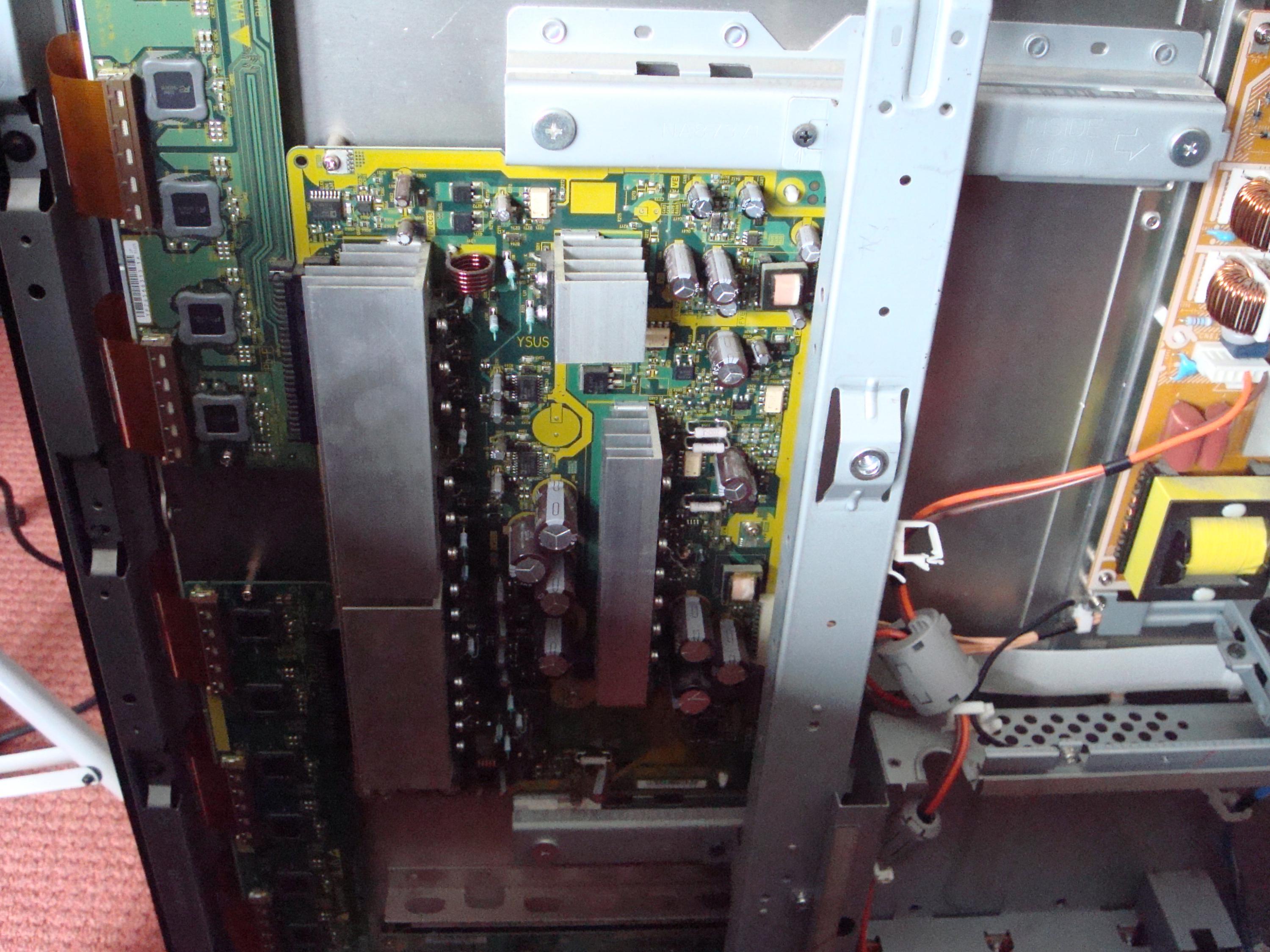

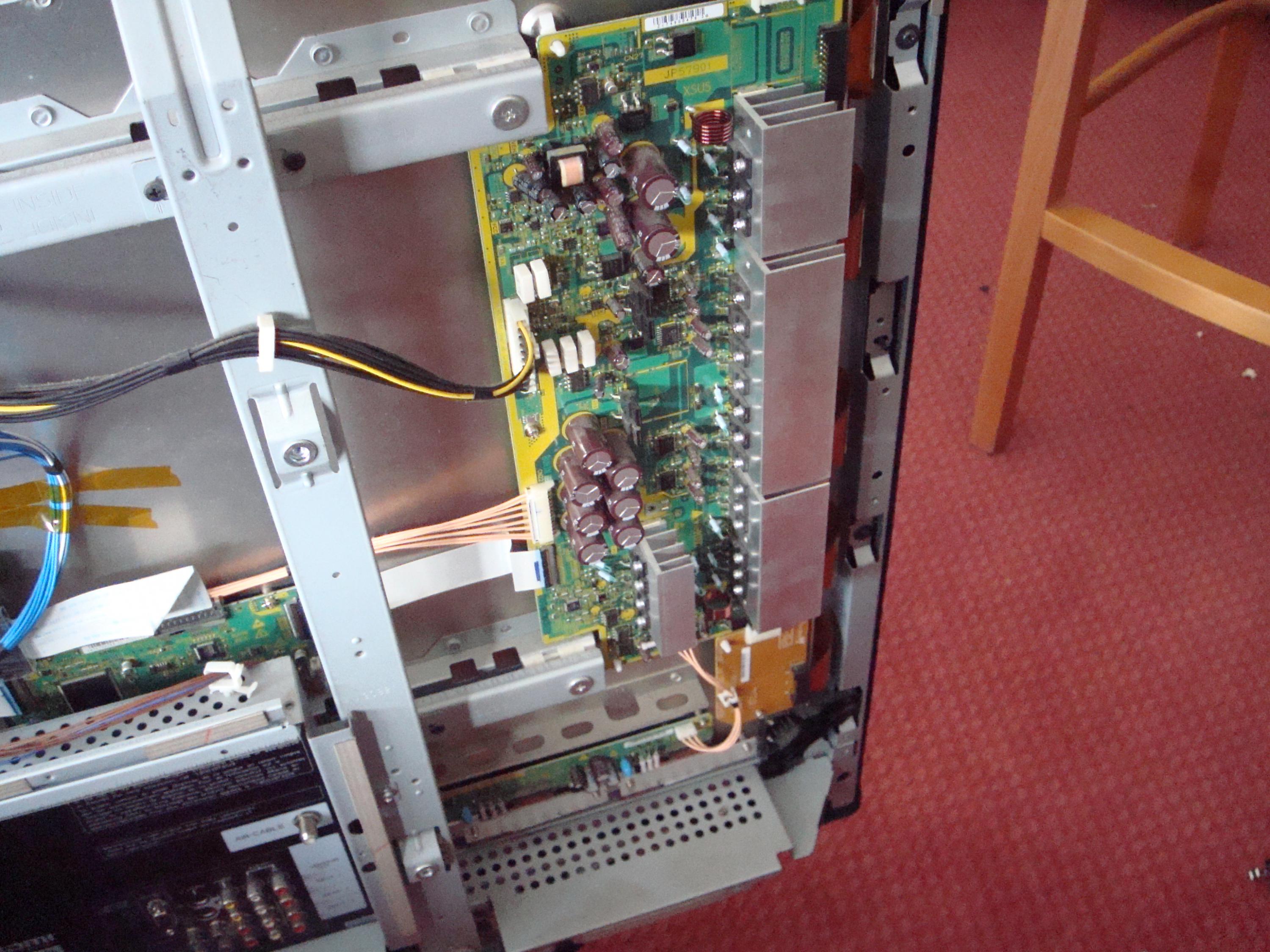

              Well now as I was measuring those voltages at the connector on the power supply, I noticed there were two screws missing that not only hold the board to the chassis, but supply ground to that section. I assumed all the grounds were tied together. So I put in the screws and now the tv stays on with no dropouts at all. I've been watching it for a few days now and everything is good. I'm gonna put this one in the win column, thanks for leading me to the problem.
                        did u find solution ?? I've noticed that all the screws in the YSUS must be in and tight or this happens. Have a P50H401 that did this.
                        • Videojoe
                          • Sep 2013
                          • 47
                          • Us
                          Yes the center screw was missing from the X sus board and another one was loose. But youre right, the y sus board will cause the same thing if its not tightened.

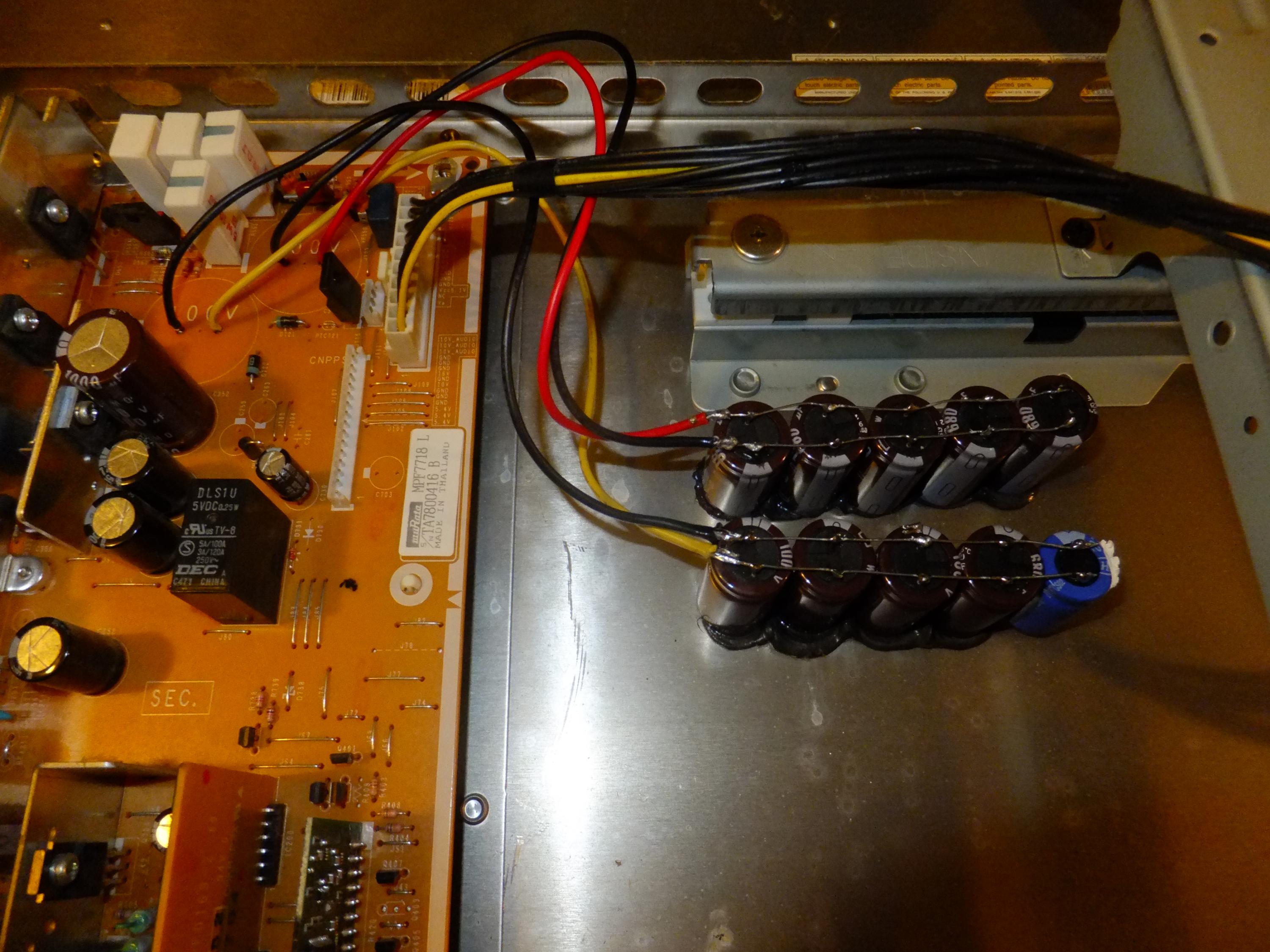

                            I just got done working on a Hitachi P50H401A. The 2 3300 Caps were swollen but I did not have any replacements so I tried to make one by sticking a bunch together to make the two 3300's but that did not seem to work. So I just ordered two new caps and I have to see what happens when it comes in.
                            Right now the TV turns on but shuts off in about 3 seconds. I removed both buffer boards one at a time and it didn't make a difference. I am assuming my Power Board is still having an issue. I thought putting the caps together would work but I guess I am wrong. If the two new caps work then that will prove I was wrong.
                            I took a picture of what I did, looked good to me.

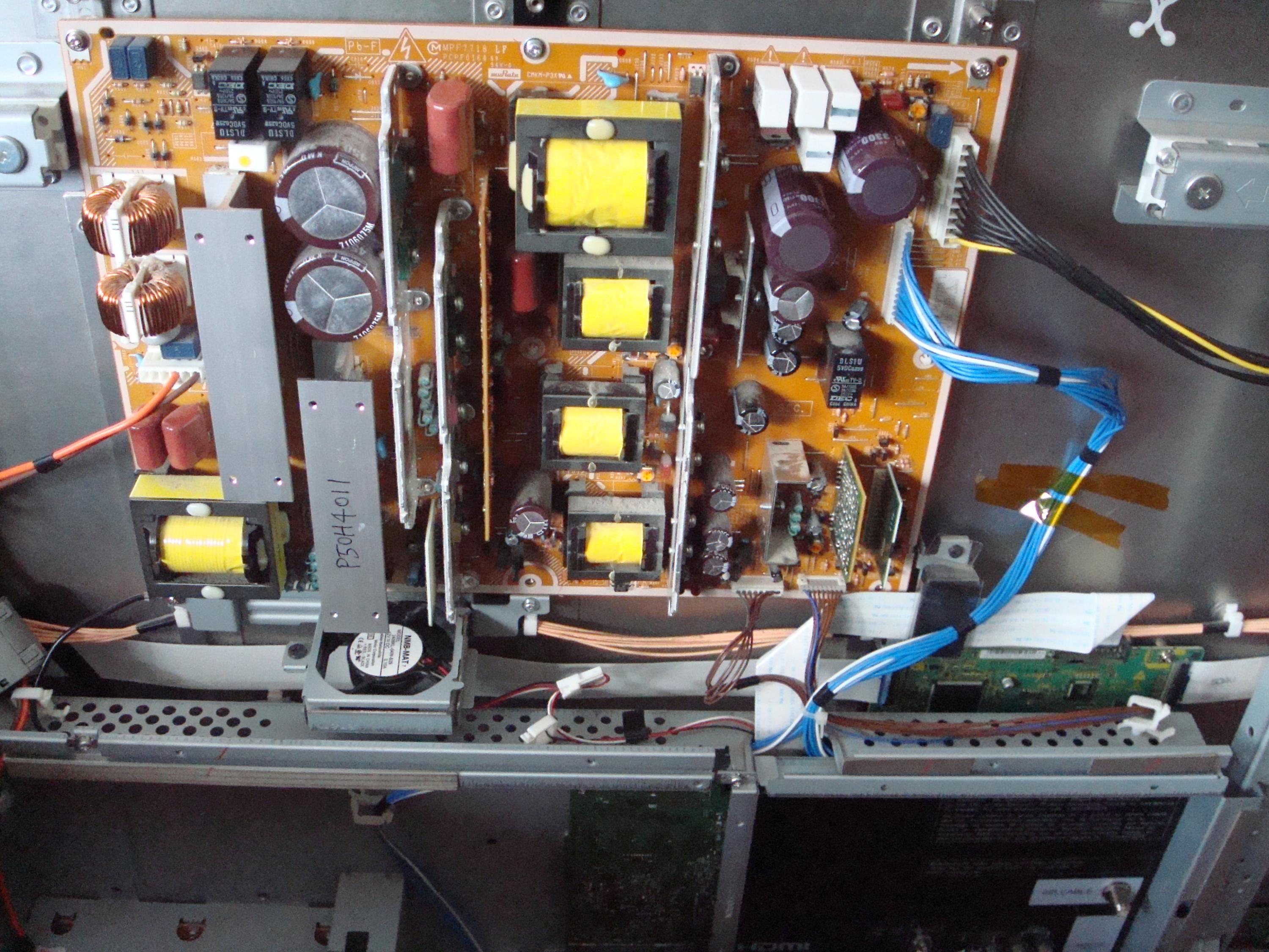

                              Correction. I was just messing with the TV and there is a fan that cools the power board. It was not spinning. I took it off, cleaned it and tested it. Put it back on and now the TV is working. I guess my Cap Pack worked after all. Now I have to buff the screen because it has that coating pealing off. I found buffing it with some liquid buffing compound does a great job.
