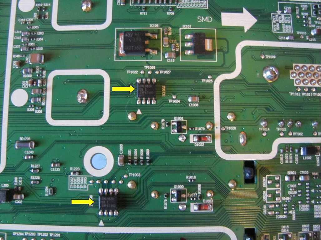

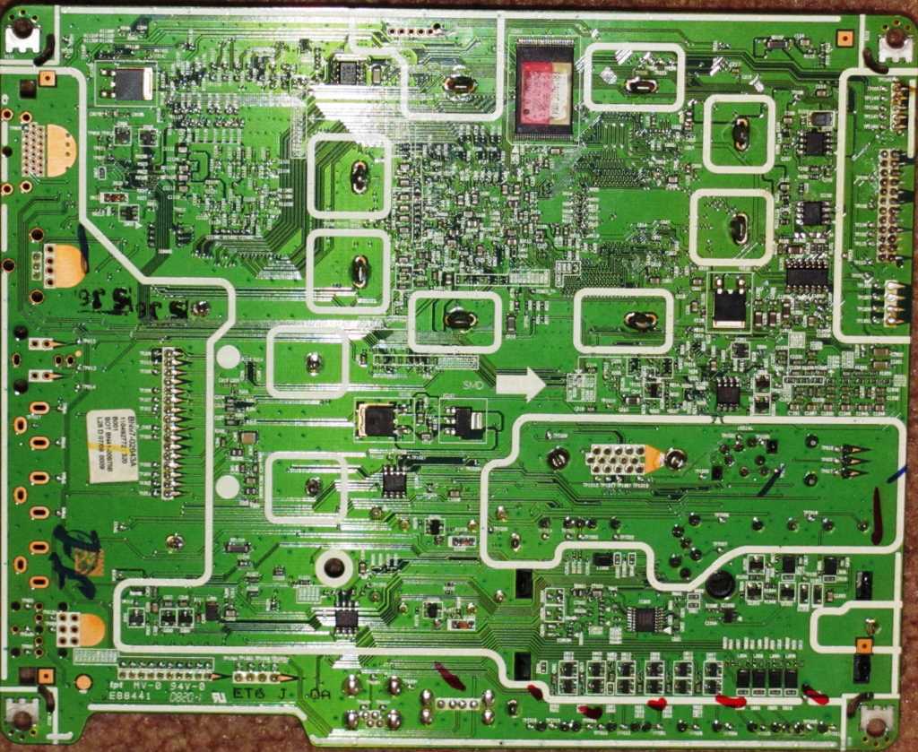

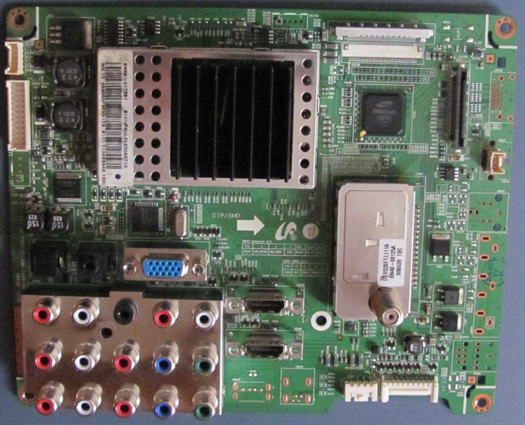

    I have a model LN46A550P3F with the won't power on/clicking problem. The power supply/backlight inverter board has been replaced and was no help. I think I have identified the eeproms as IC1000 AND IC1003 (ATMLH820 02B1) which are marked in the attached images. The main board is a BN97-02643A and also shows BOT BN41-00975B. I would like to try the eeprom reset but am not sure which is the correct eeprom and also to make sure these are the correct eeproms. I would very much appreciate any help.

    The eeprom should have 24x256 or 24xx512 or such written on it. I can't zoom in on your pics so no way to tell from here.
    Anyway for the eeprom reset to work your set needs to be able to boot or at least have uninterrupted power to the chip. If you're power is cyclying it's likely this won't work for you. You can attempt to manually reset it by attatchinig wires to it.

        Thanks for the responses. I have attached a list containing everything that is printed on the 8 pin chips that are mounted on the main board. I don't see any that seems to indicate which is the eeprom.

          i dont think the EEPROM would cause this type of fault,its normally for menu's,last time settings etc

          eeprom 24cx32 normally have pins 5 and 6 that can be shorted together before power up,then it will re-install from the mcu onto the eeprom,but these things are so damned sensitive to heat,i like to get them in place,and just before soldering,give it a blast with freeze spray to limit the risk of damage to the eeprom which is more likley an spi flash,you would need the part number

            I dont recognize any of those part numbers you would have to google the data sheets to see which are storage devices.

              If the unit tries to turn on but begins to cycle on and off before any video is displayed and all of the SMPS voltages are good, disconnect the LVDS cable at the T-Con board. If the set starts and the backlights come on, replace the T-Con board. If the set does not start, disconnect the LVDS cable at the main board. If the set starts, replace the LVDS cable. If the set still does not startup, replace the main board

                Some clarification and an update on the problem with the tv. When the tv is connected to power the relay immediately energizes and the power light illuminates. The relay cycles every 25 seconds as long as power is applied. Pressing the remote power button causes the tv power light to flicker but has no other effect. Power supply voltages are correct and stable.

                  Replaced main board which solved the problem.
