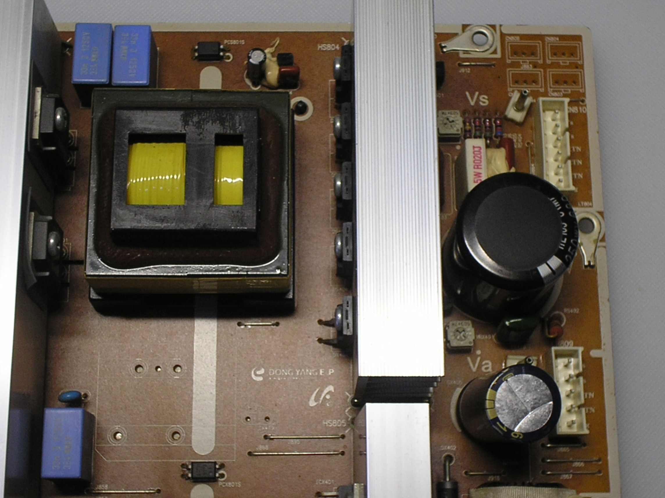

Dyp-42w2plus bn44-00194a
  • capricorn64
    replied
    Re: Dyp-42w2plus bn44-00194a
    Neelix
    I have checked voltage at pin 15(VCC) and all I am getting is -0.06V , getting nothing at 12V_OUT or at 18V_AMP !!
    Flocko
    Still getting the relays switching on and then going off straight away when I ground PS - on !!
    Pretty flummoxed now ?
    Leave a comment:
  • flocko
    replied
    Re: Dyp-42w2plus bn44-00194a
    Are you now saying that the relay clicks on and stays on when you ground PS -on (pin 4)? before you were saying it come in then went off.
    Leave a comment:
  • Neelix
    replied
    Re: Dyp-42w2plus bn44-00194a
    You get any 12V_OUT or 18V_Amp voltage? If not, you get any voltage at pin 15(VCC) of ICX801?
    Last edited by Neelix; 10-01-2014, 01:29 PM.
    Leave a comment:
  • capricorn64
    replied
    Re: Dyp-42w2plus bn44-00194a
    Hi guys
    The saga continues......I have changed out the relays for brand new ones, I now have a strong 5v at standby which is encouraging....or is it ,at the d5.3v its reading .756v so I guess I have a problem with the fets, trouble is I seem to be doing a lot of guessing.......
    Leave a comment:
  • flocko
    replied
    Re: Dyp-42w2plus bn44-00194a
    I would look at all the soldering on the back of the board for cold joints as these board do have lot of problems with these , I do hope you have also checked the fuses? if you don't find and cold /dry joints then we need to start testing for shorted FETs Flocko
    Leave a comment:
  • capricorn64
    replied
    Re: Dyp-42w2plus bn44-00194a
    Thank you budm I will give this a try.
    Leave a comment:
    replied
    Re: Dyp-42w2plus bn44-00194a
    Ground the PS_ON and then check the VCC_P (for RL802S) and VCC_S (for RL801S) DC Voltages which are for driving the relay coils to see if they are steady, use the negative leg of the main filter cap for meter ground ref. points. See page 1 of the SCH.
    Leave a comment:
  • capricorn64
    replied
    Re: Dyp-42w2plus bn44-00194a
    I have done what you advised ps on to grd which activated the relay (clicked on ) but turned of straight away so I am surmising that I could possibly have a relay problem aswell as voltages at pin 8 and 9 which are D5.3V are only reading -.250v would I be correct in my assumption ??
    Leave a comment:
  • capricorn64
    replied
    Re: Dyp-42w2plus bn44-00194a
    Thanks Flocko I will give it a try I think I understand what you mean !!!
    Leave a comment:
  • flocko
    replied
    Re: Dyp-42w2plus bn44-00194a
    Hi you need to test power supply out of he set with the mains connected you should have the 5v stby on the bottom right connector on pin 1, if you have that by making Ps on pin 4 Low to grd that will bring the relay in and give all voltages apart from Vs , to bring in Vs voltage jump Vs on pin 2 to 5v stby pin 1 with 500 ohm resistor. I hope this helps , the fault I had was that the relay would not come in when Ps on was made low the problem was tracked down to a fault relay coil the relay was replaced and fault was no more Flocko
    Leave a comment:
  • capricorn64
    replied
    Re: Dyp-42w2plus bn44-00194a
    Hoping someone can help, I have pulled the power board from my Samsung tv, as I keep getting a clicking from the relays on the hot side of the board which is a DYP-42W2PLUS , 220V input supply, I have checked all the caps and all seem to fine . When I disconnect the plug from the CN801 port the clicking stops, I get 4.86V at the standby but nothing else 12v measurement non existent , I also get no readings from Vs205 or Va63.
    Now I am assuming that a voltage regulator has gone down ,but I have no idea where to start looking for the fault if anyone has any ideas as to where I should be looking I would be most grateful, thanks in advance guys .......Steve
    Leave a comment:
  • Ltank
    replied
    Re: Dyp-42w2plus bn44-00194a
    My Mistake I miss read it. I thought it said PS-on but what I see now is VS-on. I was on page 4 lower right corner when I made the mistake
    Last edited by Ltank; 01-24-2014, 07:25 PM. Reason: correction
    Leave a comment:
  • flocko
    replied
    Re: Dyp-42w2plus bn44-00194a
    Thanks guys for the input, Will have a look at the voltage reg ICB 803 and check transistors in and around it tomorrow
    Leave a comment:
    replied
    Re: Dyp-42w2plus bn44-00194a
    QB402 is for the UV-Reset, do you mean Q401 (is normally ON) which when PS_ON pin is grounded, the Collector will rise up and allow 5V to get to the LED in Opto PCB803S/A?
    Last edited by budm; 01-24-2014, 04:42 PM.
    Leave a comment:
  • Ltank
    replied
    Re: Dyp-42w2plus bn44-00194a
    How low of a dvc when it drops? Does it go low enough? Q402 is not turning on. If circuit was working properly Q402 has a .7vdc drop.
    LVT817B has a .7vdc drop leaving 3.6 vdc at anode of optoisolator. With 3.6vdc on anode and 4.6vdc on base of Q402 the transistor is not turning on and the led part of the optoisolator is reverse biased; therefore it too is turned off.
    Try jumpering a low to grouund through a 500 ohm reisistor to the base of Q402. It should turn on both the transistor and thhe optoisolator. It aperars that
    this set turns on with a active low not a high.
    Last edited by Ltank; 01-24-2014, 03:44 PM. Reason: more help
    Leave a comment:
    replied
    Re: Dyp-42w2plus bn44-00194a
    Since you have 5VSTBY, that means the VIPER22 is working, you need to check the circuit around QB803, QB804, ICB802.
    Leave a comment:
  • flocko
    replied
    Re: Dyp-42w2plus bn44-00194a
    Has anyone seen any of the VIPer 22A primary switcher chip go bad on these boards, have not looked up the pin out for it but will check tomorrow and see if it tests out
    Leave a comment:
  • flocko
    started a topic Dyp-42w2plus bn44-00194a
    Dyp-42w2plus bn44-00194a
    have this 50" Samsung come in with red standby light will not power on, checked power board and 5v standby is good and PS-on is 4.6v when in standby and goes low when power button on remote is pressed but relay fail to click,have pulled the board and put 680ohm resistor from PS-on to grd still no relay click started pulling and replacing caps,but getting nowhere fast any one had this with this board, it also looks to have been worked on in the past
  • tvguy12012012120
    by tvguy12012012120
    02-07-2025, 05:13 PM
  • fharris1977
    Vizio D50u-D1 Dead Set No Standby
    by fharris1977
    Hi. I got a Vizio with no power or standby, and won't turn on with remote or button. I checked the voltages on the connector and all read 0.00V or nearly 0(0.050 ON/OFF pin). None of the pins are labeled STB for standby although I do see some 5V pins. Other than the obvious standby led, which isn't coming on, is there a way to check for standby voltage on this PS. I'm trying to see if my problem is the PS or mainboard. Some Vizios I have fixed with no standby led me to think it was the PS but it turned out being the mainboard. Any experience with this set would be greatly appreciated.
    12-28-2023, 10:25 AM
  • Crystaleyes
    Samsung BN44-00259A standby question
    by Crystaleyes
    Hi all.
    I started a thread while back regarding TV power supply standby circuitry as it is something I am not quite on top of.
    SMPS theory and function is becoming more familiar, however the standby part is still a bit of a mystery.
    Anyway, a friend has this TV with the above mentioned power supply board which has no standby voltage, nor any other voltages leaving the board.
    The mains AC comes in fine, gets filtered and rectified with power is on the main filter cap as well as the transformer and drain pins of the ICE3B0665J, but that's it.
    08-11-2023, 05:15 AM
  • psssst
    Yamaha TSX 120 Standby Problem
    by psssst
    Hello forum. I've recently been given a Yamaha TSX 120 DAB radio and ipod dock. Its working well however when put on standby its using 6.3 watts. The manual states less than 1 watt on standby. I measured this with a plug in monitor which seems accurate with other items. In use it uses around 7.5 watts. Firstly has anyone who owns a similar radio also got a plug in monitor to check if this is normal with this unit? In the first half a second the monitor shows 0.3 watts which I suspect is what it should use but something is switching it to be almost fully powered. I've searched the manual for eco...
    03-01-2024, 07:25 AM
  • ChristianBr01
    LED TV Samsung The Frame 55 inch QE55LS03RAU Standby Light only
    by ChristianBr01
    I got a Samsung The Frame 55 inch TV for free from uncle cause it is not turning on anymore. I am in the second year of training as an electrician so I have knowledge already but I am far away from to be a pro.
    The TV has Standby but ist not turning on. A Friend of mine owns a 50 inch Frame TV so I checked the One Connect Box and the One Connect Cable there. Both are good and working normally. I have opened the TV case and measured some voltages on the Board.
    What I already found is that the 12.8V are not an the connector to the main board connector to the power...
    04-23-2025, 01:48 AM
