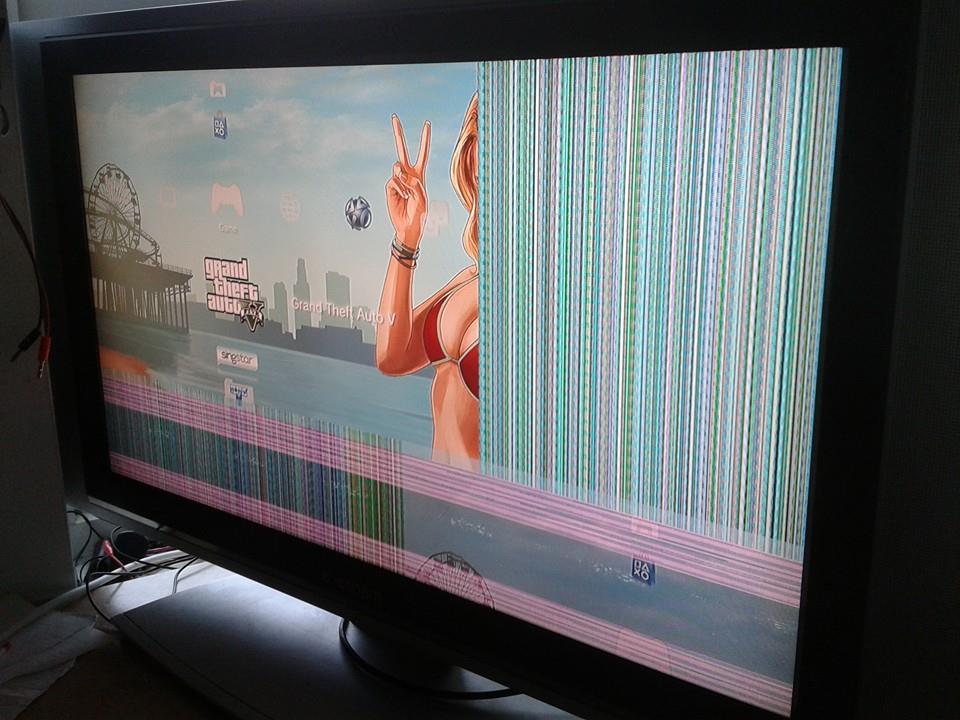

    I was given this tv e esham AV320PD as it was dead. I fixed the power supply, the problem there was blown fuse, two caps, bridge rectifier, and main filter cap. Scart input works fine but the hdmi is giving me this screen shown in pic. Any ideas on a fix.

    that's panel fail

      the scart works fine

        Make sure you're not feeding it with 1080p, some of these sets cannot handle 1080p.

          good point, I heard of this b4.

                  I've seen this before feet It 720 P. if that doesn't straighten it out you might have a HDMI IC codec failure. this is the chIp that the HDMI feed into the main board

                    I reset the ps3 to auto detect the resolution and it worked fine, thanks tom. Have you had those cd's yet?
