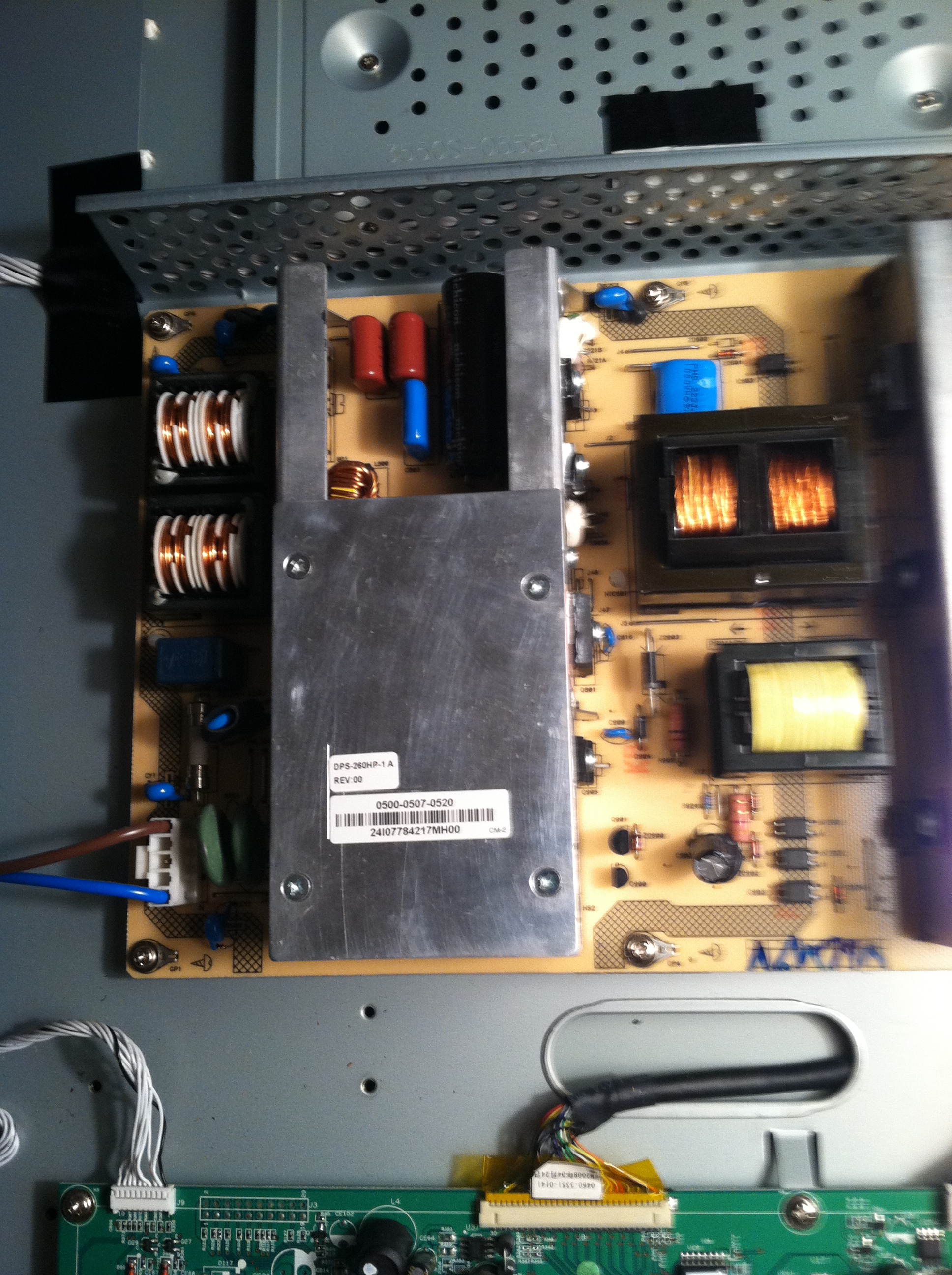

    Hi guys; a success repair on Vizio VW42L that someone dumped it on the side of the street it started to acting crazy,see video.
    http://www.youtube.com/...amp;feature=youtu.be
    i disconnected the ty control key pad on the board and re-soldered all pins and it fixed that, but it was hard to control the tv and i did not have the remote control,
    also the screen started to flick special if i did lower down the black light adjustment kinda showing random White Black blue red screens to stop it had to shut down
    sometimes it would work ok.

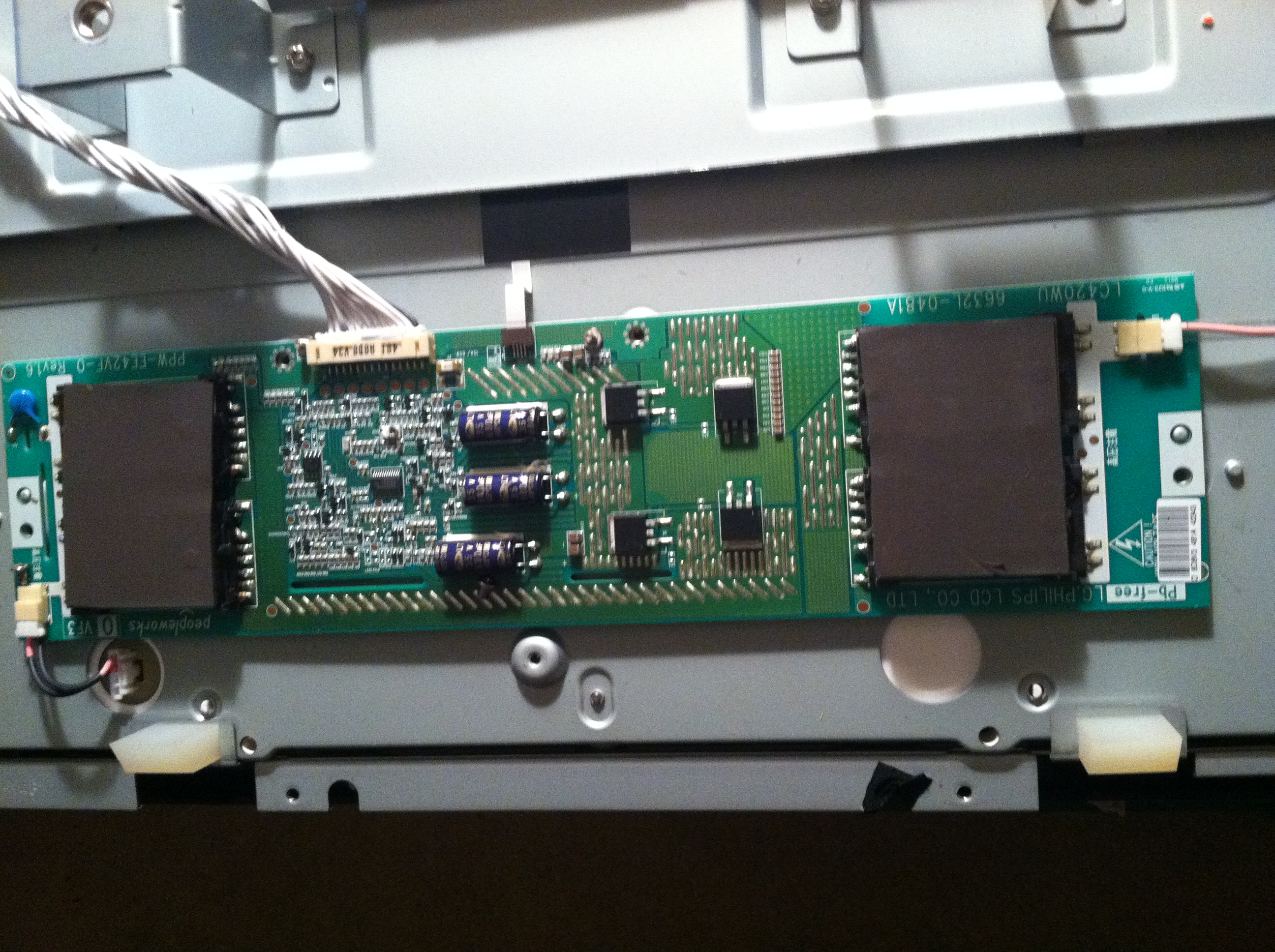

    then i first started to check the power sup caps all checked ok and checked the Inverter board caps they seem a little bit bulge but they checked good ESR but since i had to order a new remote control so i ordered also 4 - 470uf 35v 105degrees caps,i took out the inverter boards and put in the new caps fairly easy job,closed tv and so far so good tv looks good after 2 hours of working,
    note that when i checked the old caps in circuit with my cap-analyzer 88A the ESR was normal,when i tested them out of the circuit they were dead and also tested dead with my Fluke DM, i don't know if it was the heat applied to desoldered them
    for now another tv kept ou of the land field,keep my finger crossed.

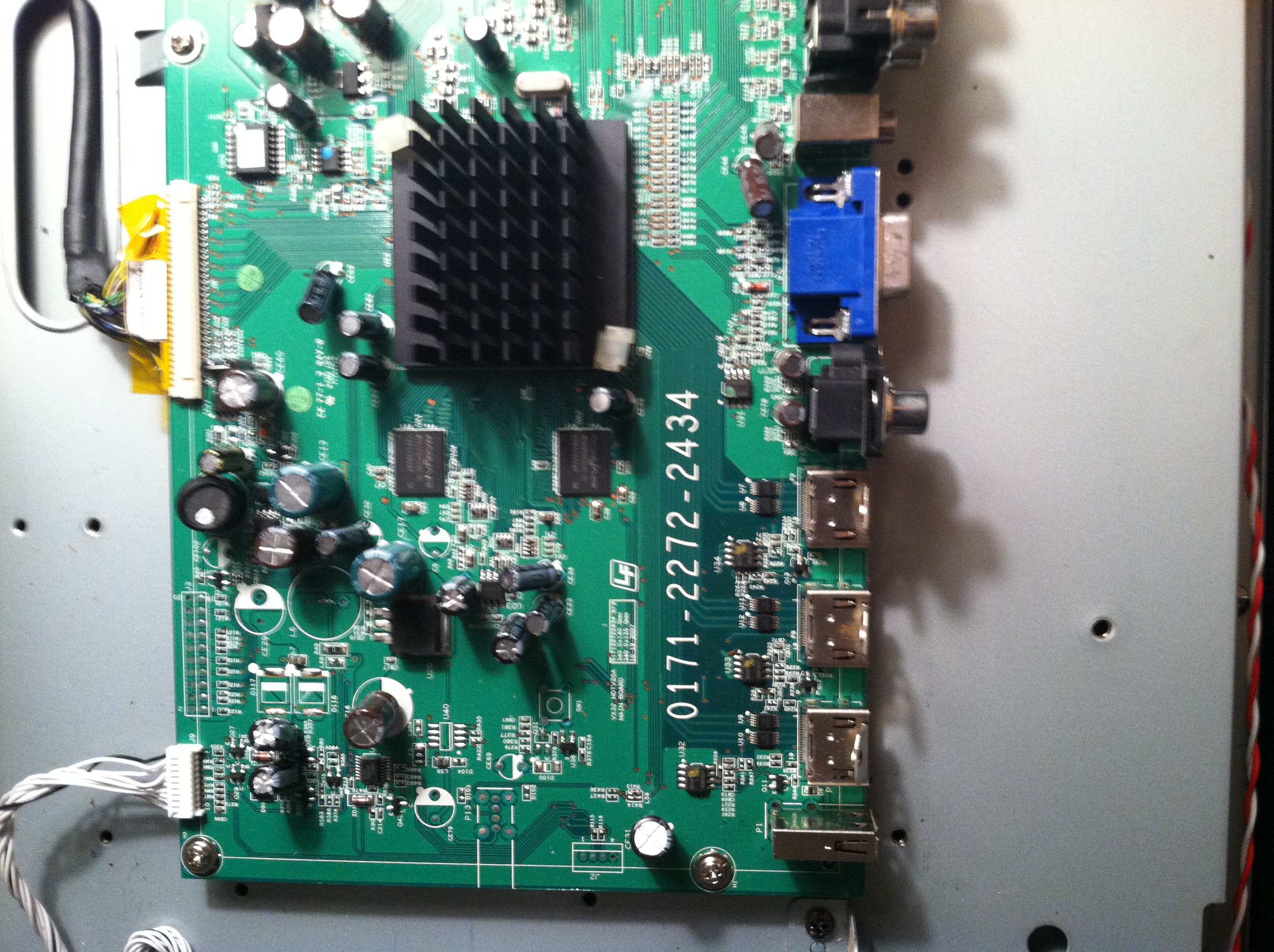

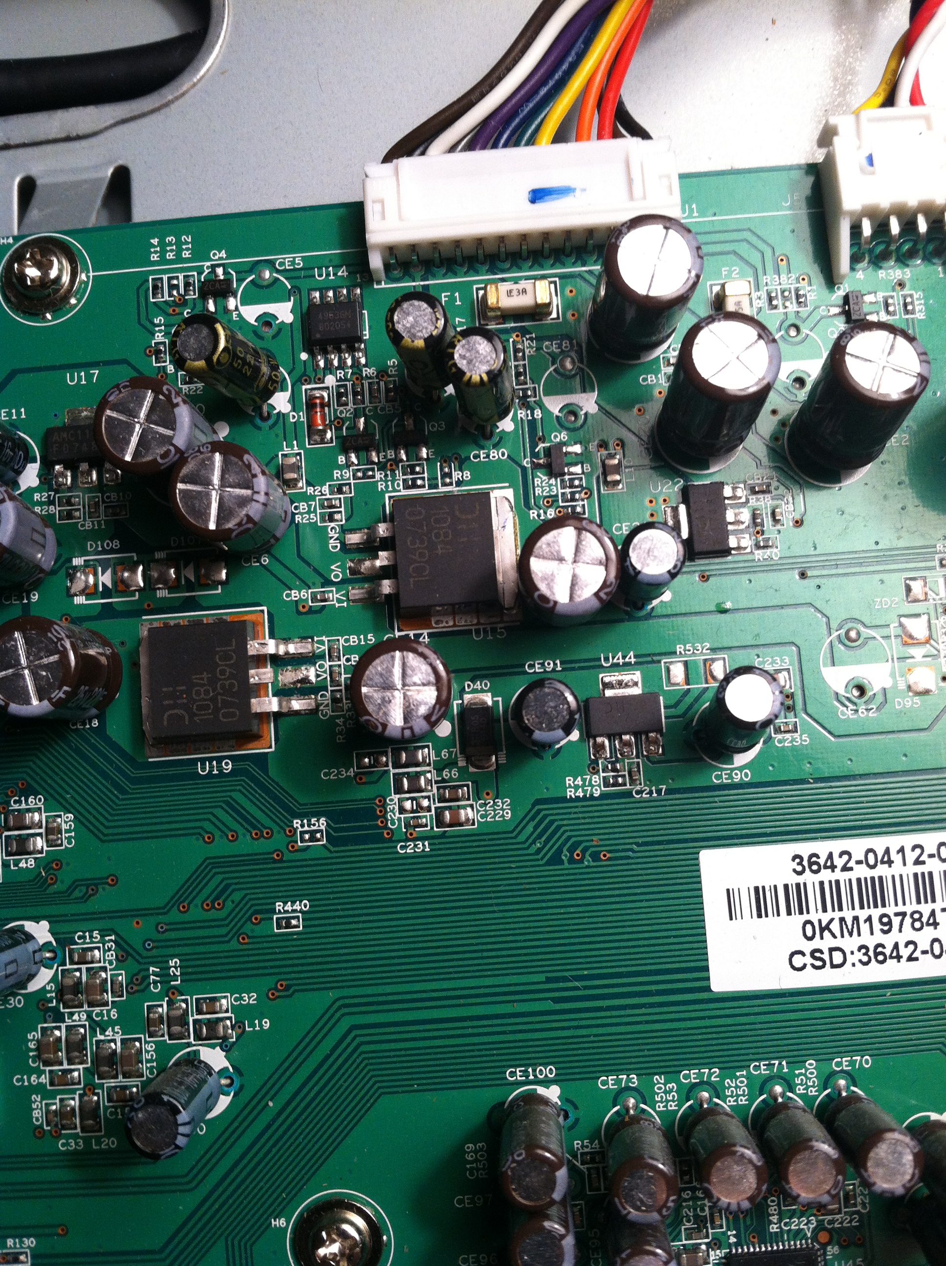

    Now to my question. I have a Vizio Model vw42l unit that I am trying to fix for my son.
    When I try to power it up with the power on button, nothing happens. No logo light or back
    light. On checking the voltages on the main board, I have no 12v supply. I have checked the
    fuses and they are both good. Fuse F1 has 5.17v on both sides, but F2 has 0 volts on both
    sides. I do not have a schematic so I dont know where to go from here. Regulator U44 has
    no voltage on any pins. Does anyone know where I should start looking? (Sorry about the
    photos, I tried three cameras)
    Board # 0171-2272-2434
    Outputs going to main board:
    PSON = 0.00
    12V = 0.00
    SGND = .00v
    5V = 5.17v
    A = 0.00
    B = 0.00
    Inverter Board:
    Fuse tested good
    Main Board:
    Both fuses tested good.
    One fuse has 5.17 on both sides of fuse
    The other fuse has 2 v on both sides
    Voltage Regulators:
    U19 Gnd 0.00
    Vo 2.51
    VI 5.06
    1084 Chip
    U15 Gnd 2.10
    VO 3.36
    VI 5.01
    1084 Chip
    U17 Pin 1 2.08
    2 3.33
    3 5.08
    AMC 1117 Chip
    U21 Pin 1 0.00
    2 1.25
    3 2.50
    AMC 1117
    U22 Pin 1 2.10
    2 3.31
    3 5.10
    AMC 1117
    U44 Pin 1 0.00
    2 0.00
    3 0.00
    117jh 1117L Chip

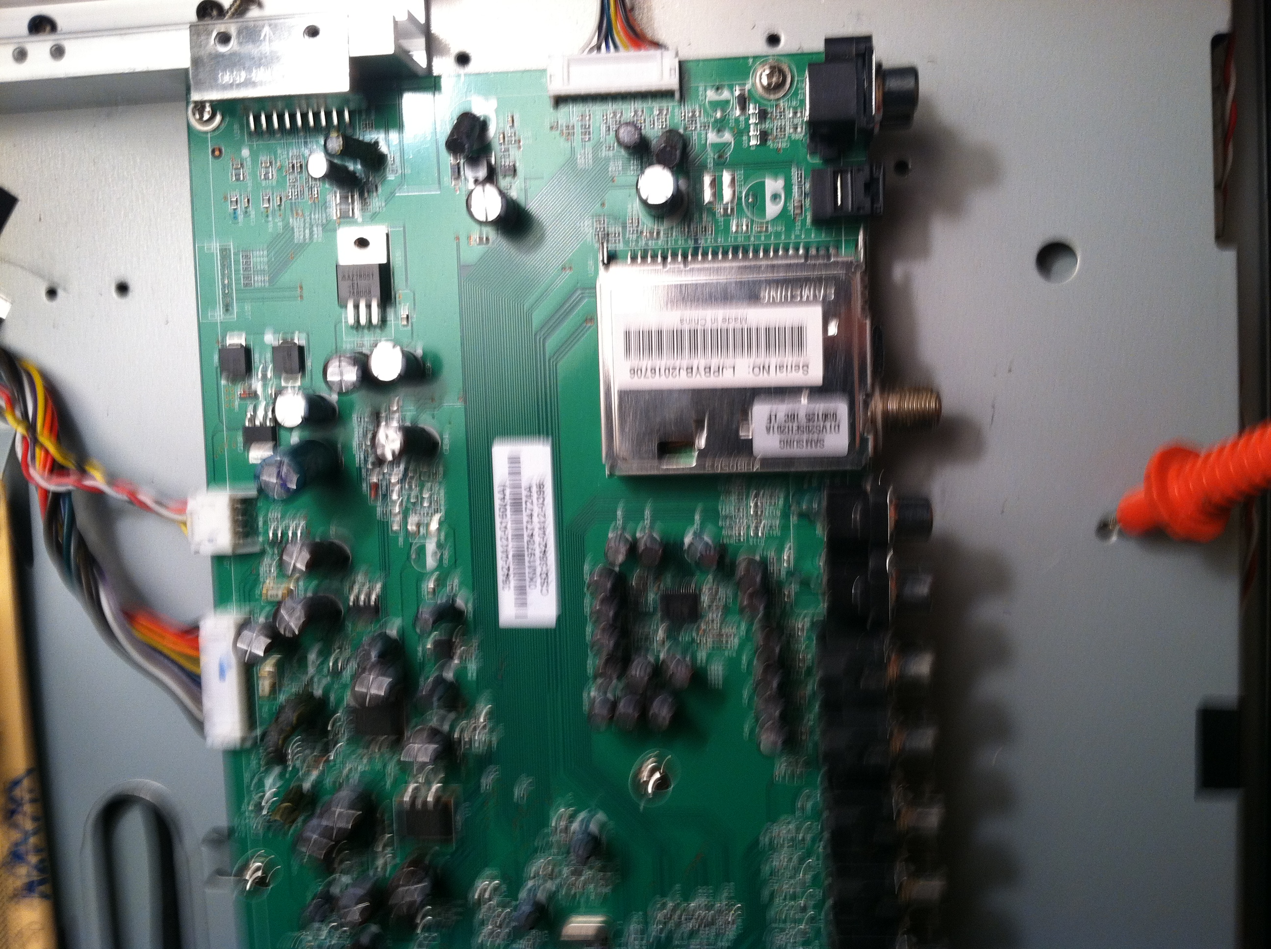

      Re: Another Vizio VW42L Tv out of the land field for now.
      Did you check for any dcV on the button board?
      • Bigjohnga
        • Jan 2016
        • 4
        • usa
        Thank you for your response. I have 3.34 v on the button board.
