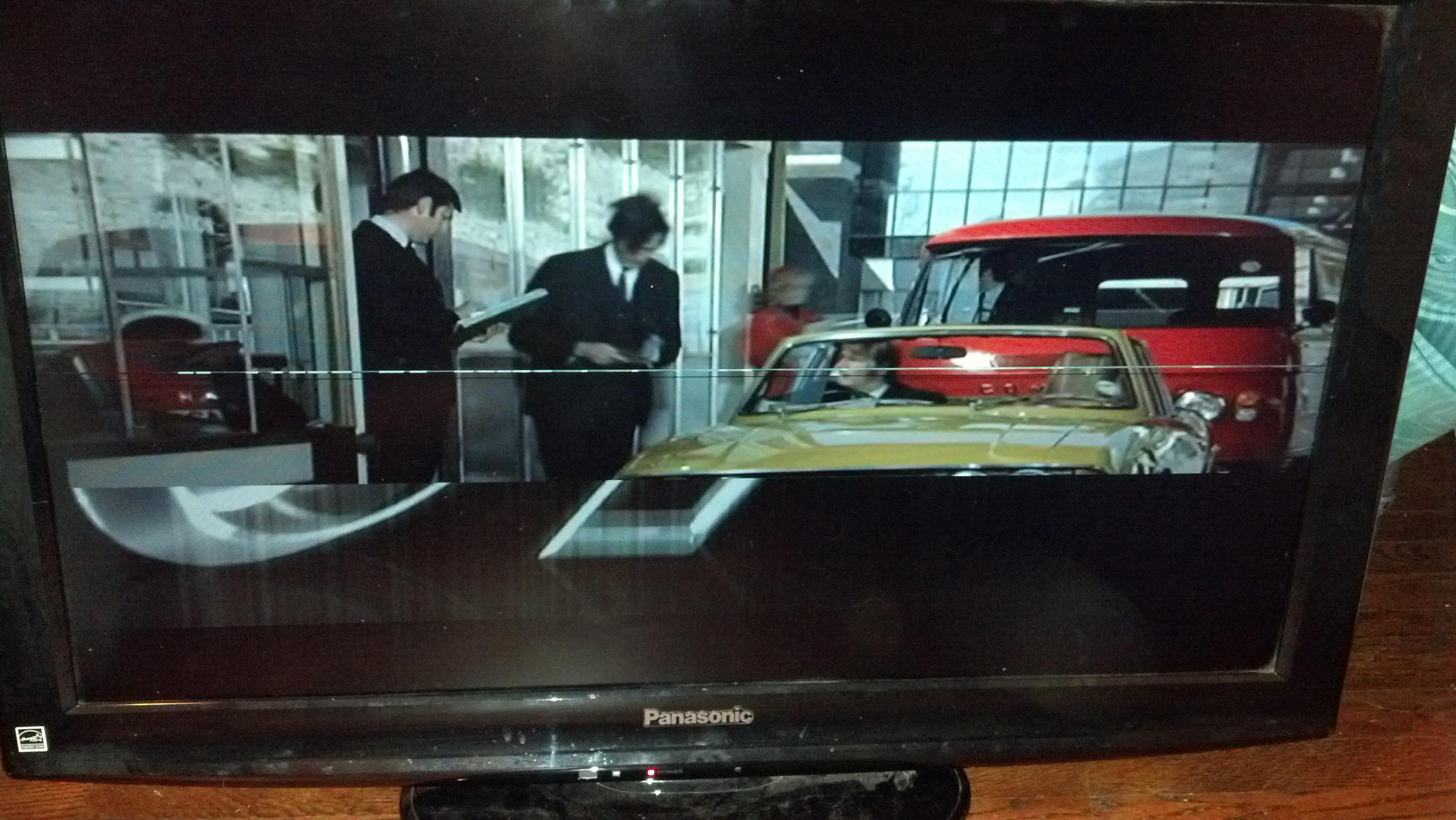

    Description: "It turns on and functions, except the bottom half of the screen will either be black or freeze."
    Is this worth attempting? Looking for a backup in the likely event that I can't fix this Sanyo.
    Thank you.

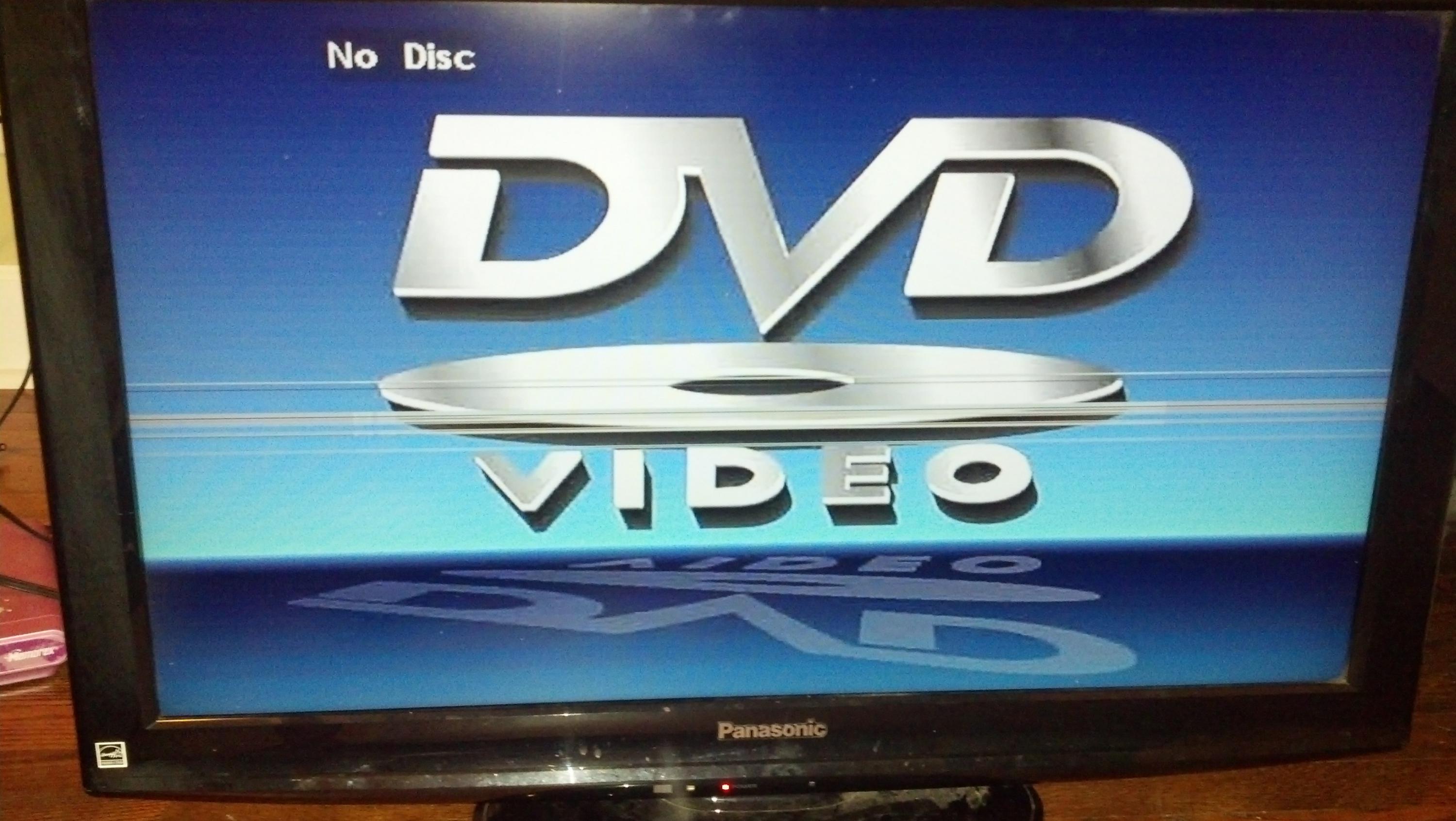

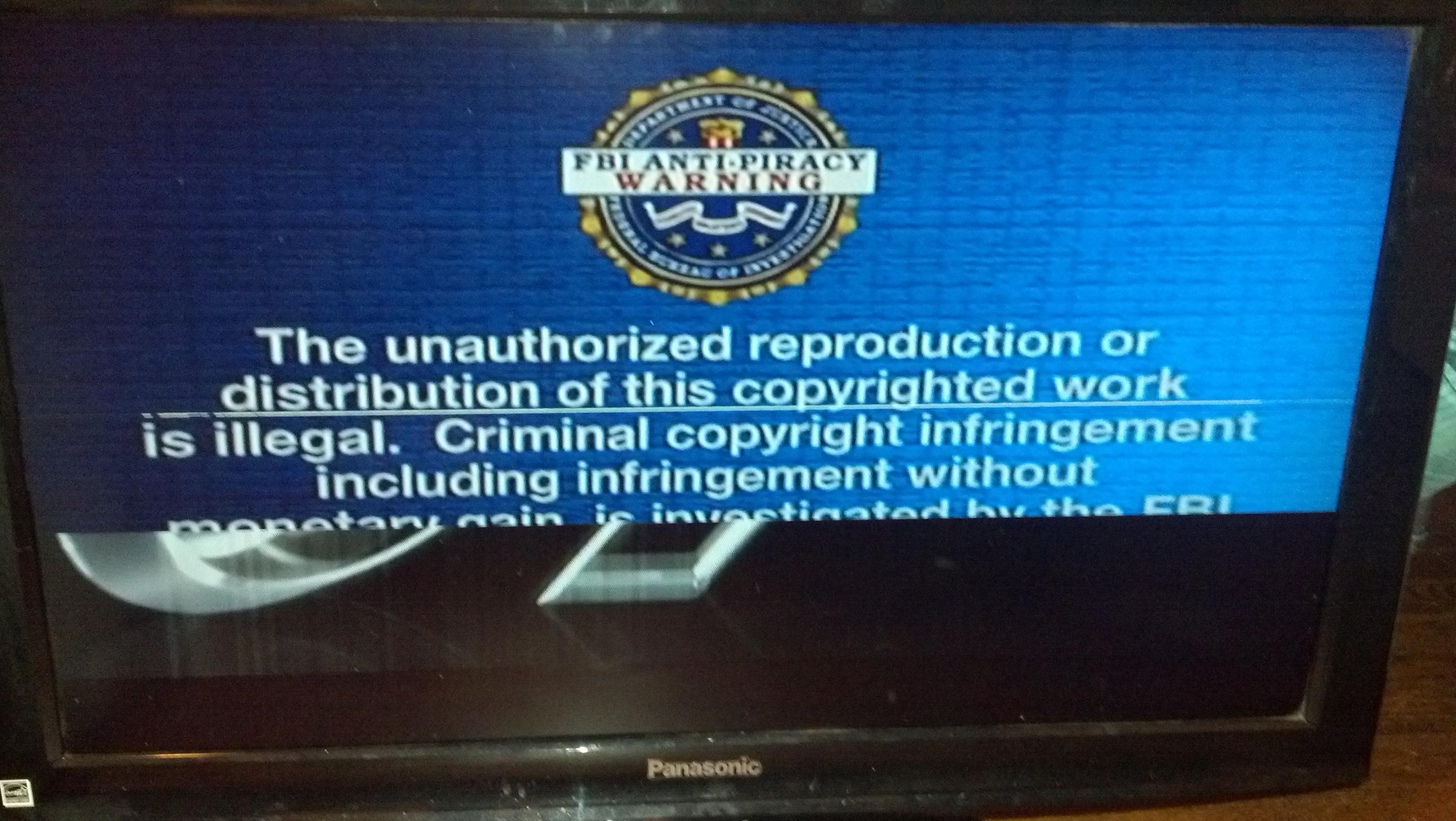

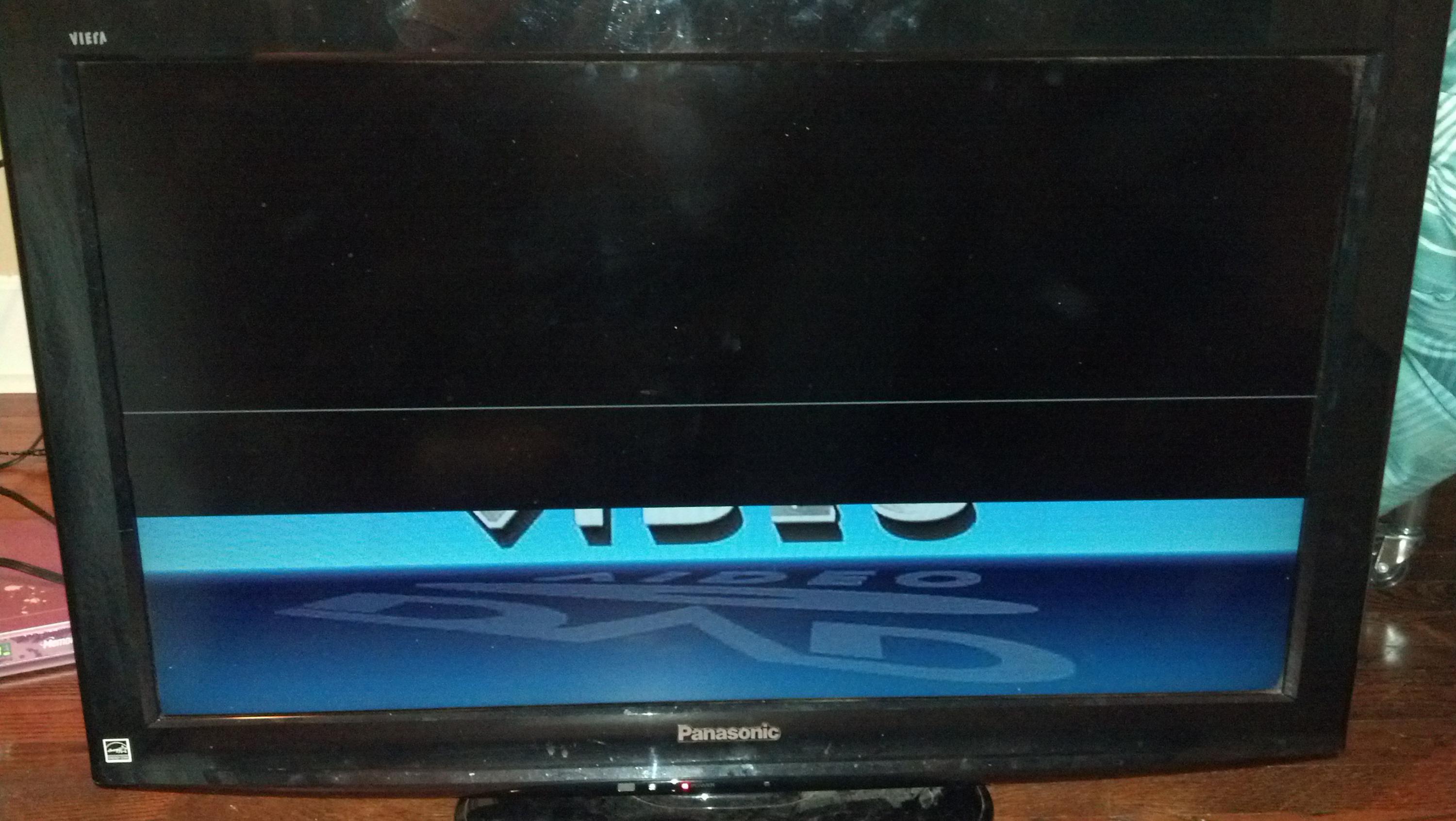

          Here are some pictures of what it's doing, if you can tell anything else from them. Thank you!
            Re: Panasonic TC-L32C22 - Bottom Half Screen Black or Freeze
            That's definitely panel right there.

              I notice in the pictures that the 'damage' changes and moves around - is that typically a symptom of bad tab bonds?
              Hell, if I could get it to stay like it is in the first picture, I'd be satisfied with it.
              Thank you!
                That was a plasma. They rarely have panel problems, even if the power electronics tend to be less reliable, overall, they are more reliable generally.
                You can try fiddling with the tab bonds.
