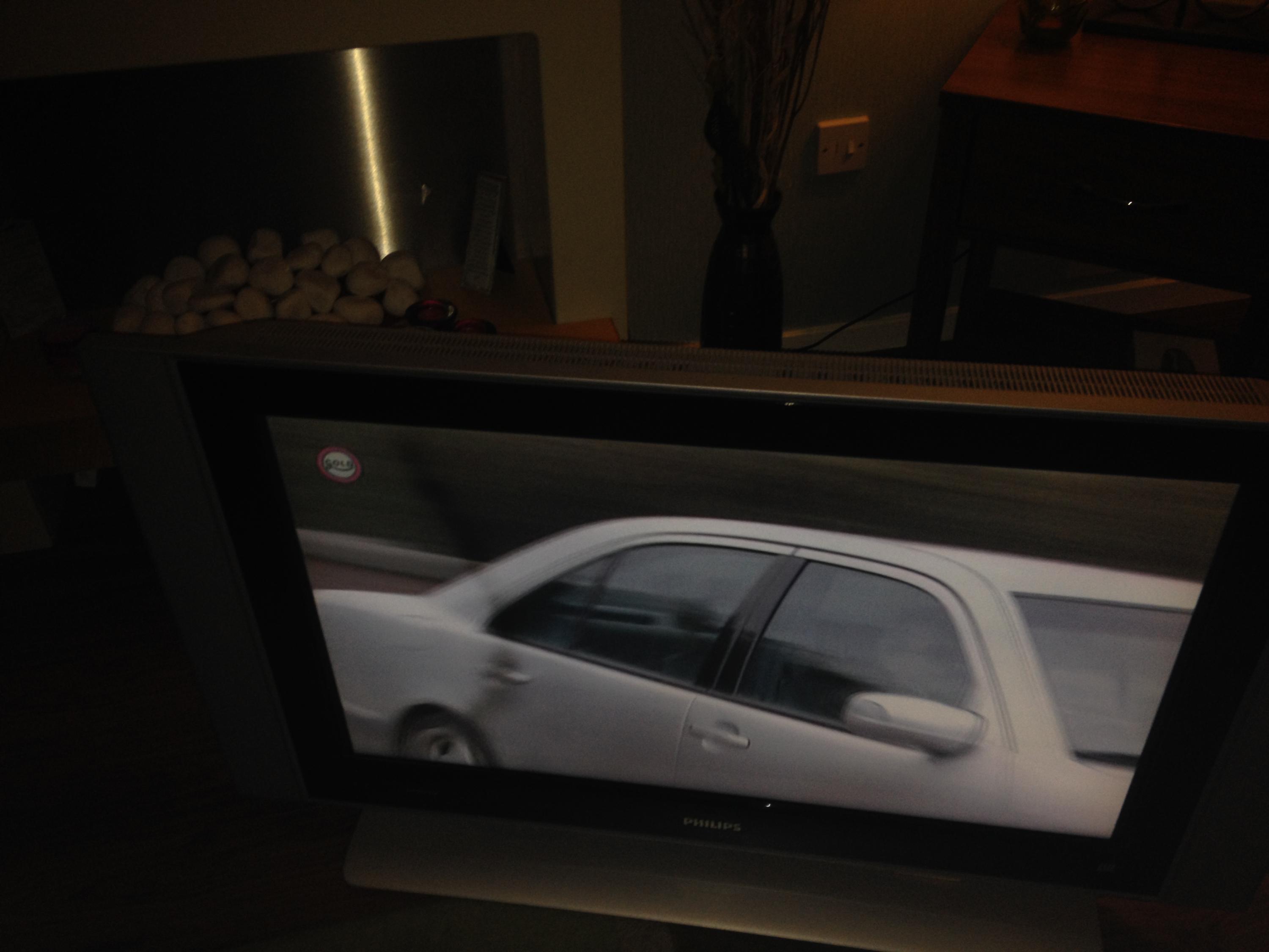

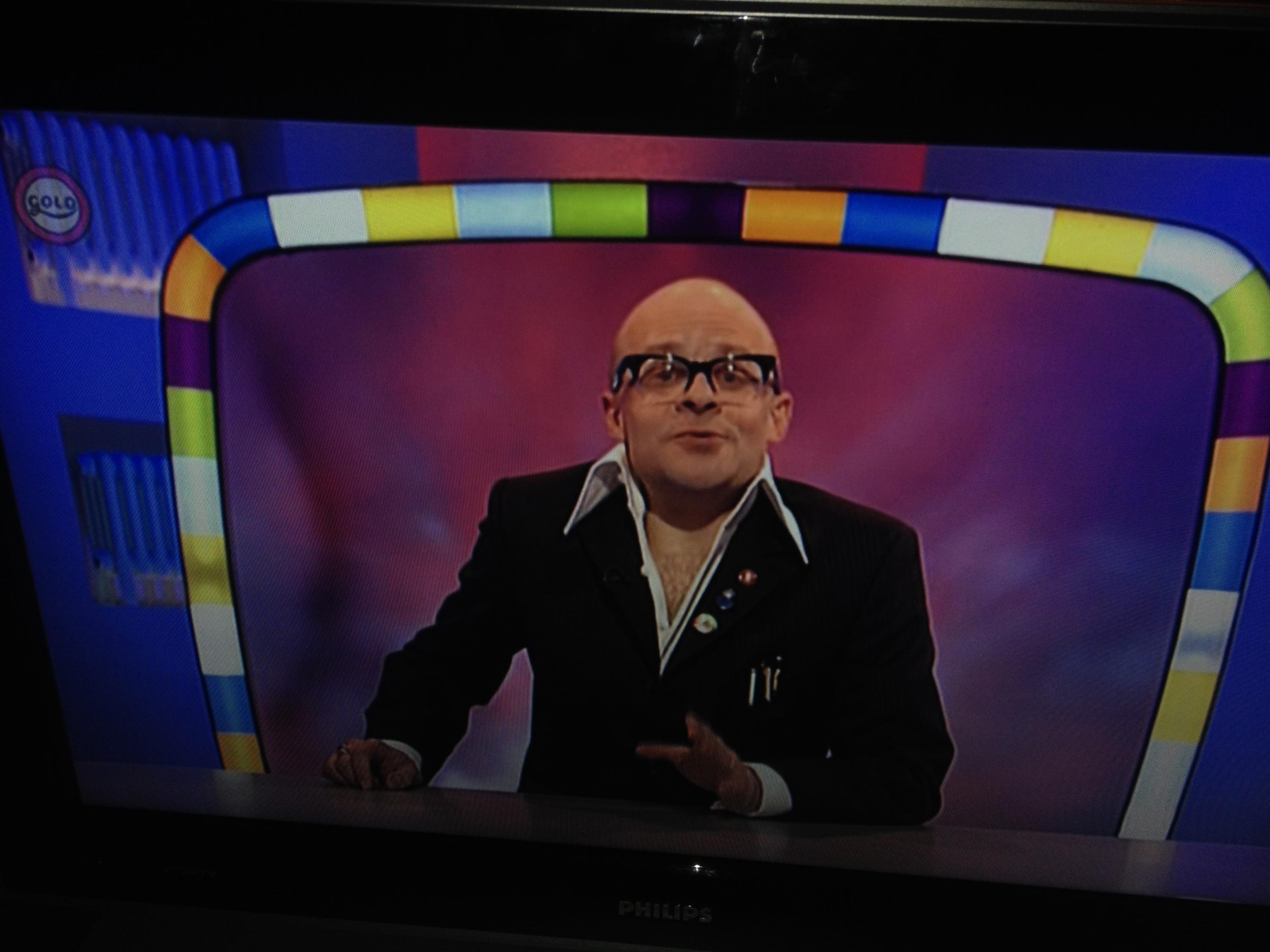

    Philips 37inch lcd picture fault
    their is a black smuge on the screen after about 20mins can see in picture any help please
    Re: Philips 37inch lcd picture fault
    Mura fault, panel. Not repairable as far as I know.
    If this were a year ago Philips, LG and Toshiba were doing free exchanges on these models due to this being a common fault.
